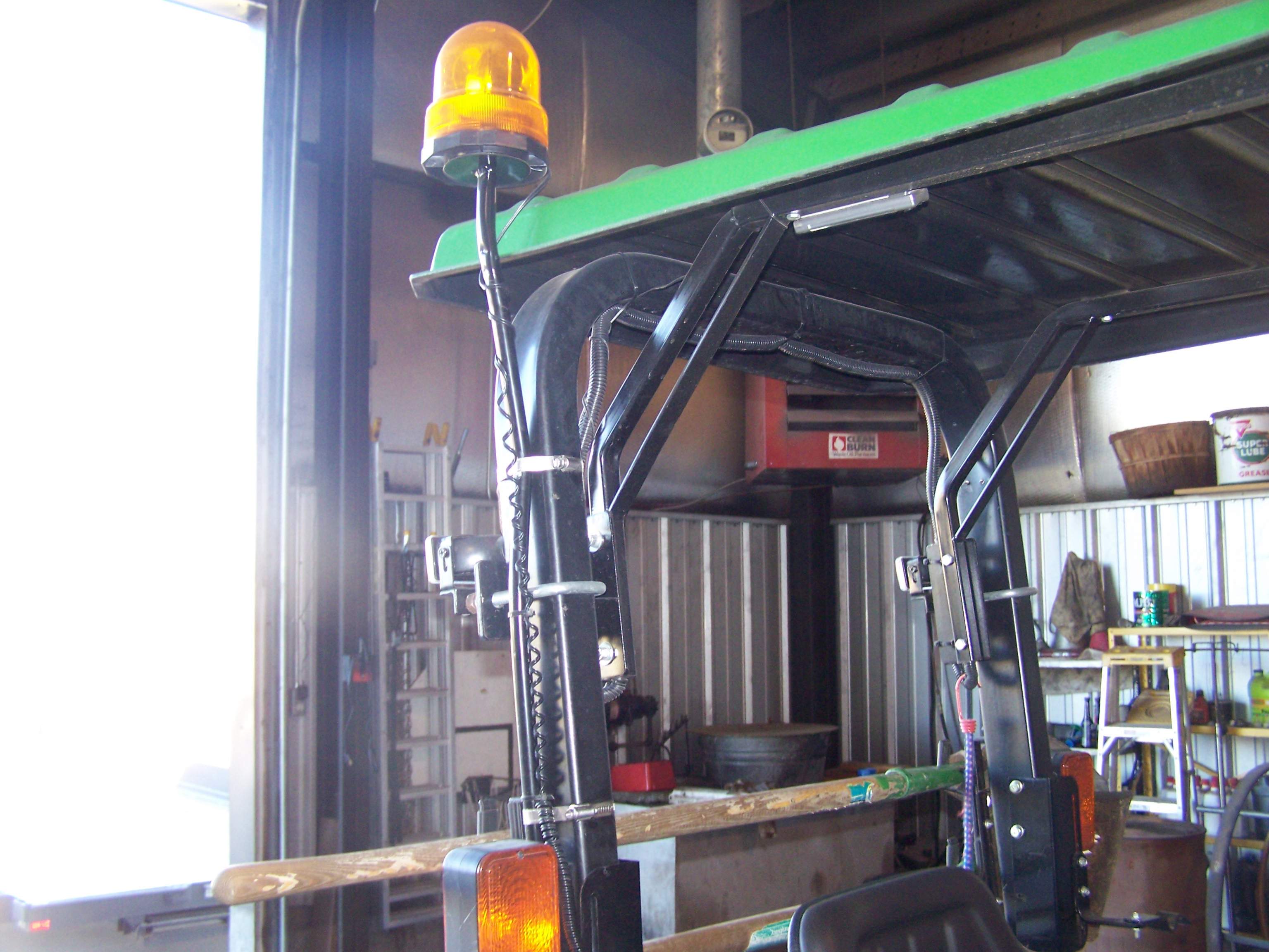

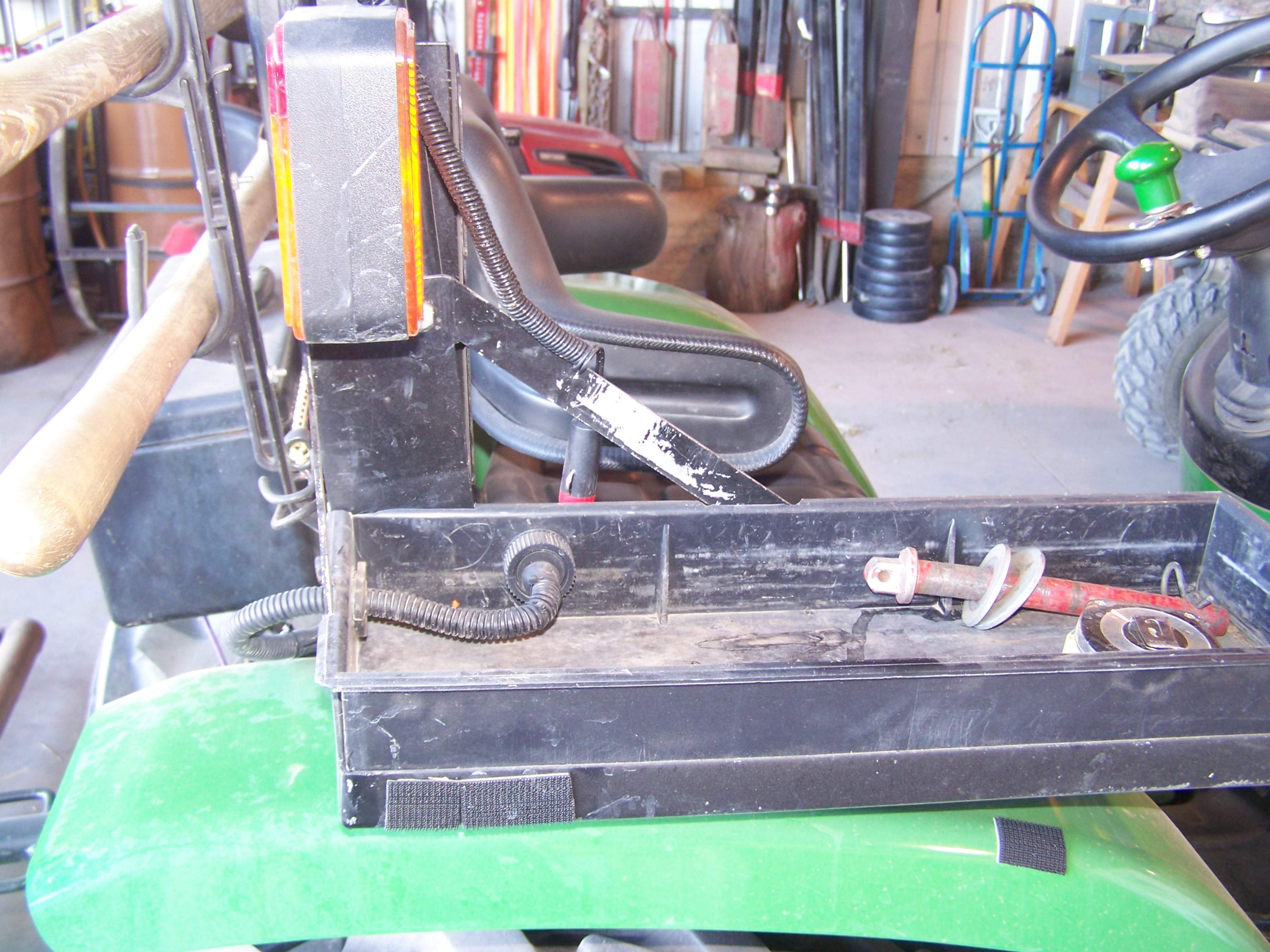

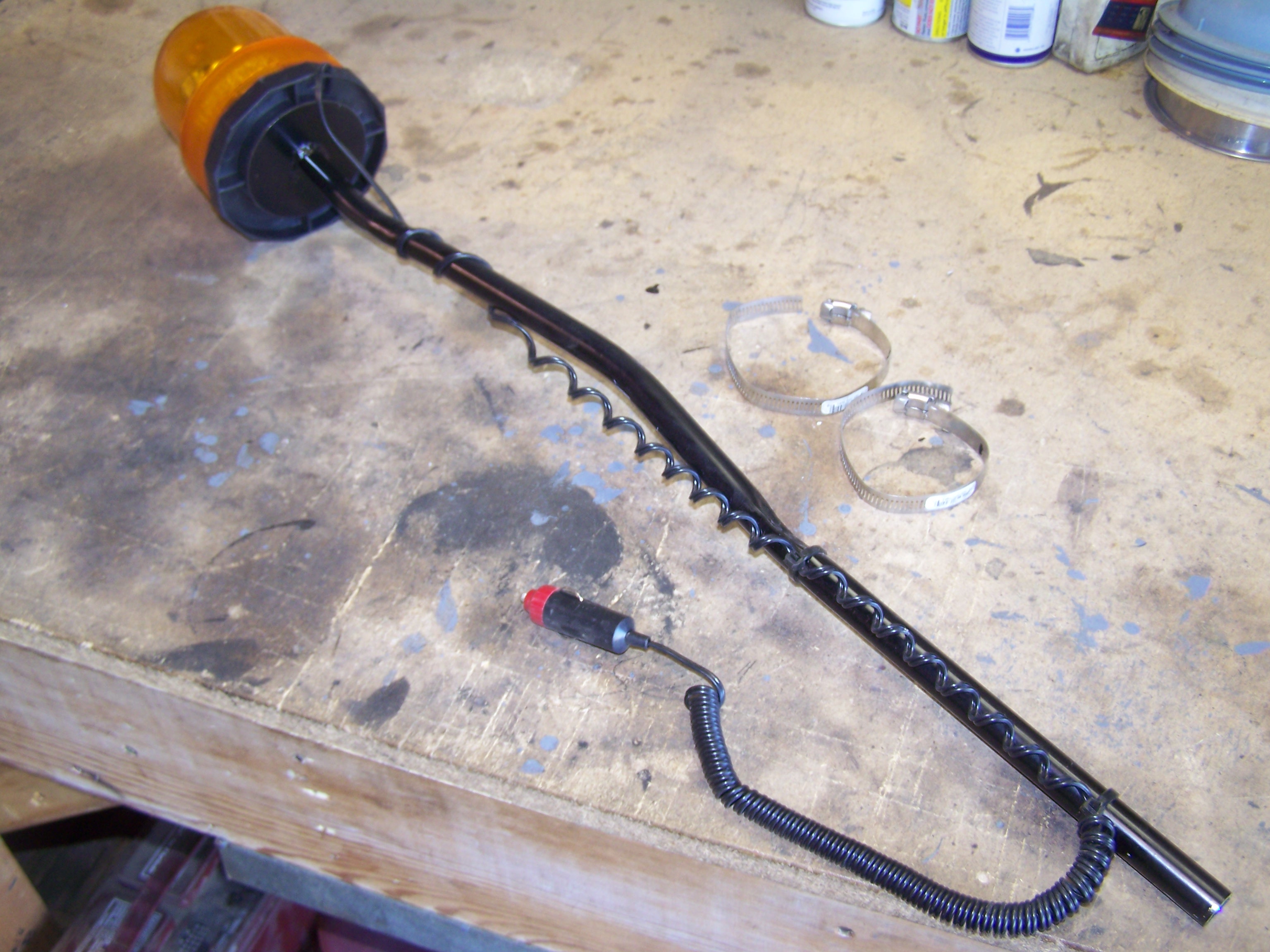

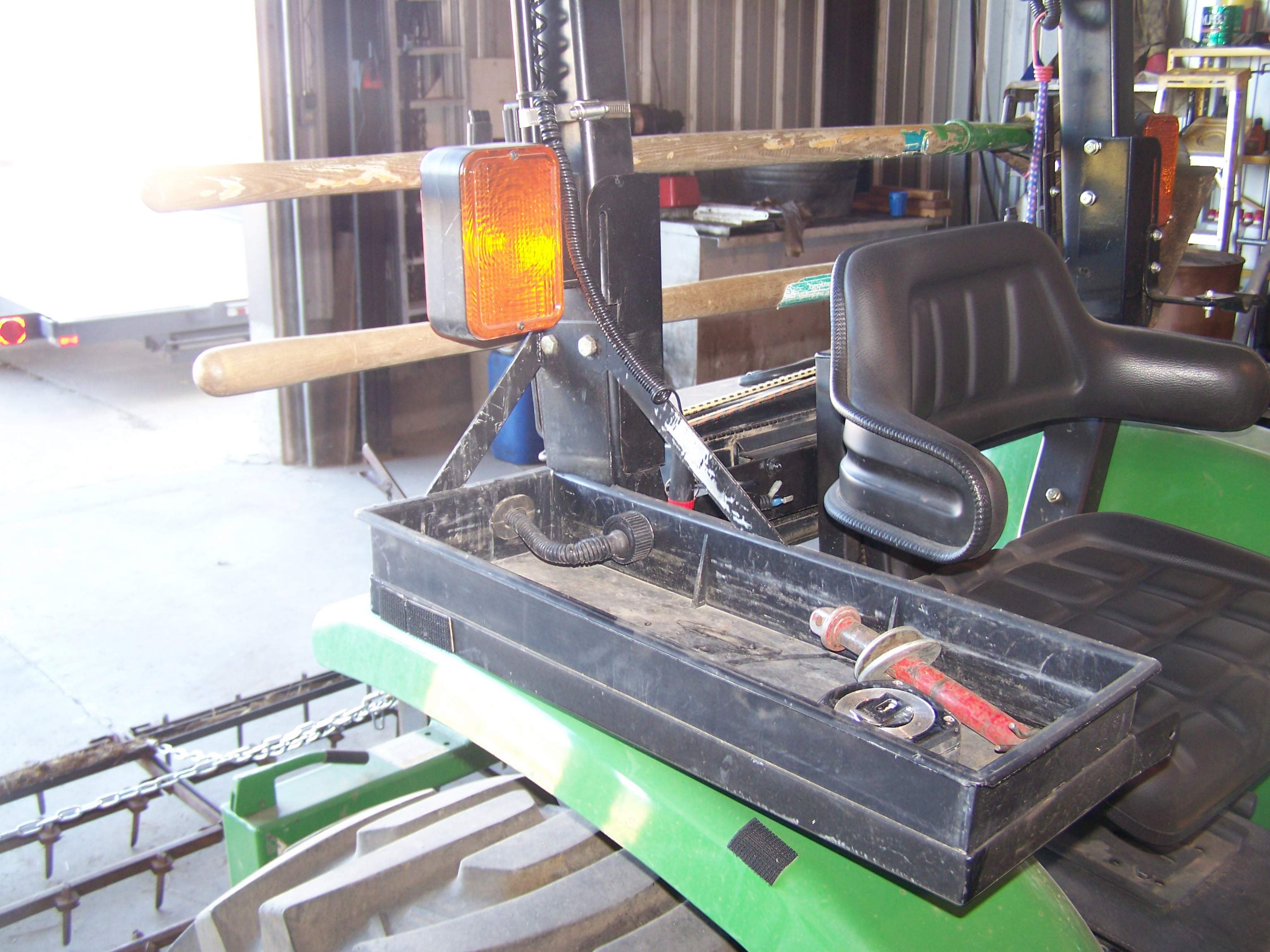

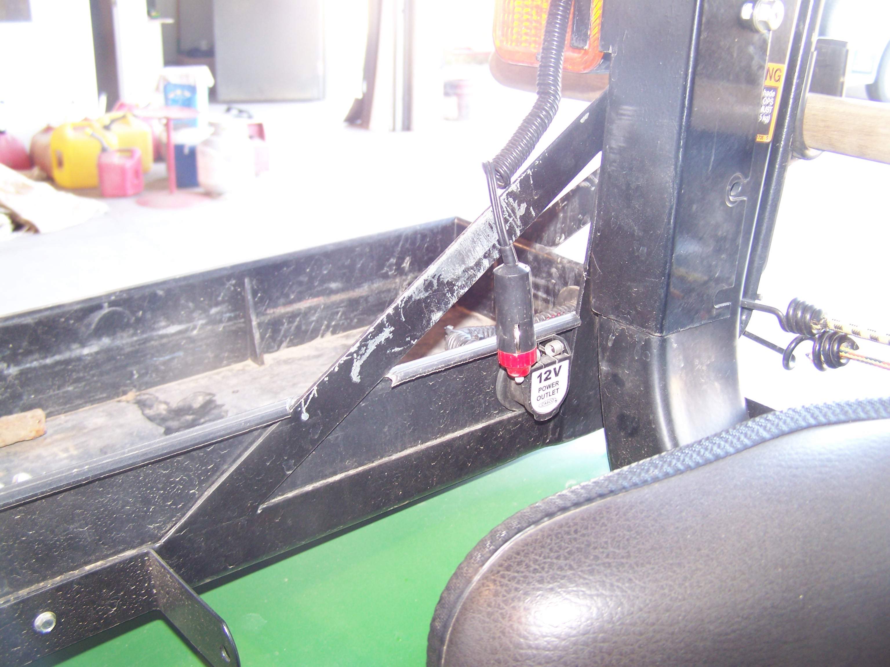

Here ya go... the 12v plug came from my local farm and ranch store. Power is drawn off the starter hot lug. Nice thing about this plug is a person can charge cell phone, or adapt other 12v things to plug in...ie.. lights, mp3, spotlights, etc, so power is always there when needed.
Thanks! Very nicely done... I may do something similar
