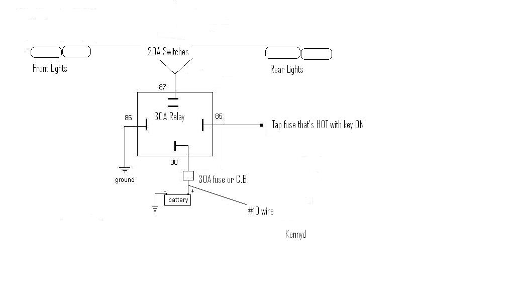

Re: the light relay install - anybody know of a source for a weather-resistant plastic box to mount the relay and terminal strip into? Struck out today at NAPA and VIP.
Does my 4120 have any spare slots in the fuse box from which I can put a 30a fuse and run power throuigh the relay to my light switches? Need to get a service manual......
First, the Bosch style relays from most auto parts stores are weather resistant, and include a mounting tab. Look at this one: 30 Amp Relay, just Google that term for lots of hits about them.
Second, You DO NOT want to pull 30 amps from the factory fuse panel. Run a #10 wire directly from the battery through a 30 amp fuse or circuit breaker. Remember the diagram I posted for you? Here it is again:
Yes - I remember, but thanks for sending it again. Just wondering if it was possible to utilize the stock fuse box. Probably not a good idea as you said.
Only use it to feed the coil side of the relay with something that's only hot with the key ON.
even with low amp loads? I have a fan and possibly a radio to mount on mine.
