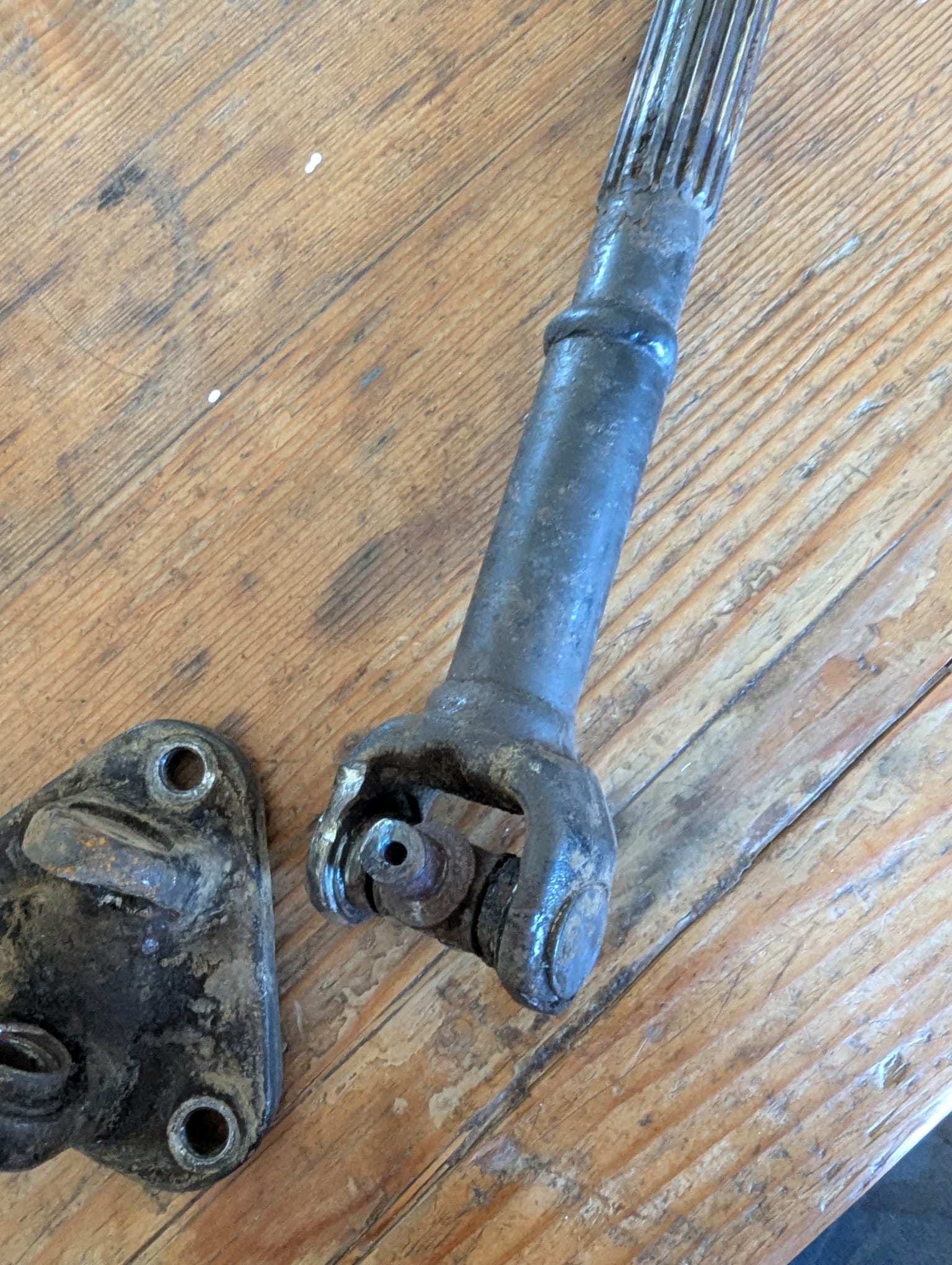

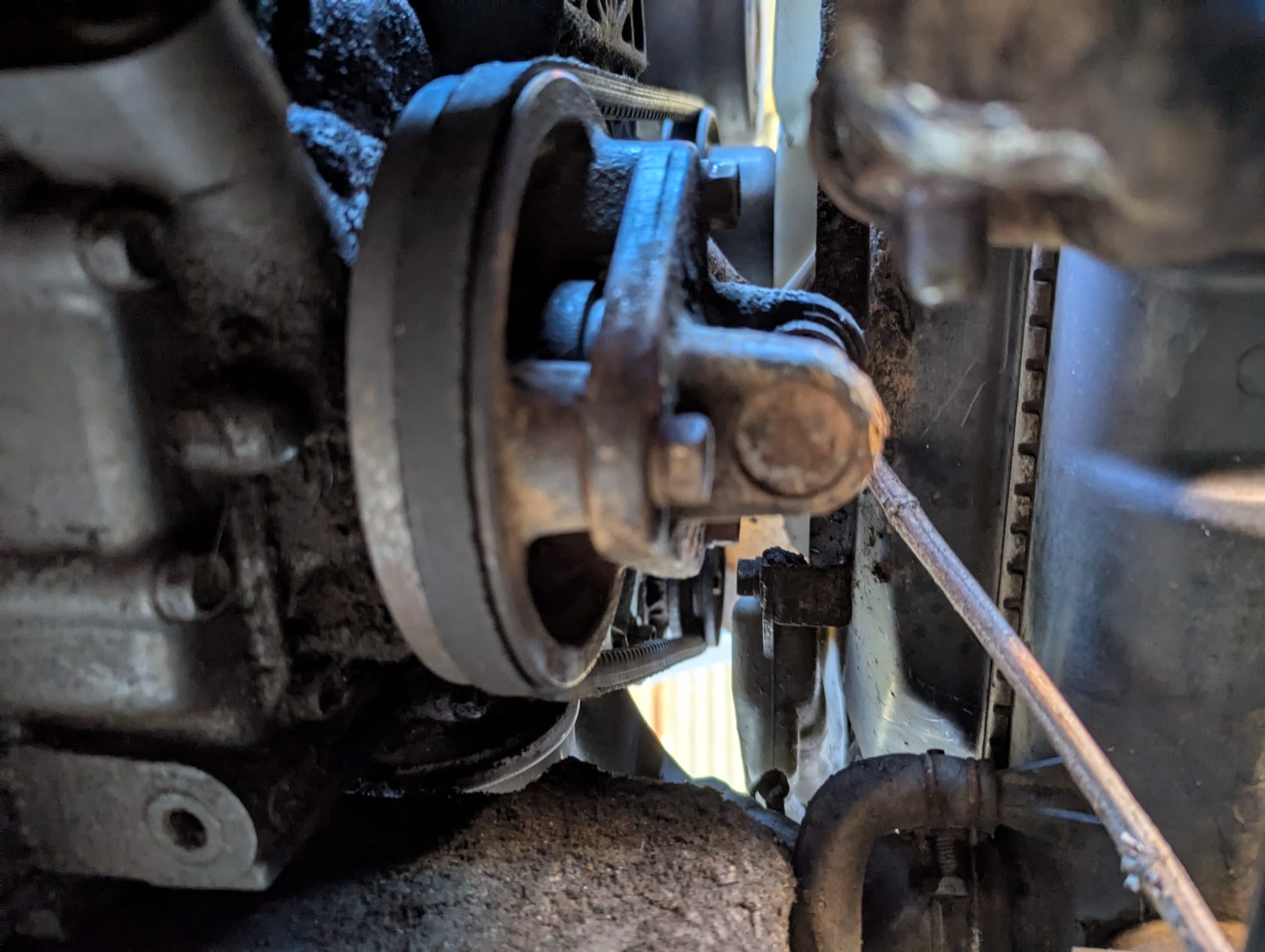

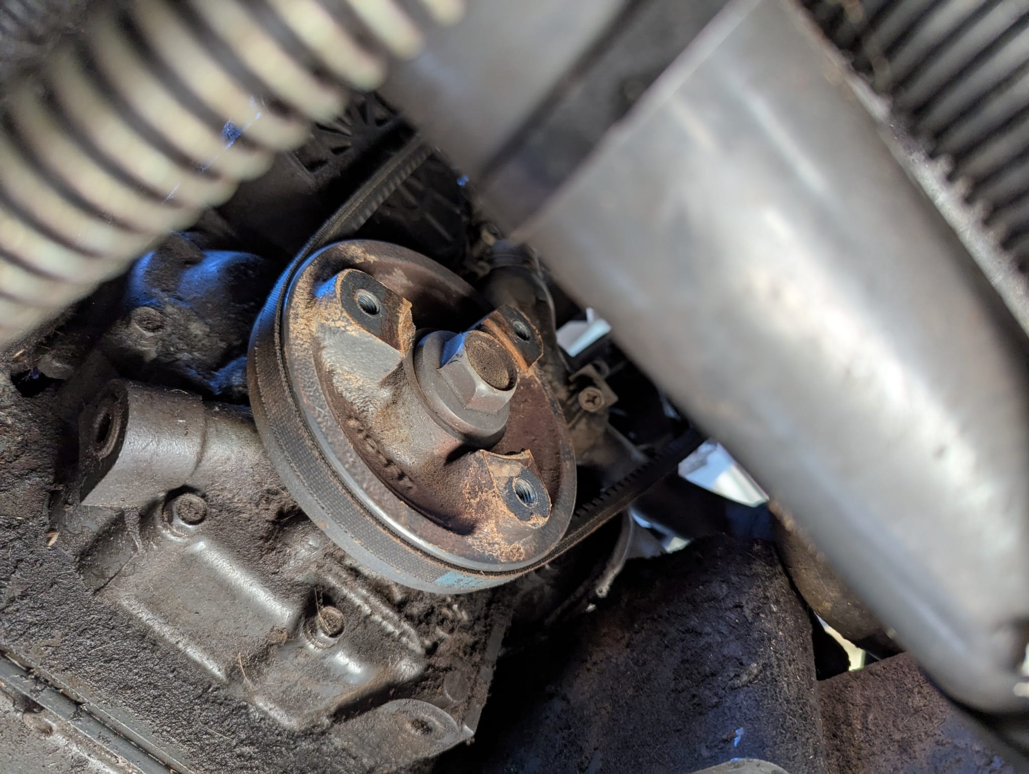

I am needing some help finding a replacement spline shaft for my f3060. The universal joint has fractured and i need to replace the shaft. picture showing the failed join and the triangular plate bolted to the motor below. I am wondering if they still make this shaft with the bolt on plate? or are they different because I cant find anything looking like this on line. It is the shaft connecting the motor and the HST
Here is the shaft and plate removed showing the fractured joint . Any thoughts?
here is the triangular plate mounted to the engine
Here is the plate removed.
Sorry, not able to see in the photos which piece has fractured?

You can buy complete new drive shaft for about $750 from any Kubota dealer, or buy individual parts as needed.
Below is a dealer I have ordered from many times.
Select Category: "Transmission" + Diagram "D10502 Universal Joint/Fan"

Colemans in Kansas City has them and their shipping is actually sane as well. In fact my local Kubota dealer has them in stock. just checked yesterday. Complete and parts. Curious as to how you broke the driveshaft? Maybe I should say, from the looks of the first picture, an acute lack of grease is at fault.
