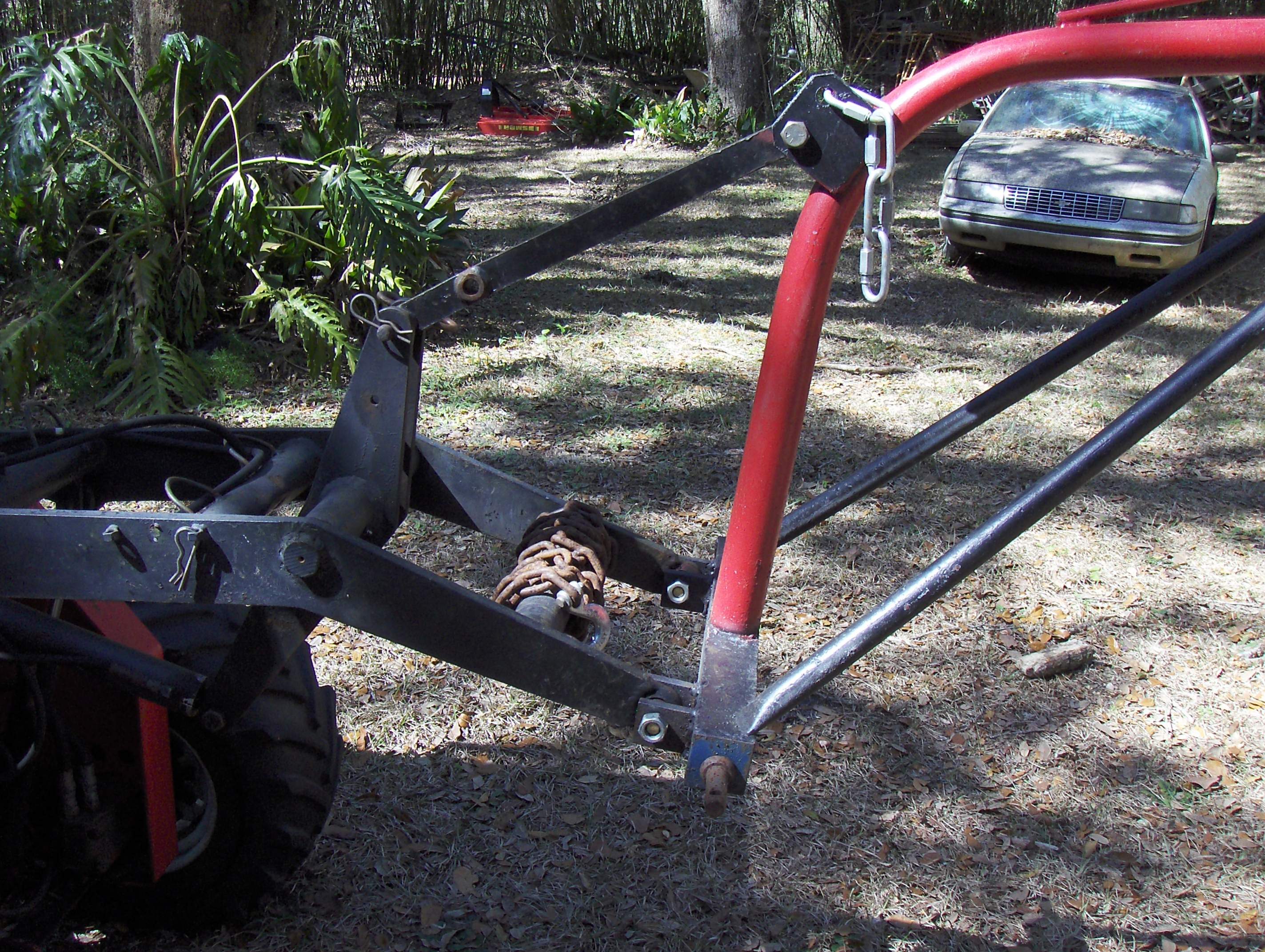

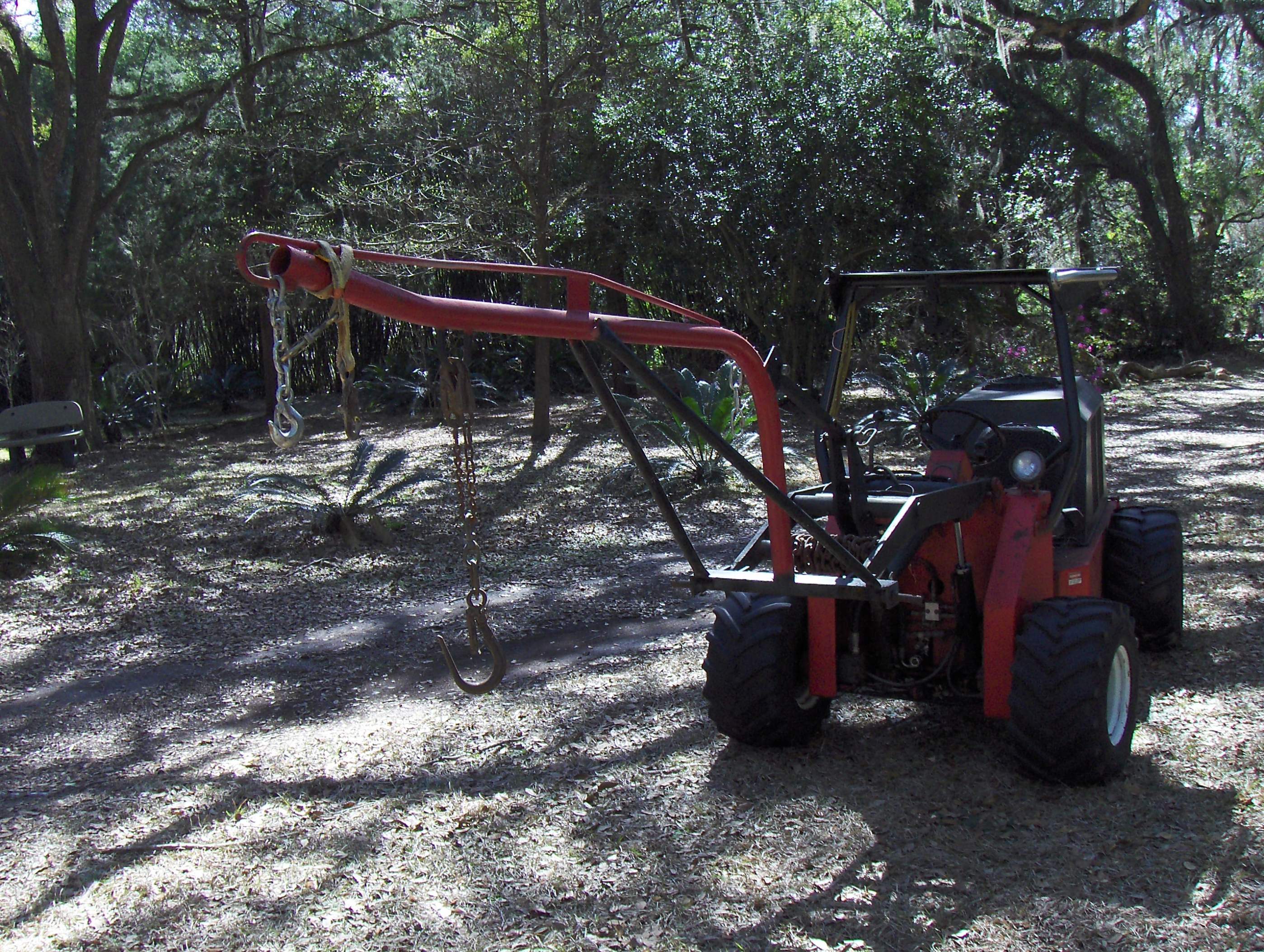

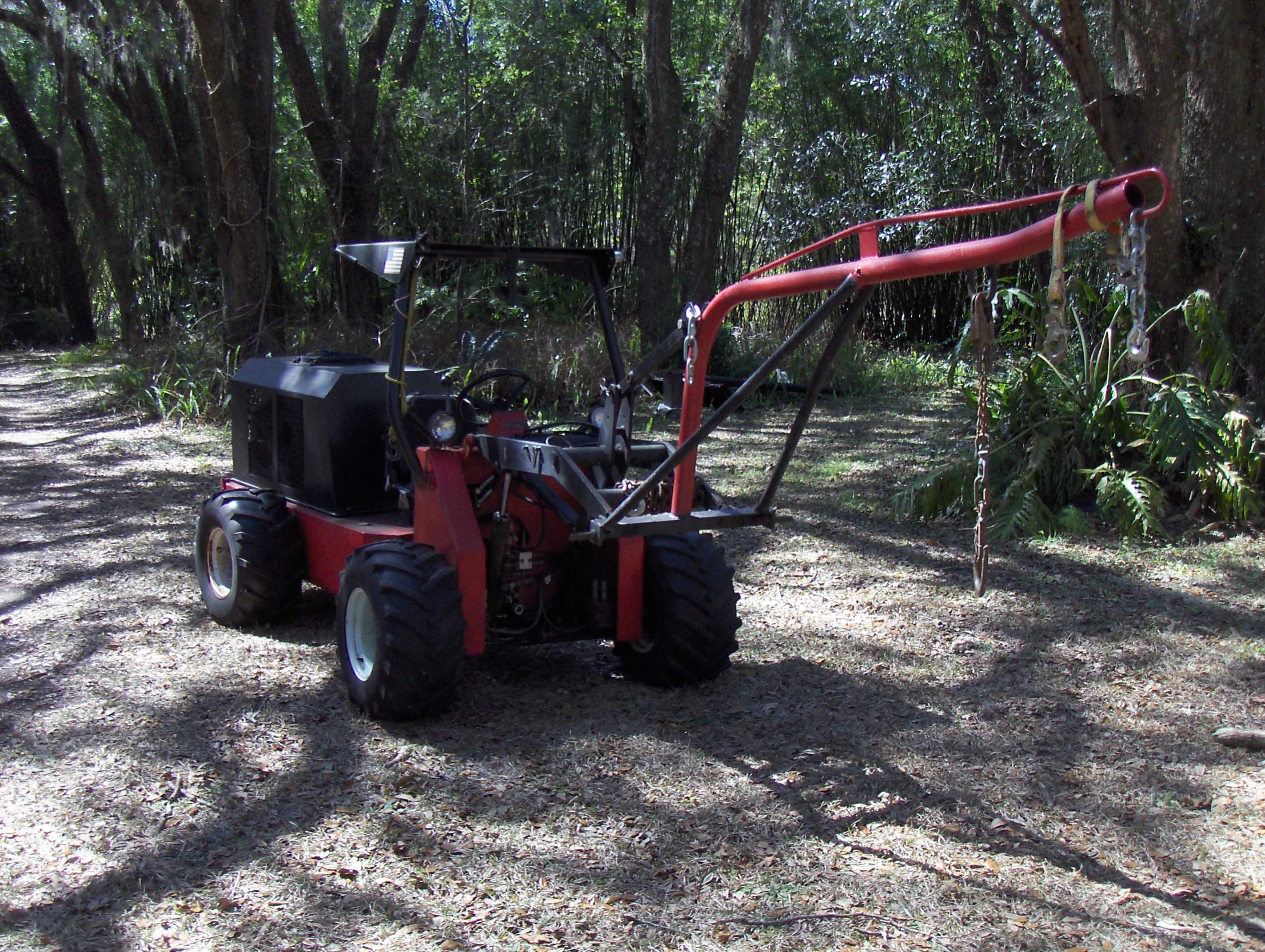

Speaking of boom poles, I reconfigured this one to mount on the front of my Power-Trac. Works real well. Can reach up as high as 16 ft. It can still be used as a 3PT boom pole.
That looks like a strong built boom pole.

The boom pole is well made, and I was thinking of modifying the end piece with some hitch type tubing. I want to mount a hydraulic chain saw on the end.
