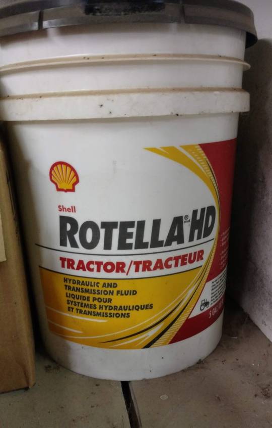

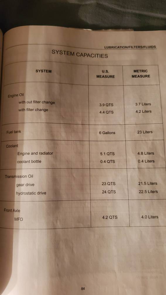

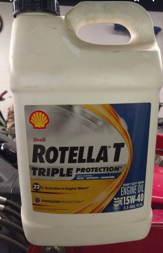

Agreed. They have a kit that contains all of the filters and it is typically much cheaper than buying them individually from your local dealer. This is how I get filters for my 2016 26xl. Unless the previous owner provides documentation of fluid and filter changes I would change them all after you get it.
I run Shell Rotella diesel engine oil and hydraulic fluid. Both are Mahindra recommended. Mine is the HST model. Screenshot_20210113-230941_Photos.jpegScreenshot_20210113-230914_Photos.jpeg

this is prolly the way im going, where did you pick up the rotella?

I typically get the fluids at Tractor Supply. I think I have gotten the engine oil at Auto Zone also.

have you replaced all the fluids, would you say 7 gallons is enough for the front axle and hst/hydraulic?
