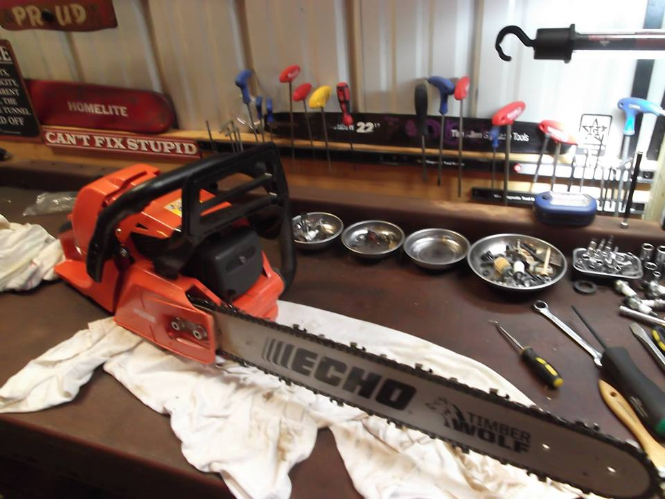

on my 490 the seal to the carb seems ok, on the 620p I use an o-ring as it looks like a small gap.
Yep 590 620 too. Different oring.

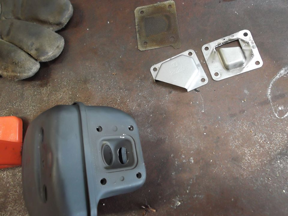

30 min fix if you know how to retune your carb afterwords. Let them breath better, but more sound too.
590 muffler is restricted so bad. Never had a 620 on bench to see muffler. How I open for a quick fix.
490 same way. Open that muffler and retune. Remove deflector and remove tube and open. No need to do like mine came traded in with pipe.

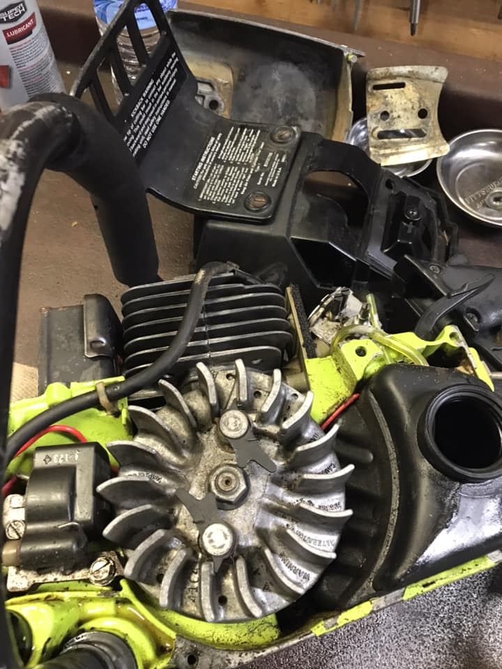

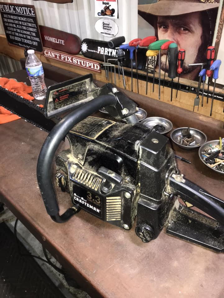

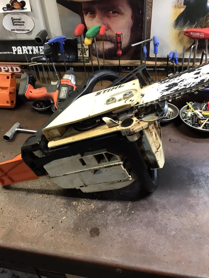

Old school 65cc picked up to see if I could save it.
So much was wrong with just the lines and fuel filter someone tried to use. The carved stihl fuel filter smooth to try and fit the line. Duh slides off.
Fuel line in tank vent hole. But least was run to carb.
Tank vent line wrong hole and ran wrong and out and no duckbill even installed. Just will spit mix straight out and up that way.
/ Just another junk chainsaw
#1,325
She lives and cutting.
Not bad psi for a 4000 thin ring saw.

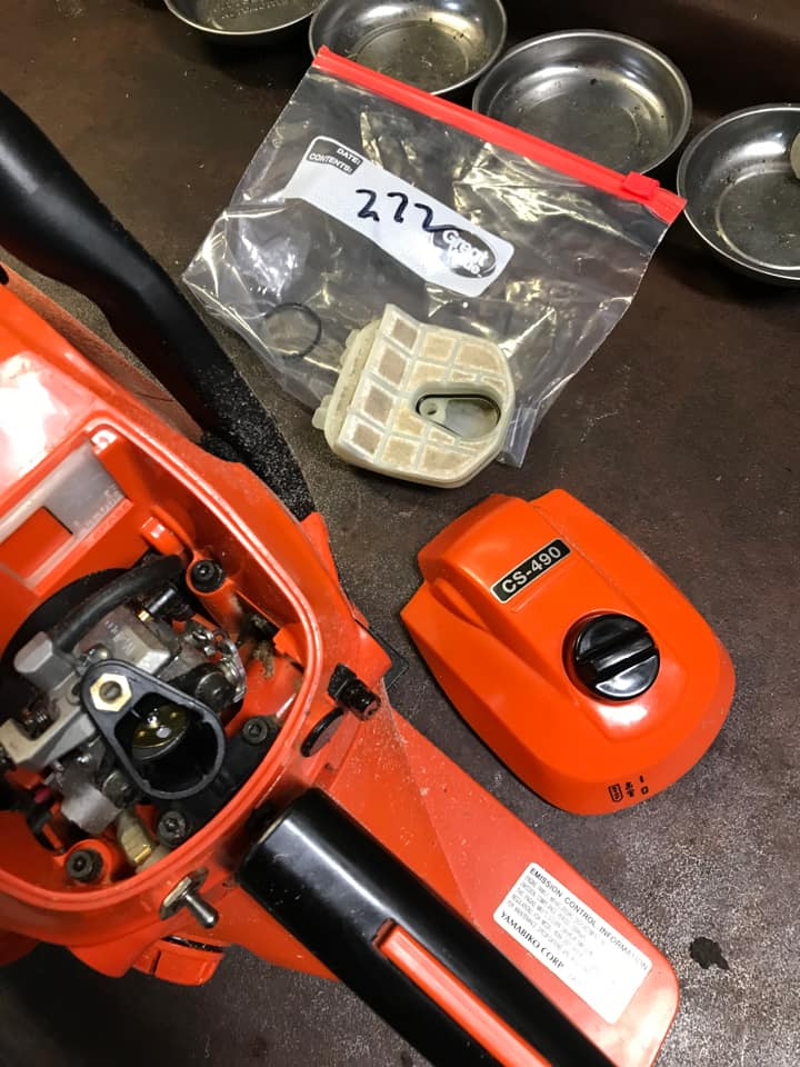

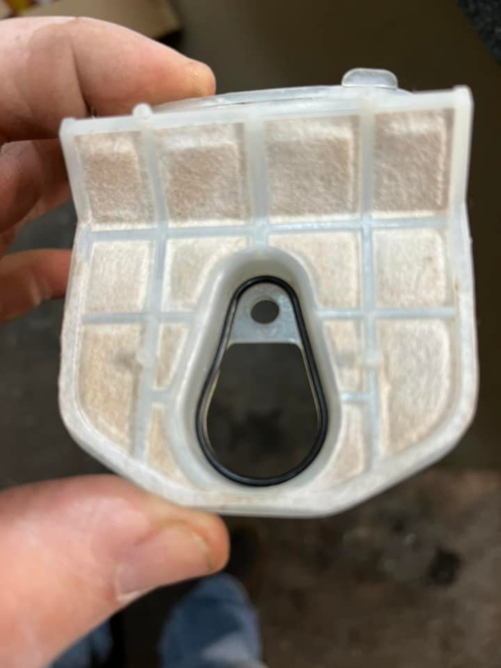

You finding fines in your carb throat from getting by air filter on this series echo? Just curious. Most folks find them on 490 4910 501. I did too.
Easy fix in pic. Stops it.
do you have a step by step procedure on how to keep the fines out of the carb throat and retune your carb?
I have two CS-490's that run well but would like to keep them running well for a long time.
Best thing for the 490 501 4910 is the 272 o-ring inside air filter.
Can see it inside filter in pic in my 490 and friends 4910 pic
