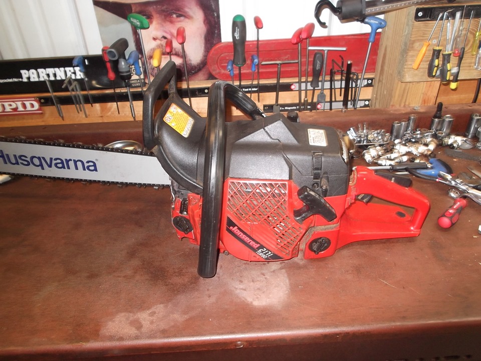

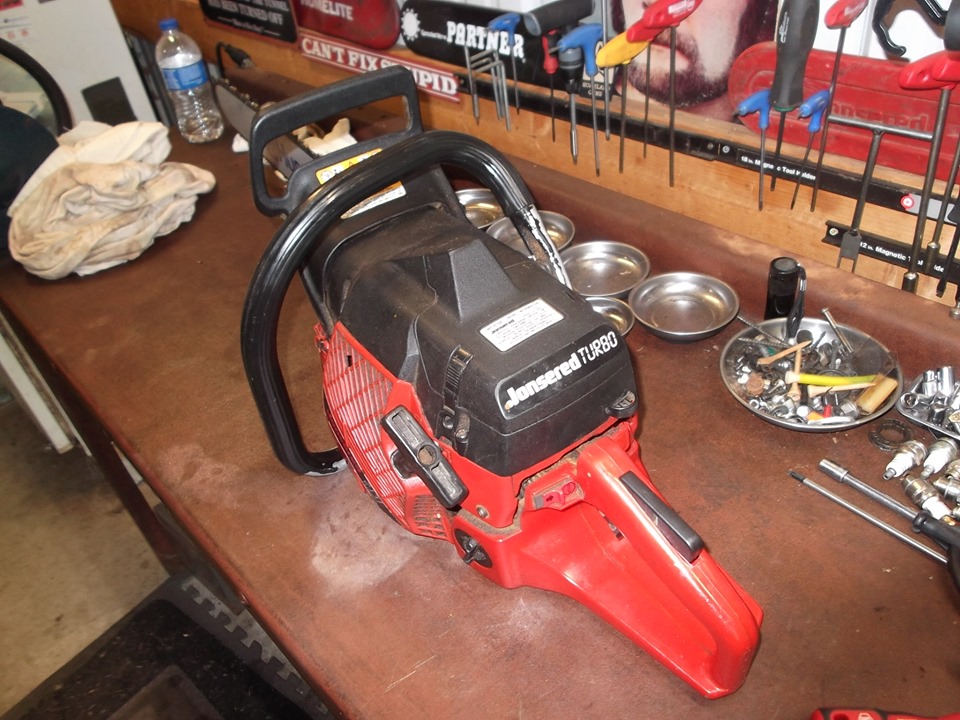

Just showing aftermarket 272 redneck cut. Just for use. So other guys having issues getting a working cover if they are worried about such.
The red I used is wrong but it was on hand.
Tried to buy 2 correct shades at 2 different places and they were out. For me it didn’t matter if it had been any color.
Was just showing for those that care and wanting a cover for those Jonsered.
You could leave it whole without cutting and leave orange for use. Just know some jred folks let that bother them.

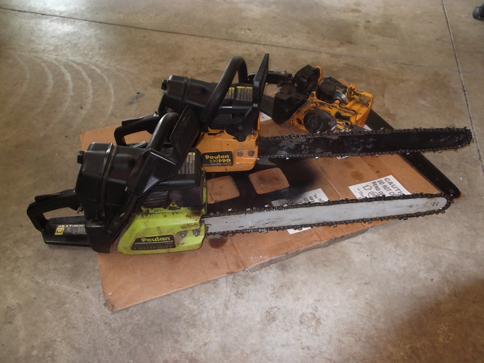

I've just redone and tested 4 42cc strato poulan saws for folks. I have to admit they are just so gutless of a saw that barely even get trim type work done. Let alone bury their bars.
Nothing like the better 42cc ones before the strato crap.
Only 1 didnt have the fuel lines rotted off and he ran can poulan husky efree mix. Lines still looked new.
Might go pull a PP260 42cc non strato that hasnt been used for years off the shelf to see. Maybe I just have become spoiled with other little saws I run.
See if the 260 etc run like I recall. Know there is one up there on shelves somewhere.

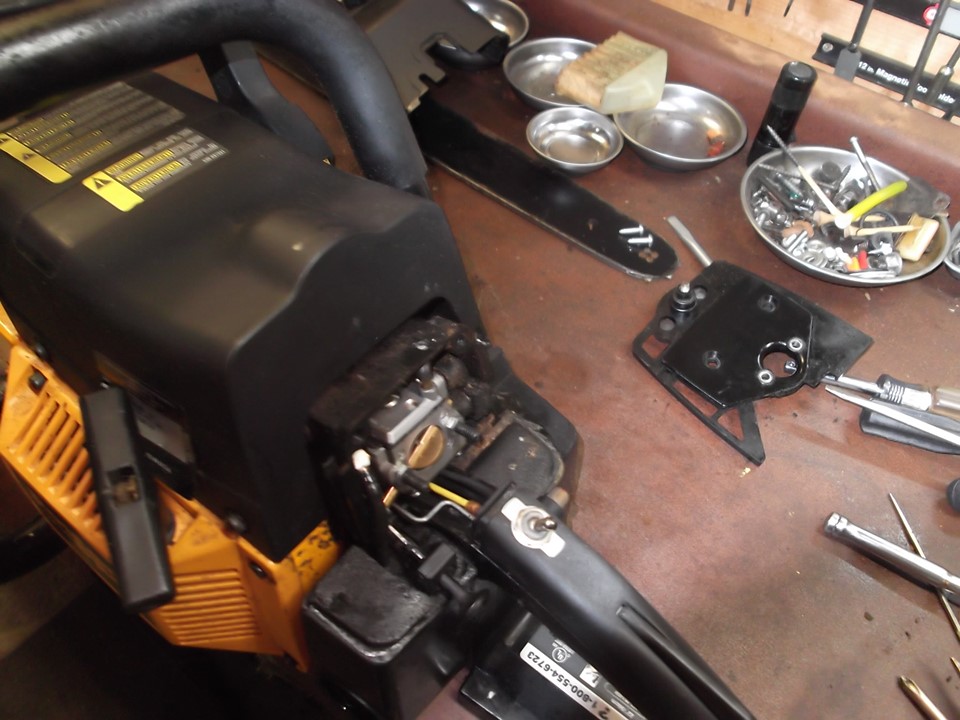

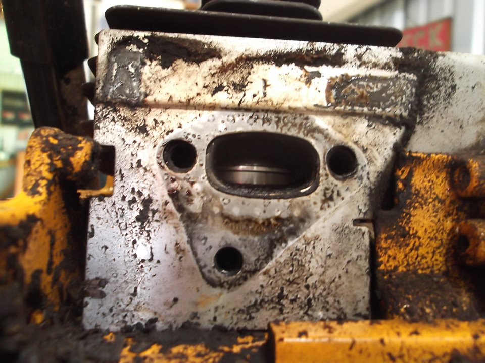

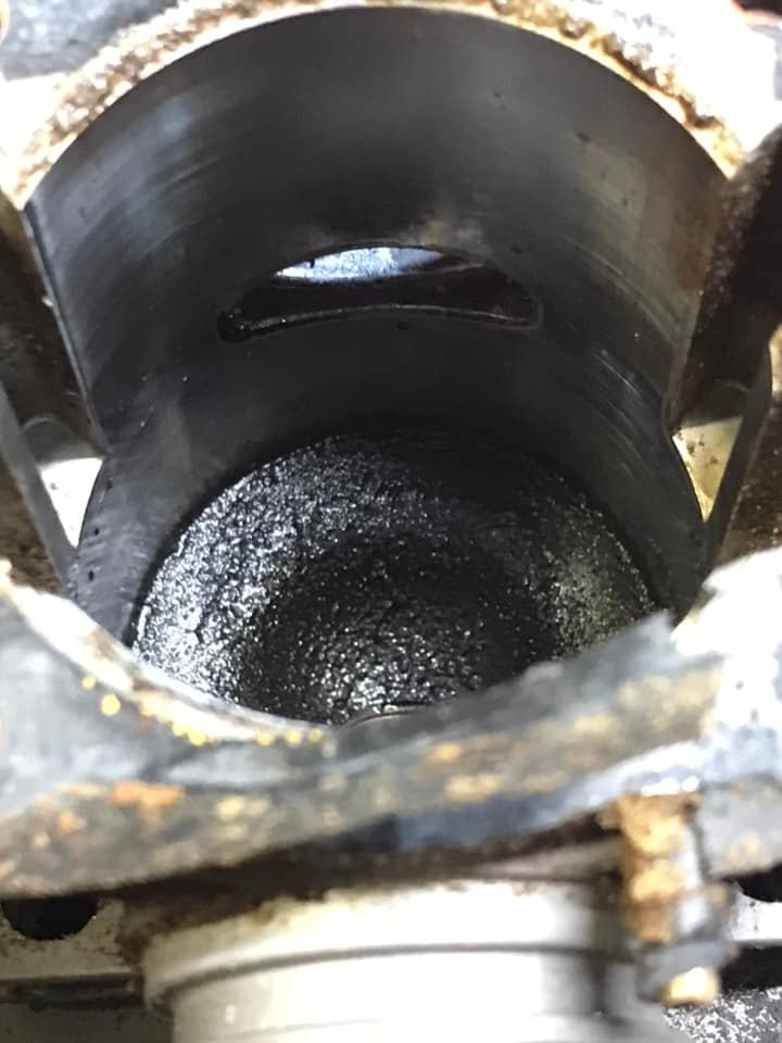

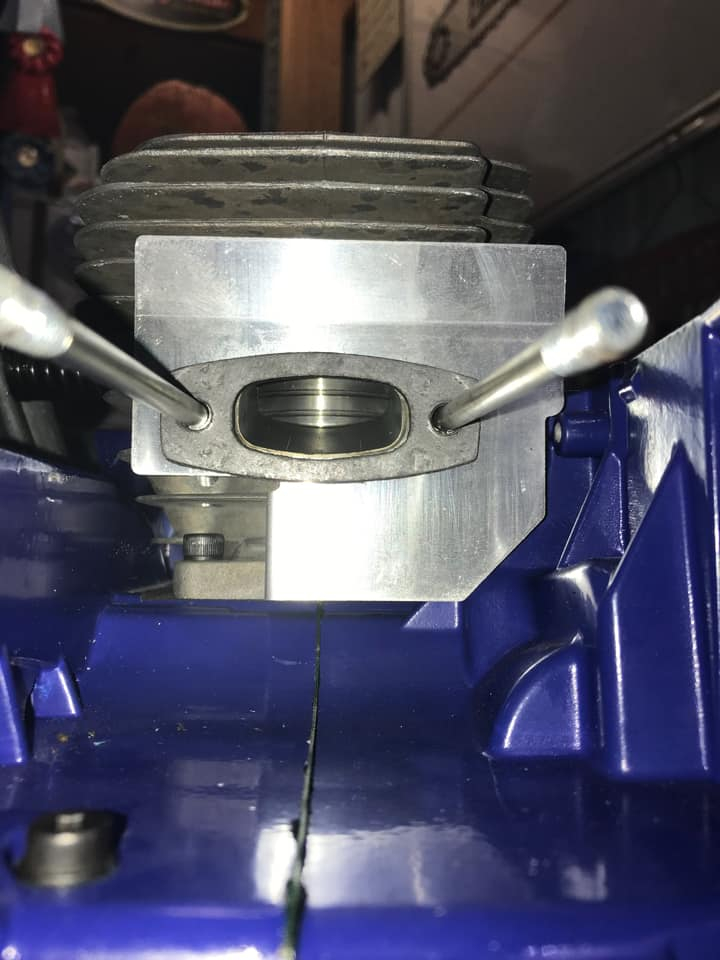

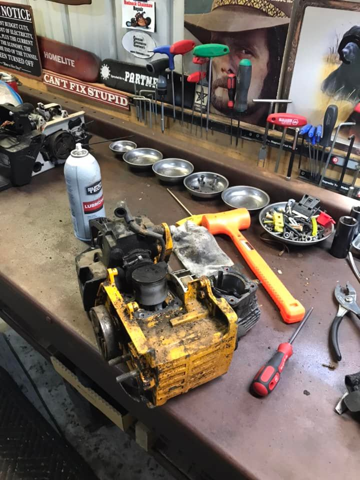

Another 54cc that was installed with backwards piston.
Only other maker I have seen do this oem has been husky on 2 pro models. 🤯
Got lucky this one hadnt beat itself to death like they normally do scoring cylinder and ruin piston.

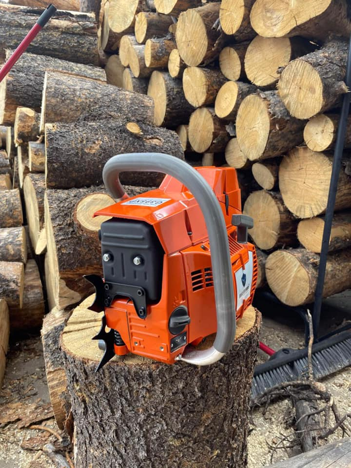

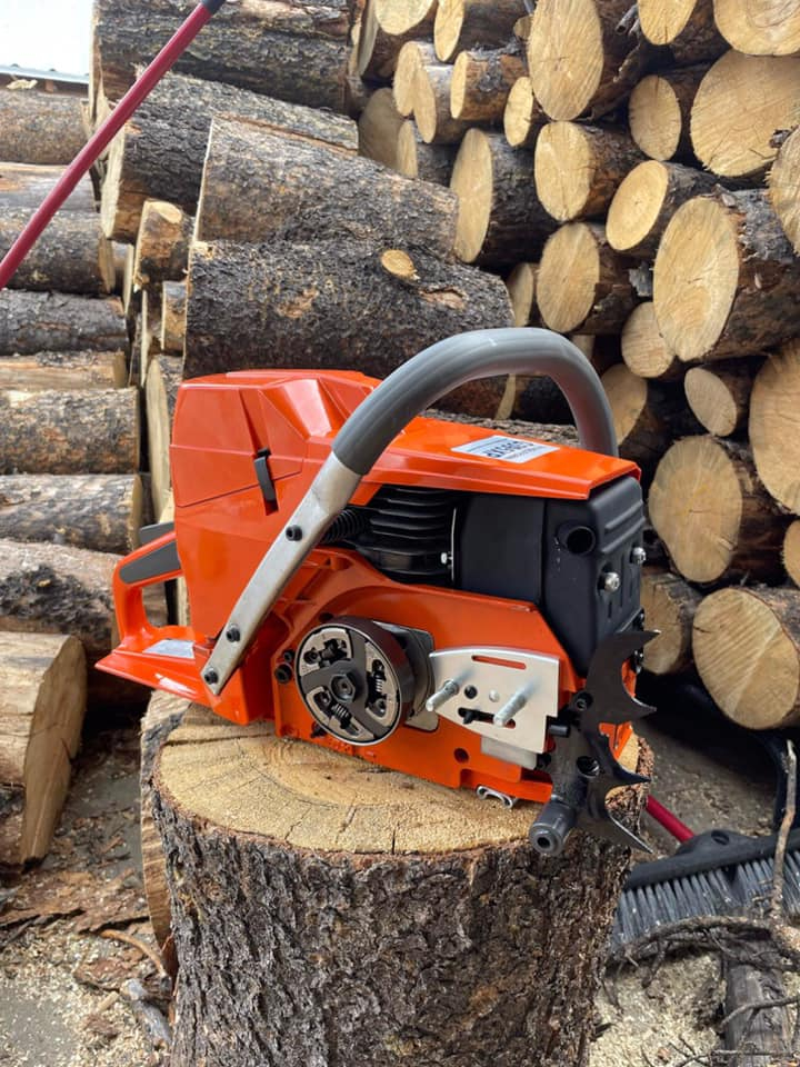

Farmertec G395xp. Curiosity got the better of me
3 days to my door from Farmertec website US stock.
Orange or blue if your picky on a chainsaws color. Didn’t matter to me which.
Looks like a winner to me and can’t beat the Price IMHO. 339 from Jes or US stock Farmertec. 359 shipped.
Starts easy like they should.

Couple of the US dealers showing their G395xp clones in orange.
I picked up the blue one that came out first. I dont buy saws for color or looks myself.

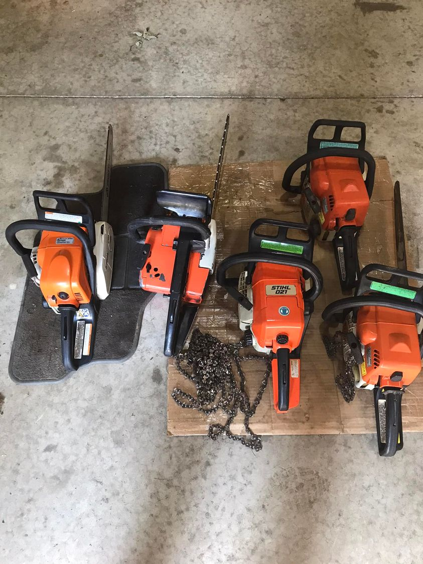

They just keep coming in to line up for some bench time.
They pull and they pull but they stihl wont go.
/ Just another junk chainsaw
#1,299
Funny, my stihl 025 always choke, pull, pull burrrp, unchoke pull and goes. I wonder what the difference is. Mine's circa 85
Owners and maintenance given for up keep on saw.

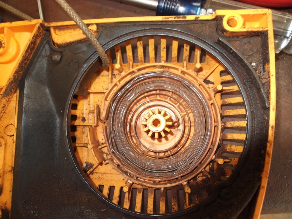

Some had ethanol jell in the tanks from older mix. Some had water in the tanks from ethanol mix drawing in moisture. One broken pawls, 1 broken trigger mount in handle. 1 throttle linkage off carb. 1 plug and so on.
