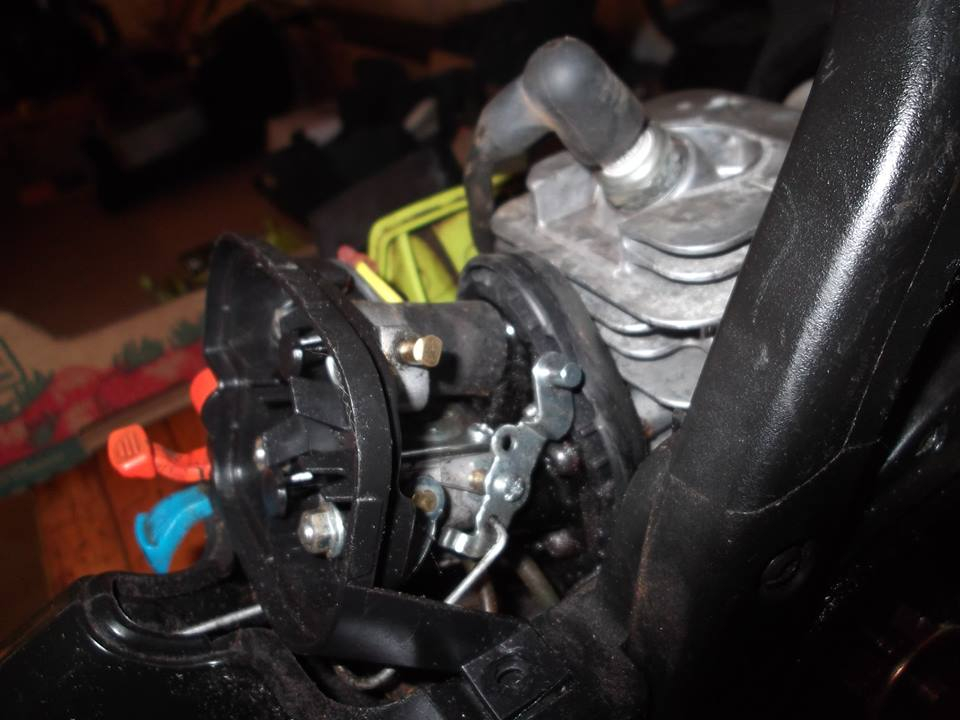

Looks like it should operate, but is it listed for your saw. Jet and Venturi size is the real question.
the one in the first pic is like the one that xyz123 has posted. But I don't know if the are the same.
I see the difference in the pic but I have no idea if there was a design change or not, or whether the carb in the first pic will work ,or not.
Having a hard time locating the carb in the second pic, but it's the same style as on my saw, and appears both share the same part number

The carb I had marked A B C was a NON strato carb on a 2150 for a guy long ago.
The strato carbs and other non strato are sometimes set up different. Pay attention to your carb and take pics.
Pic of carb in question and the name brand and numbers always help.
Black plastic upper strato deal was broke off this one. I found the metal wire carbs the same.
/ Just another junk chainsaw #1,245
Thanks, I don't know what part this carb with the plastic lever plays, but I haven't been able to locate one. All have metal linkage .
My carb number is w-26B. Everything I have seen stated that this different carb is compatible with w-26B. So, I ordered it.
we'll see what happens
