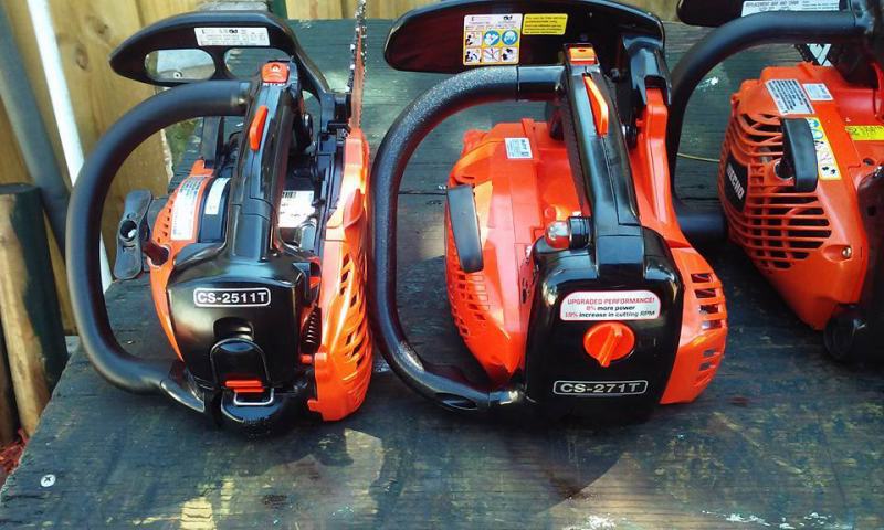

What I find somewhat interesting is, the Echo is almost an exact copy of the Japanese Tanaka (no longer made), top handle arborist saw, right down to the air cleaner cover. I believe Makita bought Tanaka and discontinued the saws but I could be wrong. My buddy has one (Tanaka top handle), nice saw. It certainly was a lot less than the Stihl top handle that I crushed.
If I could get a Tanaka saw from a local dealer I would buy it in a heartbeat. They made good quality trimmers. I feel like their saws would be as good also.
/ Just another junk chainsaw #1,343
All I see anywhere are parts, no complete saws. I know my buddy will never part with his. I believe once Makita absorbed them, that was the end for their saw line.
The Echo could be an exact copy actually.

Guy I knew had 2511 271 355.

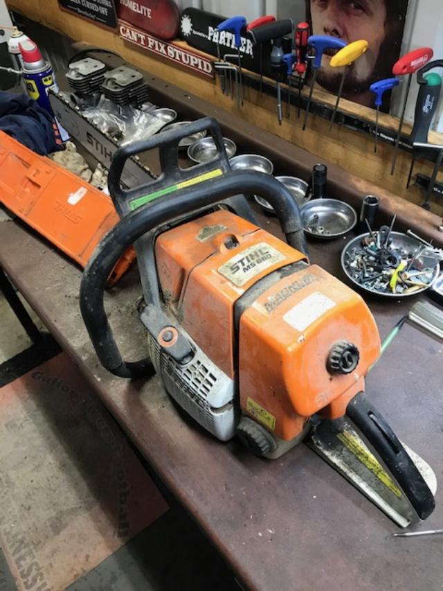

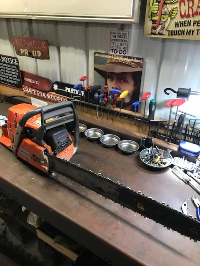

2 with muffler mod I took on trade 490 and 372. 2 with pipes in them were local trade ins. I dont do pipes on mine myself. So many different ways and so many different muffler sthls with their own problems.
290-390 sees the most from a 30min muffler mod I have timed before.
Just open under stock deflectors or add a deflector or gil them. Called caveman muffler mod that is free.
