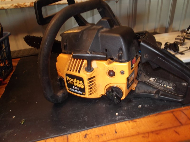

PP260 is a good saw for what it is. Plastic clamshell saw. Just dont get a whole lot wrapped up into one. I sell them for 50-75 ready to cut. Great little trim saws though with spring av. IMO better built and in the cut then the small homeowner saws sold by stihl for 3-5 times the cost.
This saw is before the strato crap they added later. I prefer this little saw to them.
Matter fact have a $50 one on the shelf now.

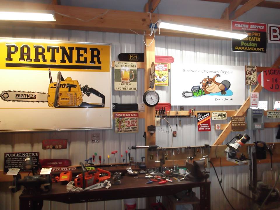

Looks like a nice shop you have. I was always reluctant to get so many magnetic nut & bolt holder cups.
Afraid they become permanent storage for "extra" nuts and bolts :embarrassed:
Oh well, maybe I will get few more...
Cheers :D
/ Just another junk chainsaw
#645
Cheers :D
I have 3 benches with them. #1 shown is main work bench so it has a few more.
I try and keep them broke down into sections when tearing saws apart.
/ Just another junk chainsaw #646
Very nice looking shop, wish mine was that neat.

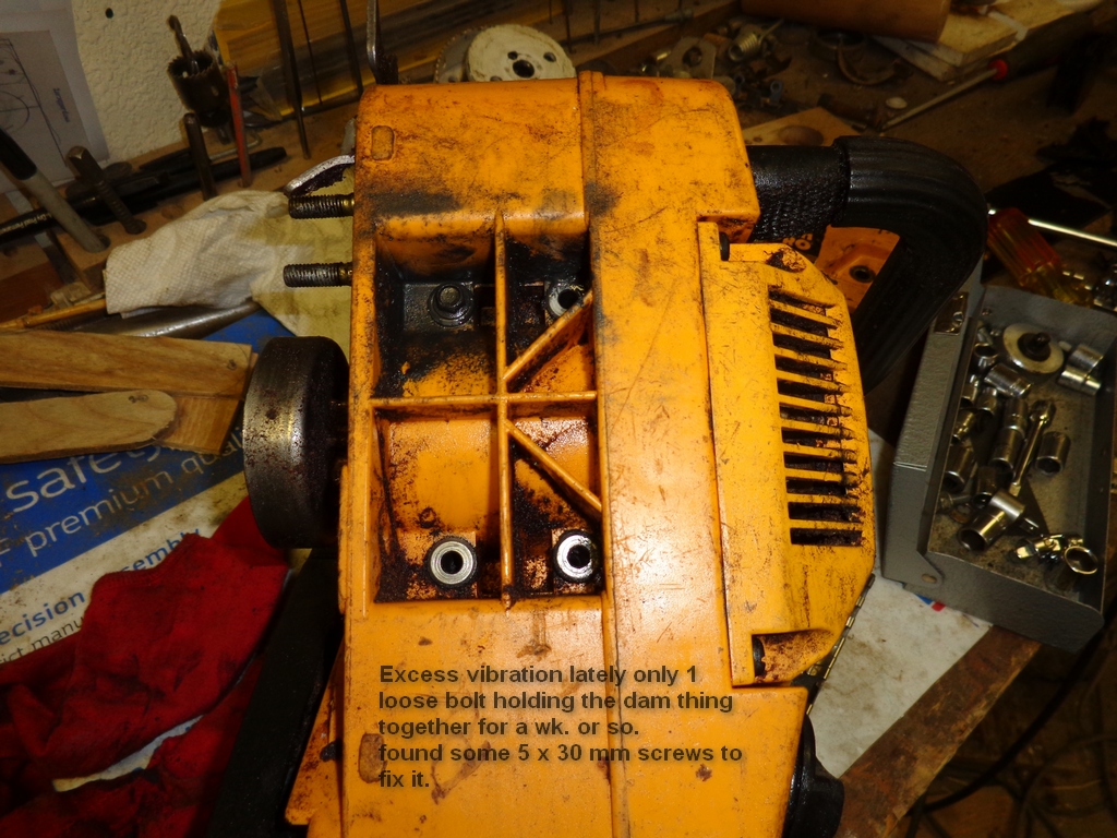

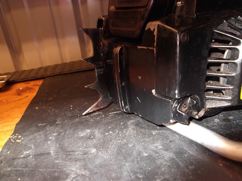

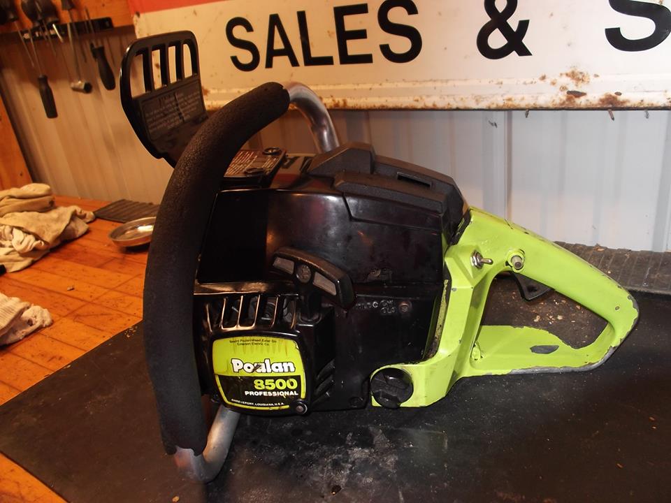

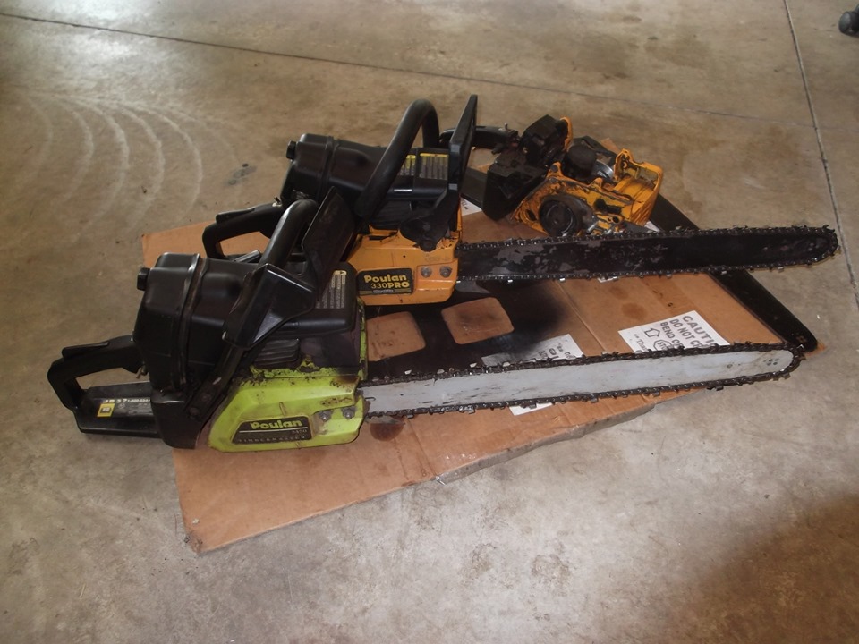

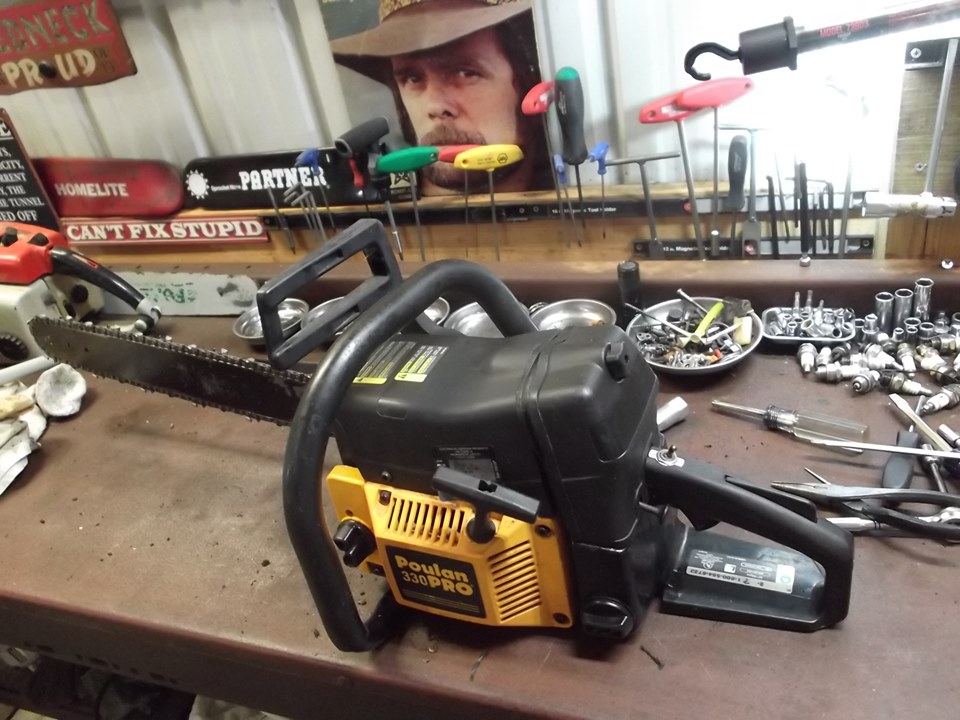

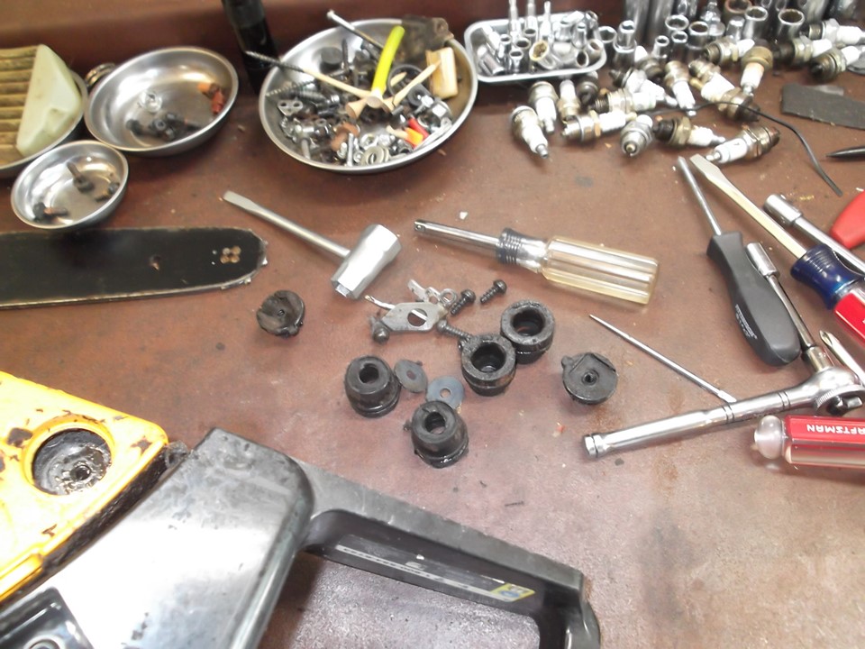

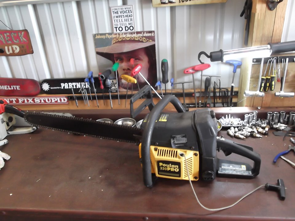

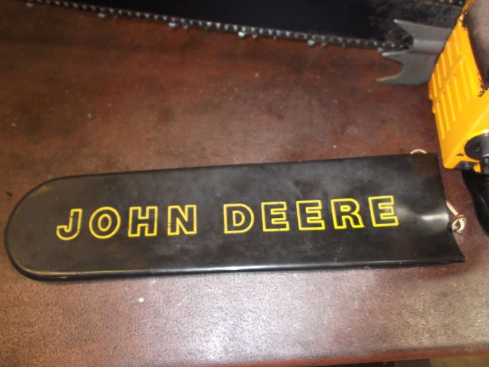

Seen a poulan 330 54cc with the 22" 3/8 for sale. Sticker shows 2007. While I was out I found a JD bar cover to put on the shop wall too.
I was told poulan ran. It did. But needed a air filter cover, air filter base being the stud was broke off in base and drywall screw was used to hold cover onto base, both right side lower AV's were ripped apart, fuel line needed replaced. The issue with the recoil was the rusted and broken recoil spring. Thank goodness I still had all those parts still.

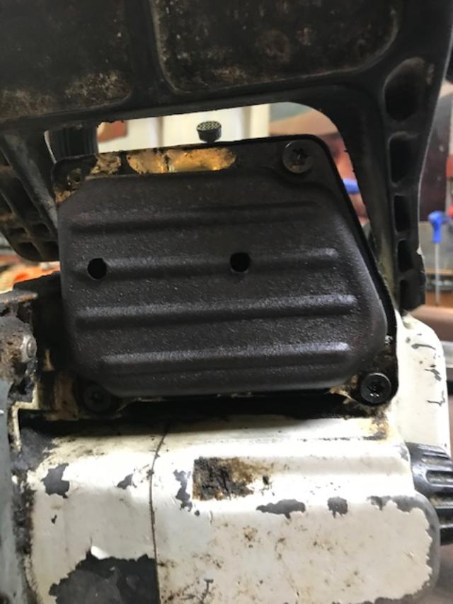

Went ahead and pulled the tube out of muffler and opened up the inside cage too.
Some before and after pics. I put a 20" to test with.
p33022.jpgp33020aa.jpgp33022line.jpgp33022av.jpgp33022afc.jpgp33022b.jpgp330spr.jpgjdbarc.jpgp33022p.jpgp33020a.jpg

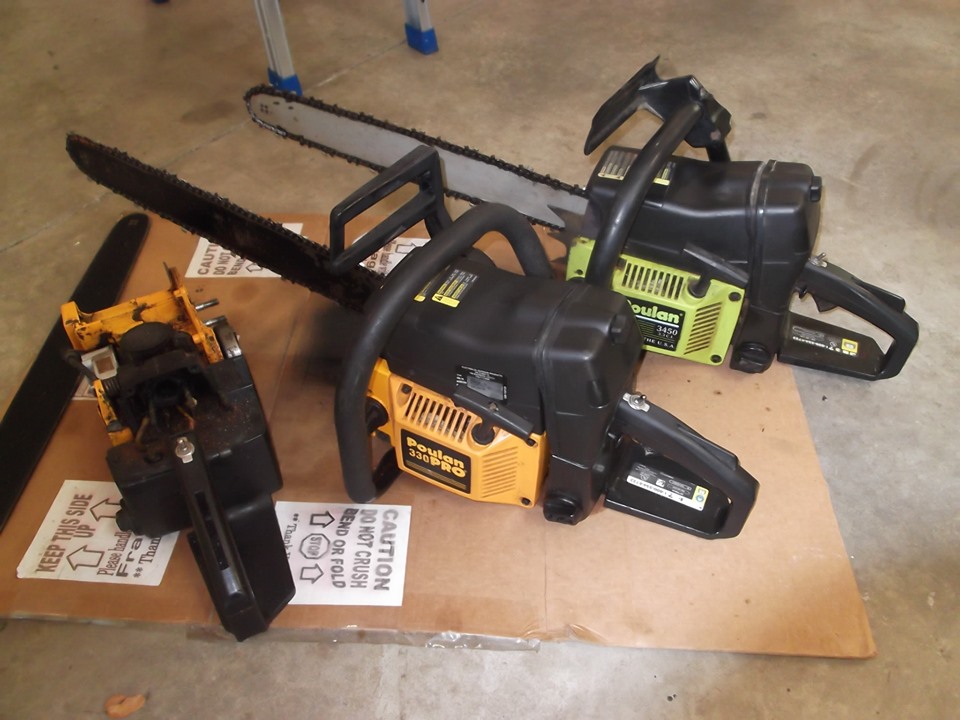

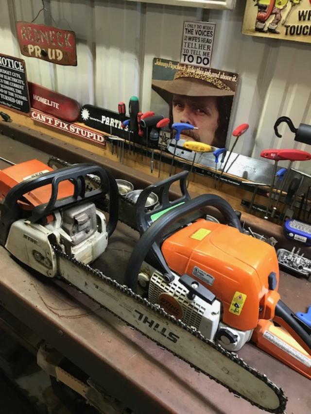

Put the 1999 3450 and 2007 330 side by side for someone on CRG
Local coming by to try both out sometime so both set up with 20".
/ Just another junk chainsaw #649
View attachment 614296View attachment 614297
Very nice work. My favorite saw is still my Homelite Super EZ AO. Bought it new in late 70s and still runs like a dream. Getting harder to find those funky friction clutches.

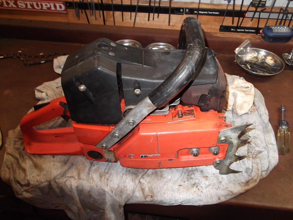

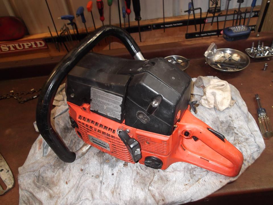

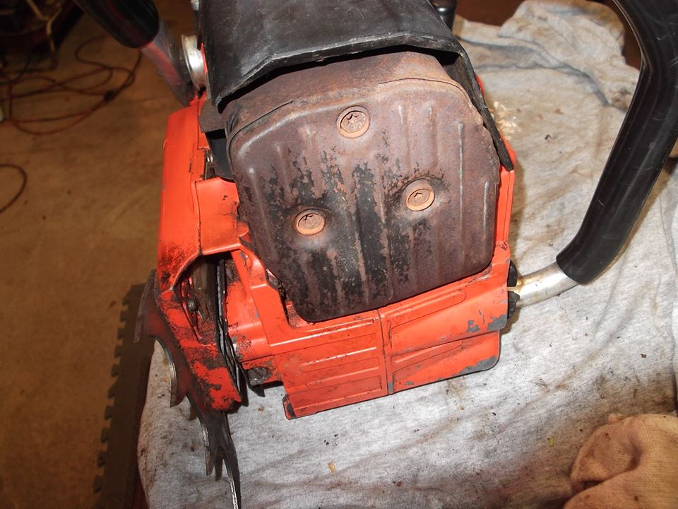

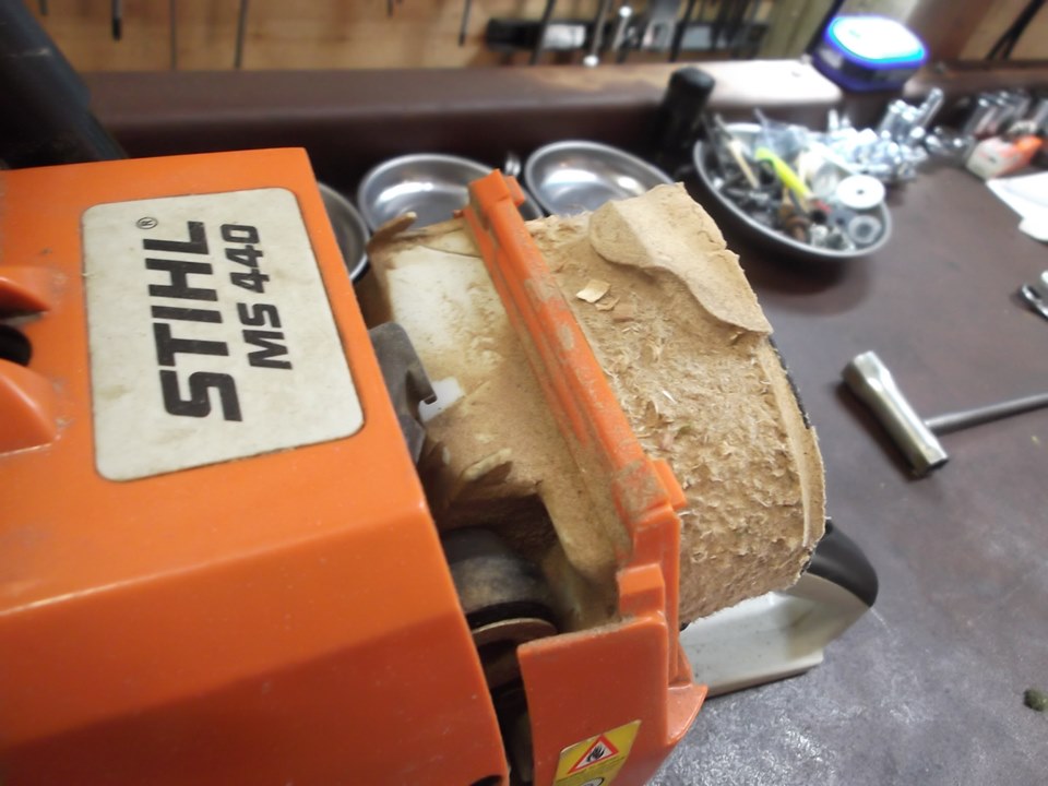

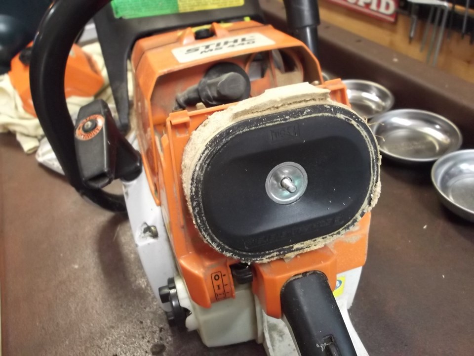

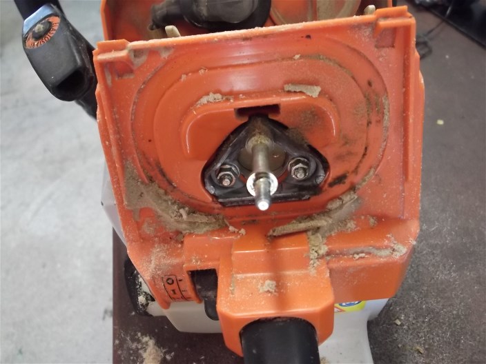

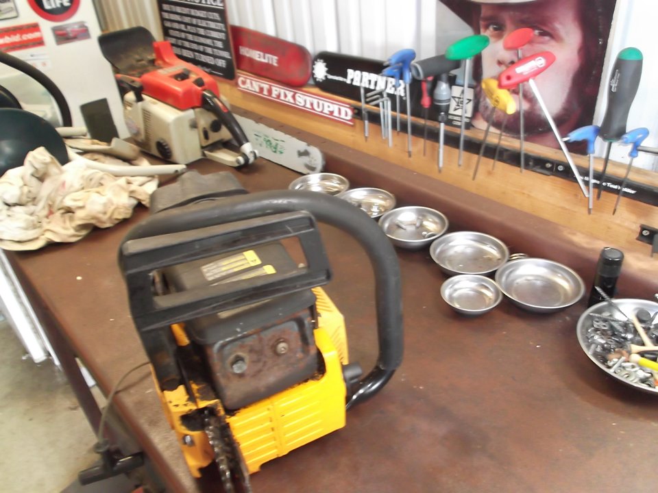

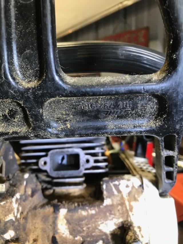

Firewood cutters saw on bench. :( Lot in carb throat too.
#654
Yikes! I am surprised it ran long enough to get that plugged. If it is the carb, then there is the reason, punctured or not put on right and the saw was ingesting sawdust.
Just fines in the carb. Just typical stihl HD filters doing a so so job and owner running a dull chain.
I think it gets by the base matting surface a tad. This is one of the ones that didnt come with the rubber gasket built into the base itself.
Think I have a pic from 2016 here somewhere.

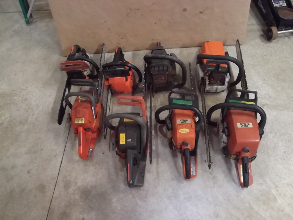

More junk lined up to go through. :licking: Dont care what the brand they all pay the same. :D:moneybag::dollarsign:
MS211 wasnt in pic. Came in first.

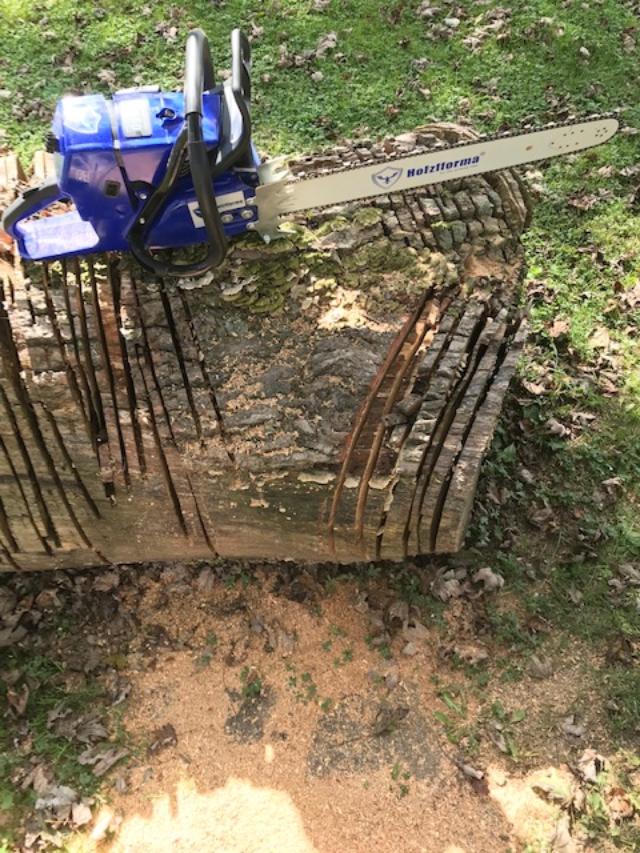

Testing out one of those 660 clones.
I sprayed mix in the cylinder while plug was pulled to lube things up before pulling over. Just dont like the idea of dry on dry.
Just tested and tuned before and during cuts.
I did pull and put my own sparkplug in it.
Cuts as should and works as should. Was actually impressed with it for stock saw. Even got her set fat for now.
Cant tell any difference in it and the last used stihl 660 I sold in the cuts.
I even liked that stock chain they sent with it out of the box.
Sugi copied bar.
24" buried dry ash

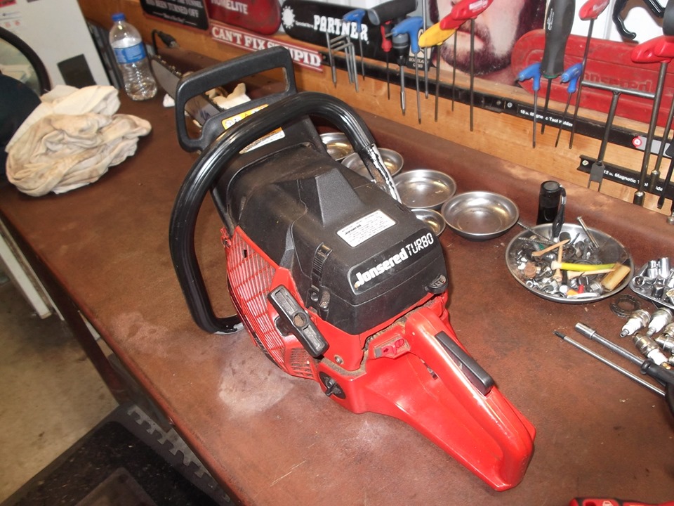

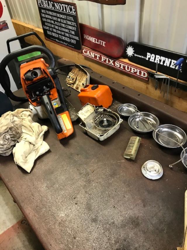

Guys 038. OK now I see the problem why it wont run. :p

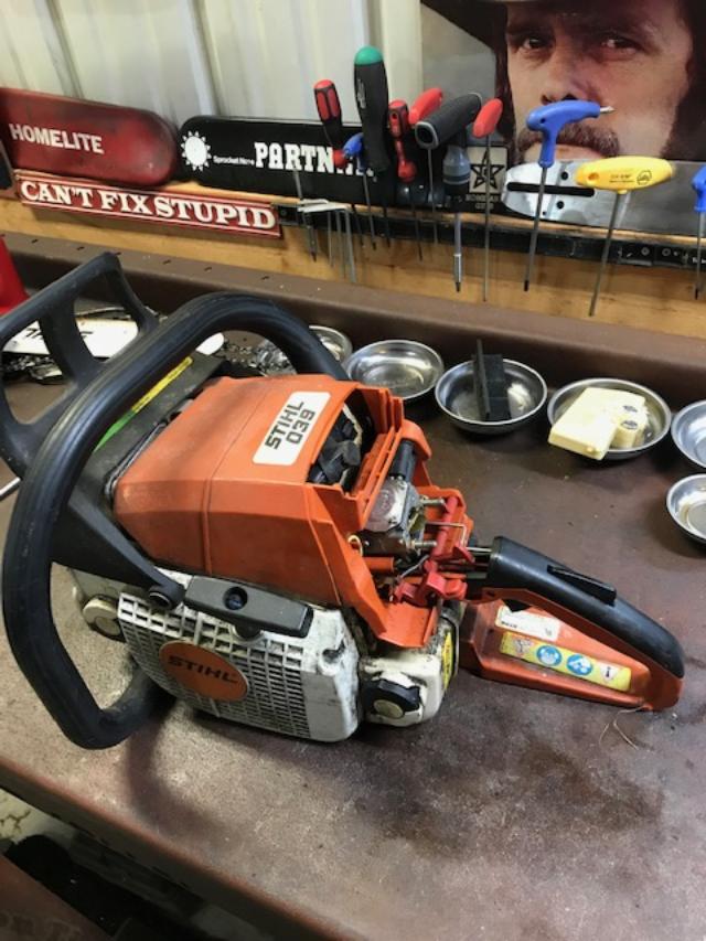

:confused3: The stuff that comes in and what all is wrong with them. Amazing.
036 just 2 things of many. :confused2:
250 wasnt to bad. Surprised.
