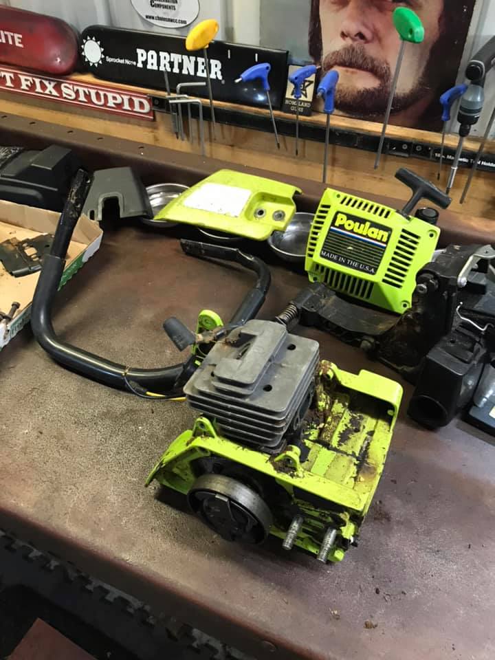

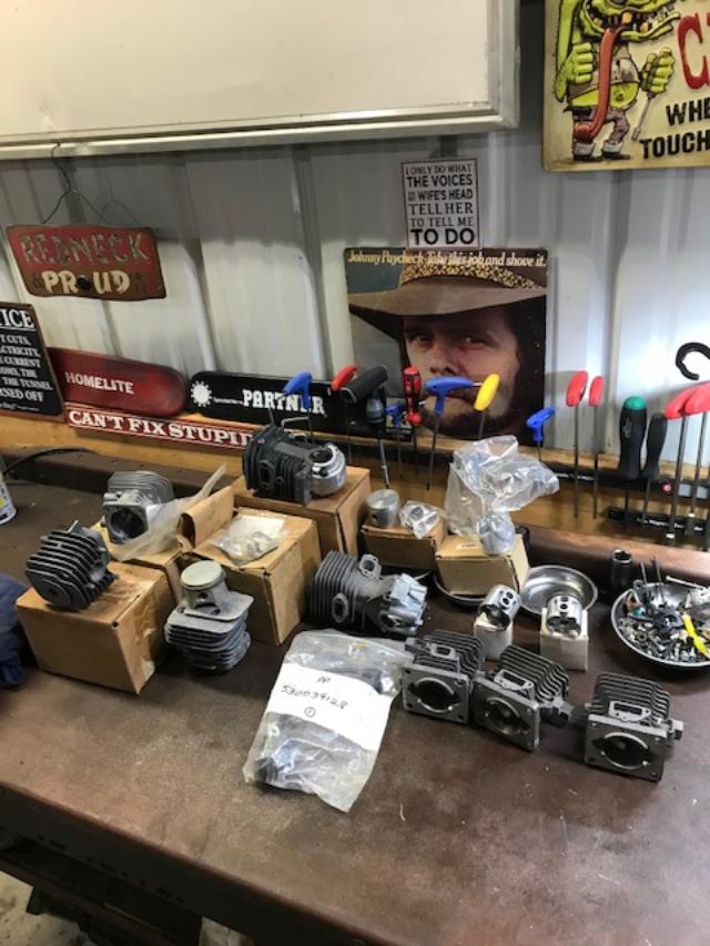

Yesterday trying to figure out what all this NOS Poulan Pioneer Partner stuff went to. Had a good idea. Today all solved.
Lot of it will go to help folks restore. Just some of the poulan I use.
Oh some weird jred 370 nos cyl too.
If you do P26 P28 I have cylinders and pistons. 1 piston no ring.
P65 P55 P70 7000 etc I have a 650 cylinder, base gasket, piston kit.
PP114 poulan pole saw nos cyl, PP295 2750 cylinder and piston.
Jred 370 cyl.
Just keeping the 54cc poulan stuff.

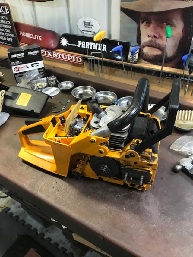

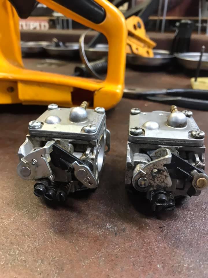

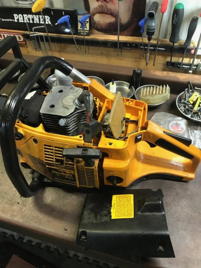

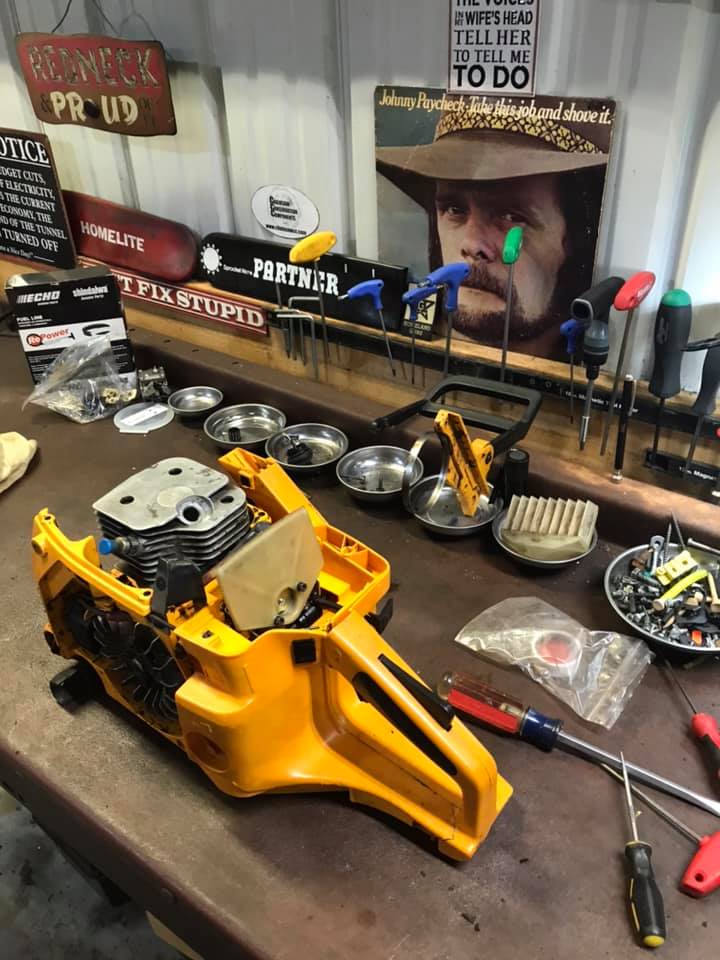

Piecing a 83cc together from parts off the shelves. 54mm bore.
Had a issue with the WJ carb I started to use. But noticed choke wouldnt close. First time running into this on this series of saws. Seen the culprit and why. :(

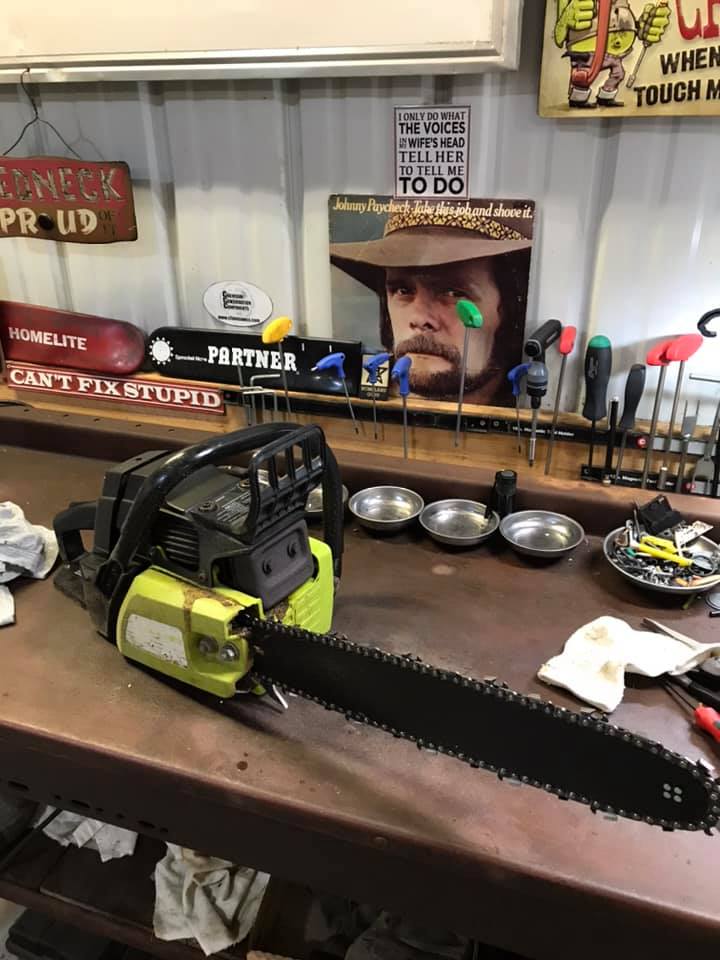

#689
What brand is the yellow one?
Partner design made in the husky plant. Sold under names of Poulan which mine is. Then in red Jonsered and also yellow Partner.
This is a 83cc one. Poulan had them in 65cc 71cc 77cc 83cc mid 90's to 2000

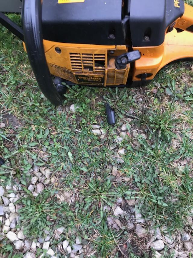

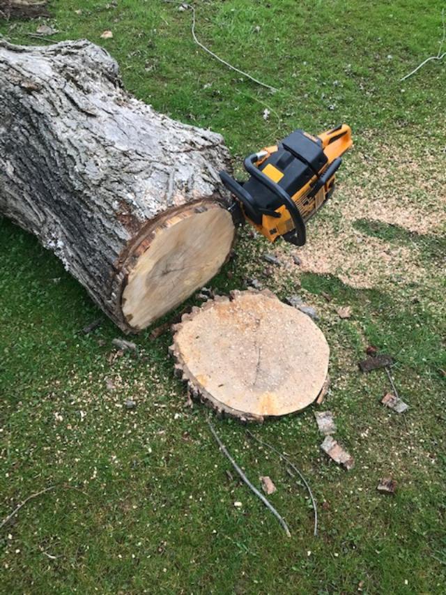

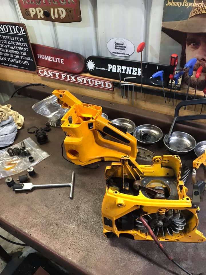

pp505z.jpgpp505zz.jpgpp505zzz.jpgpp505zzzz.jpgpp505zhandlebrokenodecomp.jpgp505zres.jpgpp505zcuts.jpg

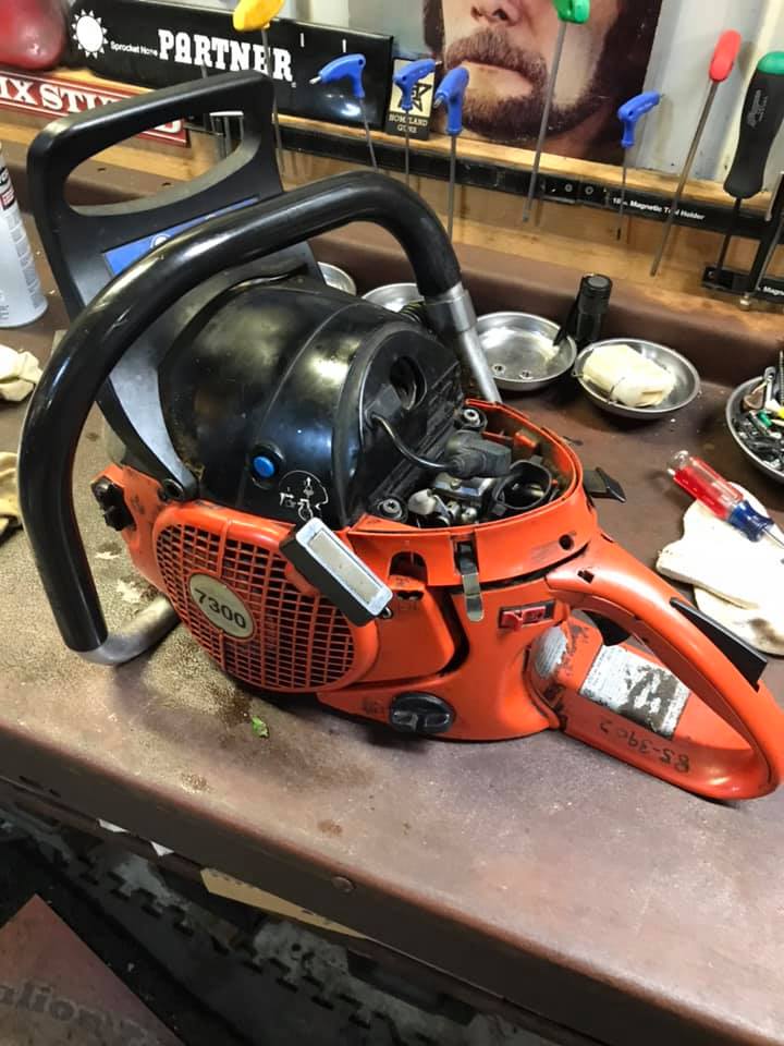

#690

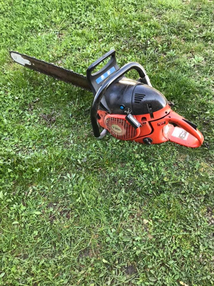

Dolmar 7300 in back firing. Aka sheared key.
Dont need a key way and molded in flywheel on these anyway. Cleaned both sides good. Line up tighten. I reset coil gap as it was to tight IMHO. Fired off running good.

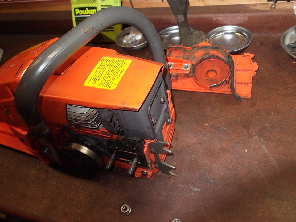

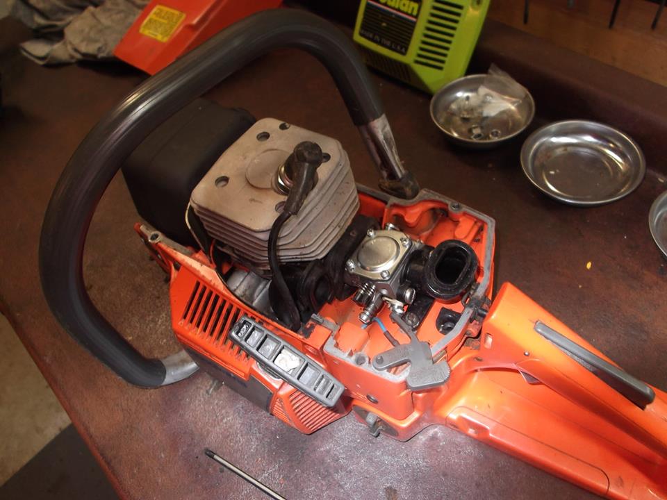

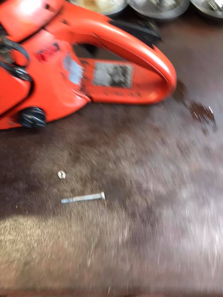

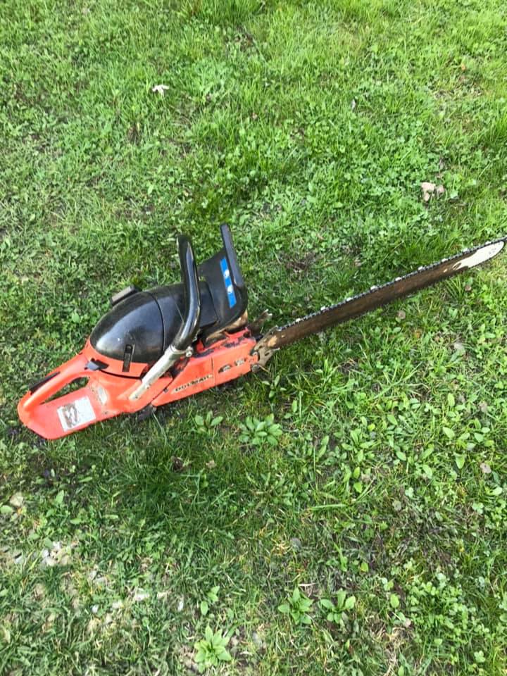

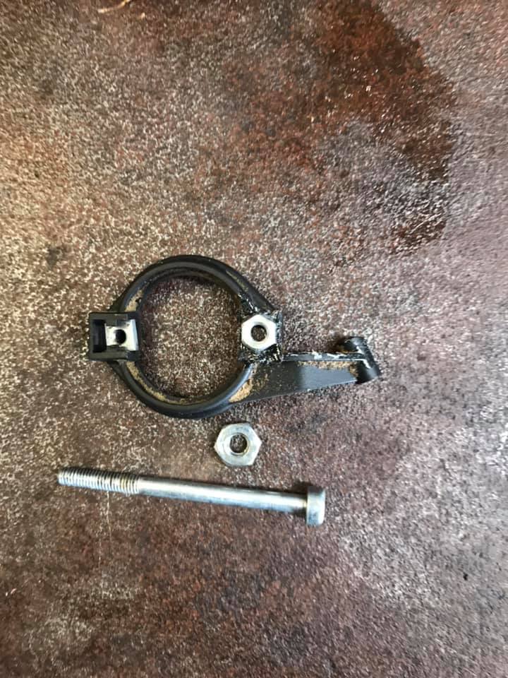

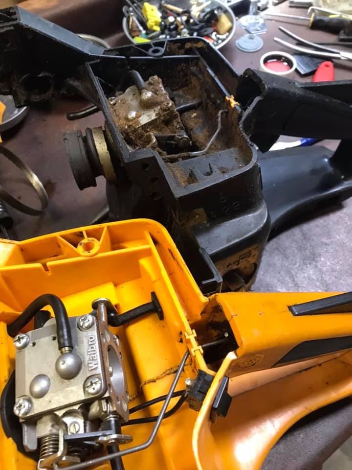

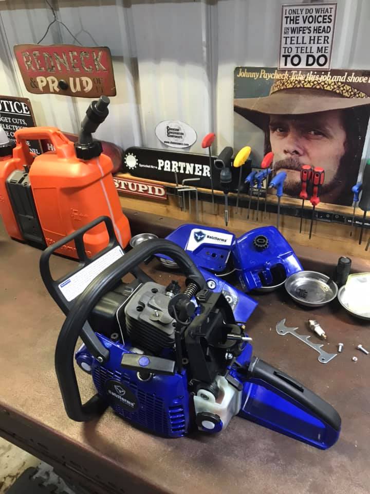

Had more issues.
Test cutting and wont go full throttle.
New boot was installed at a shop. The dang flange is broke and someone tried using a wrong size nut and basically slides onto the carb bolt. So only 1 side was even securing the carb.
So got it torn apart with a new little bolt that fits the carb bolt and trying to redneck it into the flange.
Carb was full of fines on both sides too. Dont appear to been apart for a long time. Might need a carb kit too.
Least the H side limiter is now grinded off.
The nut you could basically slide on the carb bolt. New nut one that least goes on right.
Redneck fix for the win. Test cut with 24 full skip and 8t. I would do a 7t myself.

Had more issues.

No mods, only a 73...with a 24"bar....even skip....yup....go woth 7-pin.
I didnt step up to 8-pin til 84cc big bore and thats wearing a 20" bar.

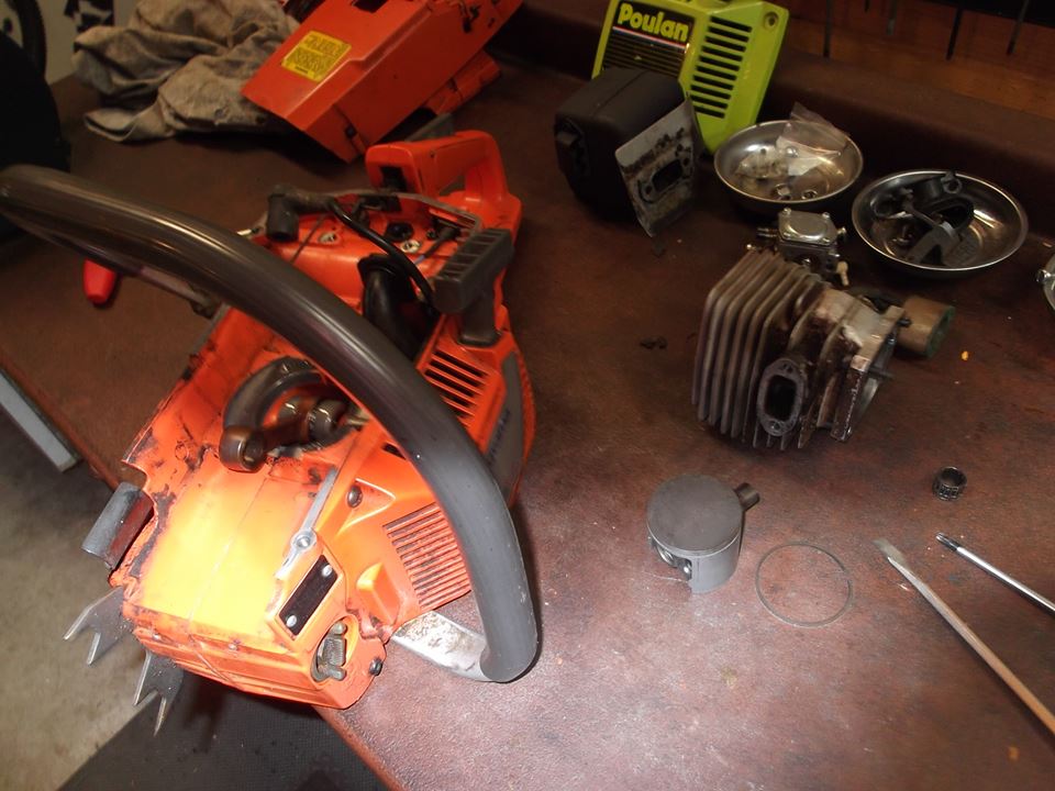

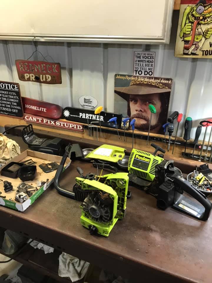

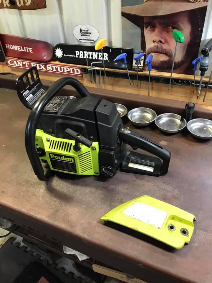

Build from a parts saw. Another 54cc lives. Like these better then the 026 260 saws myself.
Built the same way. Just the poulan has some better ideas on the intake boot and air filter sets etc with a real choke in carb too.

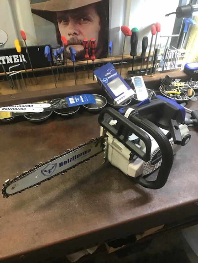

#696

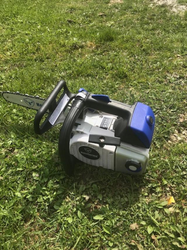

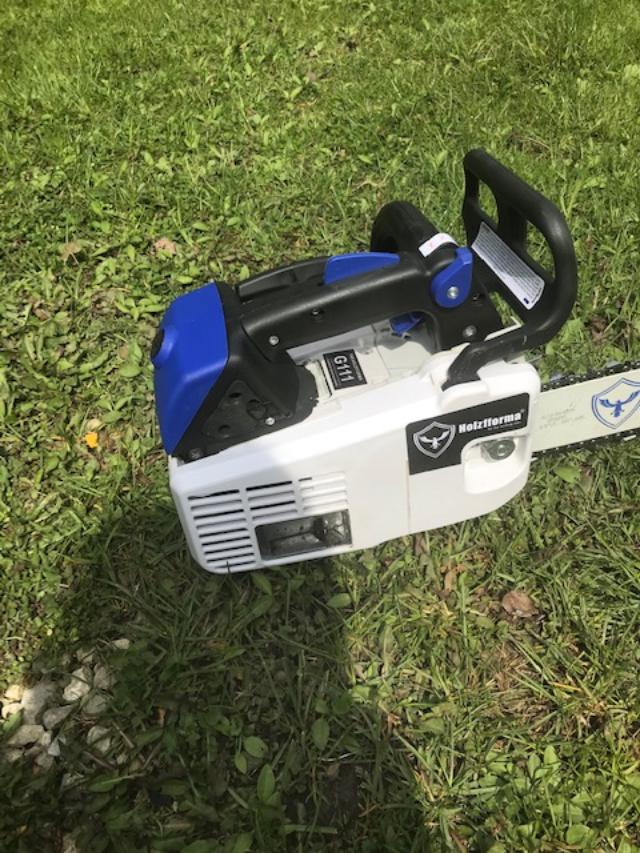

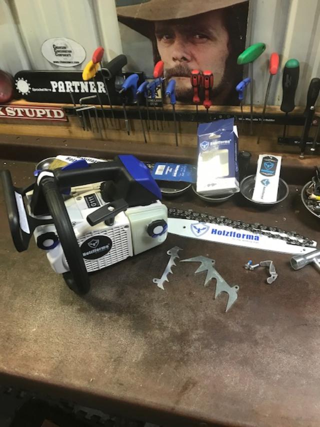

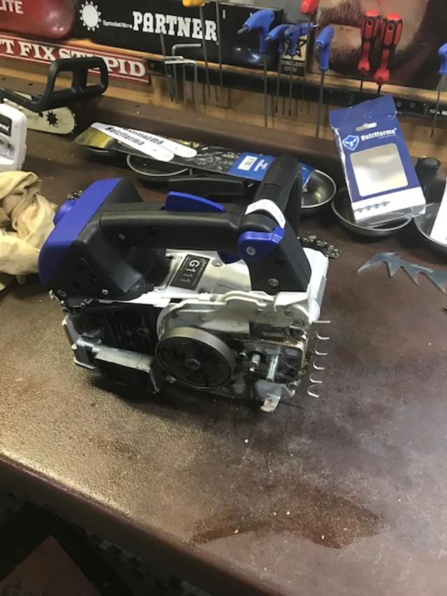

Got me another test unit in. Holzfforma G111 top handle which is a copy of the stihl 200T.
This one is marked Generation 3.
First thing I did was pull that muffler screen like I did on the oem too. Sounds just like it and cuts like it too.
Starting 2nd tank and used almost a full tank of bar oil too to tank of mix. Lunch time being I missed it.
It reminds me of my 200 I owned in the cuts. Time will tell.
Easy to start, cant recall but swear easier then my old oem 200.
I go 40:1 and tuned to my mix and turned it up a tad but still fat for a 200 111.
/ Just another junk chainsaw #697

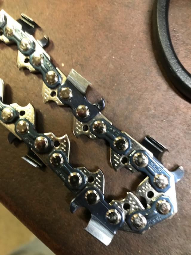

Interesting tests. What's your take on their bars and chains?
#698

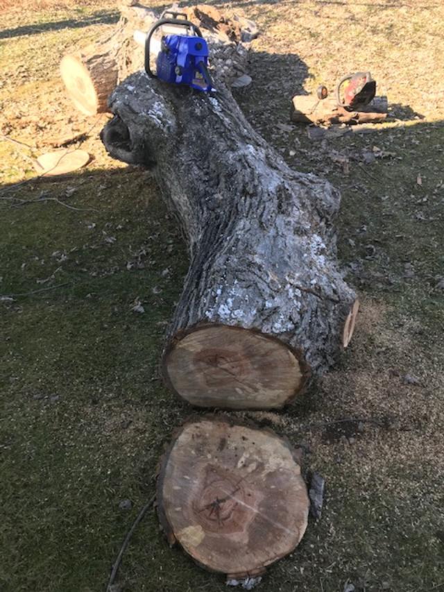

Chains has been great. All I got is 3/8 and 3/8LP full chisel though.
Bars for my uses have been good so far. But just bucking cuts here like a firewood cutter would use mostly.
Now guys that do alot of bore cutting go through tips just like any aftermarket bar I have seen on my chainsaw repair group.
Just remember they are aftermarket bars.

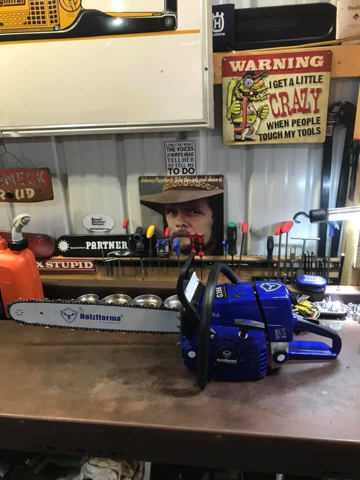

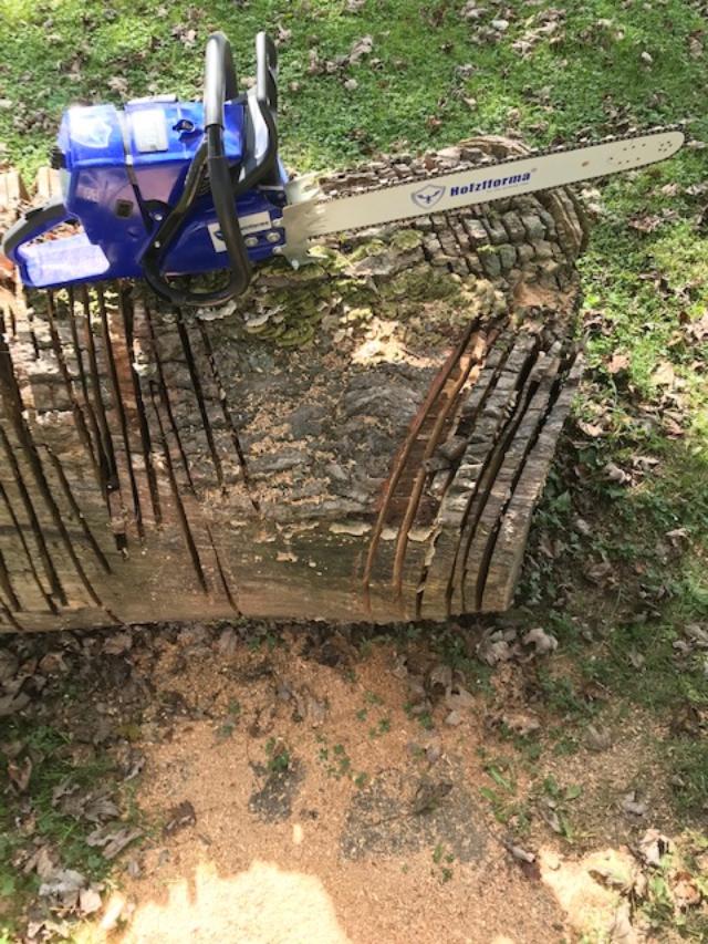

Since I liked my stihl 036 360 and the stihl 361 saws back when I owned them.
Plus no longer made and like the older stuff better with regular carbs still.
This time I am trying out a G366 which is a copy of the 361.
Feels like and cuts just like what I remember.
