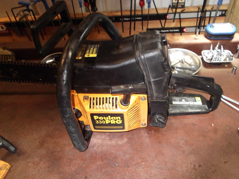

Poulan 2300cva 38cc that original owner gave to a friend of mine.
Came in no start. Had to laugh when I seen the oregon fuel line pinched in 2 places and the dirt in the tank and fuel filter off. Carb kit, new tygon LP1200 fuel line.
Pulled those epa stops for carb tuning. Seems good to go after test cutting.
Will be a back up saw to his 440 310 when needed.

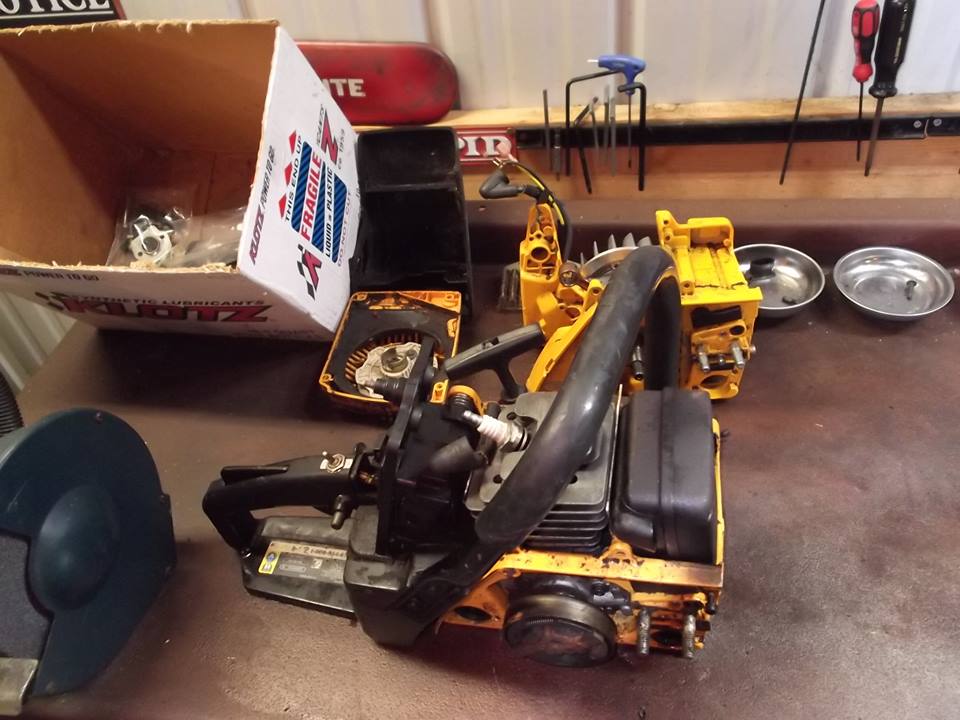

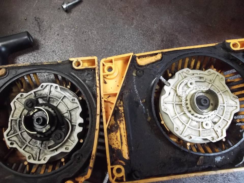

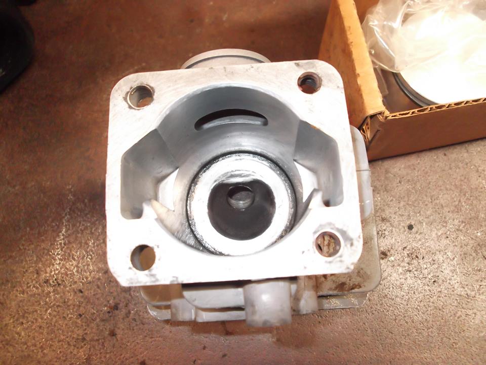

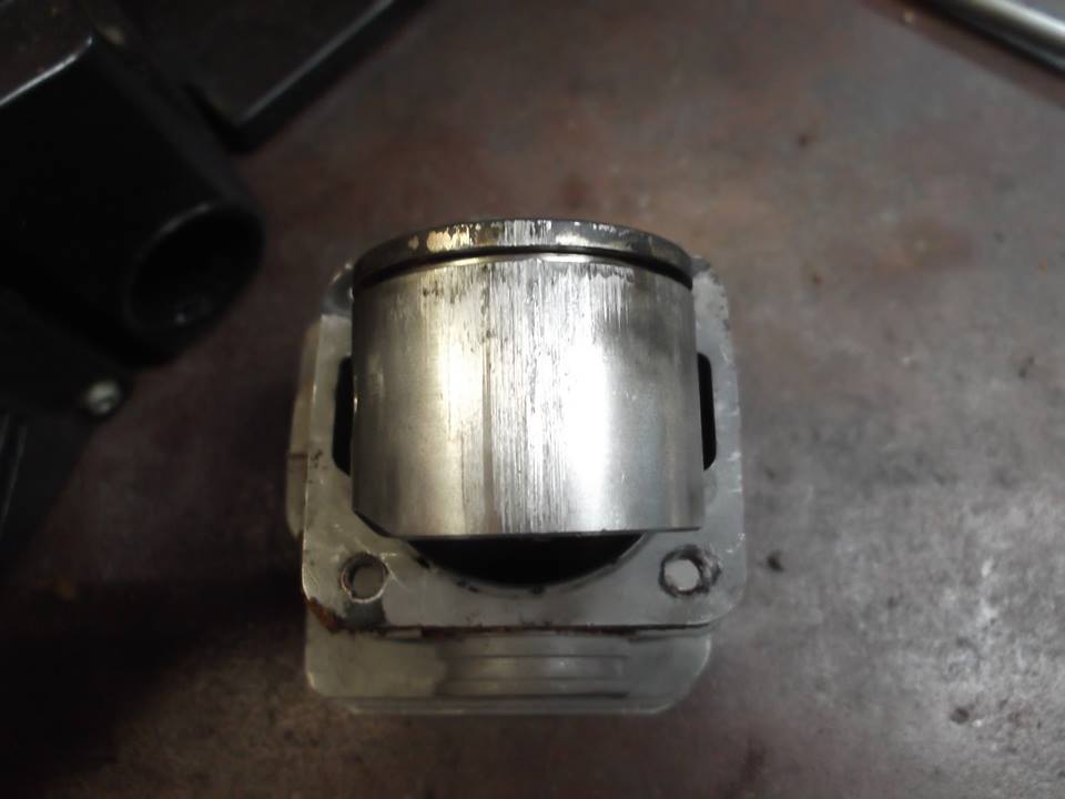

I grabbed one of the projects I bought over the last few years. Since it seems everyone wants a runner not a project to do themselves.

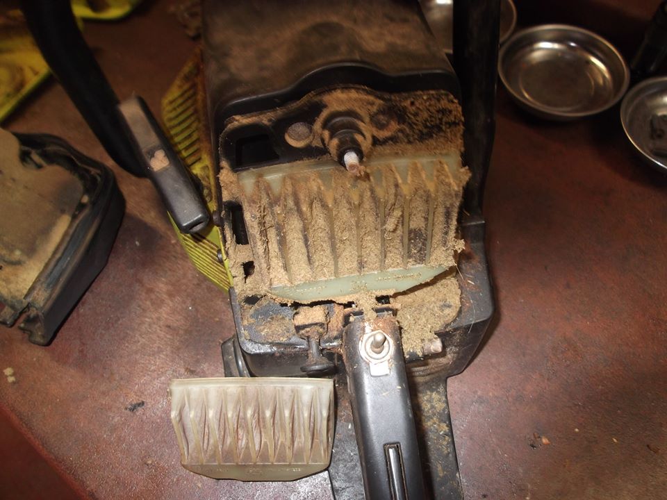

I was told this one was a runner when I bought it PHO. Dang it was, after a quick check over 😲. Took alot of air and brushing to get some of the jammed packed chips everywhere. One of those saws that must have never been cleaned. I even left the old fuel line and impulse line as they looked ok to test with. 1999 Poulan 3450 54cc
I even dug through my parts and found 1 3750 380 60cc OEM used piston and cylinder kit.
IMO I wouldnt change it from the 54cc being it cut so dang good just now in some dry ash with 16" 3/8 buried. With that big dawg maybe 14" cutting.
Pulled them dang epa stops too while tuning. Piston looked like they had been running old mix over the years. Think the batch I am running now is VP racing 40:1 e-free 90. Wondering how long to see if it is cleaning it up.
Some wrong fasteners but I dont give a rip about such things myself.
Check out how packed the pleats were on that air filter. One good thing. The air filter and mating surface did its job, no fines in carb throat. Unlike the new saws that let fines by.
