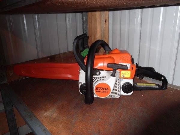

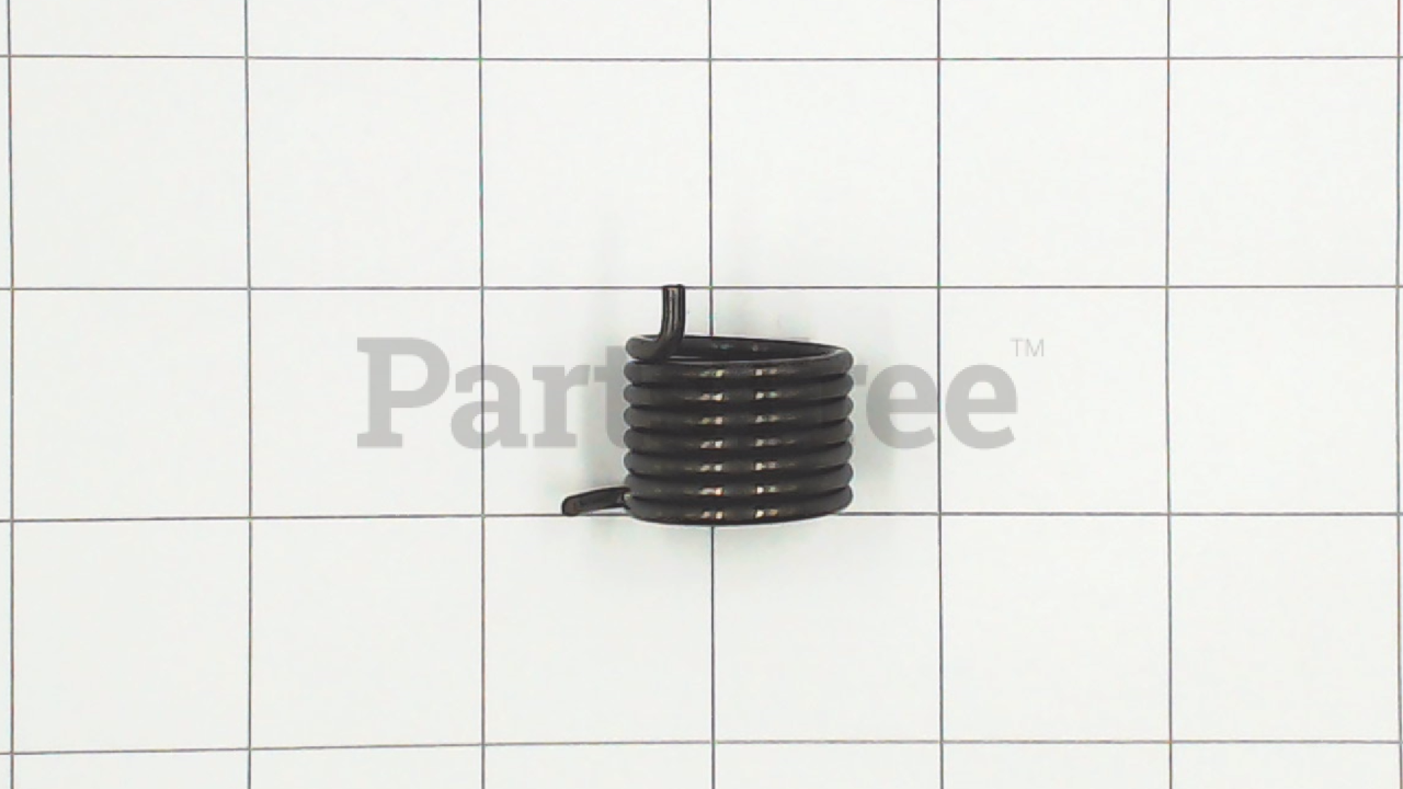

Update: Well off to either do another easy start saw.
Stihl rescue D handle made it nice for his hand. But the spring assist spring just stops him mid pull. Due to shoulder. On the echo 3510
So I got his easy start 180 and he could start it right up.
The stihl version is 100% easier to start.
So bringing it back home and going to sell it and get him another easy start for back up. 180 210 250.
It will have stock handle back on it by then.
He said he thinking a bigger battery saw but don’t want weight over the echo 3510 stihl 180.
Least now I know the difference for sure.
Spring assist don’t make it easy.
Like the system used in stihl.
I’m a believer in that system now seeing it side by side with him trying them in front of me.
Then I done both. No comparison.

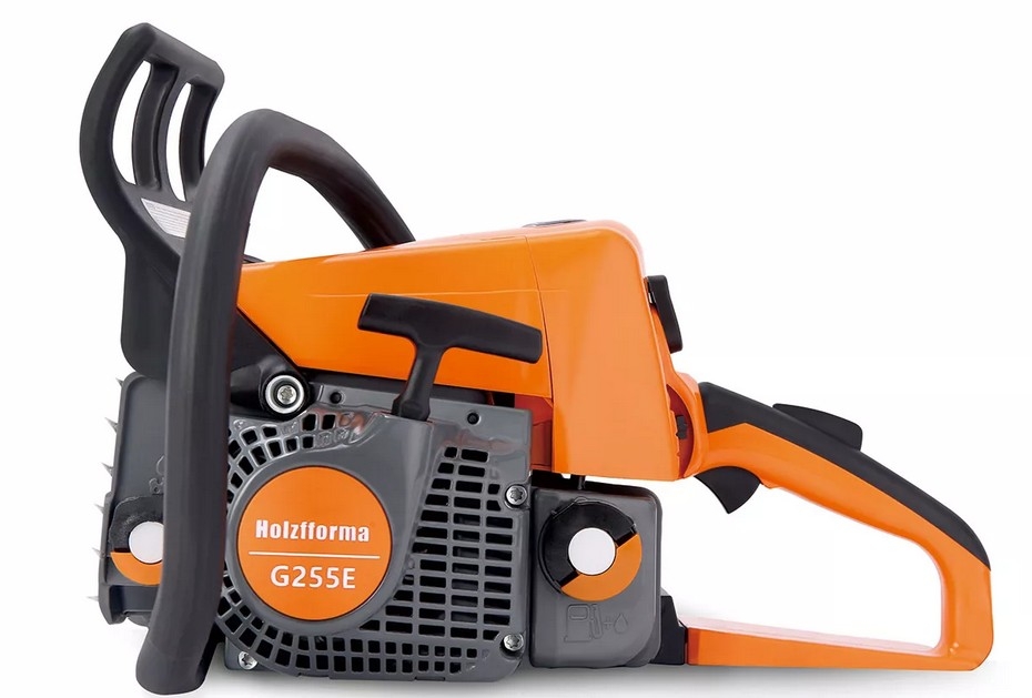

The Farmertec G255E easy start version does not work like the OEM 250 one.
It works just like the one on the 180 easy start etc.
Had a owner of one check for me.
It dont catch with short pulls and wind up like MS250 ES one. Has to be one long pull like 180 ES etc.
They had them on black Friday sale for $118 shipped from their NJ warehouse. He bought one to try out.

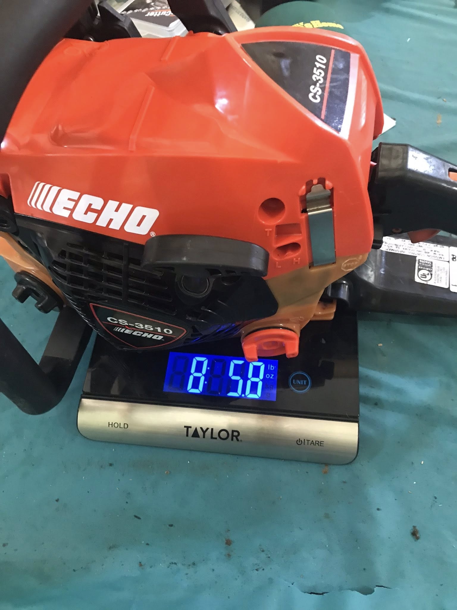

#2,695
Echo 3510. Bought this for dad as a back up saw to his easy start 180 I gave him years ago. The spring assit echo is not as easy to pull over as the easy start saws.
Whole deal here in this thread. https://chainsawrepair.createaforum.com/echo/echo-3510-3410-352/
Like new 14" bar chain set up.
New oem carb kit. Tuned and ready to cut with in my area. To 40:1 VPracing and Efree gas.
Tune could change in your area if shipped.
$150 plus shipping. In Ohio.
If online sale Paypal friends family or local pick up can be cash or whatever.
Prefer to ship after the crazy shipping time going on now. Jan or after is better IMHO.

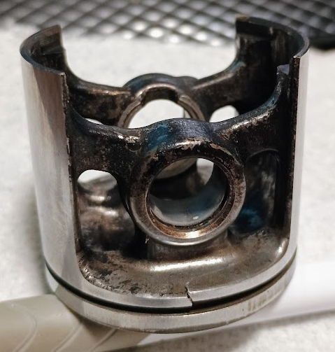

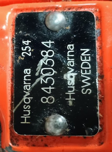

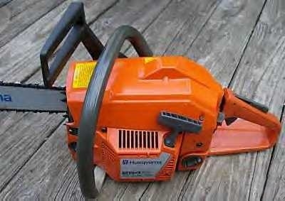

SIL bought a non running Husq. 254 that 'ran when parked' for $100 with a never used 20" bar and chain. It apparently sat for a couple years so figured the carb was gummed up. He couldn't start it so got me to have a gander, zero compression, nothing so figured the cylinder/piston would be scored to death, nope lot of regular engine oil was in the cylinder tho so some one was trying to up compression. I figured the piston would have an access hole in the top when I took it apart, nope, busted ring land. Dunno how you'd ever bust that unless it did a good backfire on the wrong stroke or bad casting maybe.
The cylinder doesn't have a scratch in it, looks like brand new so I don't think it was used much for a 41 year old saw. Piston, ring, two circlips and base gasket $50 which was a lot cheaper than I thought
/ Just another junk chainsaw
#2,700
View attachment 4579564 View attachment 4579565

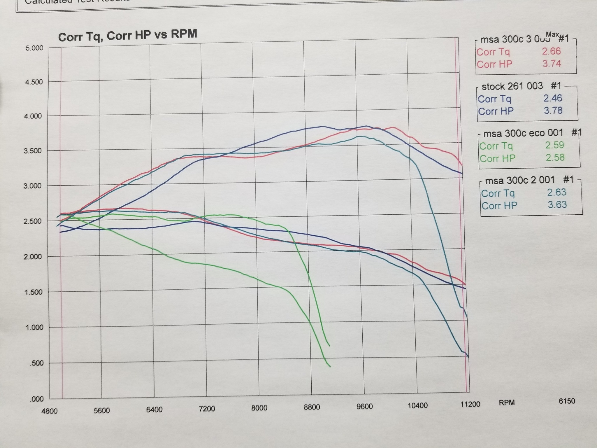

I had a nice 254xp the same time I owned a Poulan 325. Both same cc range. Just different bore stroke arrangements.
Both great firewood saws etc. But guy in great white north liked the 254 way more then me. So off it went.
What I have saved from back in 2008 comparing. -
254xp I owned in 2008 and traded off up to NS
I tested this saw against my Poulan pro 325.
What I took out of owning it and comparing.
What a saw 254xp 45mm 34mm. Runs like the Poulan 325 46mm 32mm, but feels more balanced and nimble in my hands.
Husqvarna 254, Poulan 325 = Partner 5500
