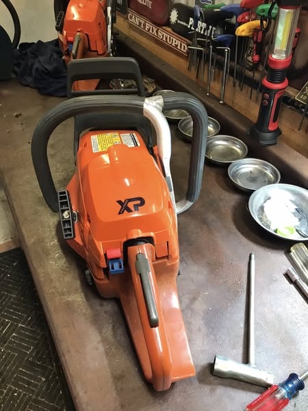

Question.
What Husky would you purchase Today? For Normal Firewood, and Land upkeep. Firewood use around 2 Cord/Year.
Using an 026 now. Perfect size, but sometimes I miss the 034 that it replaced.
4XX?
5XX?
3XX?
There is an upcoming Auction, I might chase 1, or just buy a Chinese 1 from Vevor/Amazon

Now we talking new today or a used runner?

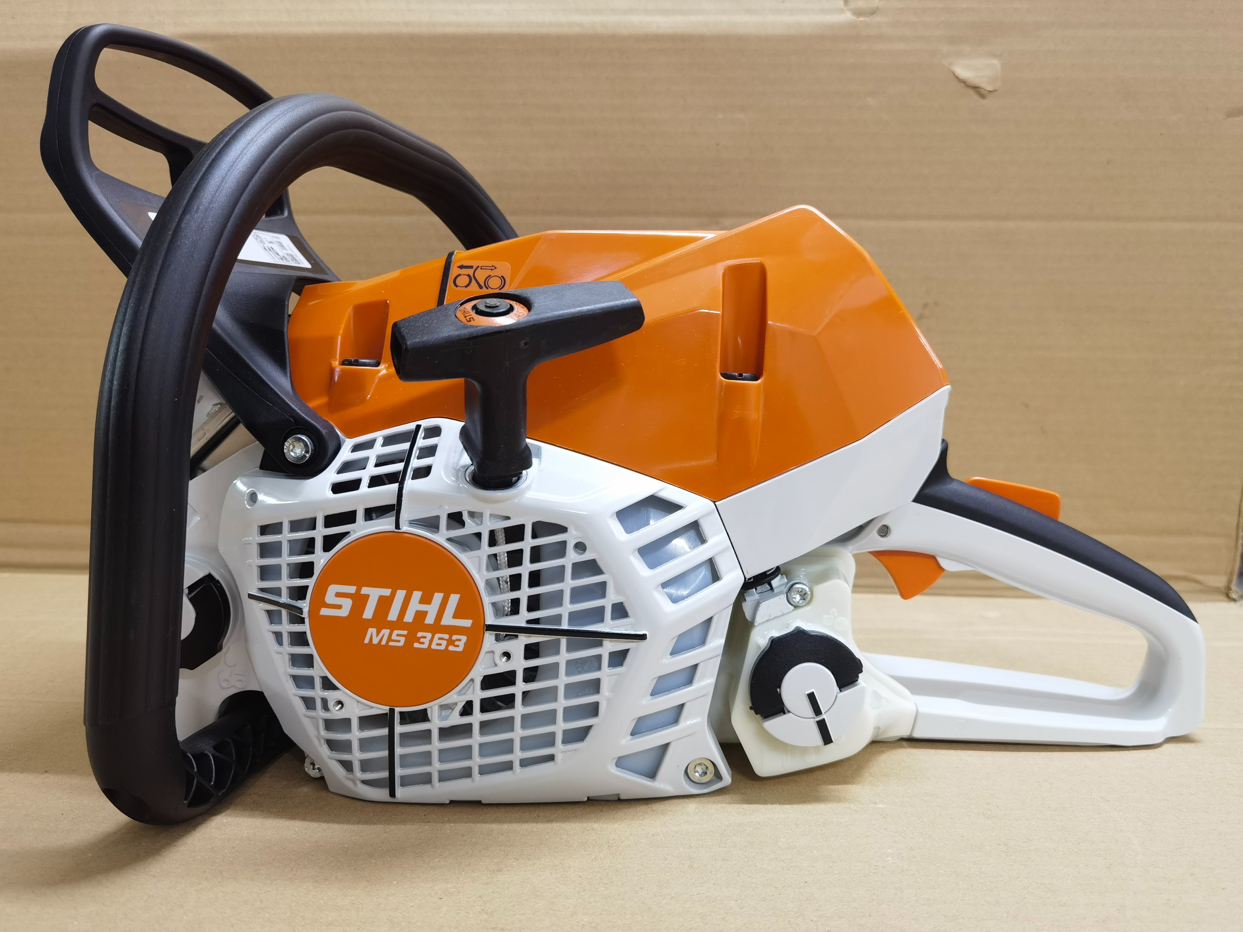

Here is the last list Paveen the honest trusted seller in my group. Pricing of the older saws and some new we cant get here.
Mar 2026 updated pricing for following saws shipped to us from overseas.
UPDATE: I just talked to Paveen and tariffs has effected pricing a tad. So contact him for new pricing options.
Stihl
ms260 brazil 600 usd shipped
ms361 and 382 usd 850
Ms660 nos usd 1,500
070 usd 1,600
ms363 usd 850 shipped
Husky
272 added Feb 2024 USD 1,000 shipped brazil
61 Aug 2023 usd 800 shipped
372xp OE as of July 2023 usd 950
288xp and 390xp usd 1,250
395xp usd 1,350
3120xp usd 1,600
Echo
Cs1201 usd 1,850
Price includes delivery to anywhere in lower 48.
The plane shipping should cost close to 200 alone I would guess anymore.
Where my OE 372 came from ;) Friend bought like 8 of them.

Used I would look 60cc range 036 034 super 360 even a 361 in stihl
357 359 262 in husky
590 620in echo
50cc used 261 Gen2 OE newer
husky 346 NE 353 maybe a mkII 550 but they had crank bearing issue until a certain #
echo 501 or 4910 then 590 620
/ Just another junk chainsaw
#2,877
@Snobdds I posted the updated price list above. Paveen is in my group.
#2,878
New and in US a whole new ball game.
Husky 550 mkII the newest or 562 MKII
Stihl 261 newest Gen or wait for their new one replacing 261 in the 300. Then 400 either NE or OE one.
Echo 501 or 590 620
