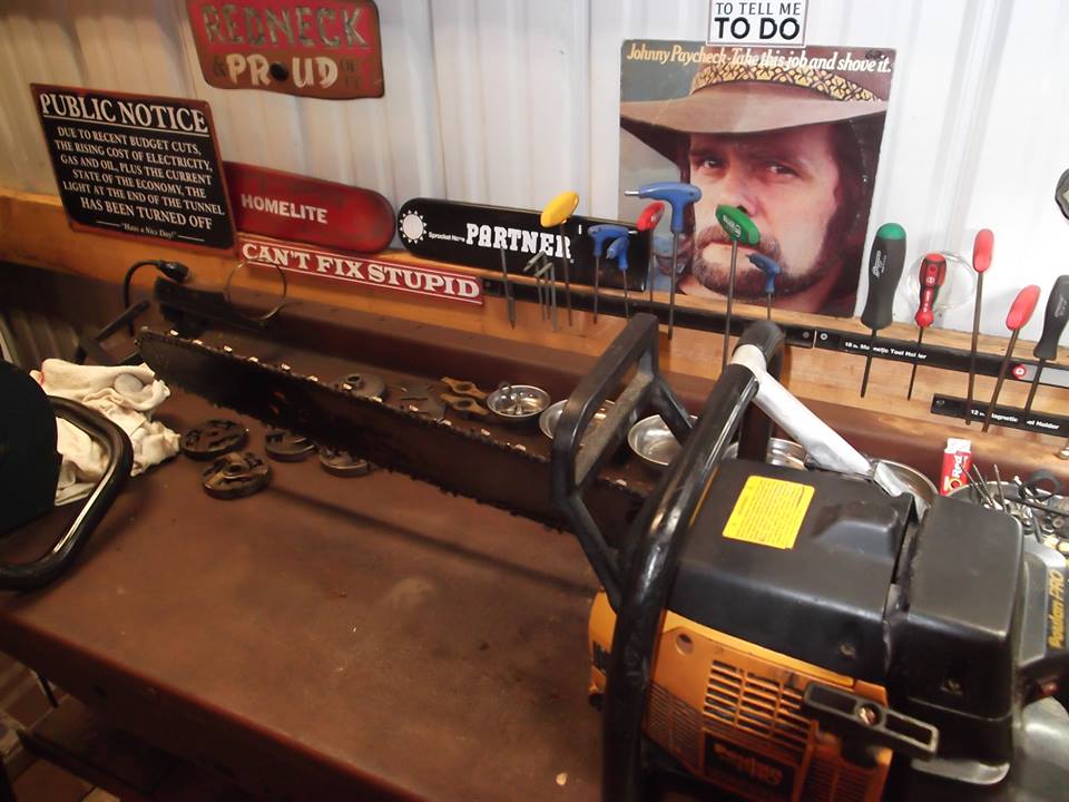

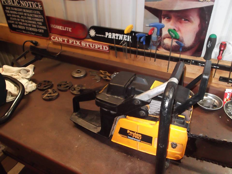

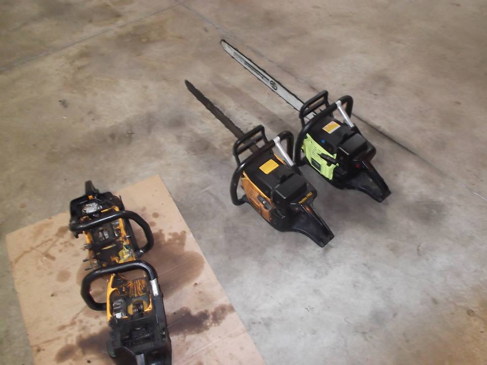

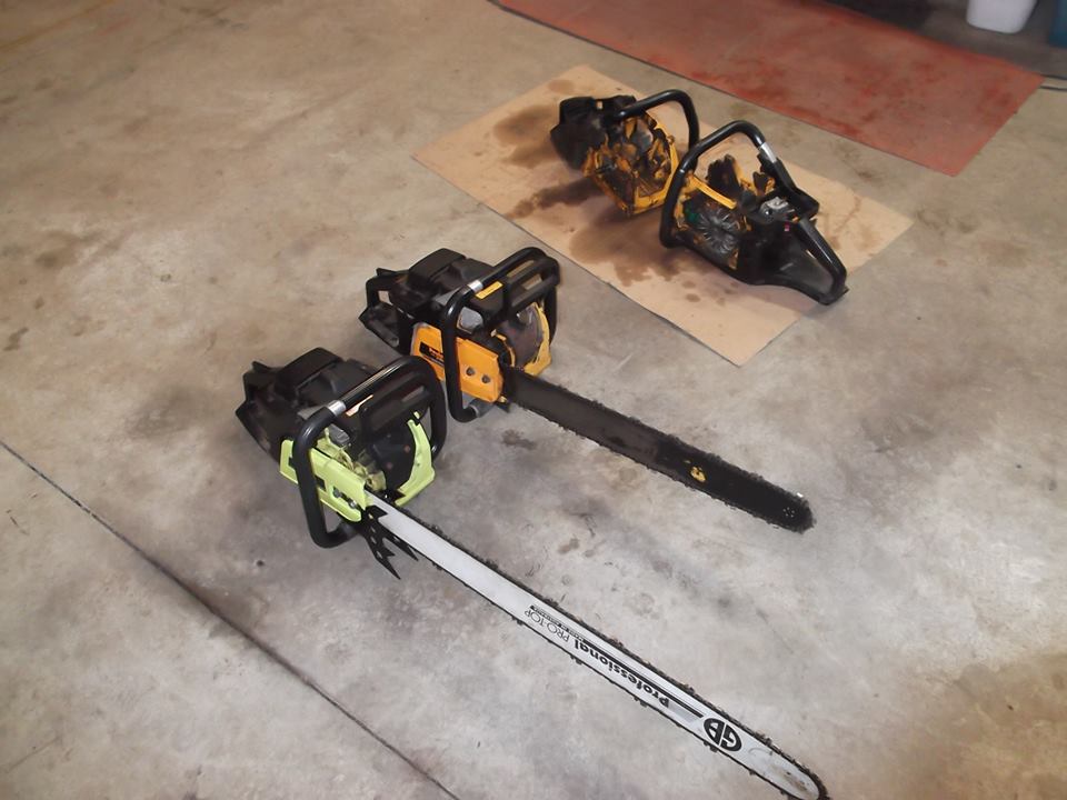

The project 445 70.7cc I used to test the 3 styles of worm gears in worked. Metal and Plastic worm gears from the early and later series.
Being that is over I made the 445 up my way today. Put the original style plastic worm gear in it and installed the other full wrap I bought. Put on a 24" 3/8 84dl oem bar that came on my first 415. Me likes after test cutting.
If you notice it dont have on the west coast big dawgs that are needed for a full wrap. The 415 fire dept saw had full wrap and smooth inner dawg for its uses. So I wanted this one set up like that.
71cc yellow and 83cc green both with full wraps. Like finding hens teeth for these now days.

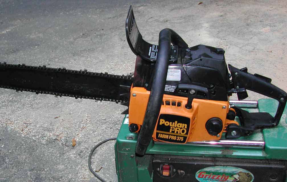

I have this FarmPro 375 (61cc) that I recently refurbed. Runs great. About 1990 vintage, I believe, and it has manual
chain oiler only. I want $200 for it with limited 30d homeowner warranty. The older green Poulans from the 80s are made
better, IMO. But this is a lot of saw for the money.
