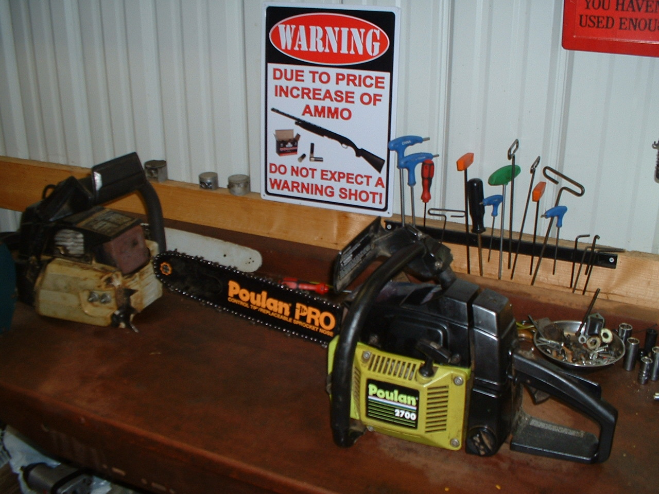

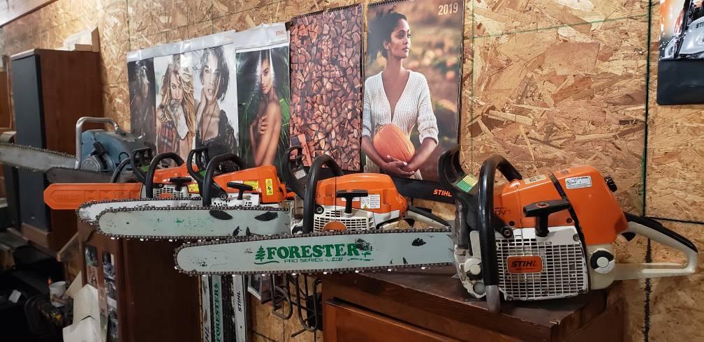

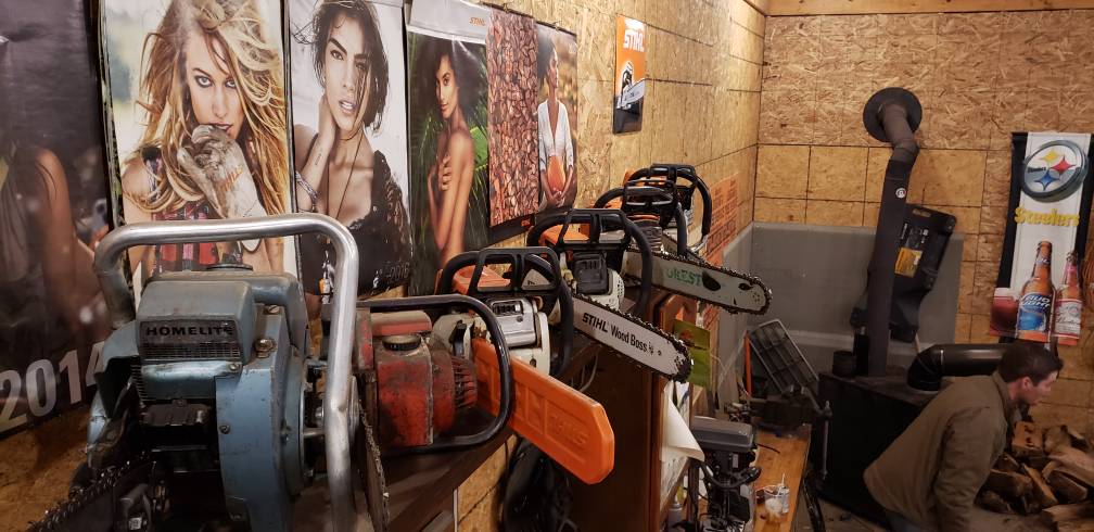

At my buddies shop last night. He's got a nice little collection on the shelf. 20190107_184841.jpeg20190107_184945.jpeg
/ Just another junk chainsaw #528

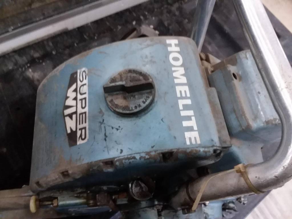

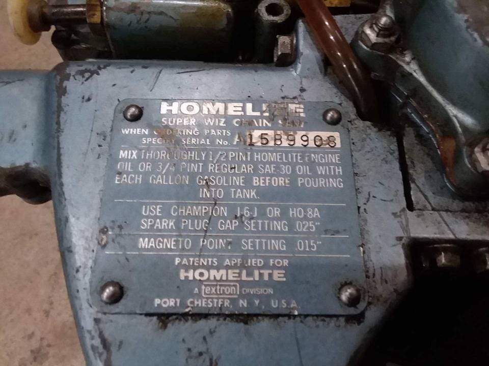

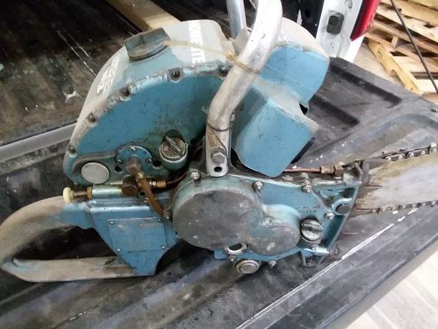

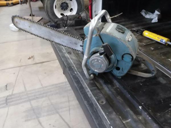

Very nice. Do you know what model Homelite that is on the far end?
I don't, but I'll ask. Interesting that you look at the front and you see the Piston in the hole.... No muffler back then.
/ Just another junk chainsaw #529
I think it's a newer version of an EZ-1, I have one of those stashed at my moms... even got it running at one point :), loud when you can see the piston through the "exhaust diverter". Once I get my shop built I'm going to get all my older and cooler chainsaws hanging on the wall somewhere...

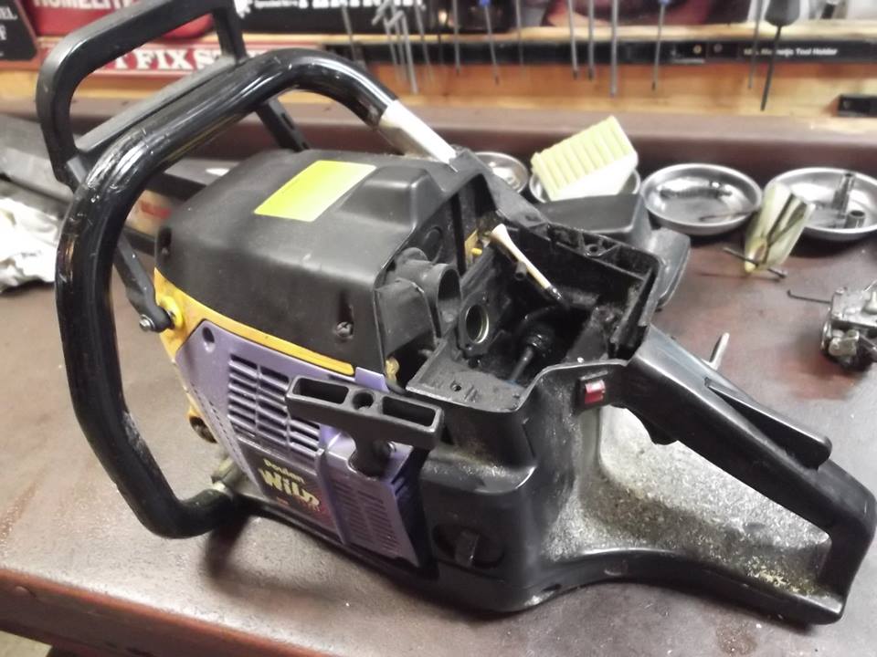

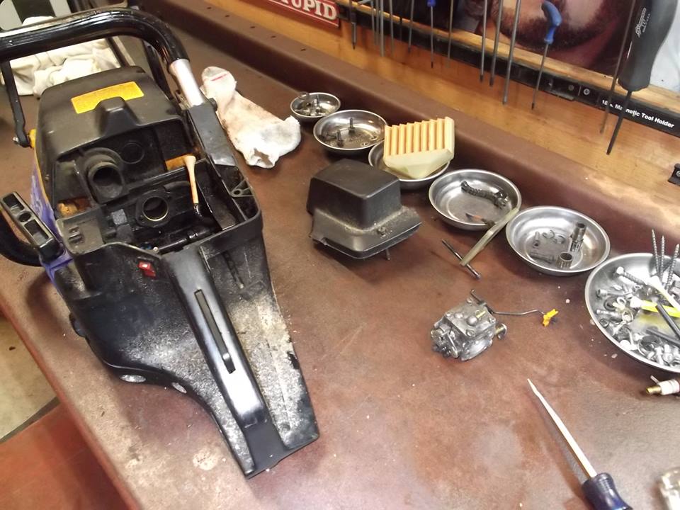

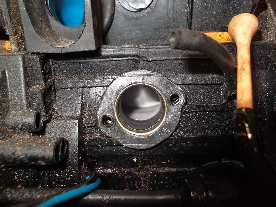

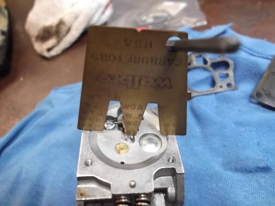

Finished up other folks saws and still felt like working. So rebuilt the carb on my #1 PP445 71cc 50mm that didnt run so good awhile back when compared to the 441.
Also tried to show the walbro tool for setting heights. Also have a zama one. Their cheap, quick and handy.

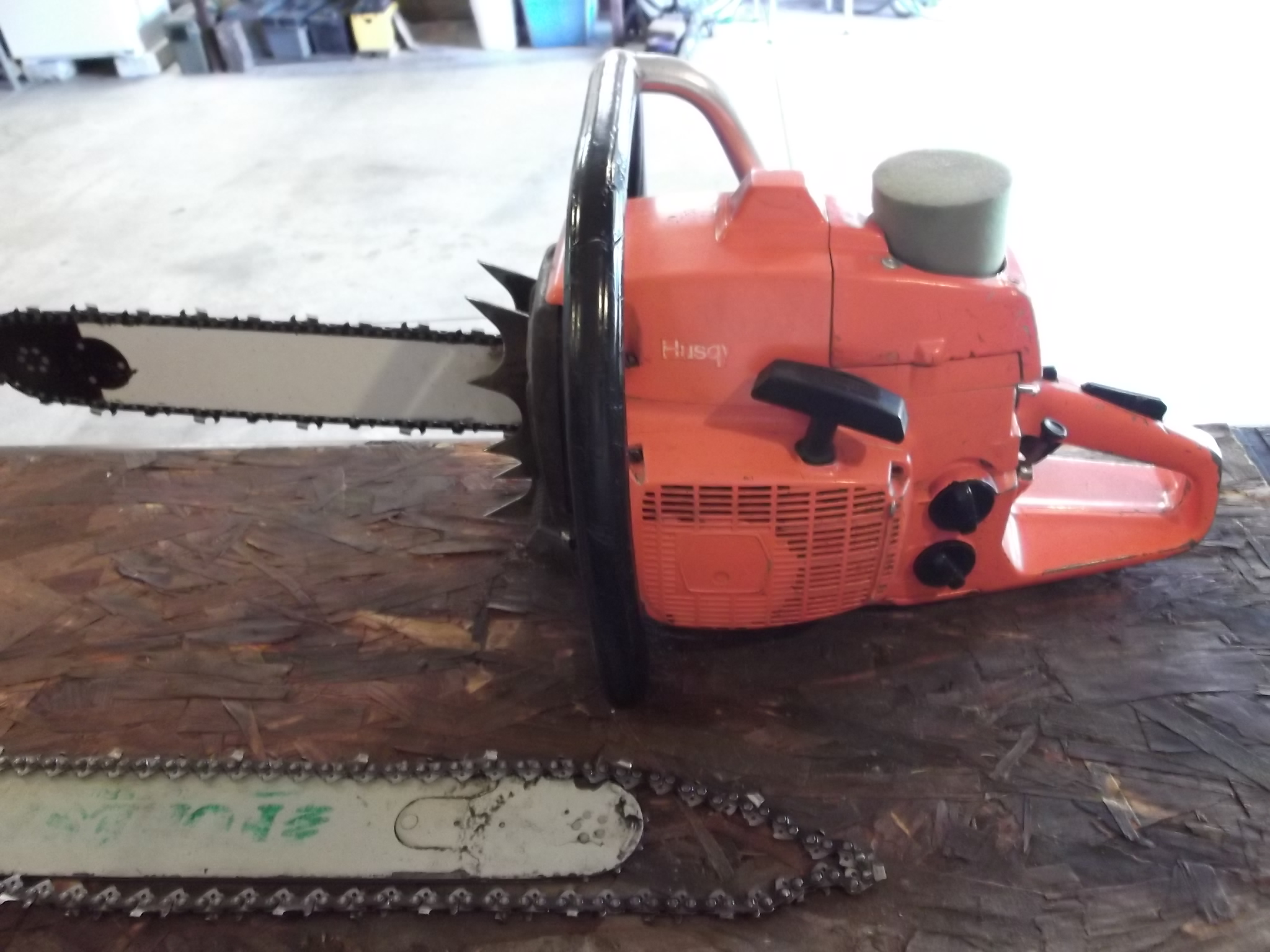

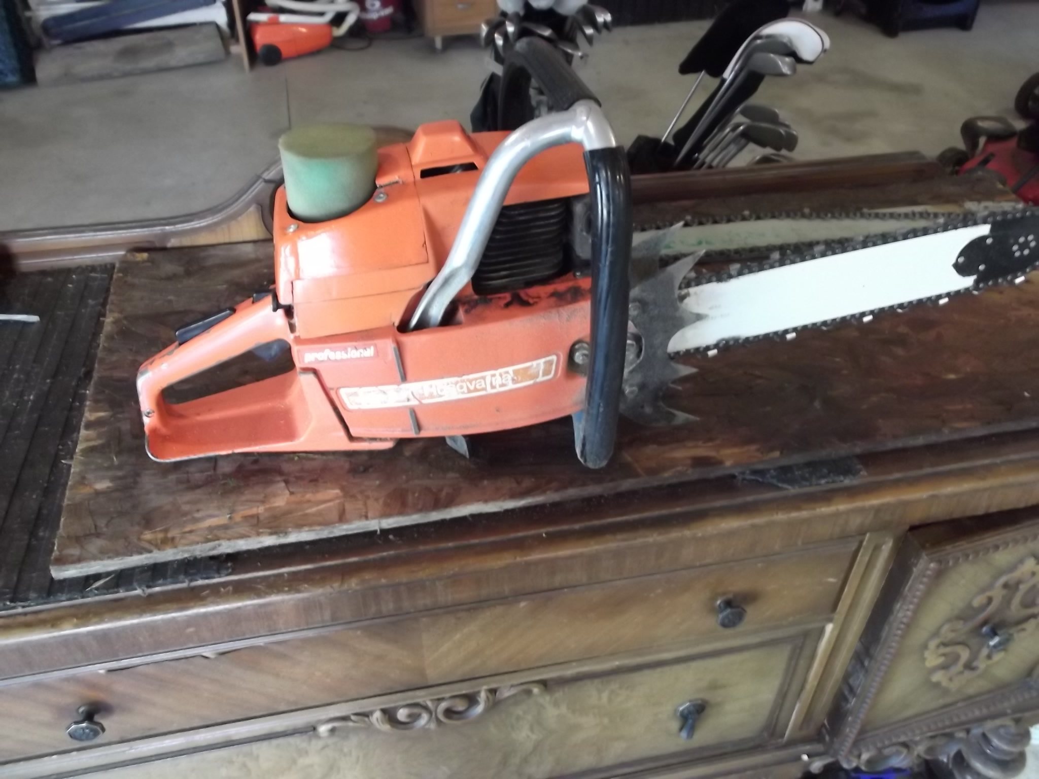

Traded this saw off late 2010. Today I bought it back. Guy said around 5 tanks threw it on new oem topend. :cool:
Said he just dont grab for the biggin to often.
/ Just another junk chainsaw #536
23 lbs big and 8.3 HP power! Yikes!

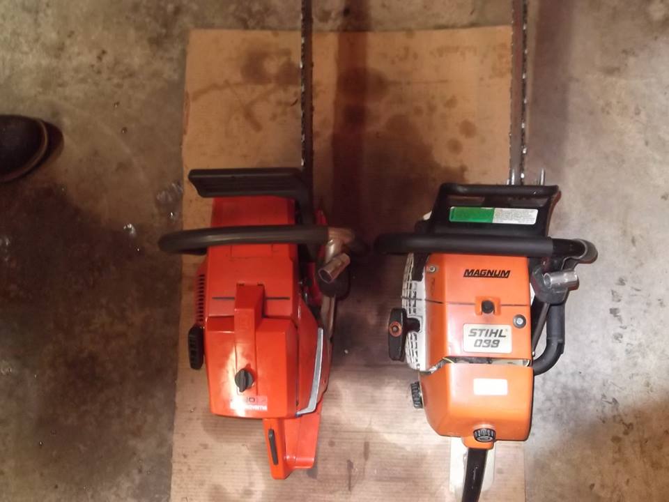

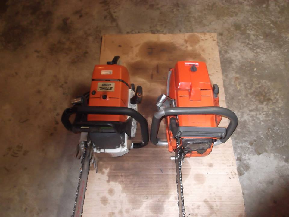

#538
Somebody heard me whine about the heavy saws.
2 more came in.
