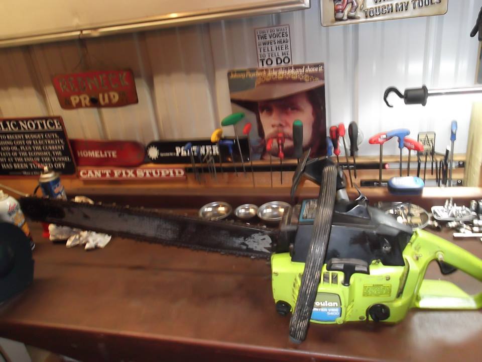

One 1/4" fuel line replaced and runs good as new.
1 owner poulan 5400 85cc I picked up from original owner that dont use it anymore. Said been setting for at least 10 years.

Oh, how sweet is that one. About 1980? Late 70s? Does it have points or EI?

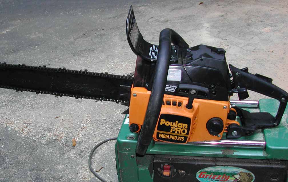

I just landed this one from the late 80s: A PoulanPro 375 Farm Pro 61cc. Manual oiler only,
no chain brake. Seems to be nearly the first of the "PoulanPro" brand name and the new colors.
Runs great now.

80-84 from my reading. Family tree 5200 5400 8500. I have had 5400 and 8500 so far.
The 375 has auto oiler and manual oiler if I recall right. I owned them too. One I had had wrong air filter top.
Had 4000 375 3800 3400 etc in that series.

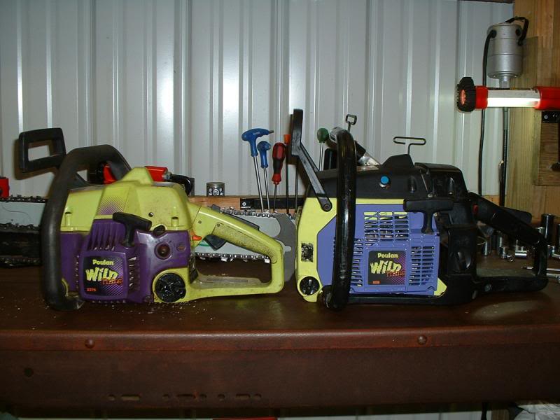

I don't think I've ever owned a piece of junk as bad as this poulan wild thing ! I don't even take it to the woods anymore. I only take the husky 55 now

What do you want for $99. :p:laughing:
Most the ones I seen that owners have troubles with is they dont know how to tune. For one they come to lean from factory. 2 the carb nuts get loose and you need to check and do maintenance from time to time. 3 the fuel line is junk in them and should be replaced. Most the fuel filter has already fell off. :confused2:
Tools some times are only as good as their owners. But yes the 55 is a proven and much better saw.
I cant stand them because they have no AV myself for a little trim saw. I usually sell them tuned and ready to cut for 40-50 to homeowners doing yard work around the house.

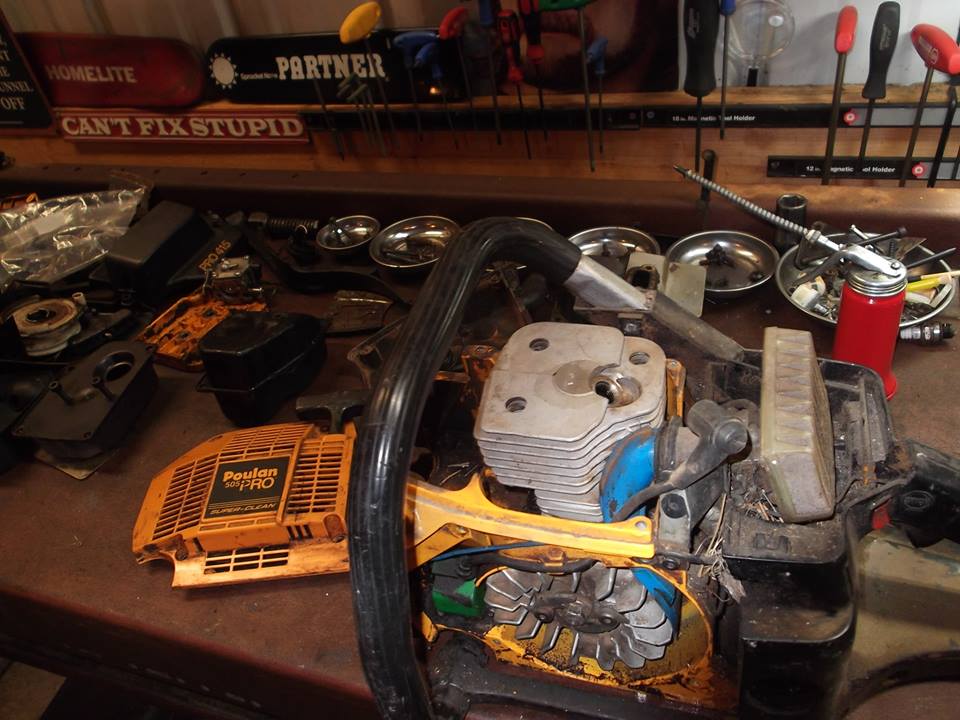

My favorite 70.7cc saw #4 project now.
