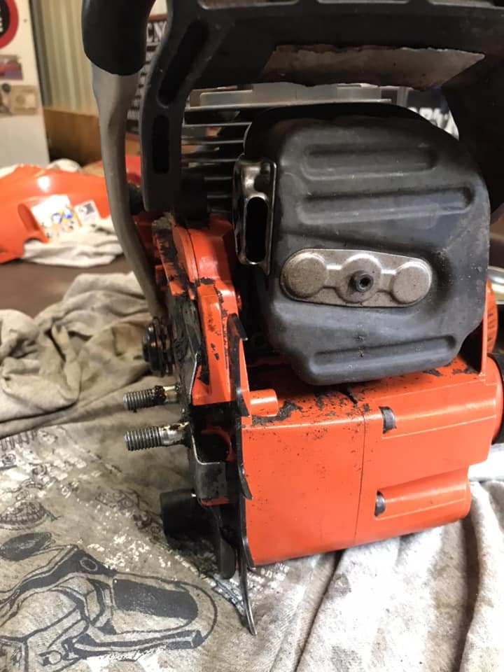

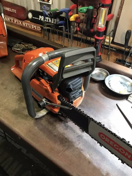

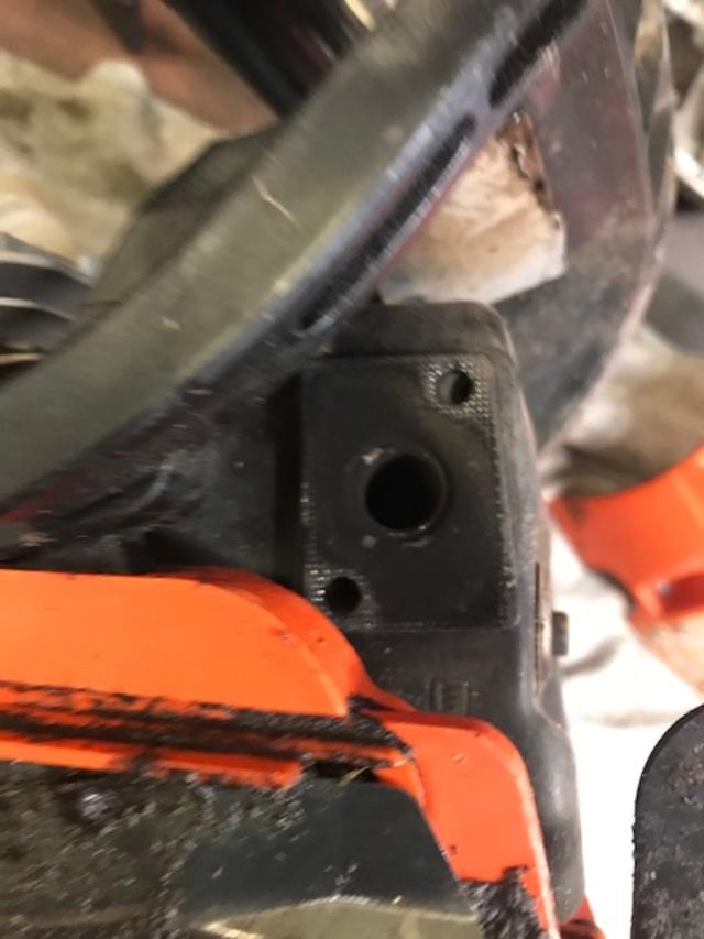

@kenmbz did you toss the inside tube and open front up?
   / Just another junk chainsaw
#2,462

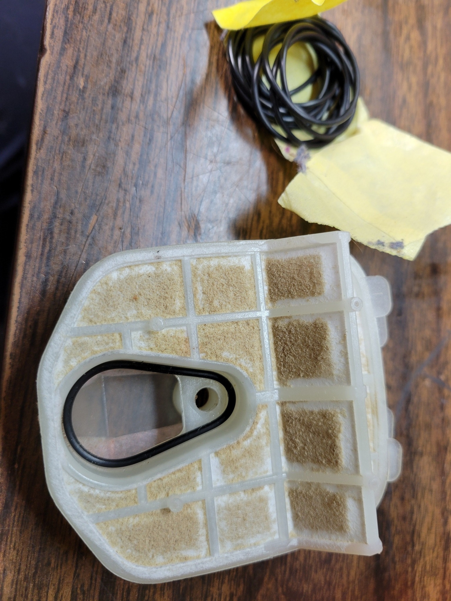

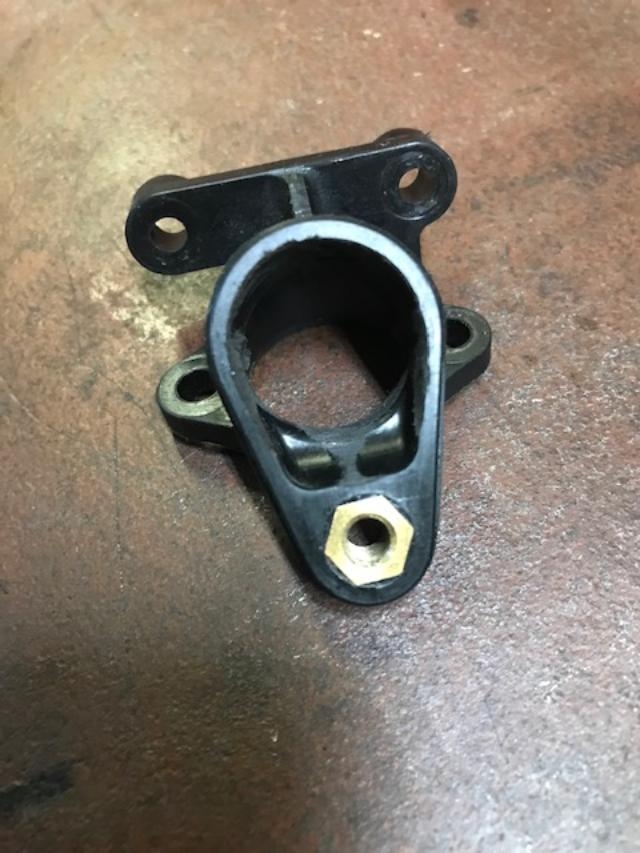

Also to help keep fines from getting by the mount area. Oring.
Then small gain by doing this on them. Proven on dyno with stock and then removed.
Really nothing to worry about as my 2 stock 501 I havent done it yet. But did on the ported 490.
#2,464
I have the oring and did not pull the tube yet.
That's why I was surprised to notice a difference.
Think like 1 more slot and maybe little more open on 501 4910 deflector top.
490 lower.
IMHO still isnt enough. Inside tube pops right out. Open front up.
Echo always hold their saws back by mufflers.

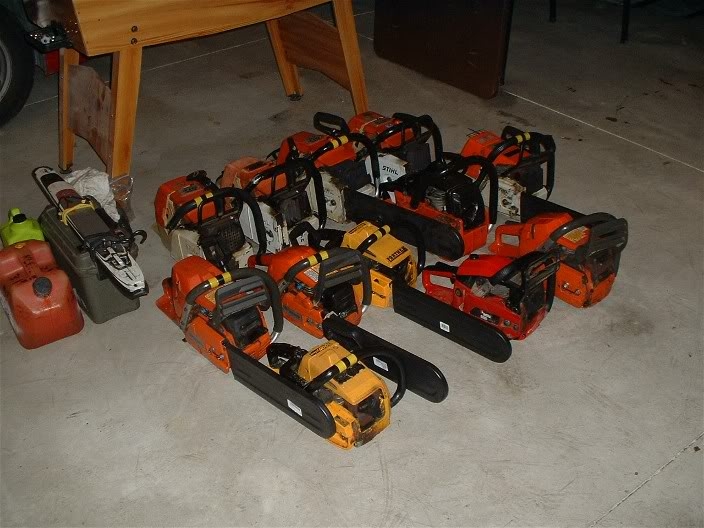

Past saws. All ported but the one 365.
No brand loyalty here, they need to earn my trust in the model.
Pick the best from the makers for use.
Even doing that still today.

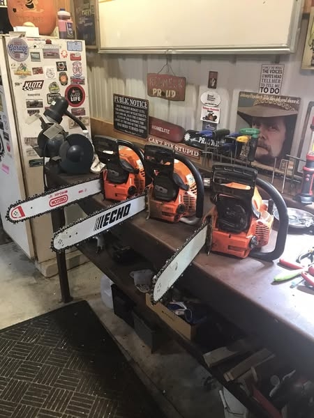

Ok, going out to Buck Up 2 Cord of 8's. Which Saw would you grab? All having the same Bar and Chain?
#2,466
Now days lightest saw that will do the job quickly.
Out of those prob the ported 357. I have yet to see a 357 run like that one did.
New off the reel oregon CL so pretty dull. Aspen cant.
   / Just another junk chainsaw #2,467
If I am bucking, I am usually using a 50CC. I have 4 (I think) 50CC saws. The Stihl 261 & 260, Husqvarna 550, and the Echo 4910 that's got a ported muff and squish adjustment. I ALWAYS grab the 4910 first, it's my go to little power house.
#2,468
Today being I run 325 on the echo 50cc x3 and 3/8 on the 2x 59cc. Wouldnt be same bar or chains used.
I couldnt count in my head how many 50cc-54cc range saws I even have in smaller size ones.
I grab Echo 501 50cc first since super light 50cc, then if bigger got to the ported 359.
