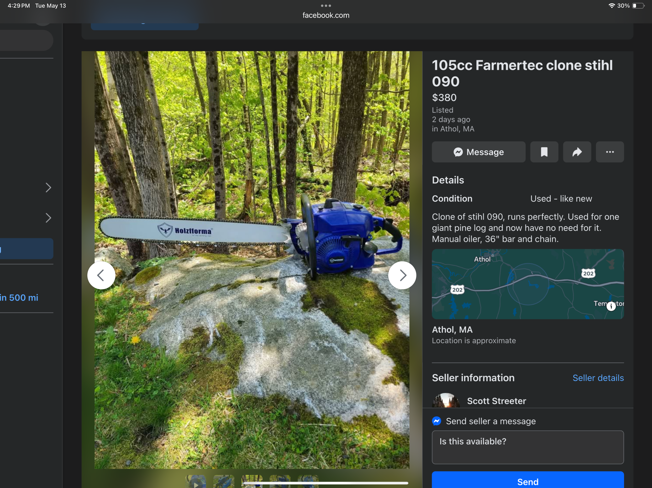

105cc. Thats a lotta motor.
   / Just another junk chainsaw
#2,290
@Hay Dude
You can have a G070 Farmertec like that one on their new colors at your door for $315 shipped from their US warehouse. Why I say with that b+c hardnose at that not a great deal.
I would never ever want those myself. Like 24lbs plus PHO.
I'd get a G660 for same money or pay extra for the G888
