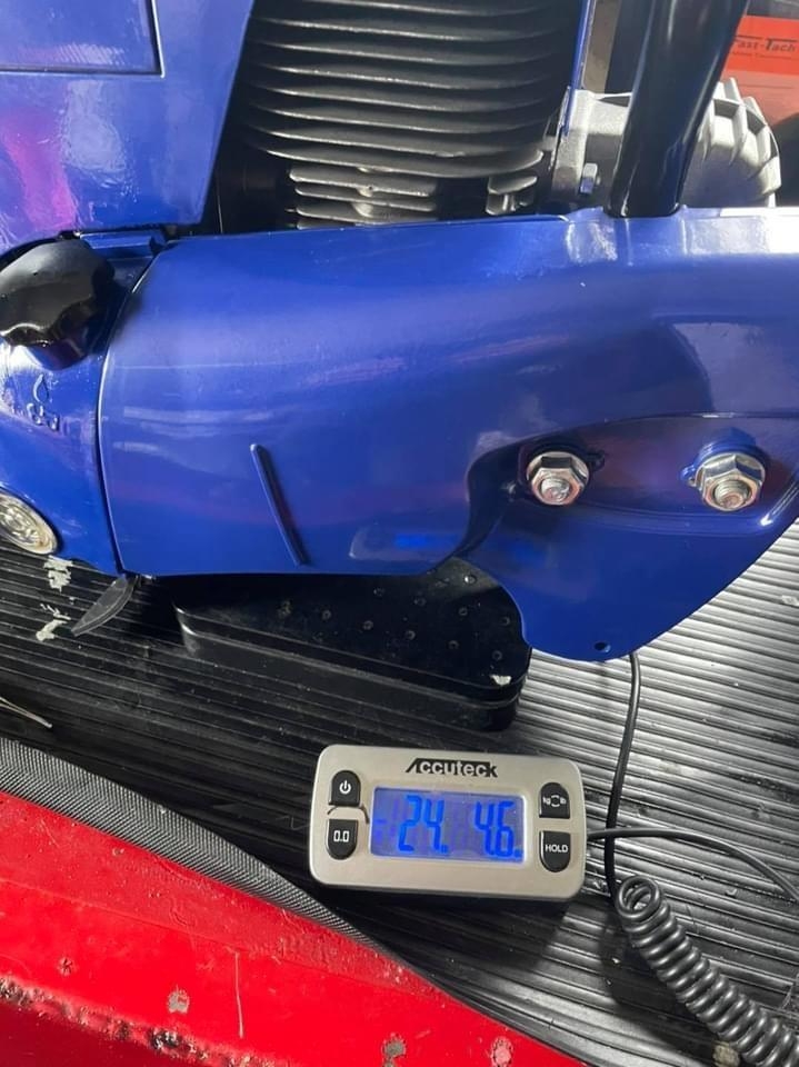

20lbs+ gets old after a few hours
   / Just another junk chainsaw
#2,293

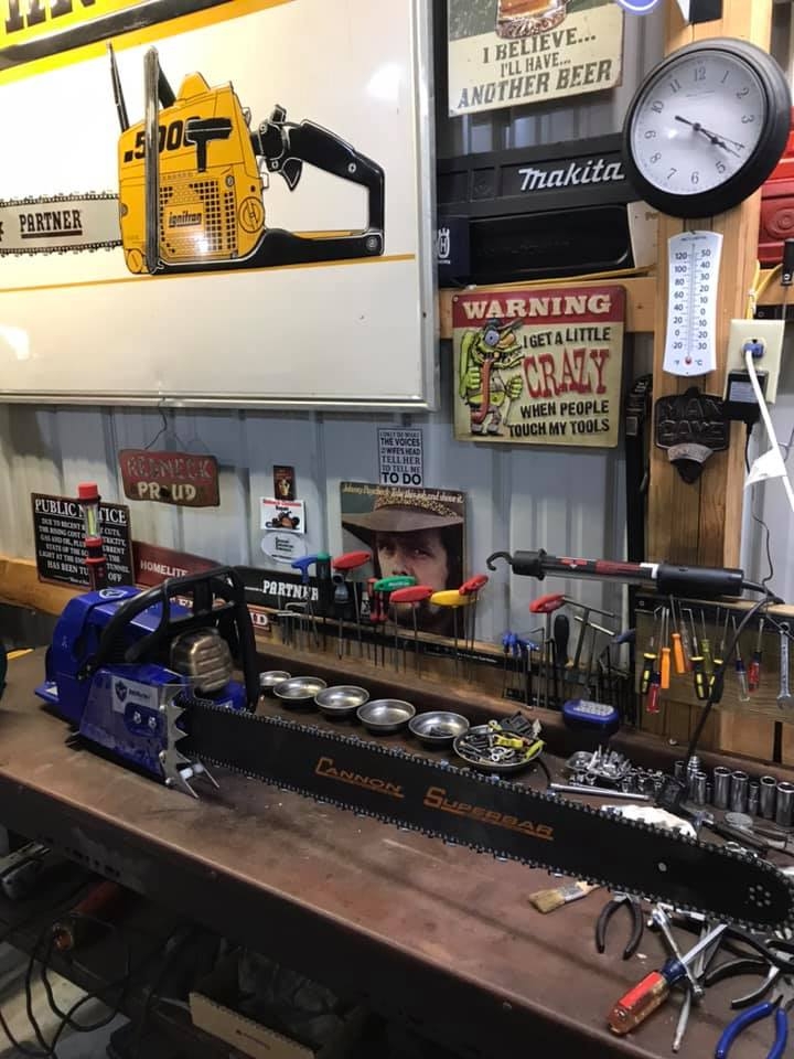

Thats dry PHO. Now just add a 36" b+c and fill them up. G888 is over 32lbs like that. So G070 plus 2 more lbs.
Mine was with lighter 3/8 chain too. Come with 404.

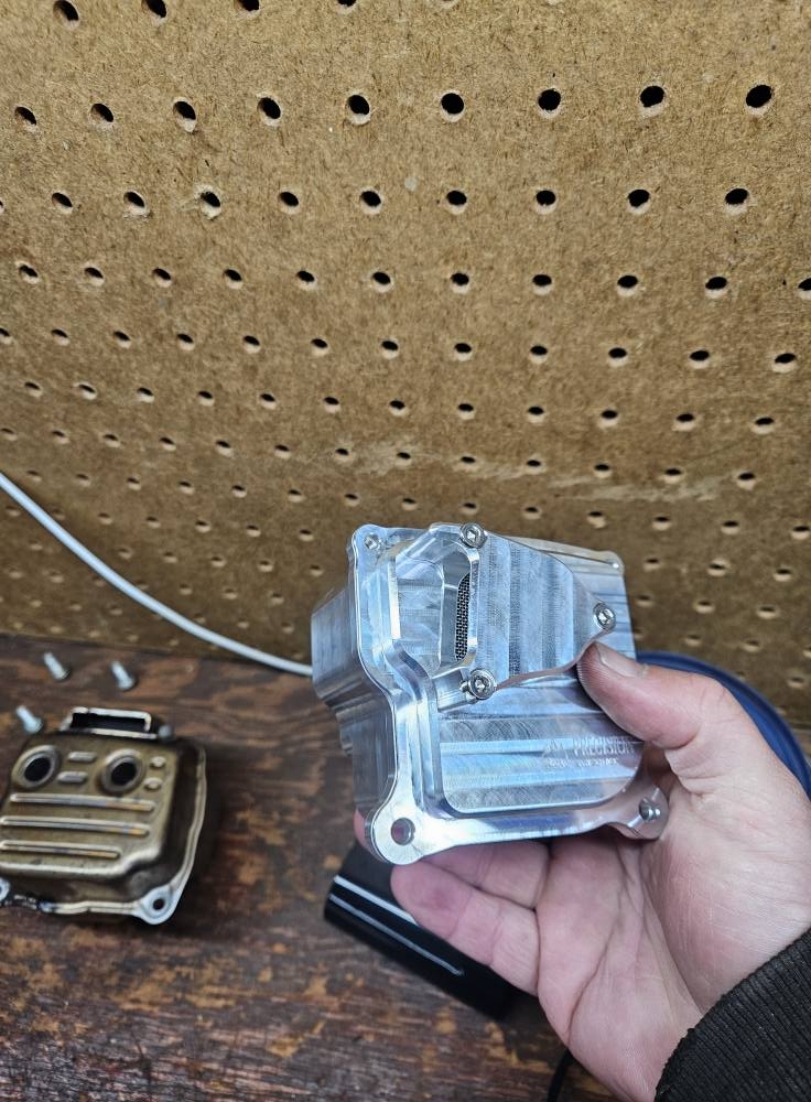

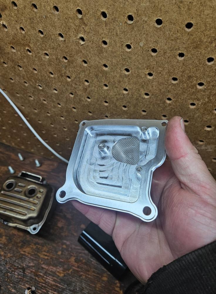

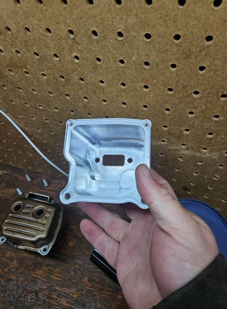

If any of you run the stihl 261.
A NY guy cnc mufflers after he scans oem to come up with his own better design.
He is doing the group members a 084 muffler right now.
His bolt on muffler showed 12% gains he said.
I like 2 piece mufflers and side exit too.

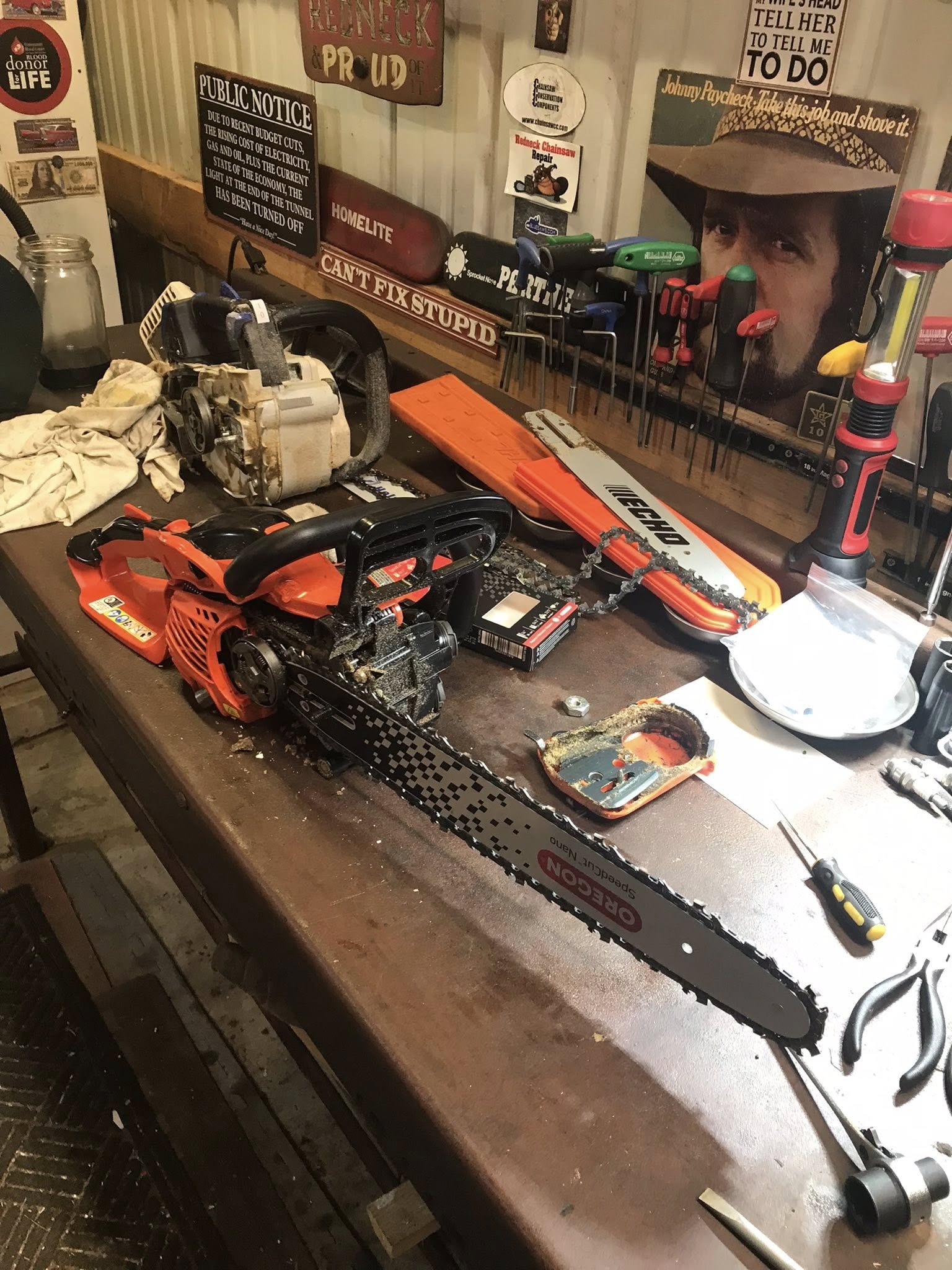

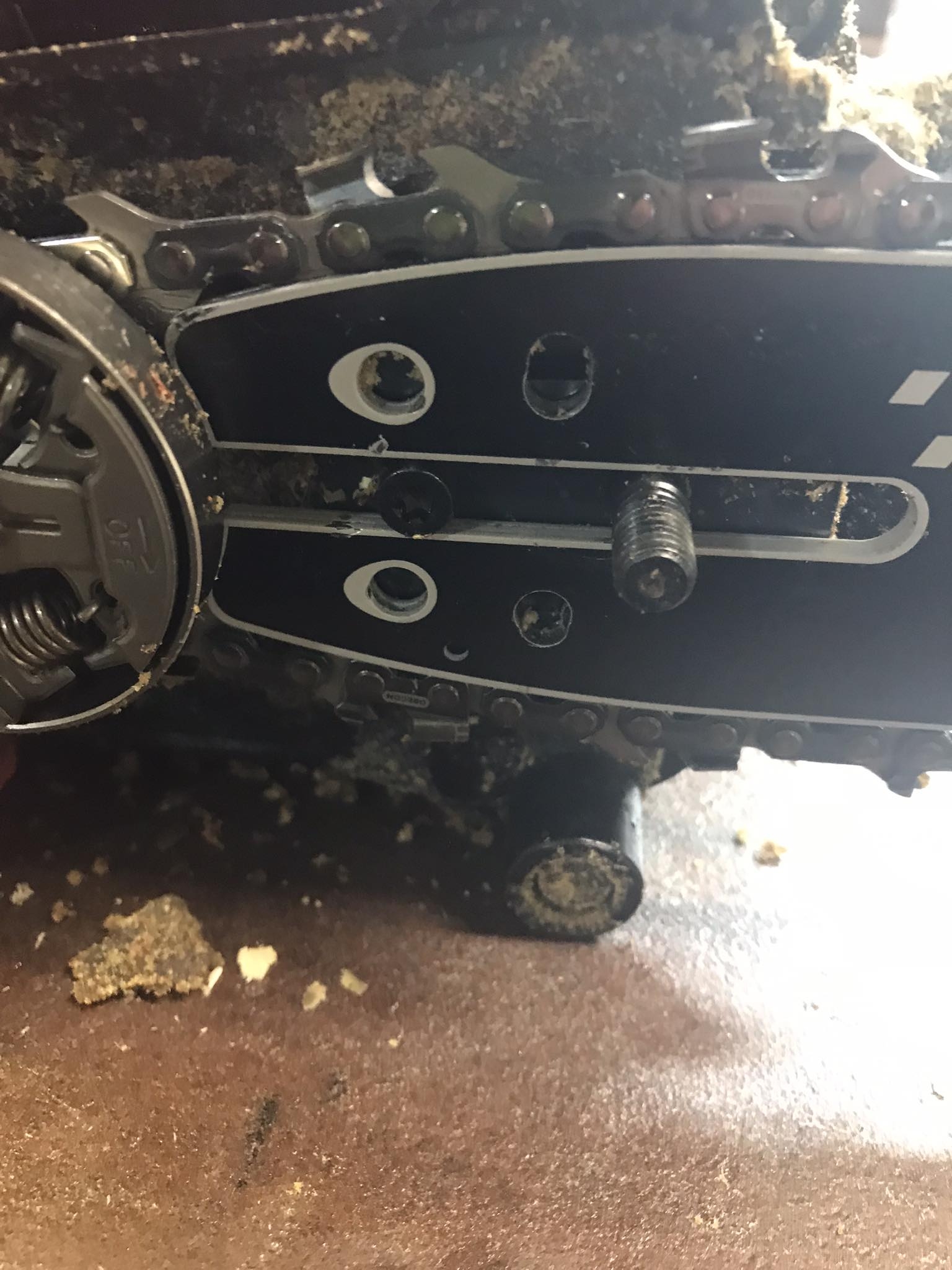

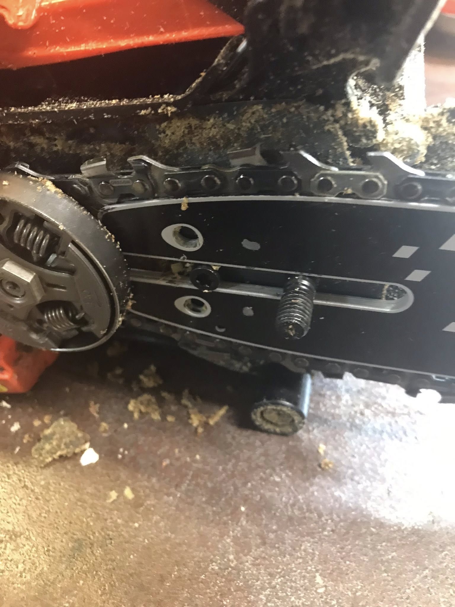

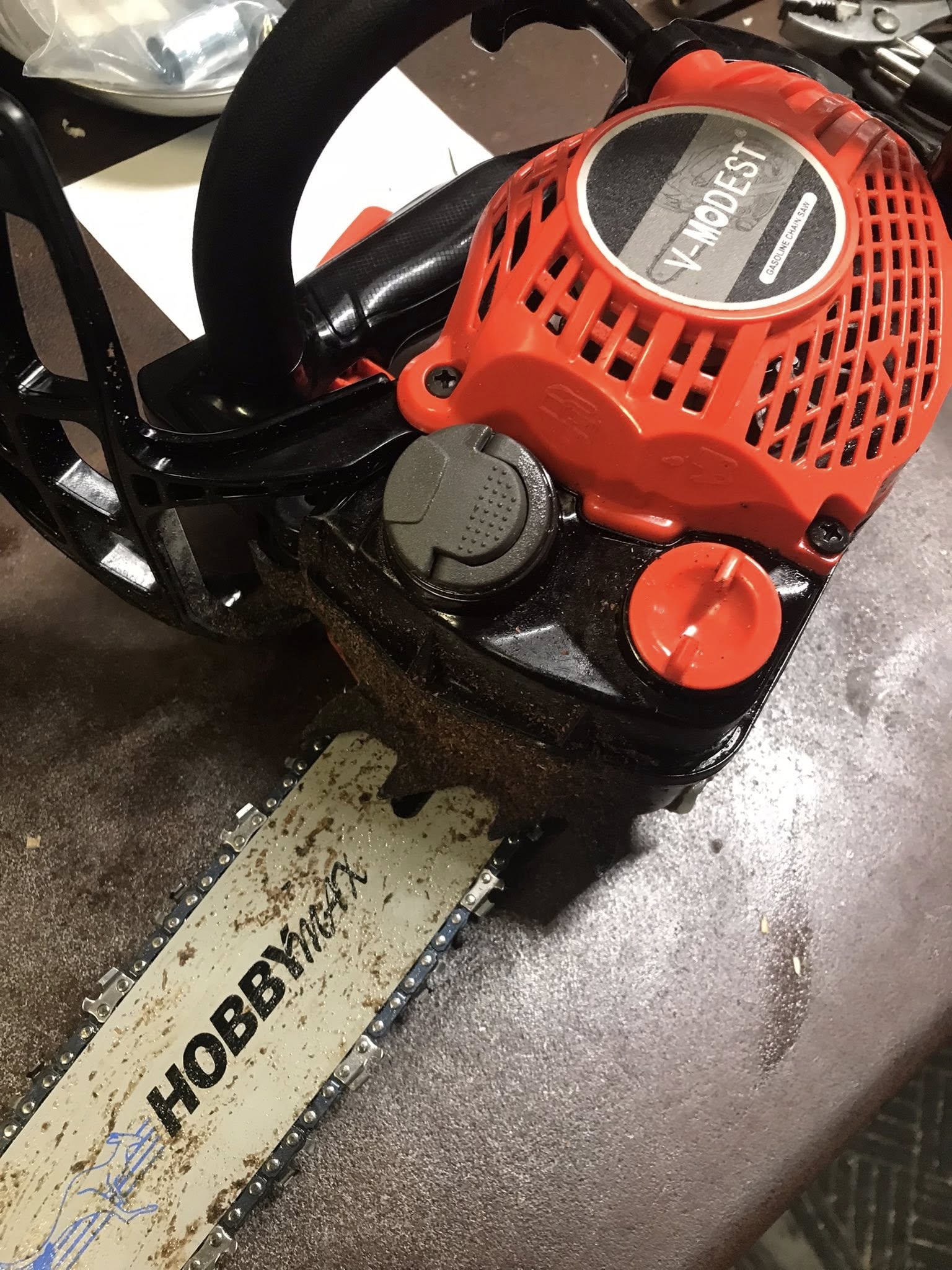

I had bought a nano set up for my Farmertec G111 200T clone. The nano cut slower then my stihl 63PS3 and clone 63PS on 35cc with open muffler. A074 mount.
So I made the work In 2511PN
Decided to just mod the A074 14” 59dl bar and use on rear handle 2511.
Since it cuts 12” buried no issues with the Egan pipe in it.
Oils great and dang I love the flippy caps

I might give that a try. My 261C is my go to, go everywhere saw
Anything he does isnt cheap. Online Store — Precision Saw Service
He also stays sold out most times. You have to contact him and get put on the list as their made.
He showed a video in group how he scanned the 084 OEM muffler to get all the specs to set up to make those.

Stihl 63PS3 full chisel 3/8LP v/s Oregon Nano 325 043 narrow kerf.
Echo 2511 25cc the Nano is great for use.
But on the 35cc Stihl 200T clone Farmertec G111. The full chisel 3/8LP does what it does best and out cuts it.
35cc is going back to 3/8LP 63PS3 and clone version of 63PS.
Nano like the 25cc saws and so do I for it.
12.8-13 tune NANO 325 043 - 8.66 hanging tossed, 7.72 tossed, 7.22, 7.44, 7.60.
3/8LP stihl 63PS3
12.8-13 5.53, 5.50 and hung one 6.40 tossed.

Love the V-modest 2511 clone with spring assist recoil just like oem uses.

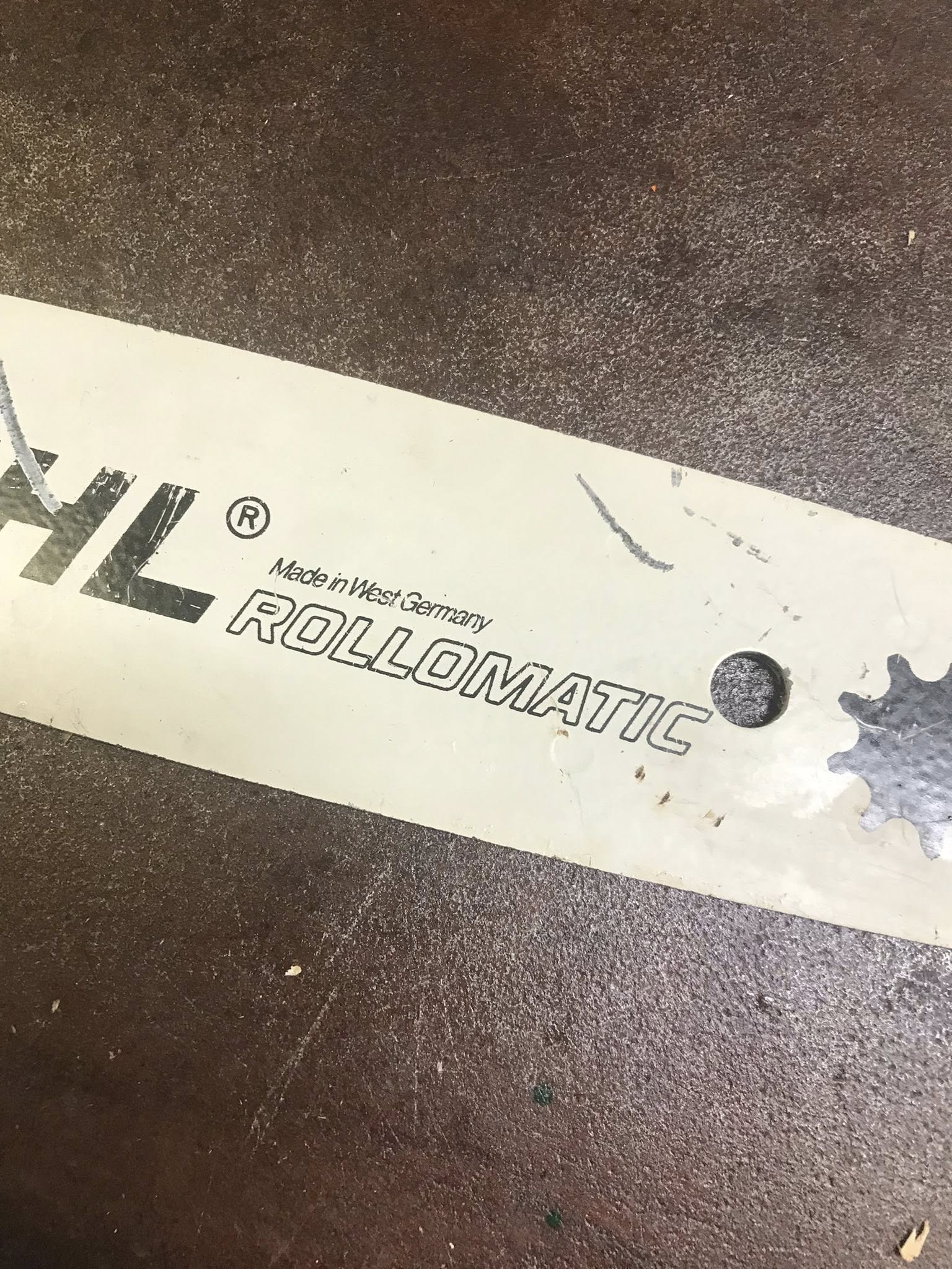

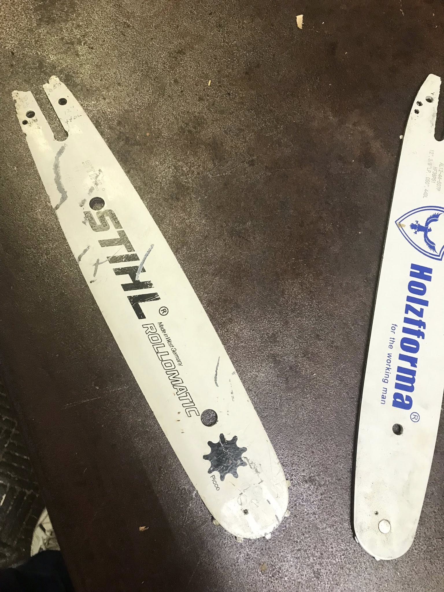

Amazing the stuff you forget you have.
I had bought this 12” for dads saw years ago. But then he told get a 14” 050
