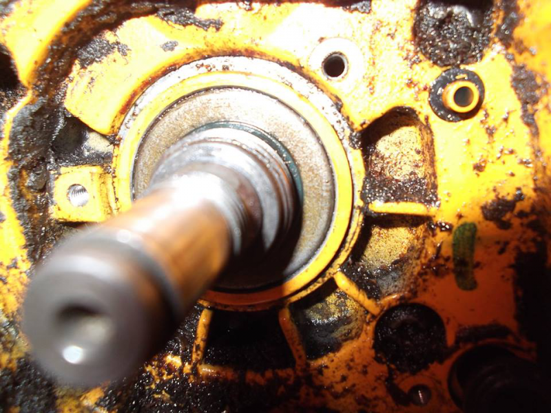

Well when you find them on your little fantasy land let folks know. People been hunting these down for over 20 years now.
Nothing matches them in the seal world.

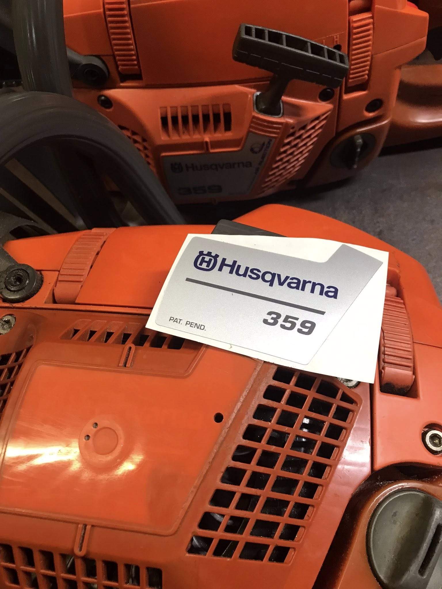

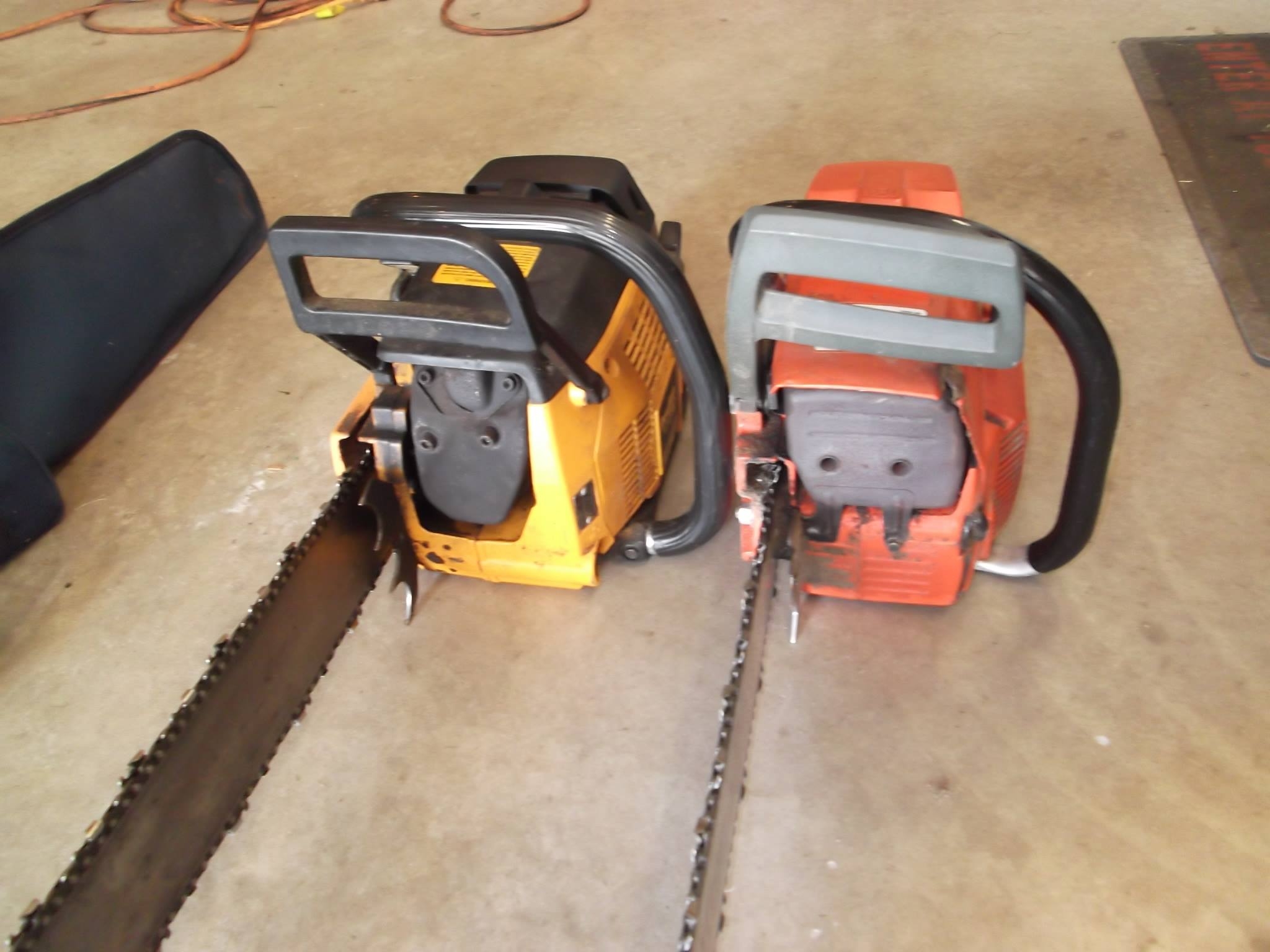

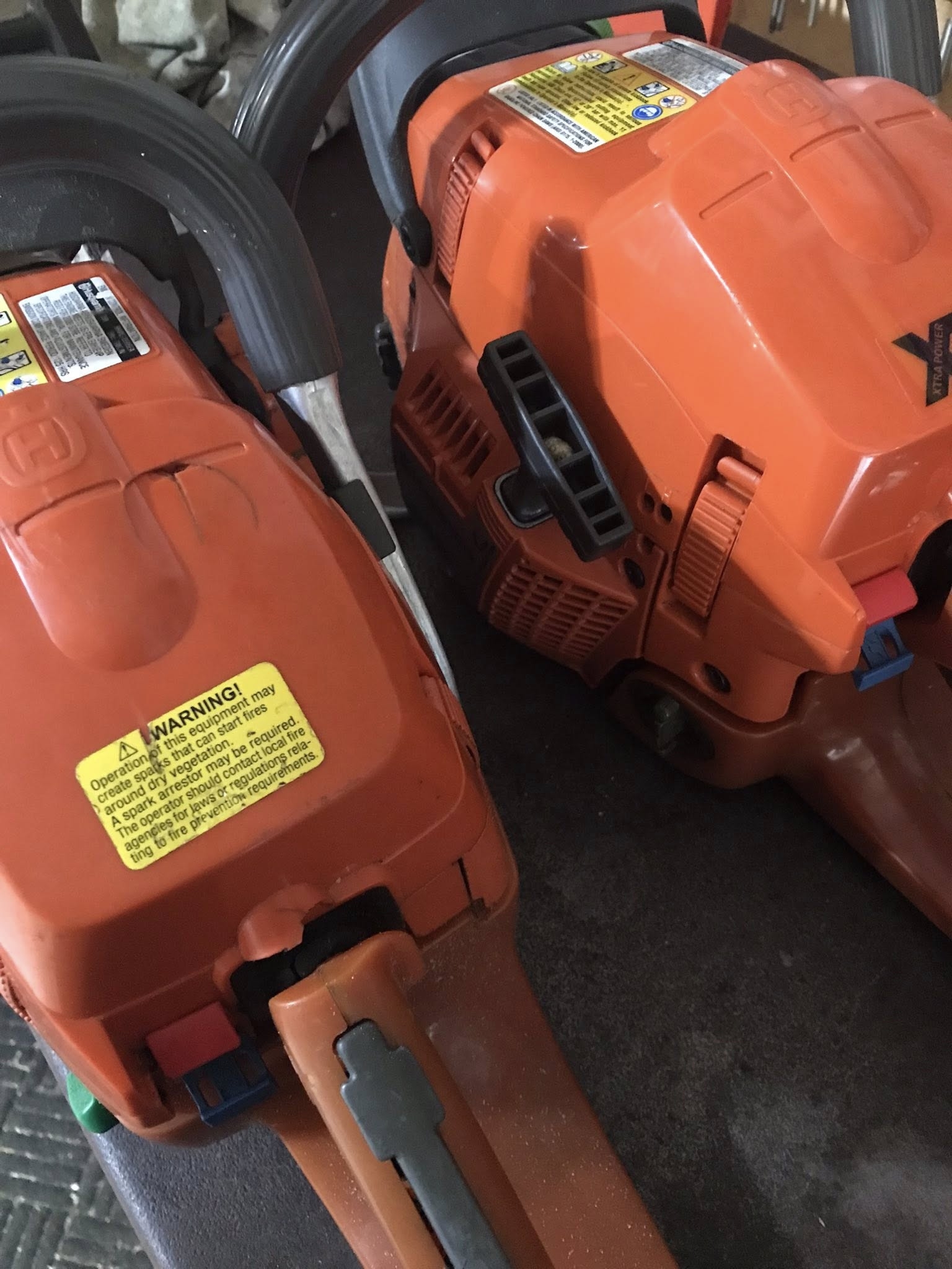

Hopefully be able to start both the 359's next week. Neither has decomps. Starting anything but smaller 2511 standing up is the limit right now.
359’s 06 09.
Took that stupid yellow warning sticker off af area.
09 is the one that come in trade as a 353 in disguise. Had 353 decal etc on recoil.
Trying to straighten it up for the testing next week.
Put some heat tape In cylinder cover where they tend to get hot at.
Also going to try that Sawsalvage chain for the testing.
06 one is ported by Corey at Fabcorp OK.
09 came in trade. Has a gasket delete. I just did a gill muffler mod and opened inside.

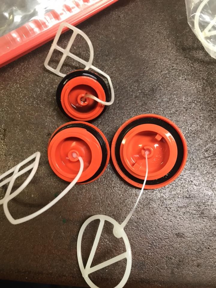

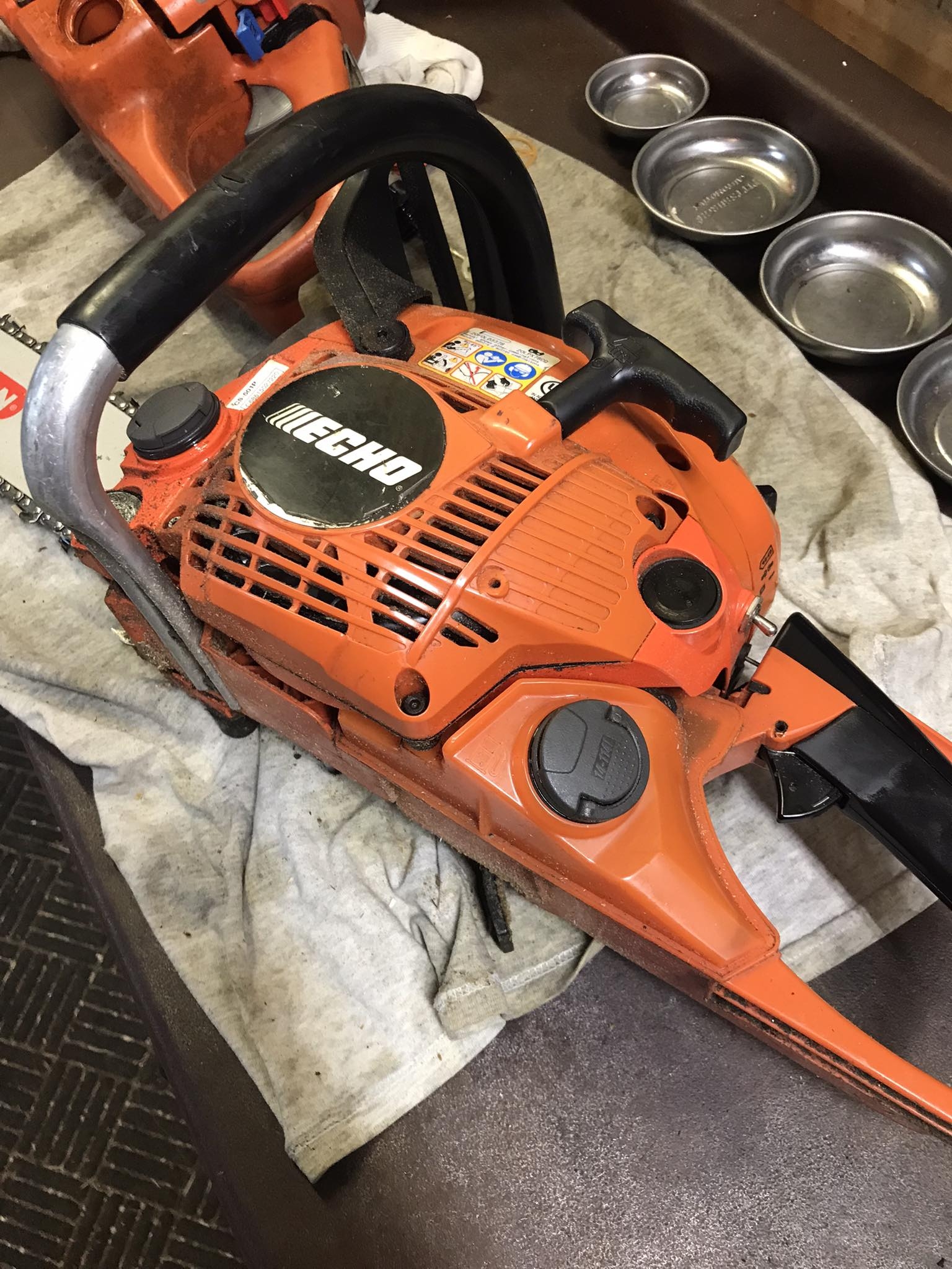

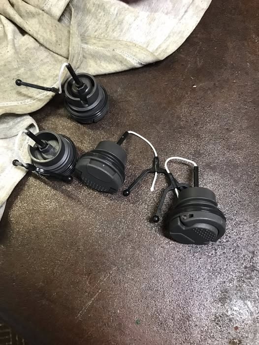

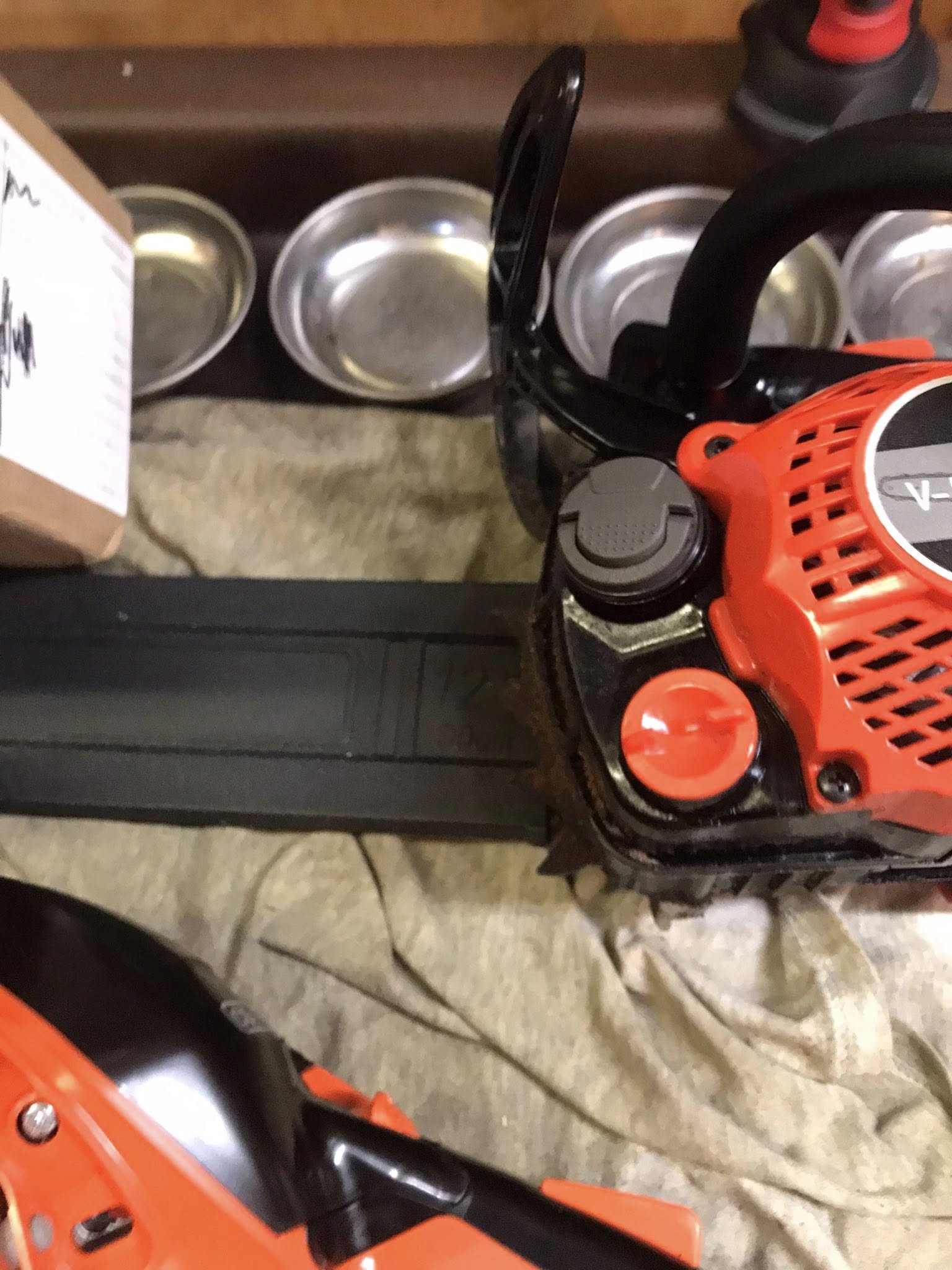

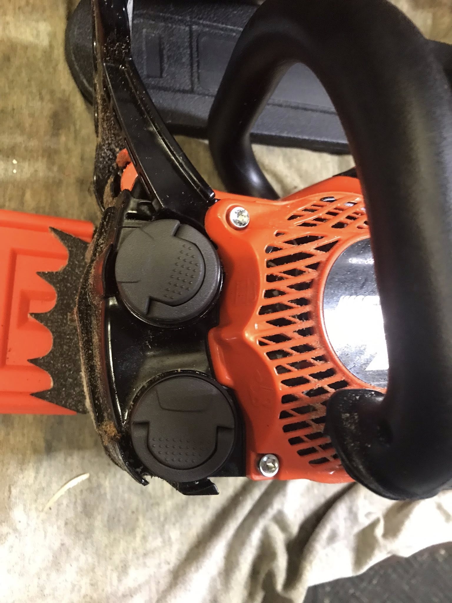

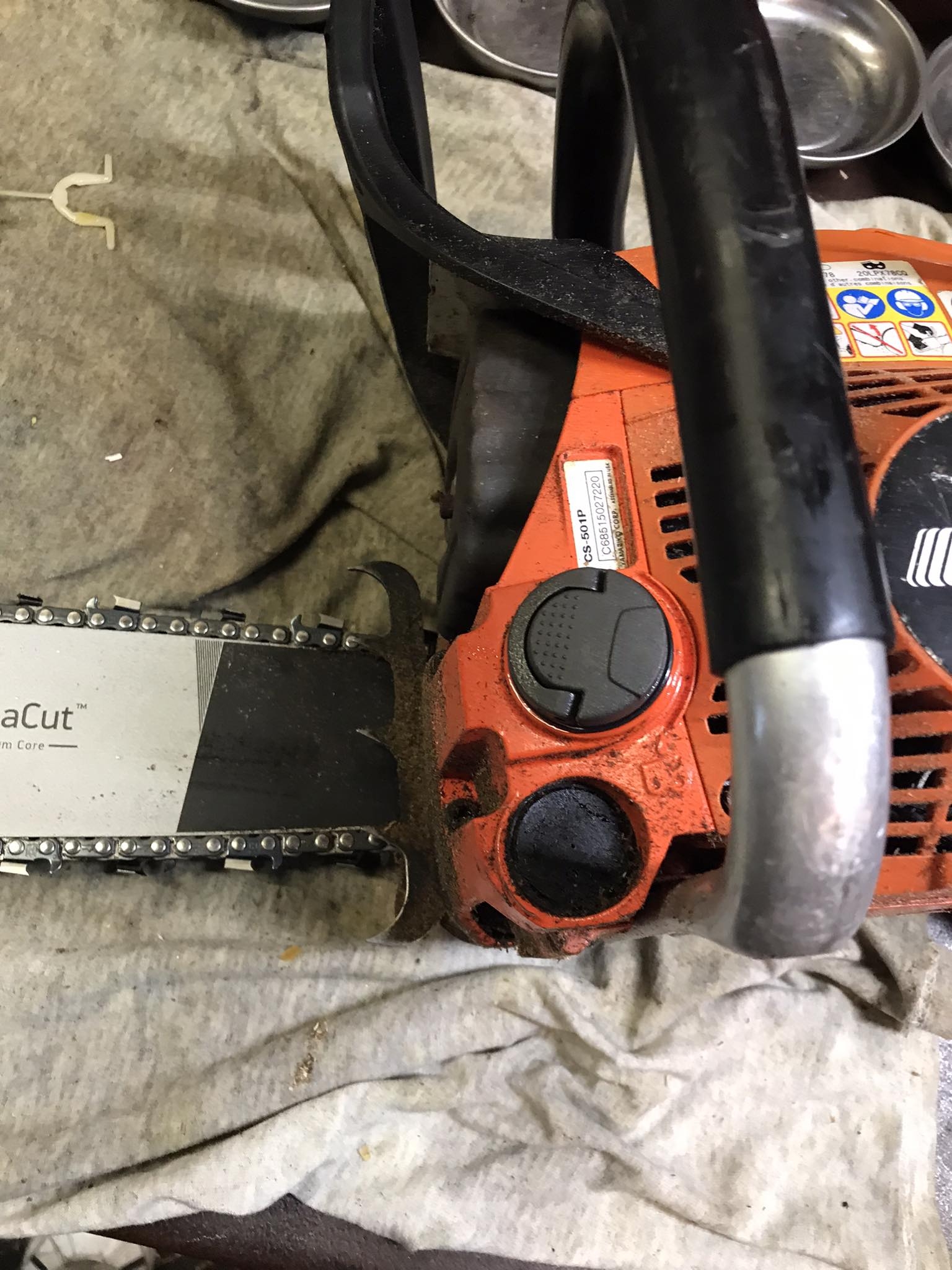

Those smaller husky flippy caps work no leaks.
Being gasket style newer husky style.
It works on oem echo 2511 fine. Don’t over tighten.
V-modest 2511 I knew oil one was out. But ordered 4 anyway.
Going to try small one on different saw to see.
The gasket on clone caps even more different. So definitely don’t want to over tighten.
But loving the ease of the screw in flippy over those darn 2 prong caps.

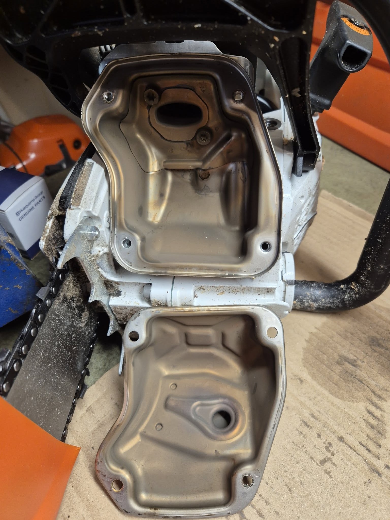

Guy overseas running the new 400.
Inside the new 400 muffler
Just like the end run of the 460. Pencil eraser size to breath through.
I bet she run lot better opened up.

If it runs that good choked up. Imagine how it will run when opened up to breath.

The cap on my Chinese Clone saw leaks gas pretty badly. I ordered a replacement cap from Amazon but it leaks too even worse. Will one of these "flippy" Husq caps fit ? I'll try it if even a chance it is. And looking at that restriction in the muffler you have to wonder what they were thinking in the design group. I'm gonna have to look at my Chinese saw and see what that one looks like. It did seem restricted on high RPM's so maybe something going on there. Cuts fine though with the 24" bar on it.

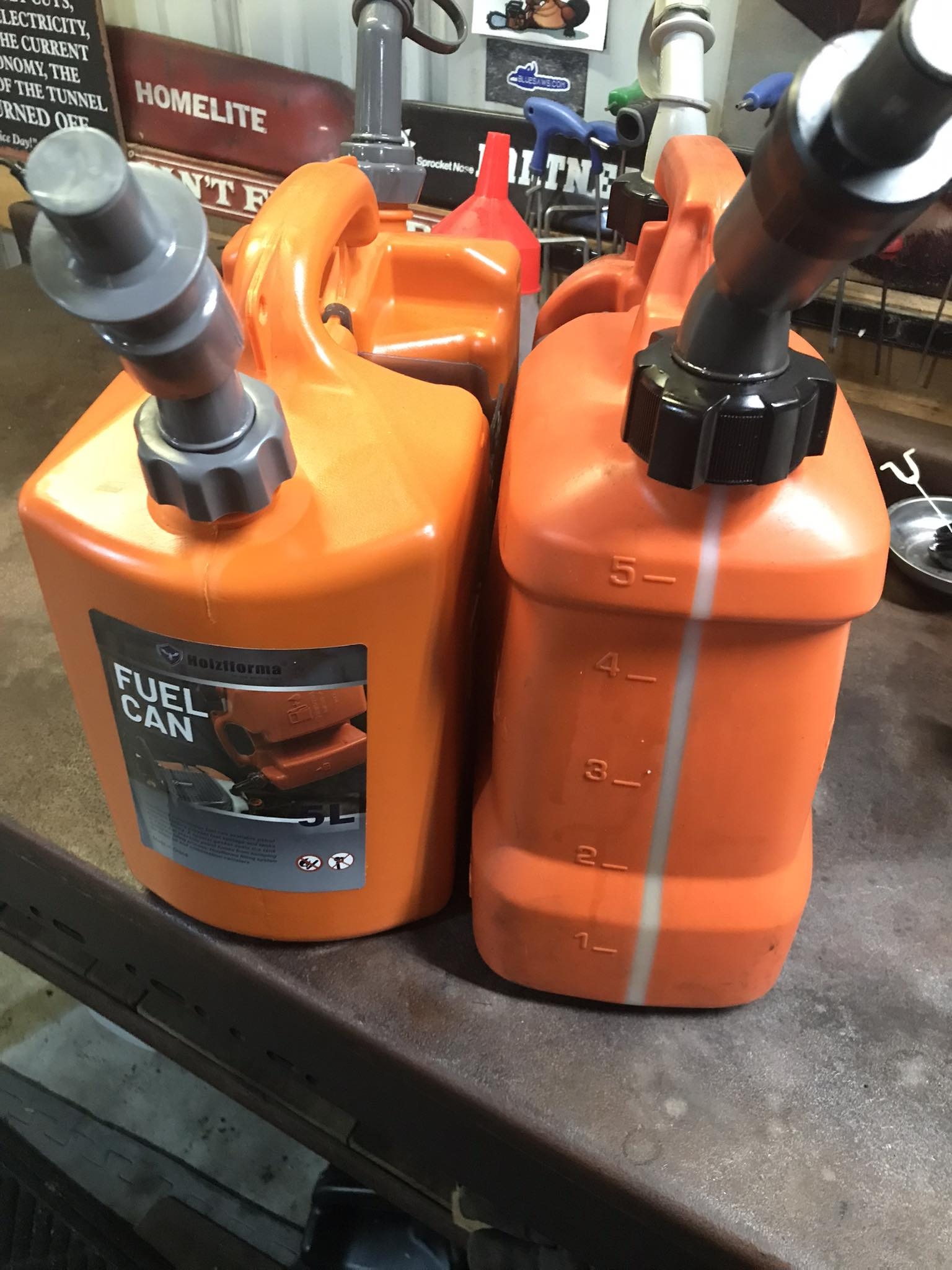

I was mixing efree and vpracing yesterday. Can and combi's refills.
Did notice one thing about the aftermarket clone stihl combi. Farmertec version of their 2 they sell that I like.
Don’t like the older green cap husky version with slanted holes. Not good when using funnels like I do.
It was closest to the newer husky combi I use.
Straight up holes for funnels.
But anyhow. Don’t have the clear area for 5L to see where it’s at for fuel or oil.
Ready to go again E-free

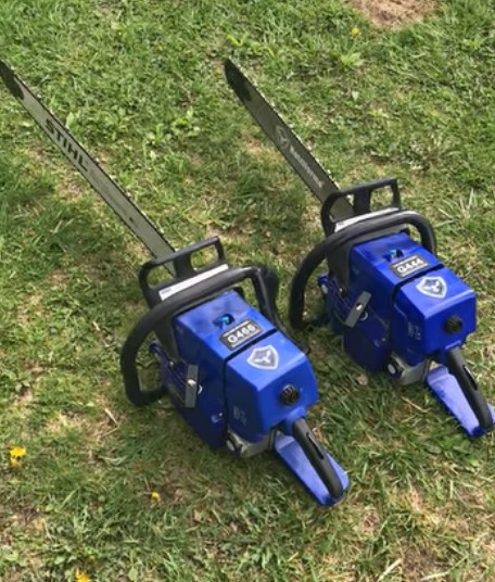

Stumper and sidekick reporting for duty. Farmertec G466 460 and G444 440
48” across lower area I want to cut at.
