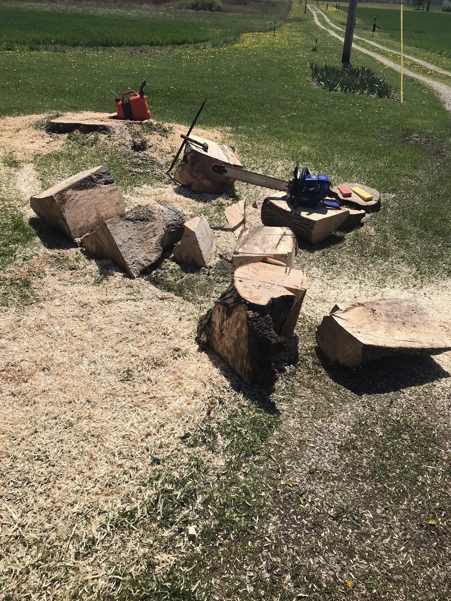

Stump chunked.
Where I had cut was higher then measured at flare of 48". Ended up cutting 46x45.
Farmertec G444 even stock with their DP muffler is a beast.

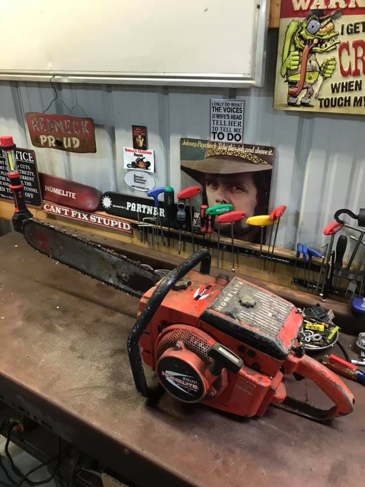

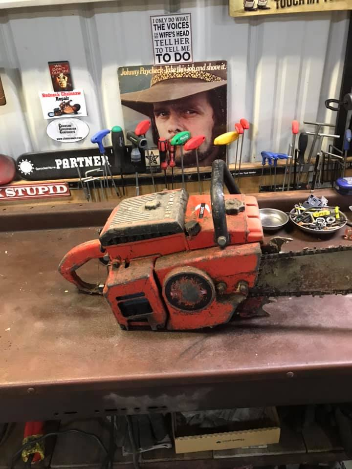

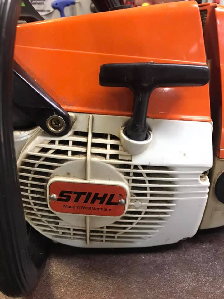

Also why as soon as I took this one in I listed it FS.
It was woods ported by friend out west Jason Egan and ran sweet. Unlimited coil with H side carb.
Reason shown in this other pic PHO weight even more then G888 MS880

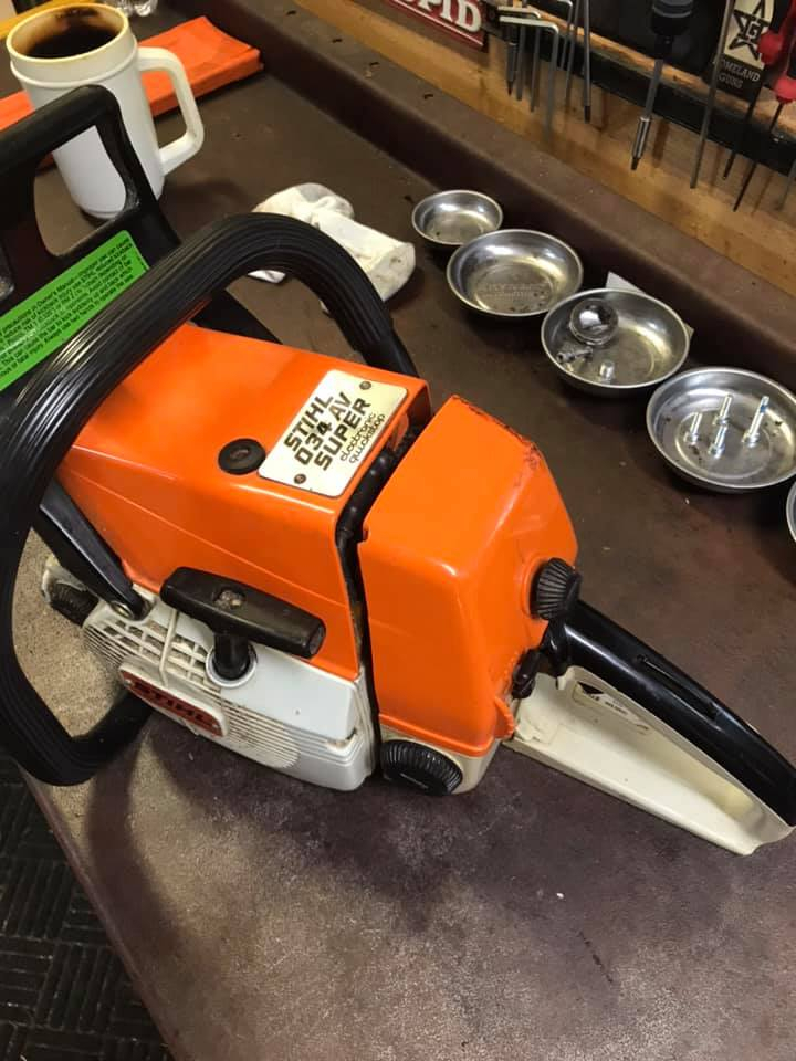

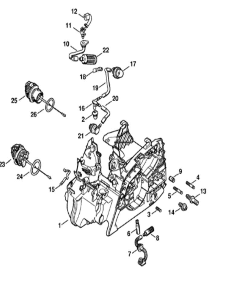

Stihl 211 complaint of gas leak. I can not find a gas leak at all.
Only typical oil line from oil tank leak. 🤷🏼‍♂️
IPL of area

#2,155
While checking things and cleaning tank vent etc.
They got very very lucky.

#2,157
Hello pita stihl location for a tank vent. :oops: 🤦‍♂️
Bye bye stihl tank vent and hello echo tank vents that I like better then stihls.

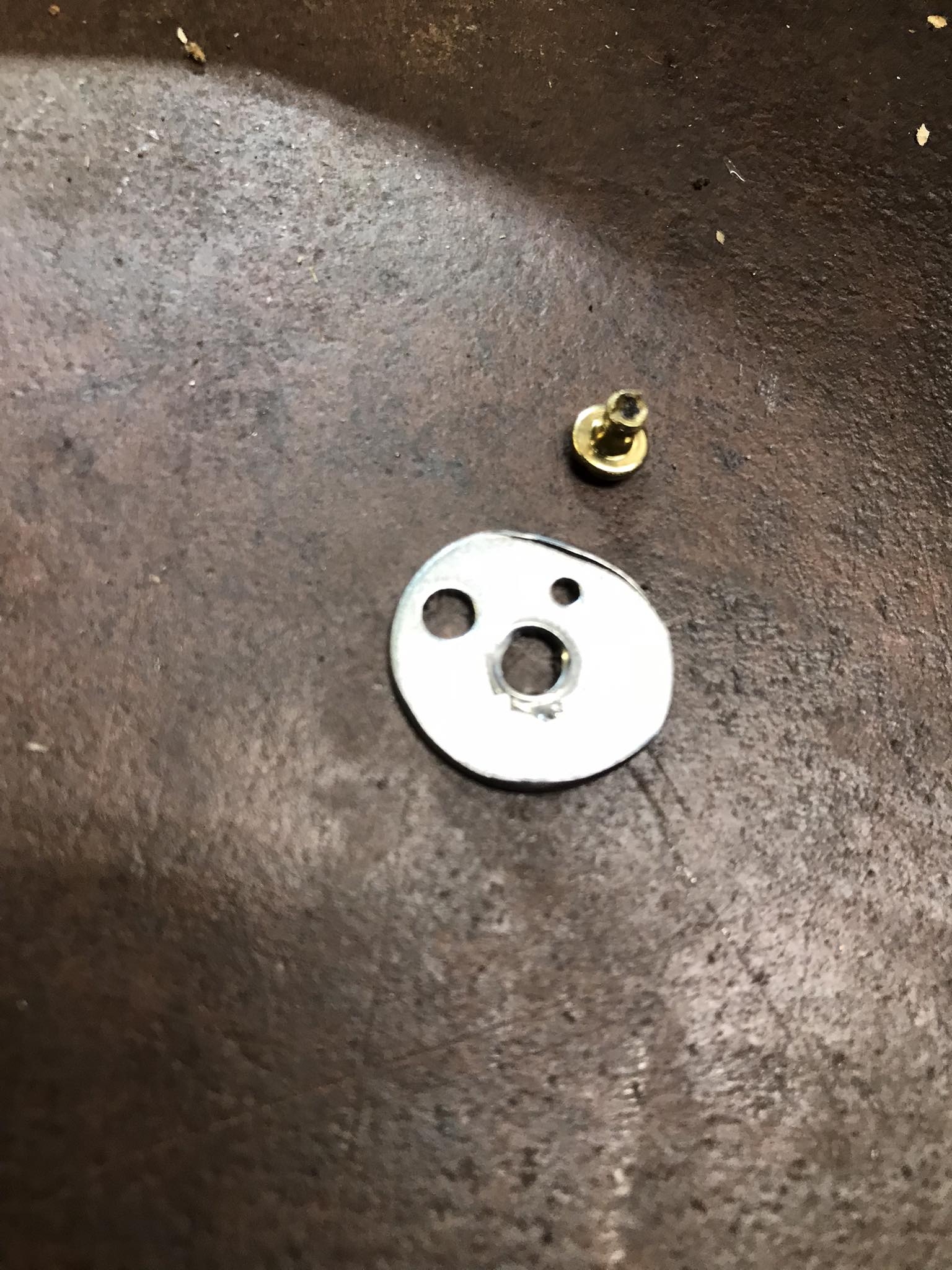

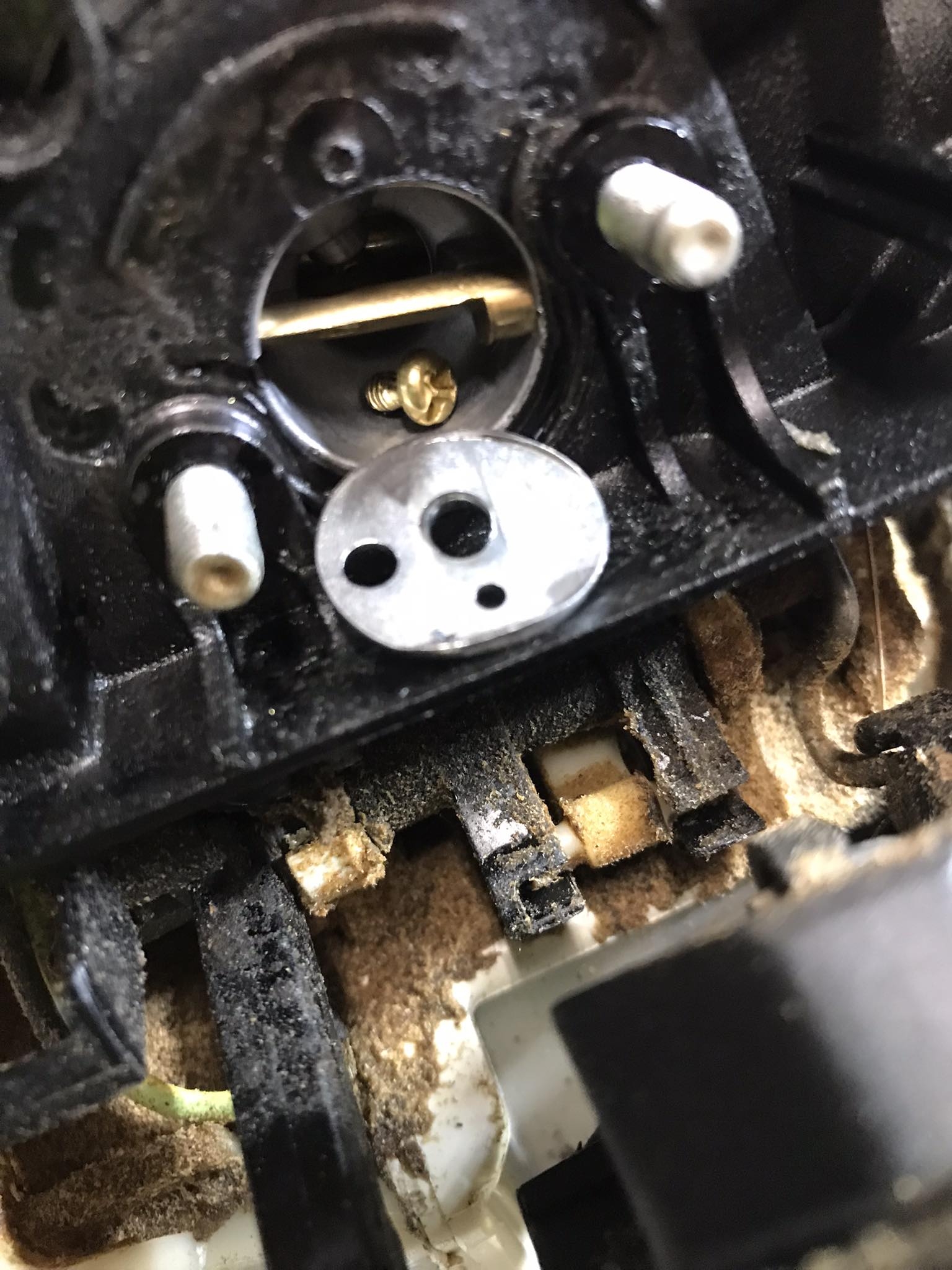

Ran by owner 3 options. Oem, afm carbs and redneck fix.
The redneck fix. Smooth the worn lips. Shape plate back to work. Take a longer screw from another carb. Loctite the heck out of it.
She lives. Choke fix worked.
