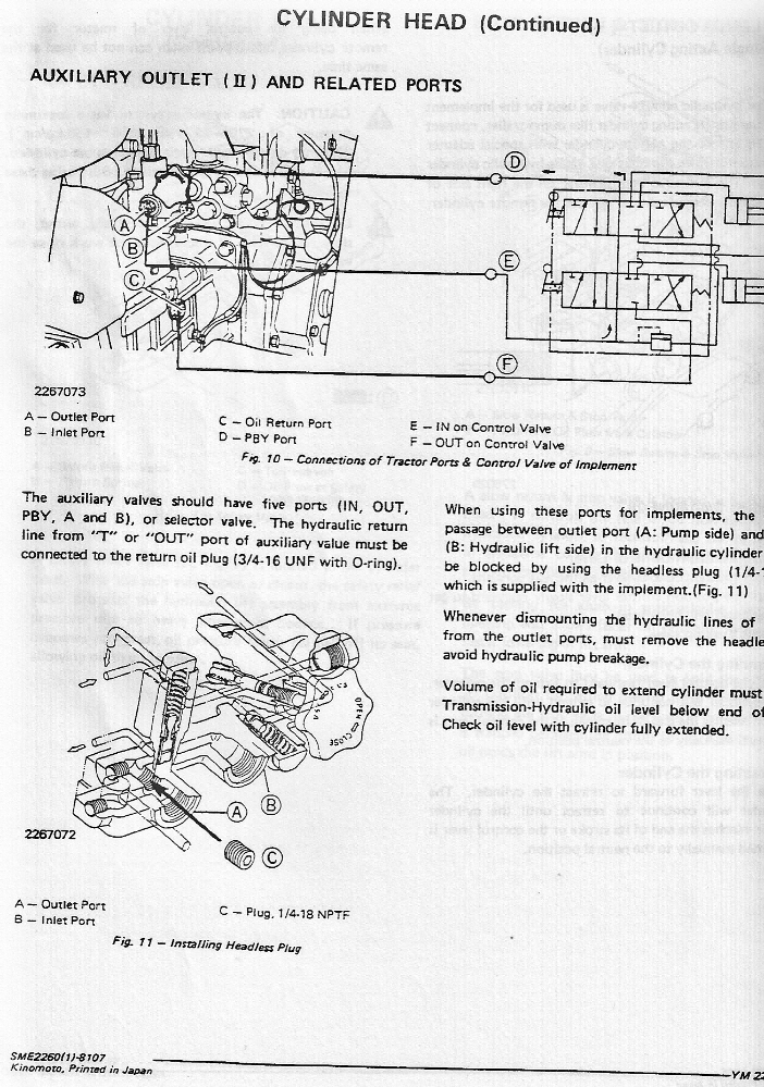

I have my YM226D set up with a wood splitter right now. The splitter taps the auxiliary hydraulic port of the hydraulic block so here is the drill:
  • Raise the splitter to work height with the 3pt and then shut down the tractor.
  • Close the valve on the hydraulic block to lock the 3pt in place.
  • Move the 3pt lever to the full raise position.
  • Connect the splitter hydraulics to the rear remotes.
  • Start the tractor and start splitting wood.
What I observed is that while I'm in this configuration, the front loader hydraulics are much more responsive and stronger. I'd say the curl is easily twice as fast as is the up/down of the lift. It really surprised me and caught me off guard.
My guess is that something in the hydraulic block isn't quite right. Anyone have any idea what it might be?
Thanks,
Keith
/ Just an observation #2
I don't know how you are hooked up so I really can't offer any advice. I am going to try attaching a scan out of the 226 manual but don't think it is going to be to good. There is an outlet for a single acting cylinder coming off the left side of your control valve and then an inlet and outlet for an auxiliary valve on the front of the control valve. If you are using that you need to install a 1/4" plug in the outlet port.

Winston,
Thanks for the reply. I do not have it set up as a double acting cylinder. My loader is using the a and b ports and returns into the c port. The headless plug is installed in the A port.
The log splitter is using the port on the right side of the block (saw it labeled as an AUX port somewhere) because it operates somewhat like a single acting cylinder. If you look at figure 11 of the page you uploaded, it is the port directly above the slow return/stop valve. The splitter return goes to port c.
It just doesn't make any sense to me that if I close the stop valve with the splitter hooked up, that the loader is on steroids (maybe that is the way it is supposed to work?).
Thanks,
Keith

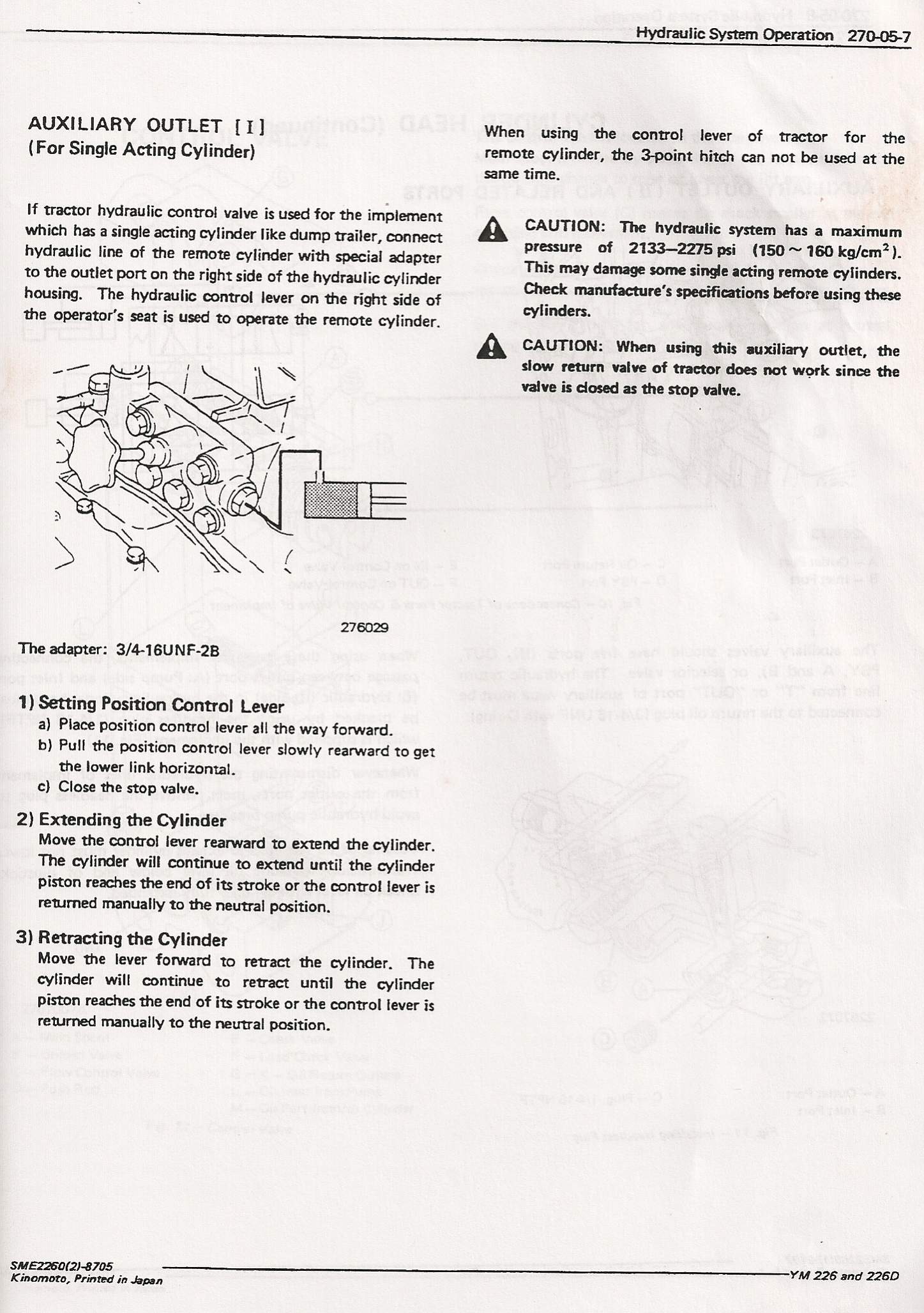

/ Just an observation #4
I guess if your setup works I can't condemn it. However, the auxiliary port on the right side is designed to be used with a single acting cylinder with no return line.

Yes, I believe Kfree has a return, I'm just saying that port is made to be used without a return on a single acting cylinder. That port is unusable without closing the stop valve and is controlled with the 3 point lift handle. I have a quick disconnect on mine that I use with a cement mixer single acting dump cylinder. Again, if it works, go for it. Does your wood splitter valve circuit stay hooked up when not in use? If so, that could be the reason your loader is slower. Here is another page out of the book on the single acting port.

/ Just an observation #8
I'm slow! When you remove the splitter do you connect quick disconnects under the seat or is that circuit left unconnected? "If" it is a completed circuit I could see why your loader does not work as fast. Does this make any sense?

OK, well, I have no idea why your loader works faster when splitter is hooked up. Got to be related to the stop valve being in the closed position. By the way, do you have plenty of pump output to operate the splitter at a good rate? I have read some believing these little pumps won't put out enough to operate one at a fast rate.
