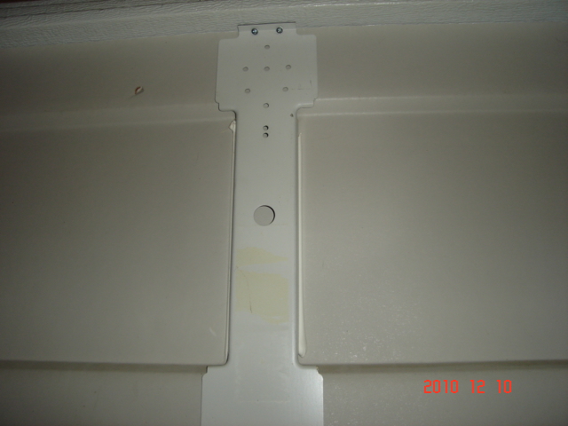

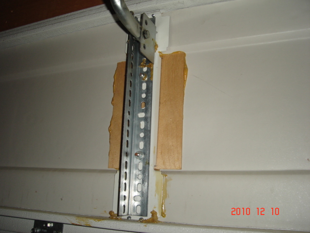

I had a similar problem, but due to operator negligence.... I forgot I had the bar lock in place and hit the button to open the door... and promptly ripped the bracket off the door.:eek:
To make matters worse, the other door, which had never suffered a similar fate, was also beginning to separate, at the door opener-to-door bracket, just due to normal use.
Yes, these are Wayne-Dalton doors.
I was somewhat dismayed, to put it mildly, at the cheesiness of the bracket installation: two small sheet-metal screws into the aluminum skin on the top & bottom, and what looked to be silicone caulking to attach the center part of the bracket to the foam-insulated center section.
On the bracket that pulled off, the sheet metal screws simply pulled out of the aluminum (they're pretty short), and the silicone caluking just ripped off.
What I did: I used 3/16" aircraft-grade birch plywood to increase the surface area, bolted the bracket to that with a section of angle steel for reinforcement, and then used Gorilla Glue on the whole "plate" to attach it to the door. Also used some slightly larger sheet metal screws. No problems since.
In the pics, the first one shows an unused bracket, and how it (normally) attaches to the door; the second pic is my repaired/strengthened bracket attachment.
It's only been 3 years since the repairs, though-- we'll see how it holds up!
