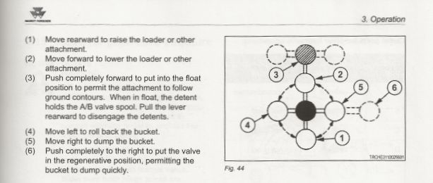

Discovered my FEL is supposed to have float mode. I can't find it. Tried every way possible to slip into float but my joystick simply won't go there (used force, speed, in motion, engine on/off, hard wiggle, soft wiggle... No go.) However, I have a "fast dump" mode extra position to the right that's not labeled nor listed in the owner's manual...
Could it be that my joystick insert is 90' out of rotation?
Or my FEL came with fast dump and no float, despite the manual?
Please advise before I tear into the joystick and open a can of worms!

Float position usually has a detent while fast dump just has more spring pressure. The detent is so it won't go into float accidentally. It may be pretty stiff if it's new.
Fast dump (also called regen) affects the curl cylinders while float affects the lift cylinders. I don't think they can interchange like you're thinking. Regen lets one side of the curl cylinders pistons feed the other to prevent cavitation.
The float on my Branson takes quite a bit of force to get past the detent. I'd be careful about doing that unless you're sure it's got float, because the internal parts on the joystick are often made from aluminium and plastic if it's a remote cable operated unit.
The float and regen are all in the valve. The remote joystick just moves the cables that are attached to the spools.

Regen can be an option depending on valve style. Some valves have regen as first position and standard dump as forth position Kubota BX 1850 was this way while other valves have standard dump as first position and regen as fourth position.
Is the OP has fourth position regen dump the spring caps should be similar length if he has float on the loader since that is also a 4th position.

This is how my joystick on my MF GC 1715 is defined.... Yours may be similar and yes there is a hard detent to overcome to go into float mode....

Thanks guys. What I know so far: I removed the rubber boot and found what I think might be enough slack in the stationary fulcrum to absorb the added force needed to force the stick into the detent. I'll have to go to Ace to get metric machine screws to resecure this brace.
Meanwhile, I'm convinced I do have the 2 stage bucket dump albeit the manual doesn't mention it
I'll get the screws and follow your advice: find the cap, check for rust, and retry the float.
Hopefully report back good news and pics tomorrow!
/ Joystick concern
#12
I found it!
The loose bracket wasn't the problem.
After reading your comments, I decided to put reasonable joystick force toward the float detent, then very carefully tap the valve with a body shop hammer.
That worked!
Thanks for all your input!
