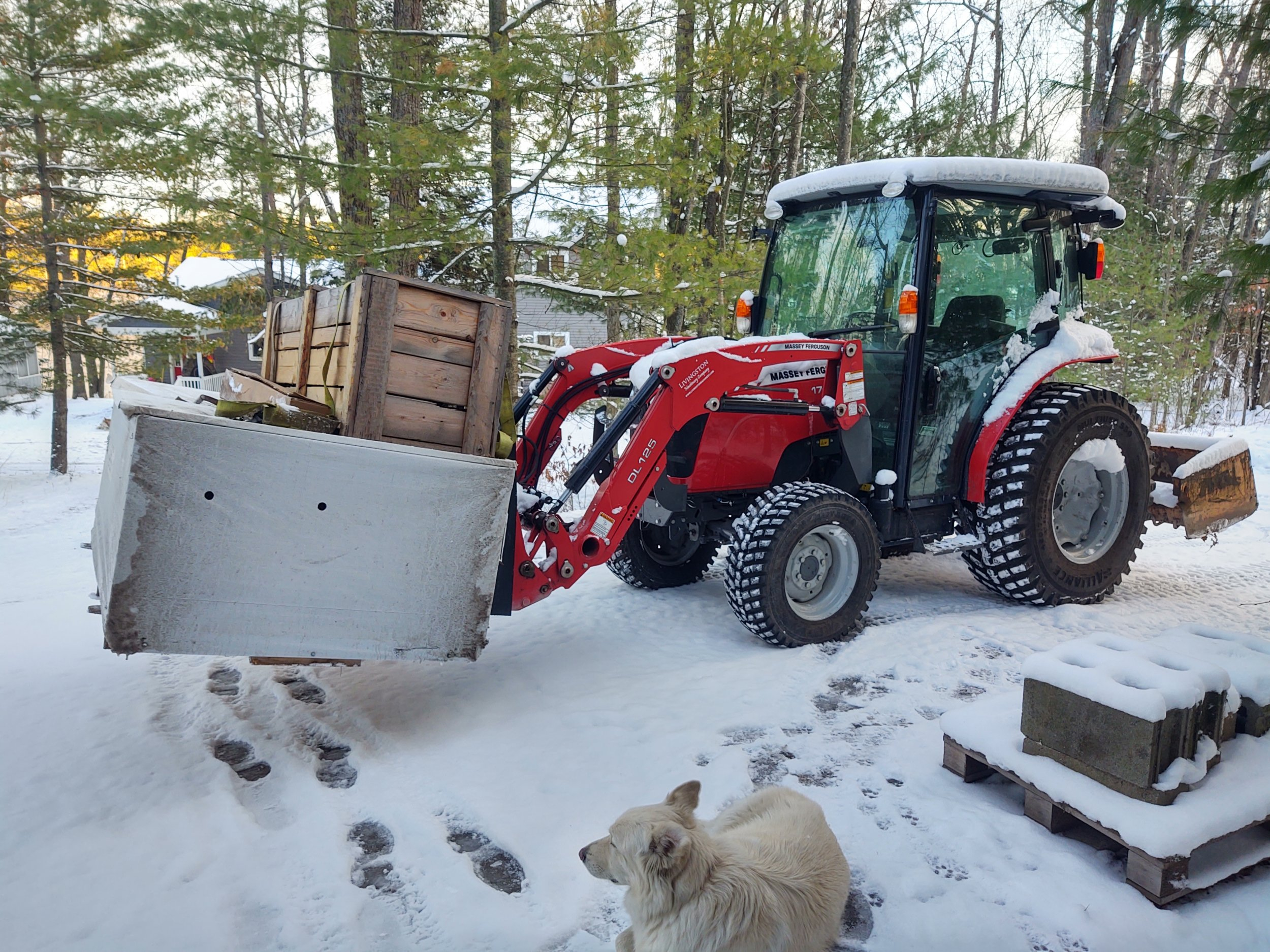

Not exactly, but they are a hybrid design tire also. I now realize I forgot to specify that these are Alliance 550 tires made by Yokomaha. They are a radial tractor tire marketed towards municipal equipment or farm equipment that travels frequently on roads but still needs to handle heavy loads and have good traction off road. They are rated up to 40mph and 10,220lbs load at 64psi on the rears.
In my opinion, these or bkt ridemax 696 should be the "standard" option on compact tractors instead of r4's.
My local Kubota dealer employee said they were "R14s" that seem to be coming through on many new tractors. I failed to get a picture but they sure look like the ones you show. VERY close anyway. Maybe a very slightly different tread pattern in the middle. The ones I saw are on an L5460 and are Good Year brand. I can see these becoming extremely popular because they will satisfy a greater spectrum of users than any other single tire -- including most private individuals (those not operating commercial loaders , those people will still want R4), a large % of the AG users who are doing a lot of mowing but not plowing, and many who want something good for snowblowing and turf cutting but not satisficed with turf tires. I predict they will take a big market share over the next couple years.

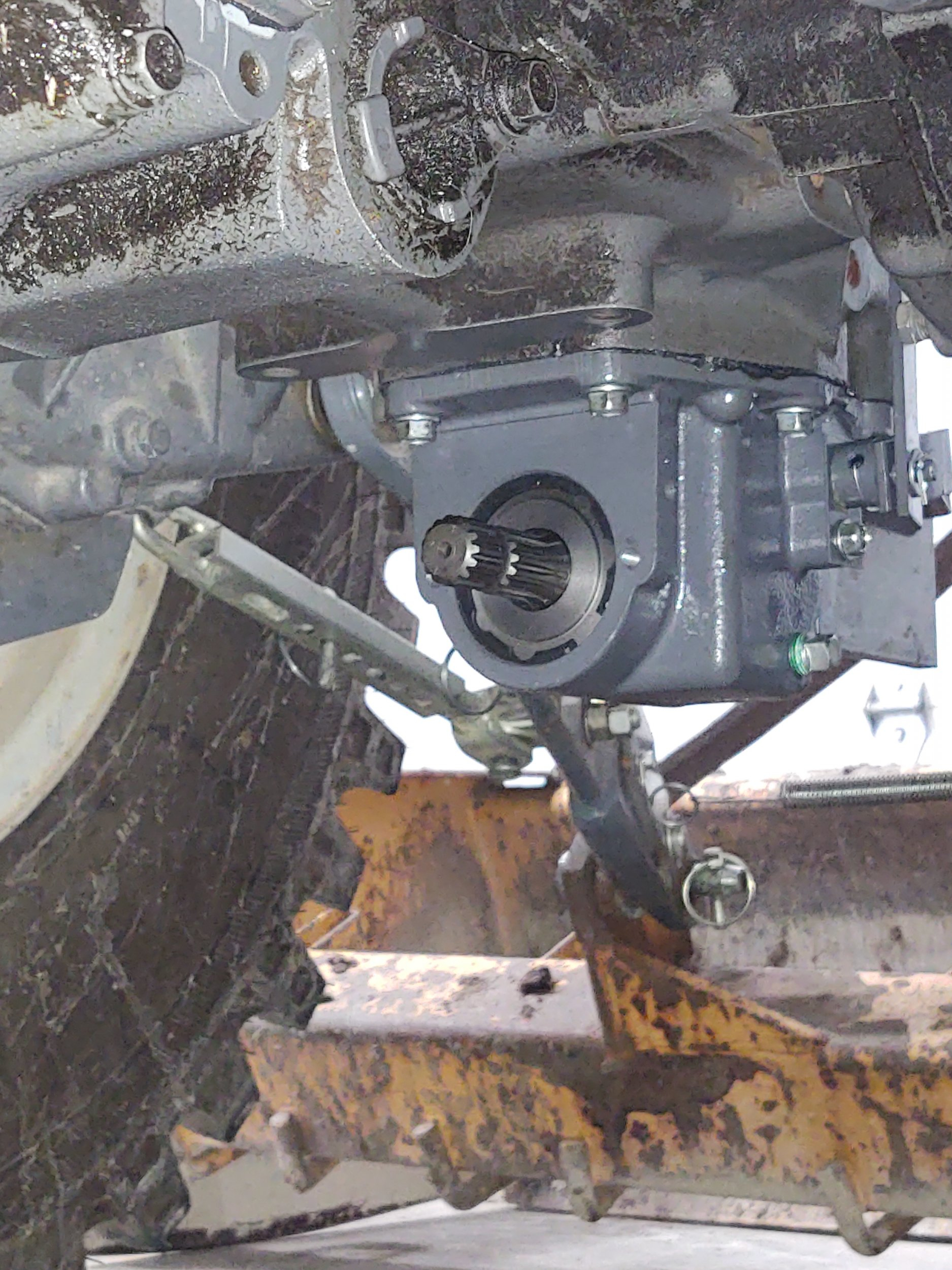

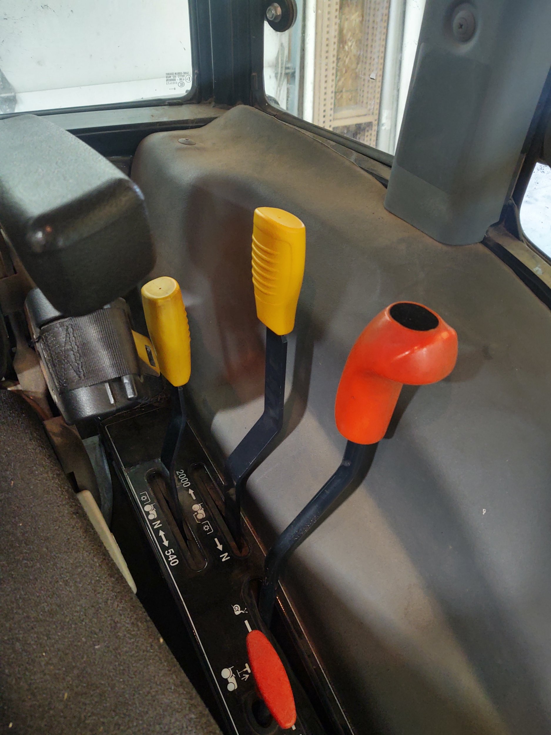

Looks like I've got some work to do! Ups man dropped off mid pto kit, 2nd and 3rd remotes, and a wr long 3rd kit. Mid pto to run the front mount blower, 3rd function for the grapple, and rear remotes for top/tilt/hydraulic rippers on box blade.

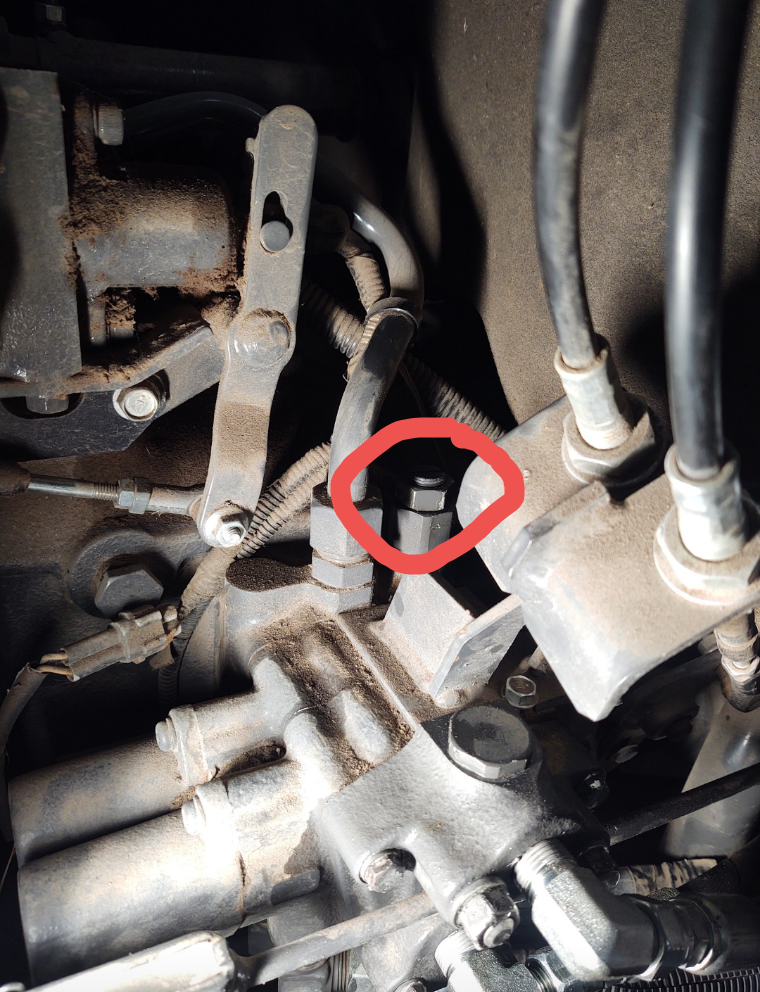

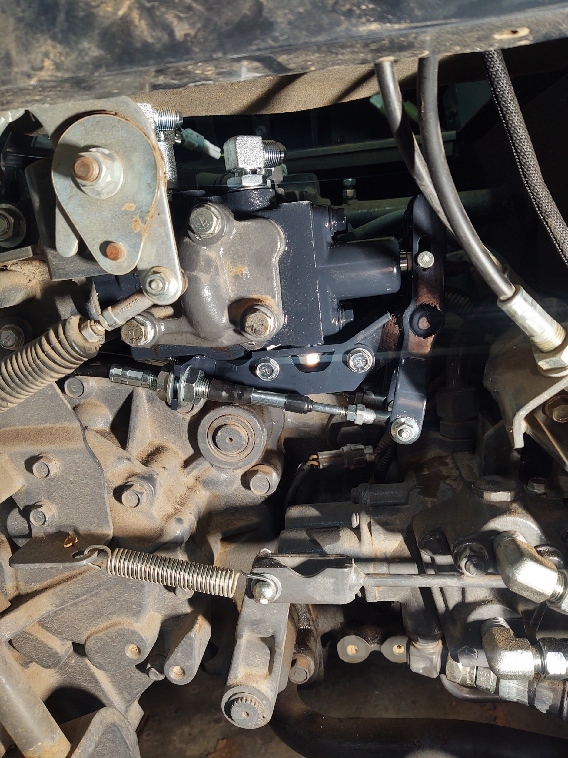

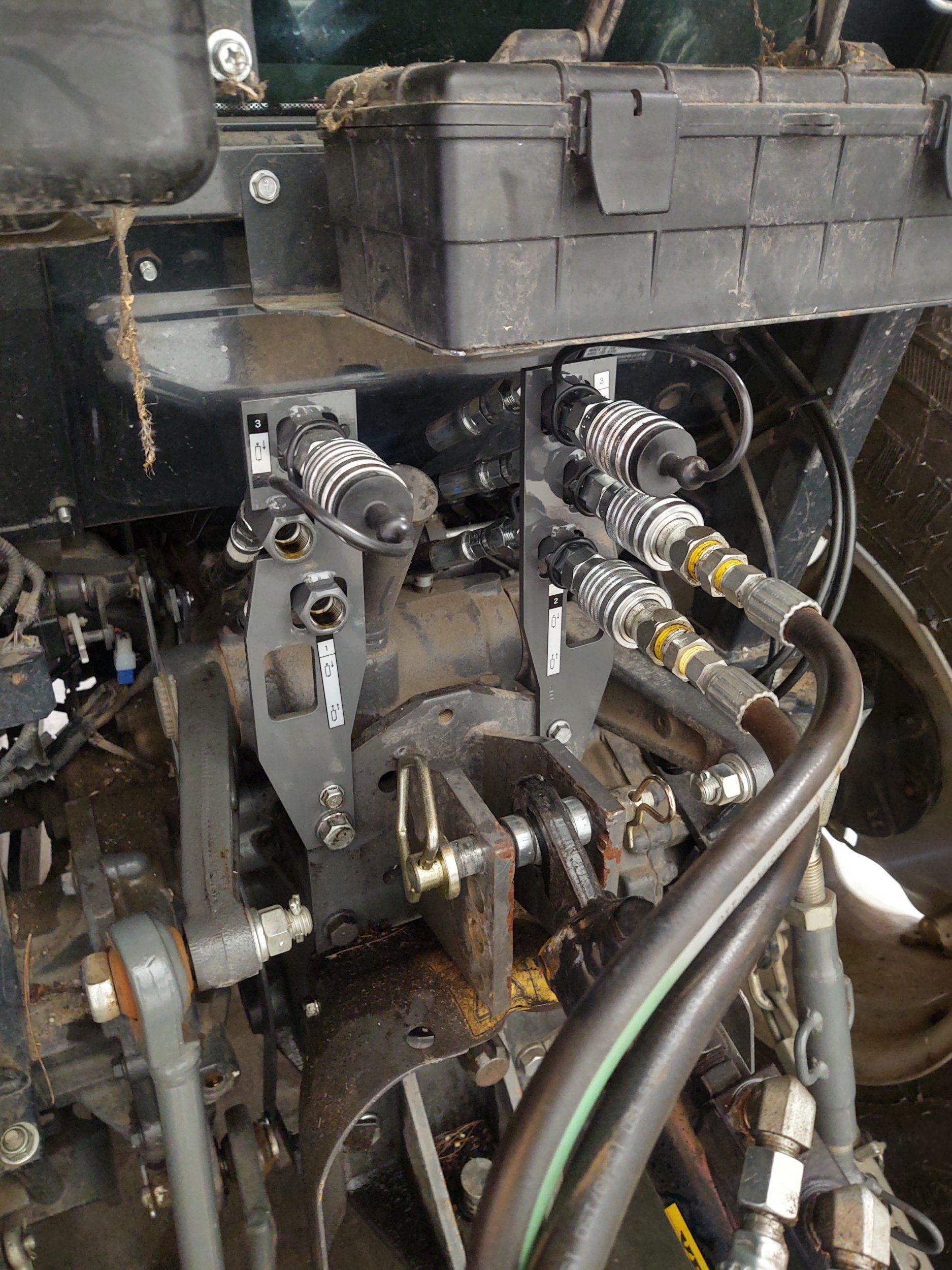

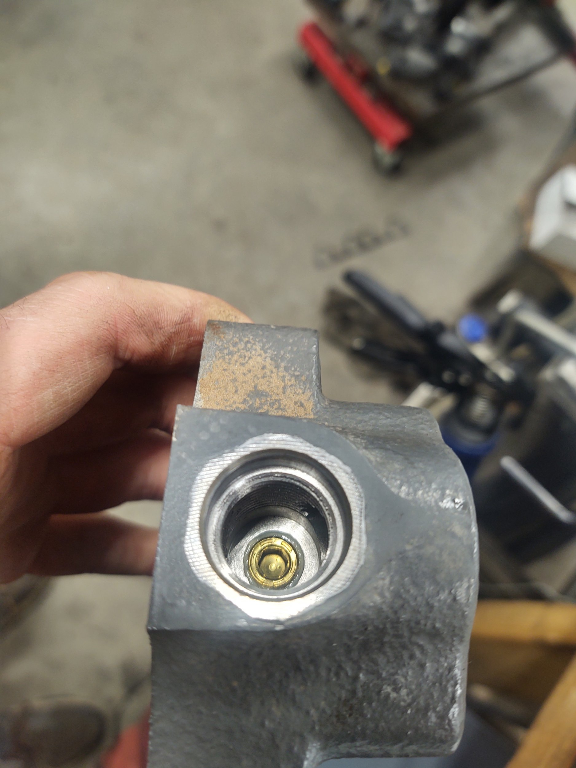

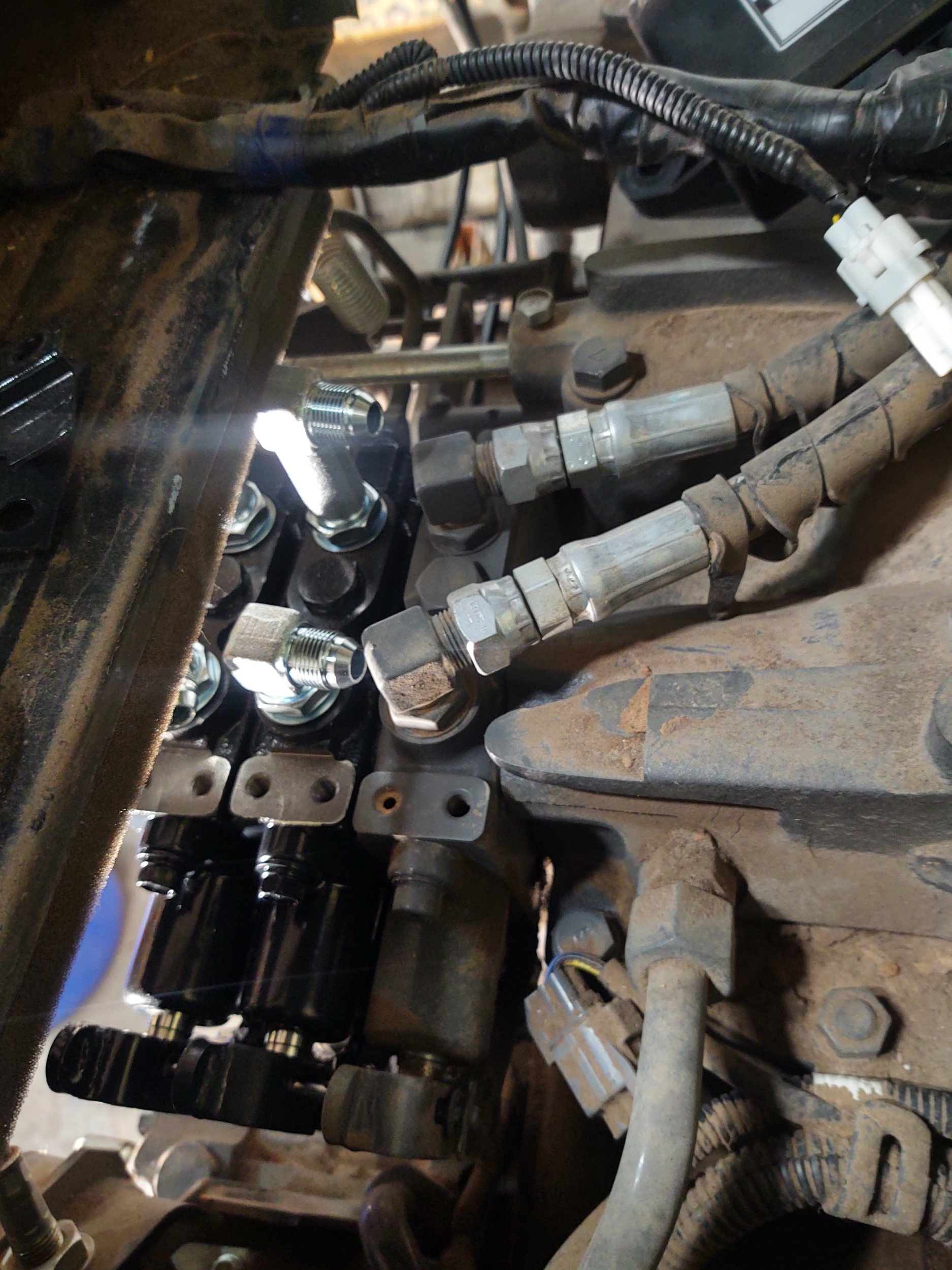

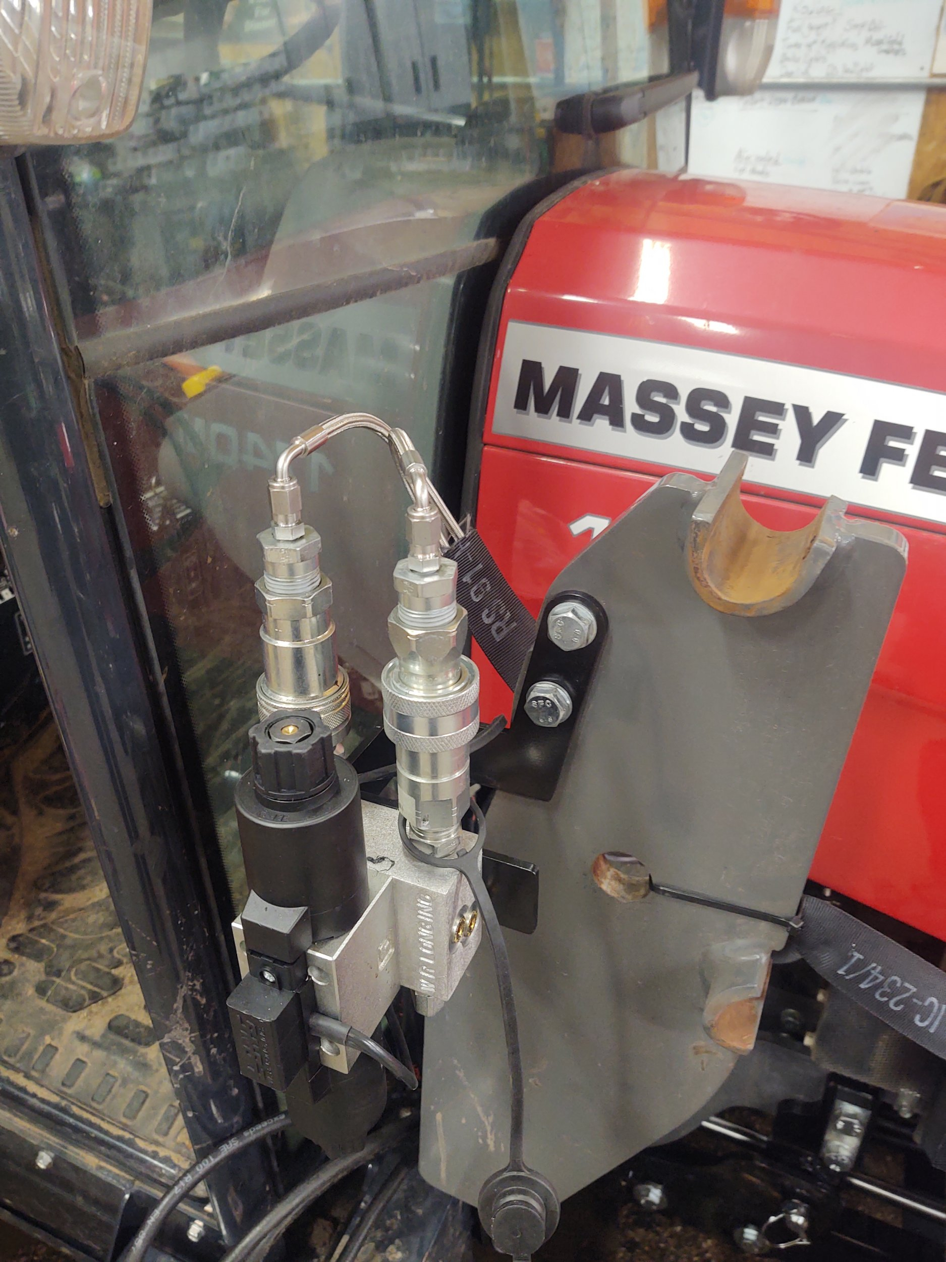

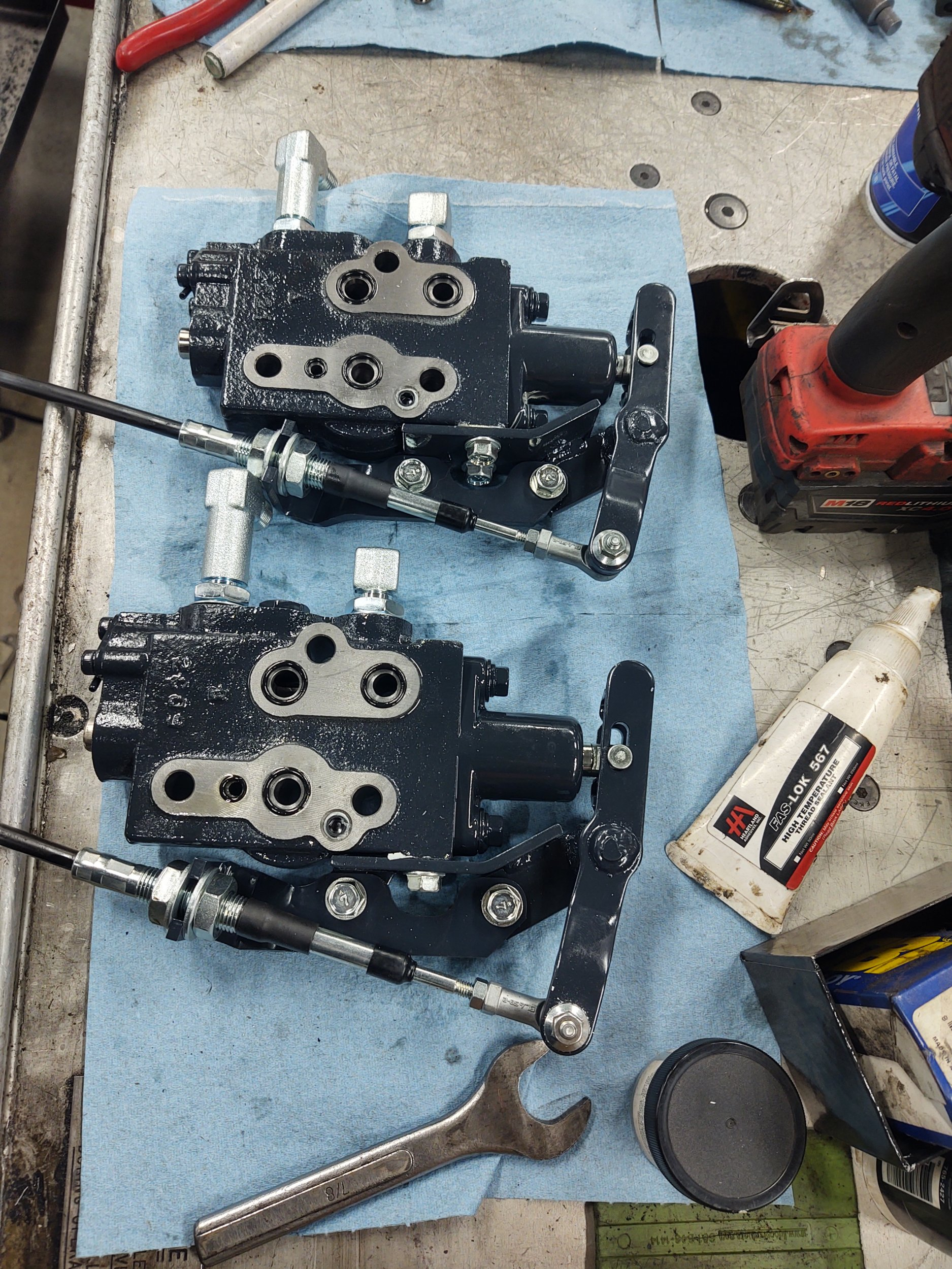

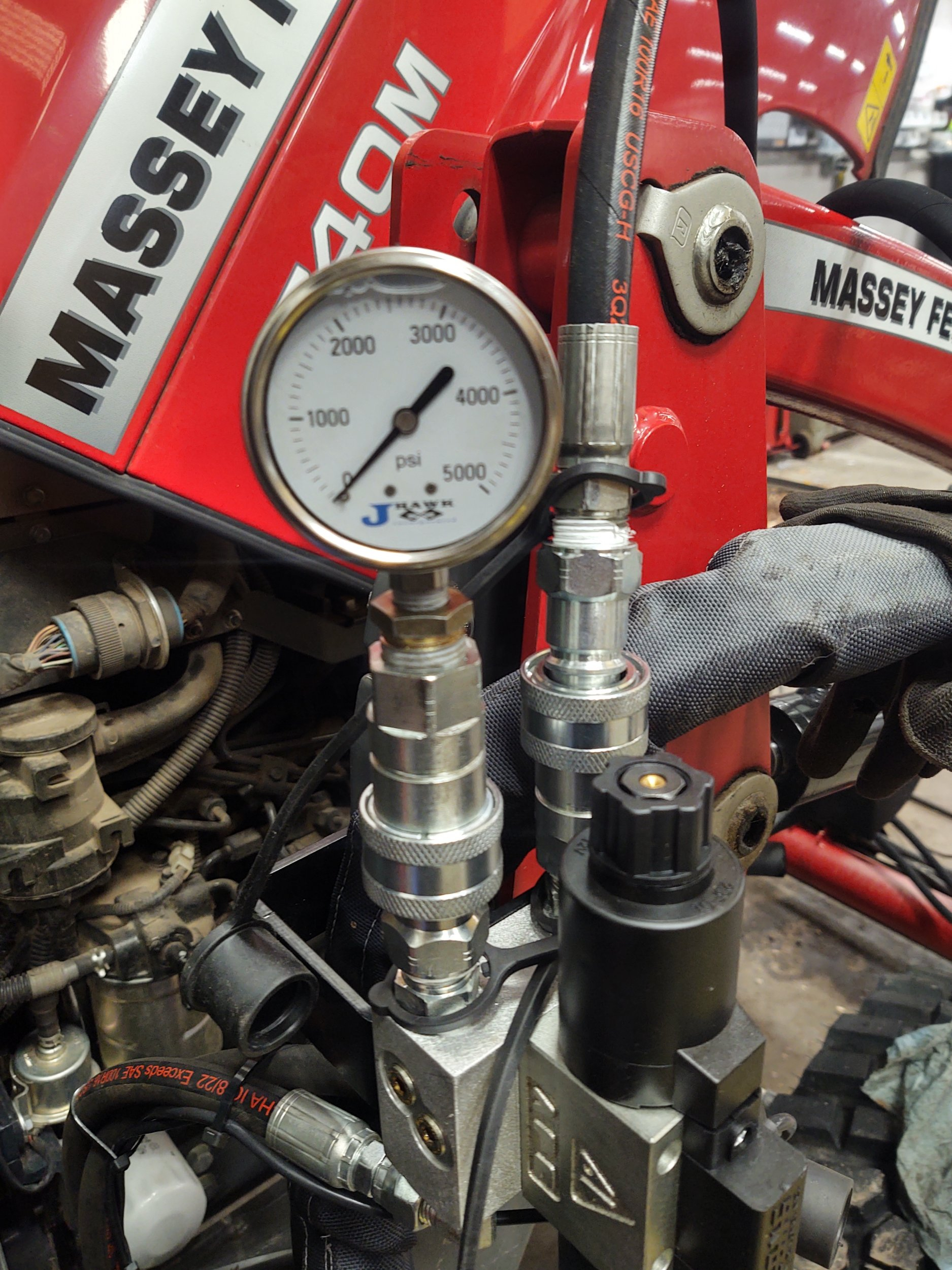

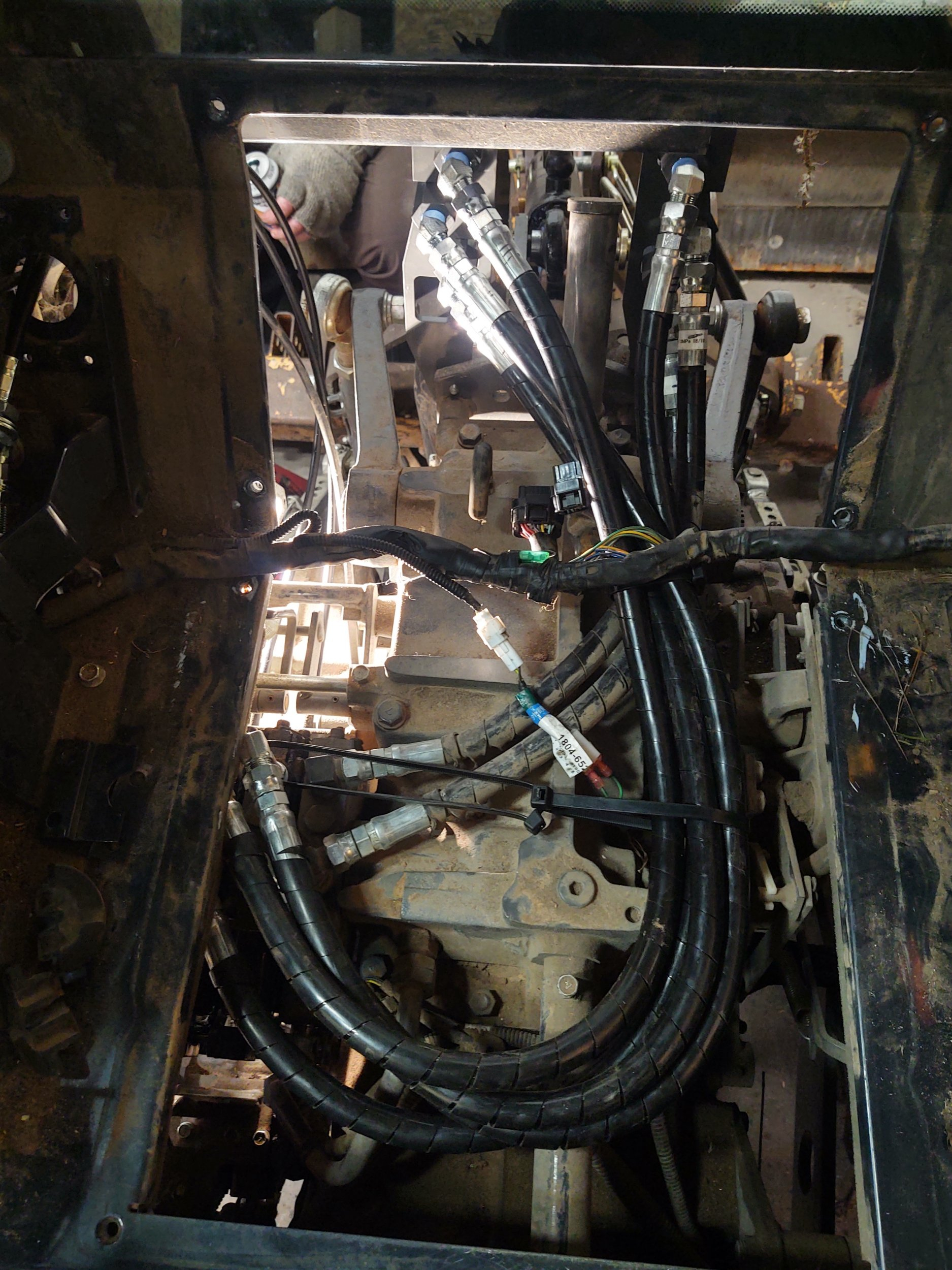

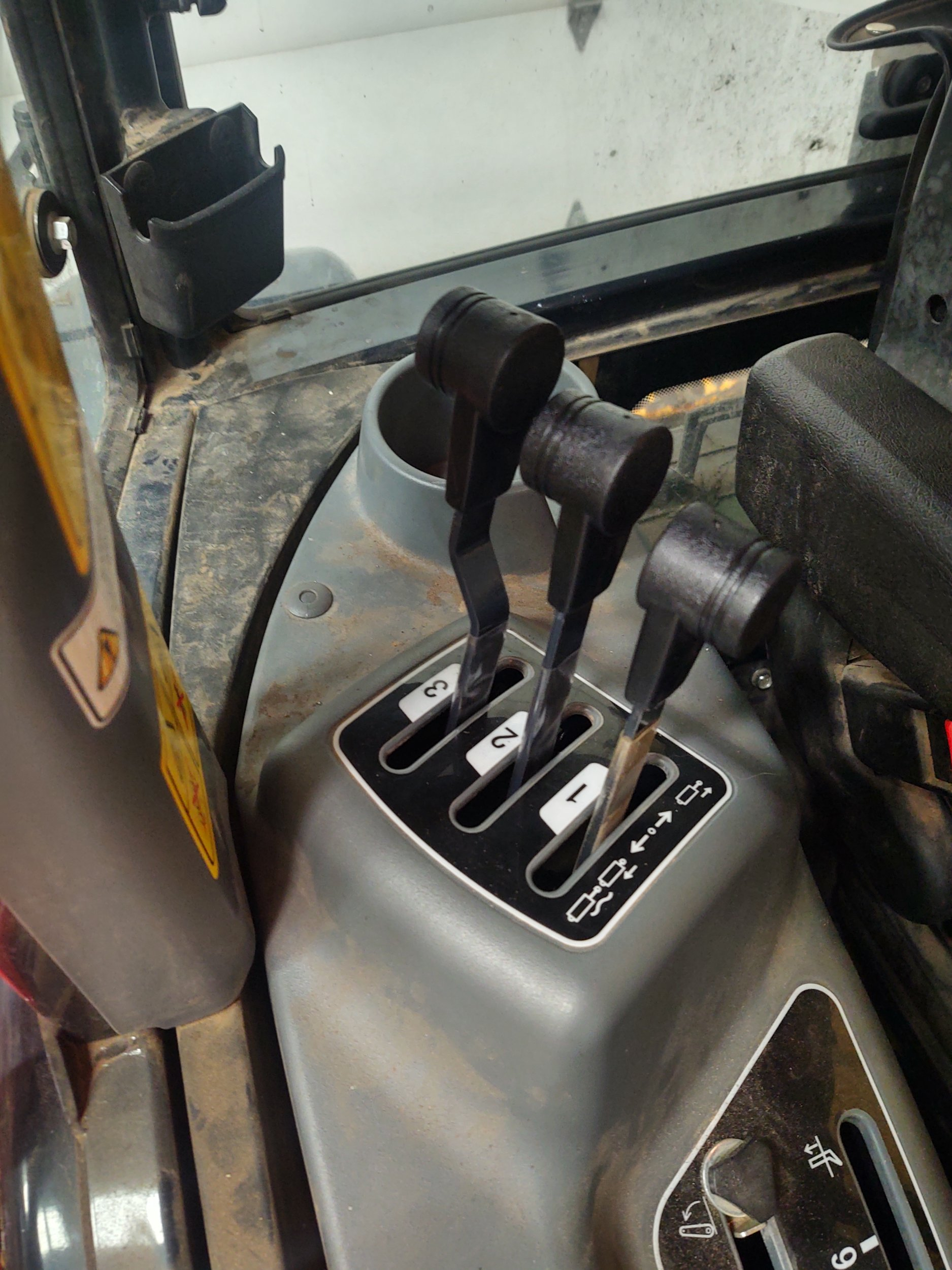

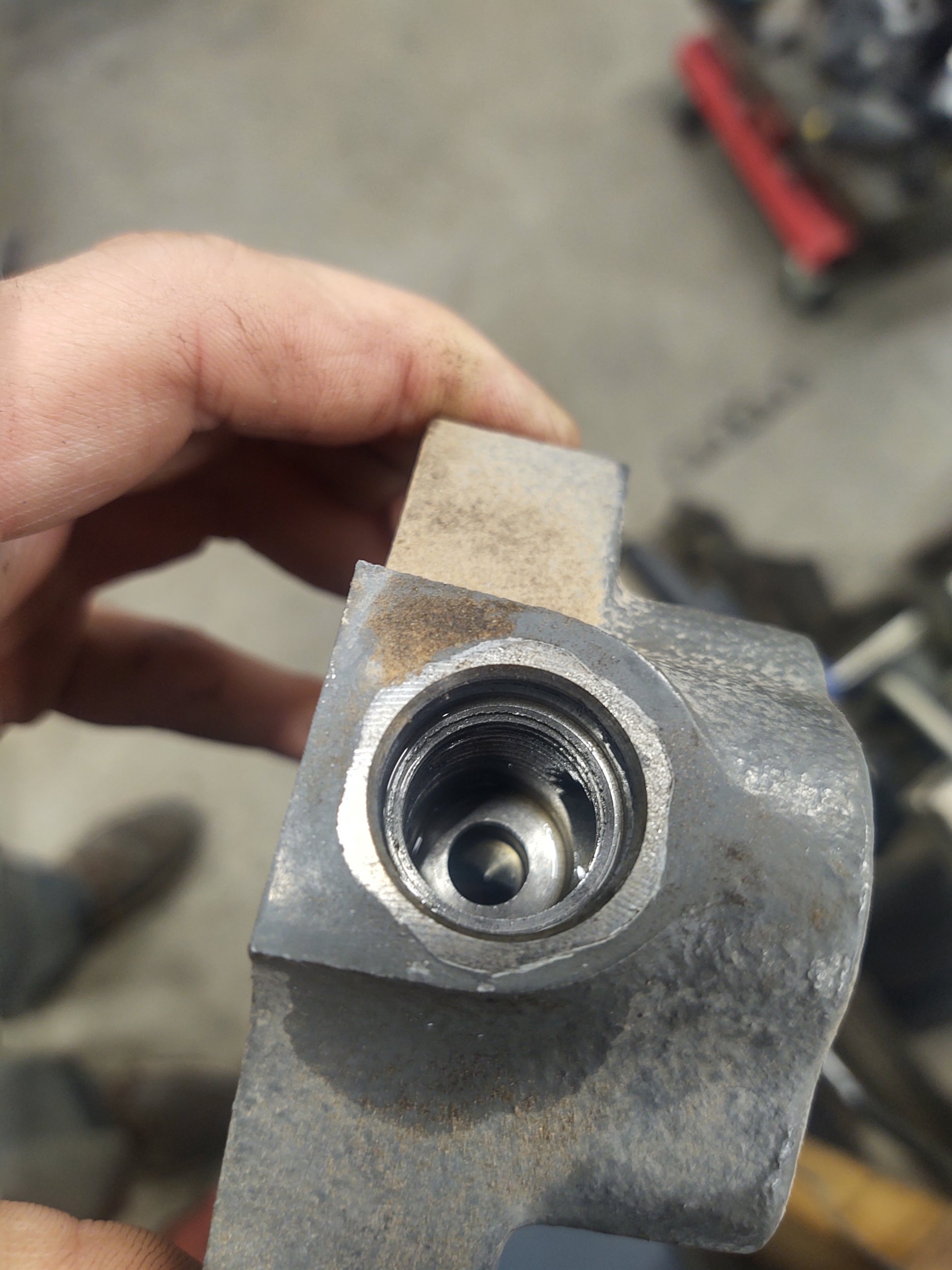

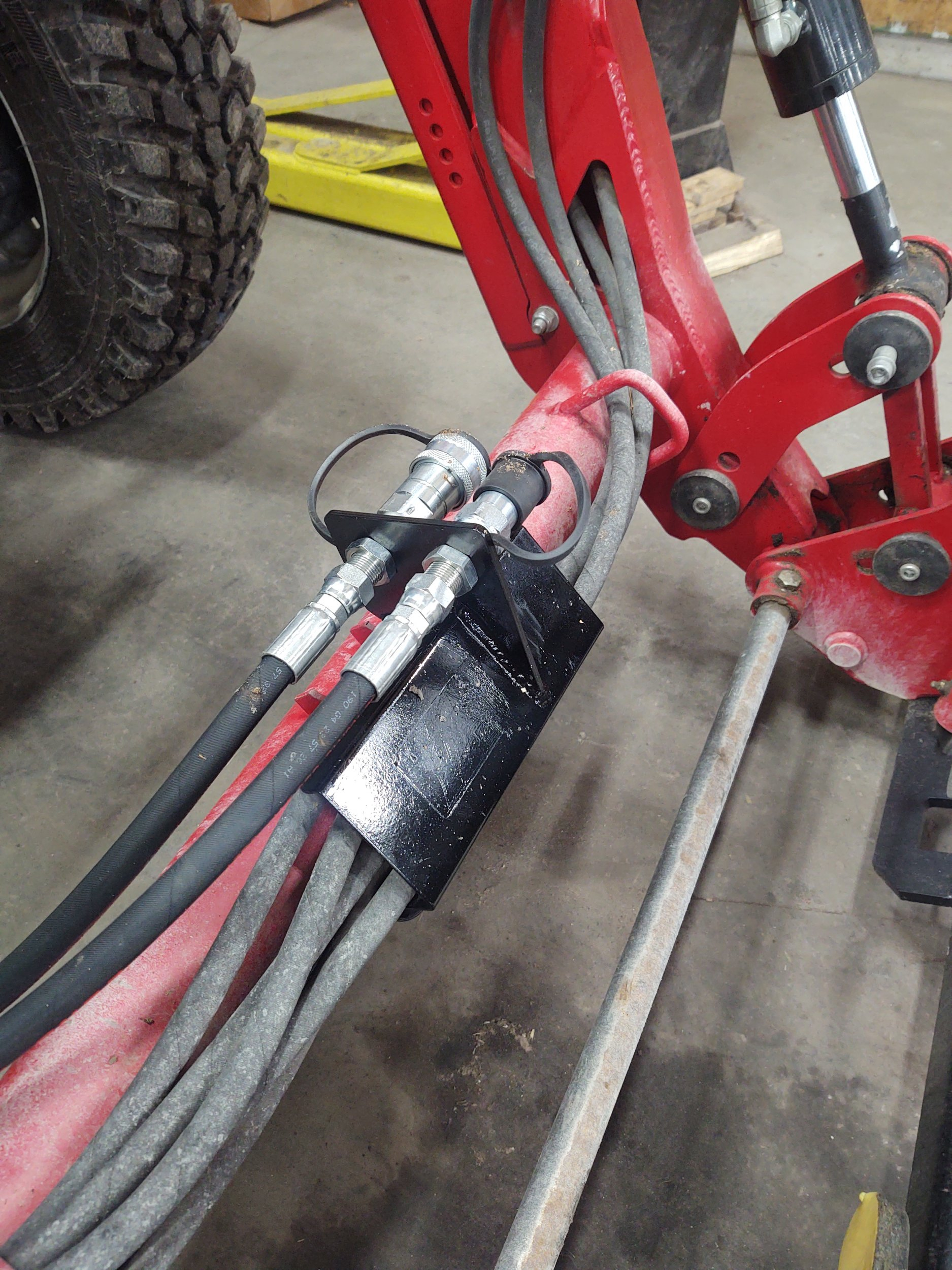

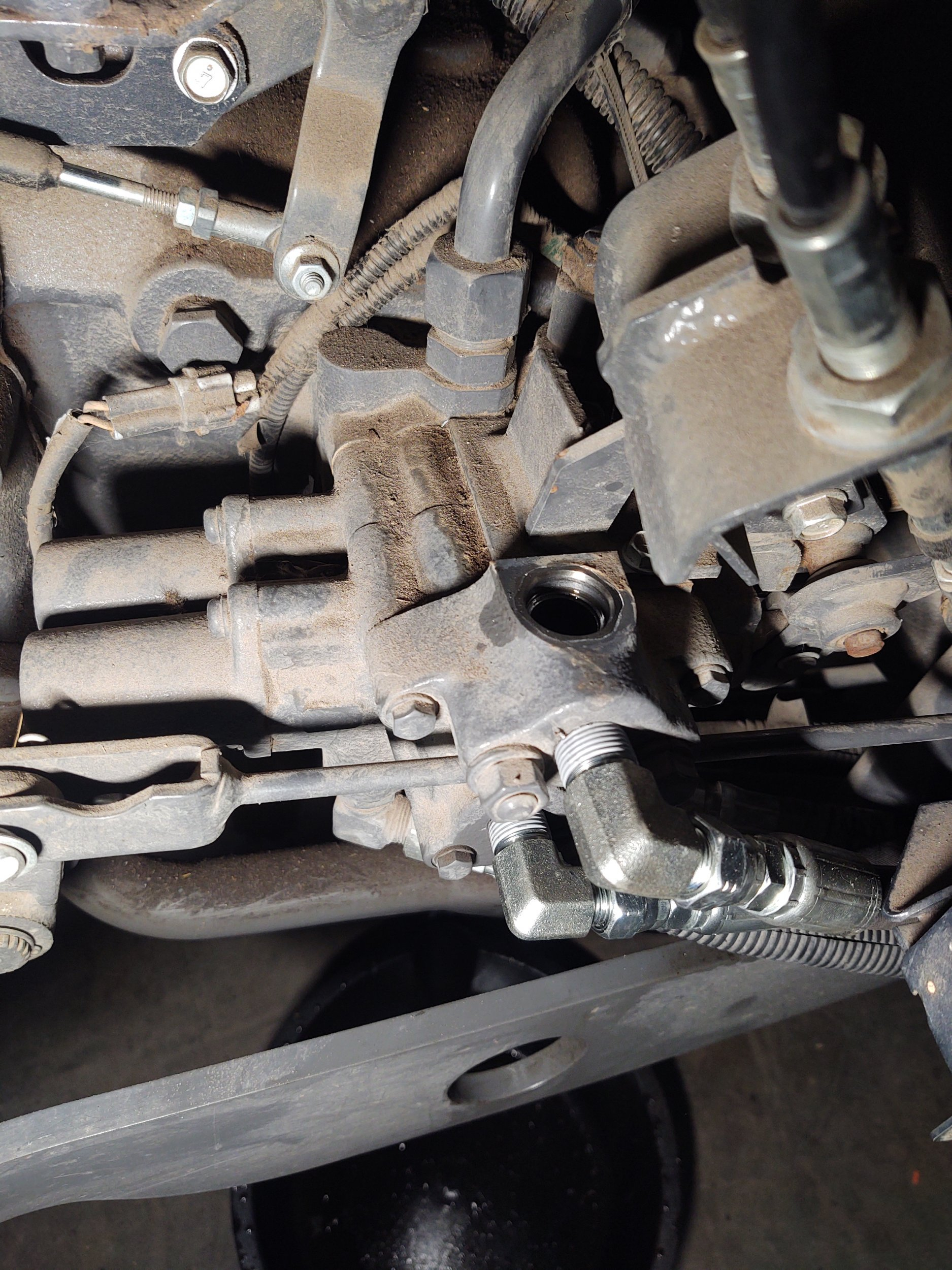

Spent a day and a half putting the 2nd and 3rd rear remotes, bumped loader valve relief pressure from 2300psi to 2700psi, wr long 3rd kit, and mid pto on. The front mount blower is supposed to be arriving in the next two weeks so I made use of time when the shop was closed.
For anyone else looking at doing this job, save yourself the $105 on the silly massey power beyond plug. Simply drill/tap the port for an 1/8" npt pipe plug.

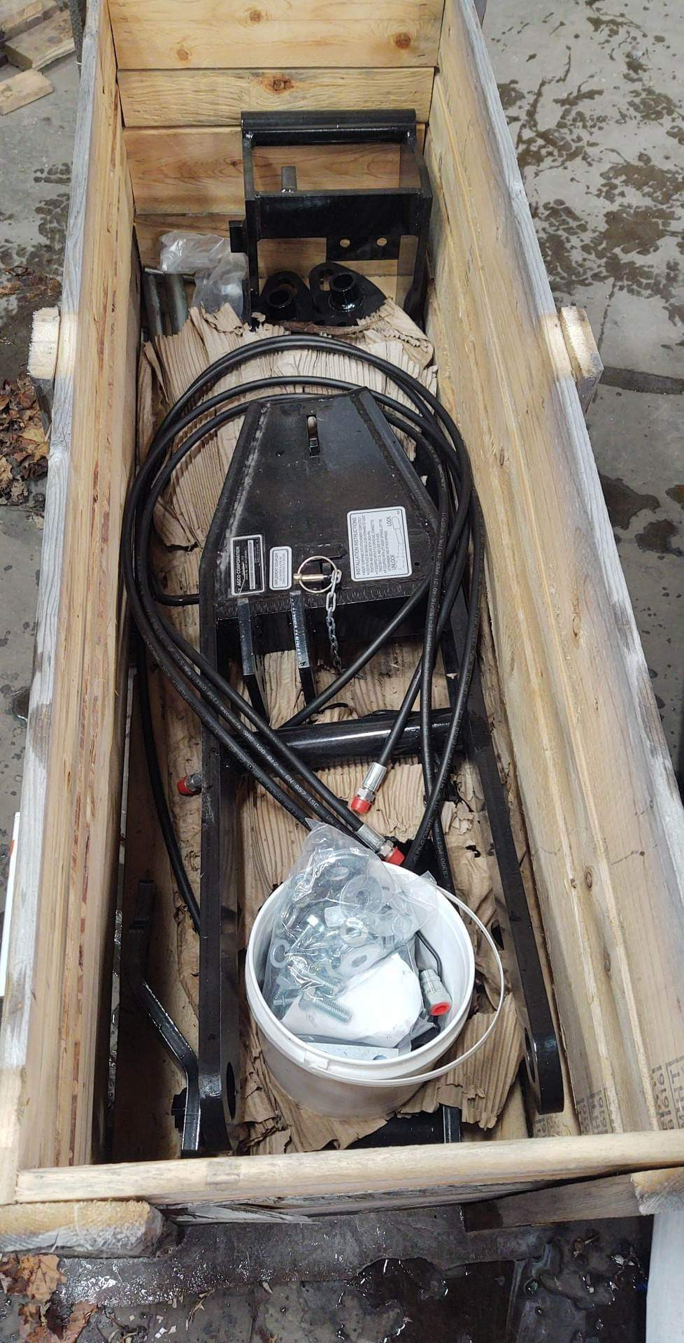

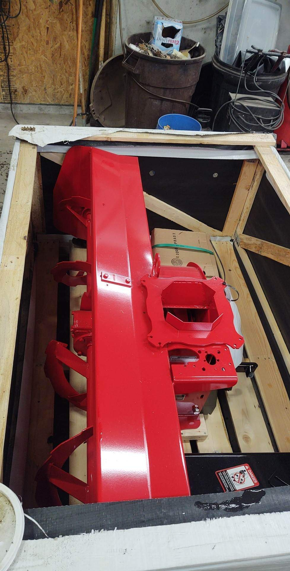

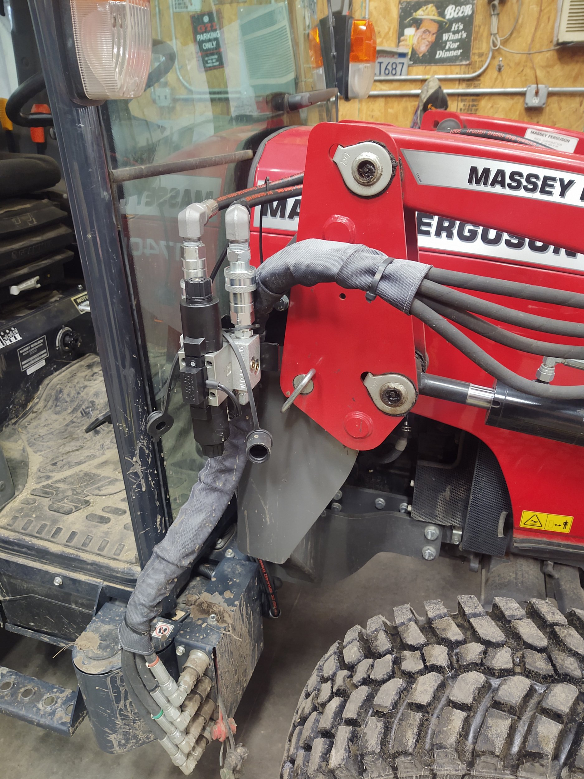

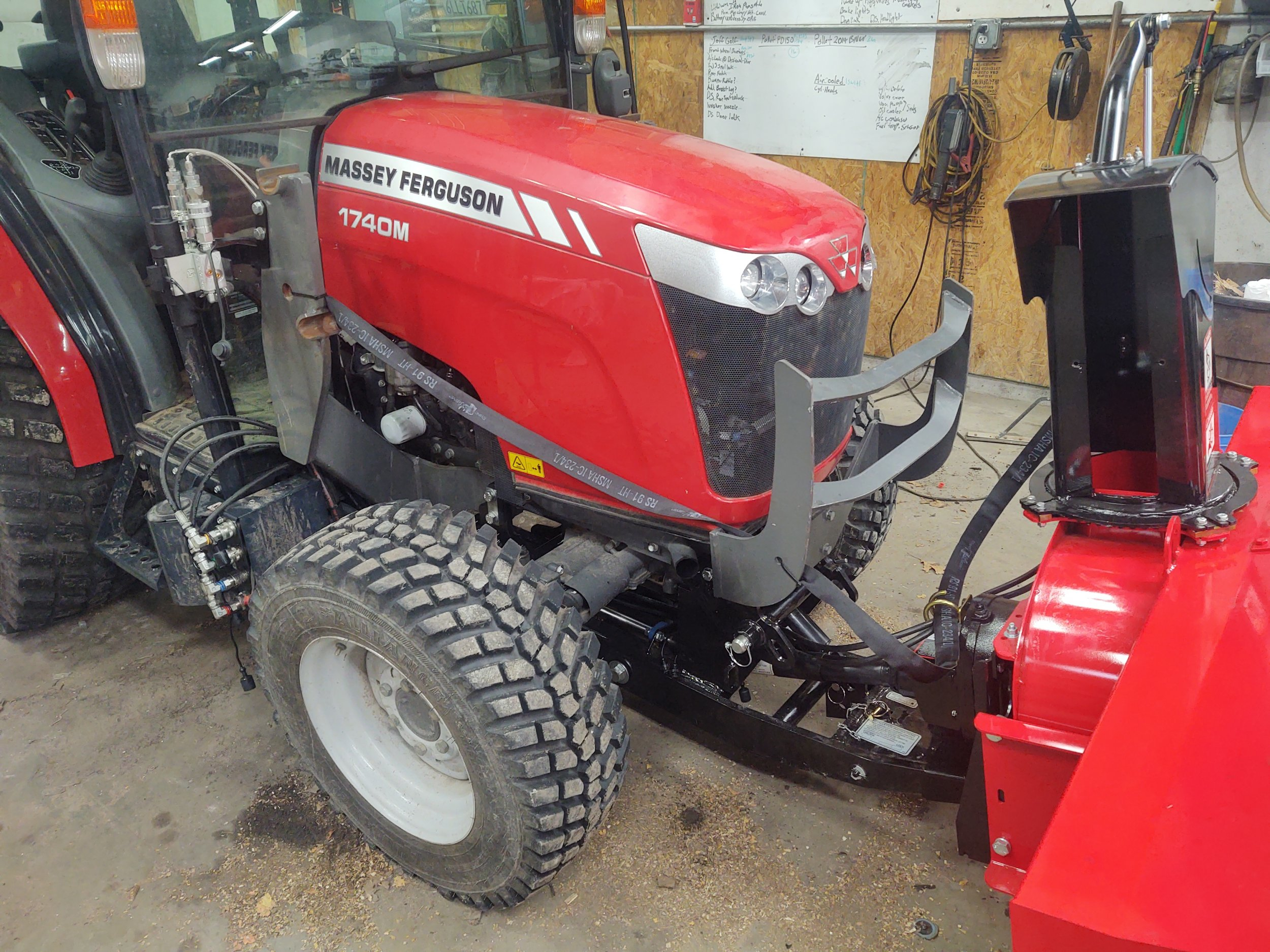

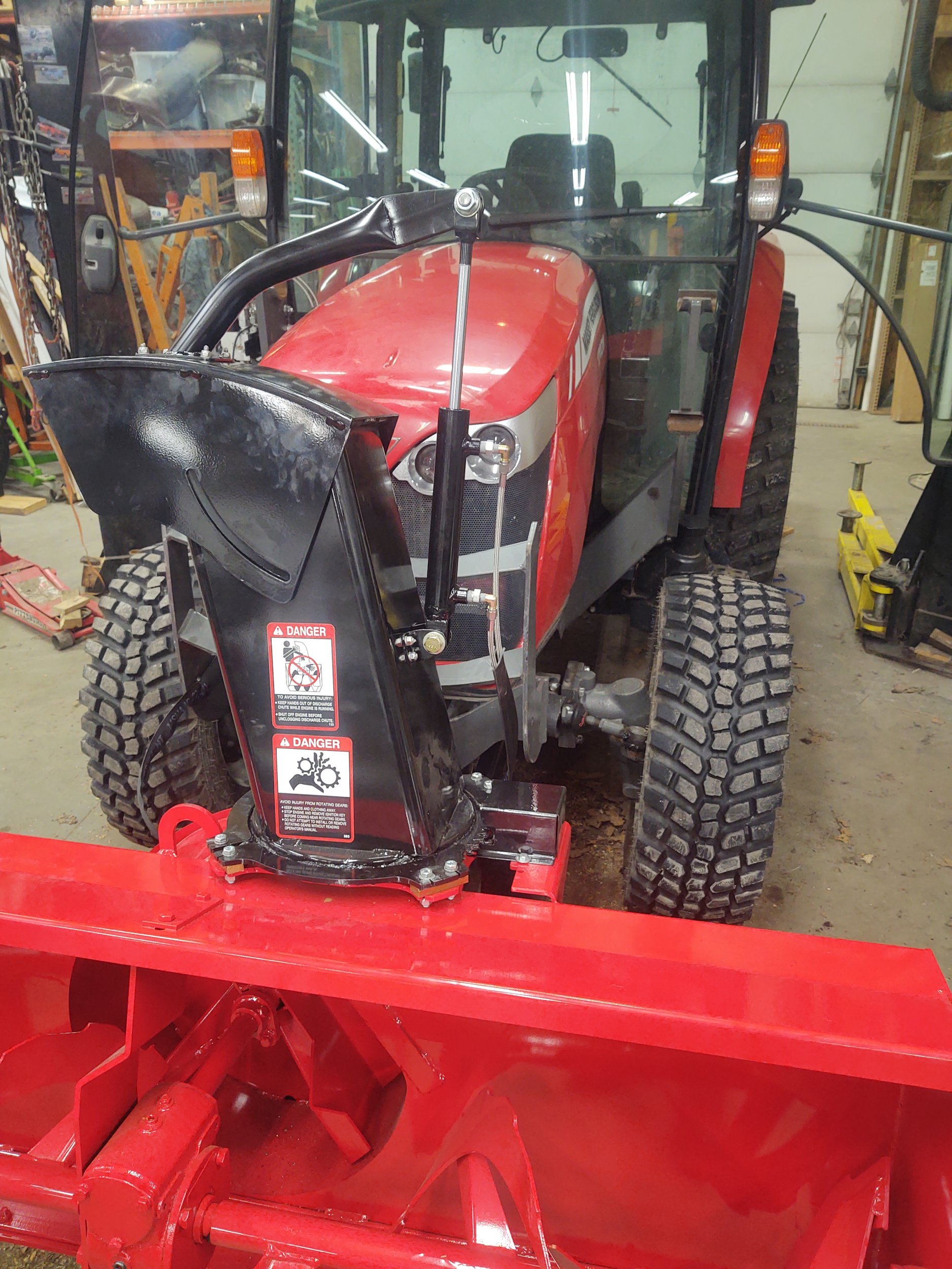

Dealer called saying the blower kit came in! It was definitely not quite "bolt on" like you'd expect though. A handful of wrong hardware, holes too small, and the latch on the quick connect mechanism needed tweaks. But the war was won and then mounted a 1x6 hydraulic ram for the chute deflector that runs off the wr long 3rd function valve.

I GUARANTEE you will love that front mount blower. Didn't notice if you have Hydrostatic drive but if you do, you are GOLDEN.
I leave my loader on with the blower. I mounted a hydraulic-pressure rated ball valve in the lift arm line. Its just suspended on the hoses, but the mounting points are close, so it doesn't sag or droop.
Then when Im ready to mount the blower, I remove the forks/bucket outside, get into the shed and raise the arms up about 2" higher than i could bump my head on them. Roll the tilt all the way back. Close the hydraulic valve, shut off the engine, then put the control levers in float, raise, lower everywhere, to drain off any latent pressure.
Then pop the lines off and tie them up. I made a hook on the loader frame somewhere and hang a tin can from it and put all 4 hose tips in the can to keep drizzling hydraulic oil off the glass.
Then mount the blower under the raised arms. I've done this since 2016--loader has never been off since I discovered this. Once in a while the arms interfere with the flow of snow from the chute but usually I can adjust my way out of that.

I hope so! I had a front mount on my old new holland so this is what I'm used to. I looked at inverted 3pt units, but they were hardly any cheaper when you added a rear scraper blade and hydraulic chute rotation/deflector.
That's not a bad idea! I'm so used to the involved process of swapping between the loader and blower on my old NH, so the fact that both the blower and loader are quick connect is spoiling me.
