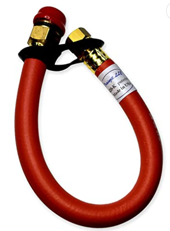

Most machines these days use an oil drain hose which is usually more convenient and less messy than using the old style drain tube,
You can buy drain hoses on Amazon for pretty much every mower engine around. It would probably make it much easier and less messy when changing oil.

Hi guys, I bought the John Deere OEM easy change conversion kit and the conversion kit's oil drainpipe is way too short to clear the Z365R's Chassie. Therefore, I purchased the Briggs and Stratton's engine drain hose, which is much longer than the easy change conversion's drainpipe but, still not long enough to clear the Z365R's Chassie and prevent oil spilling on the Chassie or rear tire, while draining engine oil. My challenge now is to find a way to add another three or four inches to my Briggs hose so I could bend the hose to the rear and drain the oil past the chassie.

I don't know the length of the MIU14391, Z255's engine oil drain hose. However, the Briggs and Stratton oil drain hose #1723165SM is the one I uploaded in my post.
I have decided to try a three-inch 3/8" iron pipe to the oil drain opening on the engine to extend my Brigg's 1723165SM hose to make it longer exit the mower chassis without making a mess when draining the oil
