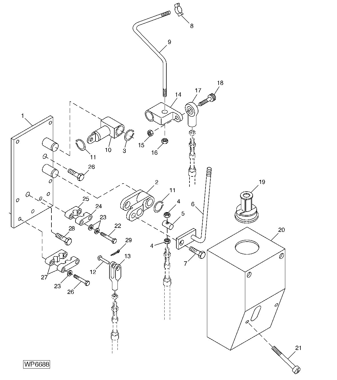

OK when I push the joystick all the way ahead it does not go into float. Any thoughts would be appreciated.

Try with bucket couple inches off ground and snap the lever forward into the float detent should feel it set.

Sorry about not getting back to you. My phone never told me that i had some else reply to this and i have not looked at my old posts for awhile .It is a John Deere 7810 with a factory joystick. It seems like it actually skips the detent. I do feel it jump and it kinda acts like it is putting pressure on both sides. I'm thinking that the joystick is wore out or needs adjusted. I just hope its not in the valving.
/ john deere loader joystick problems #5
Just a thought. Start with it a foot or two off the ground. Push it all the way forward hard and hold it there. When it hits the ground give it a 15 or so seconds. Does it start raising the front of the tractor--it's exerting down pressure and not in the float position. If however it just sit there, it's likely in float position. You can further test if it's in float at this time by moving the bucket to dump which as the front tips down will lift the loader arms if it's indeed in the float position. As you rotate the bucket back the loader arms will go down. Now given you find it's in float when your holding the lever all the way forward but when you release the lever the lever returns to neutral then the detent is not holding it in float but float does work.
/ john deere loader joystick problems #6
The detent is actually at the valve not the joystick. But it is repairable, there is a kit that can be bought for about $60, assuming all other aspects are working properly.

My tractor might as well be a new-born baby to yours but it has a loader and probably functions the same way as yours. The control has lots of play in every direction before it operates anything but it still goes into a detented float position. My posted advise to you was intended to find out: 1. is your float position not working. OR 2. is it just not holding itself in that position.
If just not holding itself in that position it's most likely a worn detent which, yes, is probably in the valve but surely fixable.
If it isn't working. Well, is the lever simply unable to push the control far enough to engage the float position? Is it for some reason it requiring excessive force to enter that position? Is the valving for this position "broke"?

I'm guessing you have a JD joystick. I'd suggest to remove cover(parts key 20) and check all clamps & attaching parts for tightness. Again I guessed a control valve as there are a couple of valve brands. Parts key 40 is the lift spool detent repair kit.
