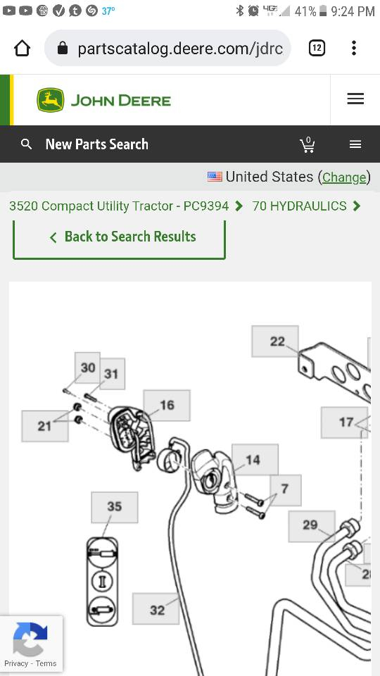

I'm looking for the part number for the 3rd function grip with wire harness that I can install on my joystick.
/ John Deere joystick grip part# #2

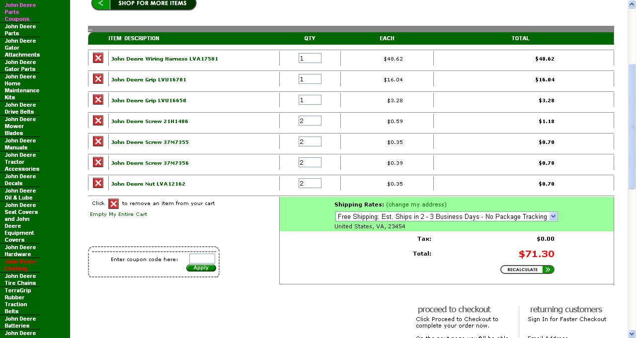

Don't know it as one piece, but the harness is LVA17501, the 3rd funtion grip half is LVU16650, and the other half of the grip is LVU16701. There are tapping screws and bolts to assemble it as well. Switch and handle halves are common across many tractor models.
Thank you J, I appreciate it.
Just finished ordering, again thanks for the info.

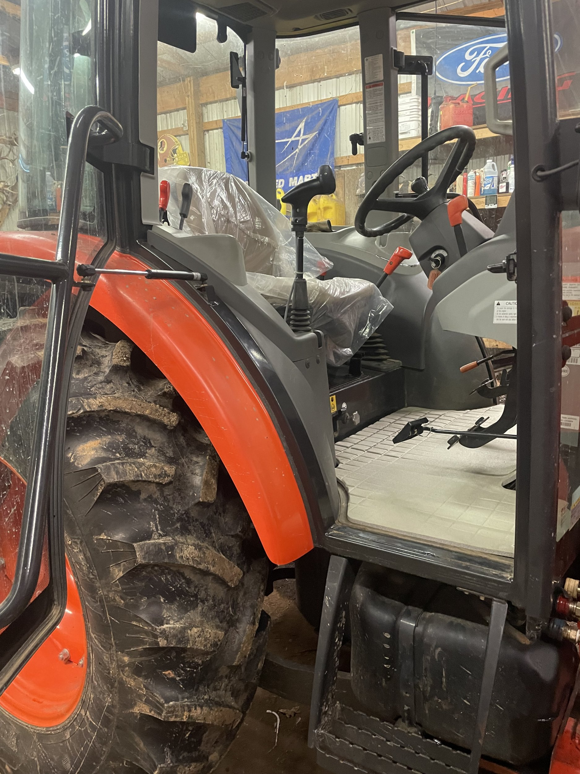

Just finished the install on my Kioti RX6010, I must say it's a nice addition.

That OEM 3rd function on the Ergo handle sure is nice (y)
That's what I've heard, probably will have to do a little adjusting to make it fit my loader stick.

On mine it wasn't a direct replacement fit, the diameter of my shifter was too small, so I just cut a piece of 1/2" copper pipe for a sleeve, and it worked perfect.
