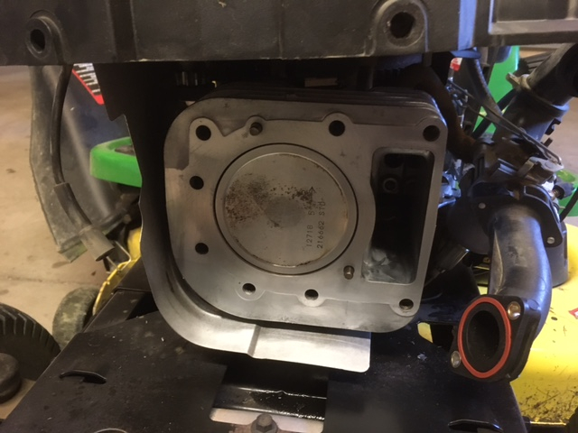

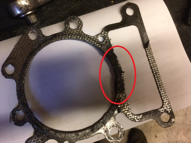

Was driving over to my son's place the other day when the 2014 John Deere D110 started to smoke. It has a 19hp Briggs and Stratton with regular maintenance. I had just changed the oil and thought maybe I had put too much oil in but it is burning oil as the oil keeps going down on dipstick. Any suggestions like an oil additive to loosen up a stuck ring before I have to tear it down and check the oil ring. Mower only has a 100hrs on it. Using conventional Pennzoil 10w30

Dollars to donuts, you have a failing head gasket.

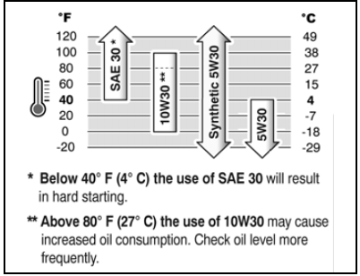

There are certainly things to know and watch for while replacing these head gaskets. If you posses a good mechanical knowledge, can follow their instructions and own a decent torque wrench- it is with in your reach to do this successfully. Typically in addition to a dropping oil level, the oil turns dark from the combustion gasses entering the crankcase. If you are hiring it out, keep the oil level up in the safe zone and get it scheduled in. 30 weight oil is recommended by Briggs. They like to sell their 5W30 synthetic, 10W30 meets spec as well as SAE 30 plus 40 degrees.

True, 30W is one of the oil types recommended in the OEM B&S Operator's Manual and Repair manual. It's odd that JD omits it in their manual. Below is the OEM oil chart.

It really isn't odd that Deere and the engine / transmission OEMs don't agree. But then again, it becomes Deere's world to the purchaser, right or wrong. Your chart seems to show 4) 30 weight oils. One of those potato /potatoe things....

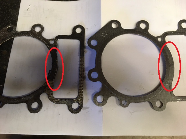

Seems like it is the head gasket, known problem with this style engine, a design problem with the lack of head bolts in one area. Cost of new gasket is about $25 and it is pretty easy to change
/ John Deere D110 Smoking
#16
Changed head gasket today
You can see where the gasket is damaged

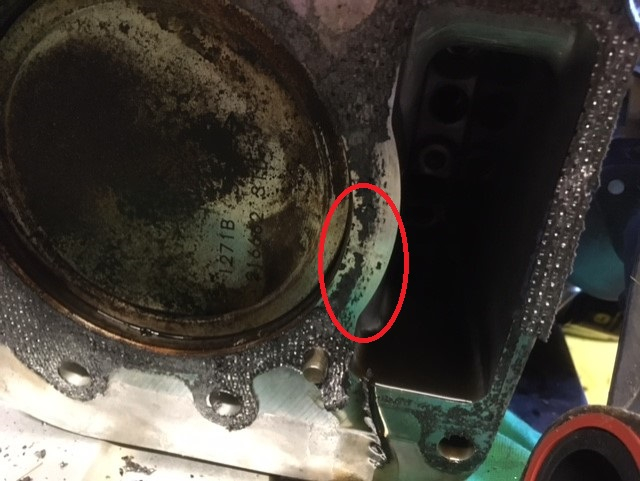

And where is blew by on the head
Clean up head
And installed new gasket, notice the size difference of the new gasket.
Ready to mow again

Obviously Briggs modified/improved the gasket design.
Looks good!
Not really. It is pretty much the same. The D110 came came w/ a 31" engine and the new gasket shown is a 33" gasket. Which certainly can be used. Briggs upped the torque specs from 220 to 250 rather than make a legitimate fire ring gasket. Rarely do they come back, but it happens.
