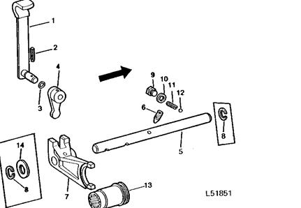

I found the problem on why the pto does not work. The groove pin that goes into the arm is broken. Does anyone know how to get the pin out? I have tried plyers and vise grips but no luck getting it out.
TIA
   / John Deere 820 #39
Not sure which arm you are referring to, can you be more specific?
If what you are talking about is a roll pin, I usually drive these out with a flat round punch of the proper diameter to match the hole. If it is mushroomed you may need to saw this flush with the surface first then use the punch.

This is the pto lever that engages the pto. The groove pin that goes through the arm is broken. The pto lever just slides around on the shaft. I removed the rockshaft housing and I can see the pin. When I try pull it out it won't move.
