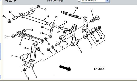

Are you referring to the split pin that attaches the lever #1 to the eccentric lobe #4?
/ John Deere 820
#42
Yes, but it is not a split pin it is a solid steel pin.
/ John Deere 820 #43
Well it is hard to drive this out if it is suspended in the air I am sure. If you can use a cutoff tool to remove the part sticking out will this allow you to remove the part and then put it in a vise to clean up?
I am guessing this is what you meant when you said the lever would move towards the wheel? I was thinking more of bending than the rod sliding in and out.
Seems like an unusual place to use a solid pin to me. What is supposed to hold the pin in place? Other than being pressed in.
/ John Deere 820
#44
It looks like to me the only way to get it out is to remove the lever (1) but my manual or service manual doesn't show how the to remove it.
/ John Deere 820 #45
Is there room to get a punch or something in to the piece marked #4 so that you can drive the lever and stub shaft outwards? This is assuming the pin is sheared and friction is the only thing holding #4 onto the stub. I looked up that #4 part and with the pin and oring is about $80 bucks try not to damage this.

Well I didn't do something right. When I put rockshaft cover back on and started the tractor the PTO works great but the lift won't work. It comes up but won't go down. I took the cover back off but I can't see what I did wrong.
/ John Deere 820 #53
There is a bolt with a small tab in the center of the rock shaft cover that you can access beneath the seat, This is the rate of drop control and it works independently of the rockshaft control lever. If you screwed this in tight it will still allow the arms to go up but will not let them go down. You use this adjustment to control how fast the implement is allowed to drop. Adjust it so that it akes about 2 seconds to fall from fully up to the ground. You adjust this for various implement weights, keeps from damaging the implements. Turn this counter clockwise to open the valve.
This would be pictured as #9,
/ John Deere 820
#54
I tried moving that but it did not change anything. What does number 7 do and does it attach to anything?
/ John Deere 820 #55
#7 controls the pressure and return valve in RS piston housing.
