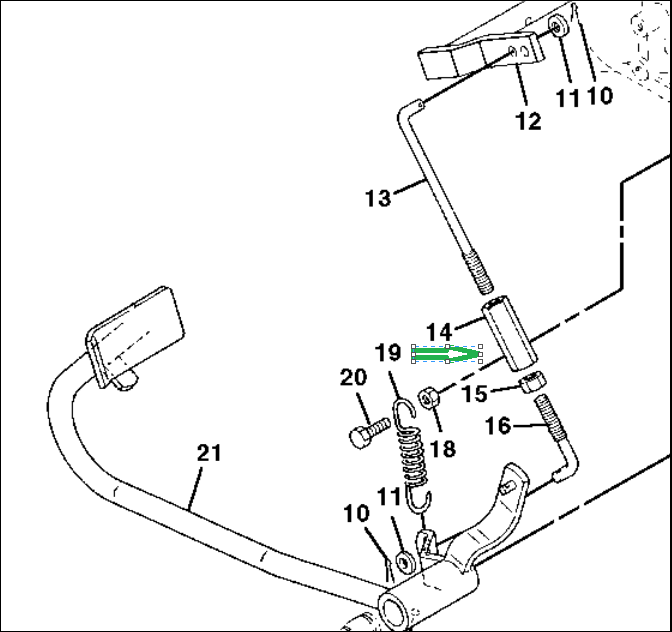

Bringing this old thread back to life. Can someone describe how you measure the free play and then where to adjust it if needed?
   / John Deere 770 Clutch Adjustment #10
Pedal free travel is determined by how far pedal can be moved forward or down before contact can be felt when throw-out brg contacts pressure plate fingers or diaphragm which ever applies. Adjustment is made by turning turnbuckle the correct direction to gain correct clearance.
