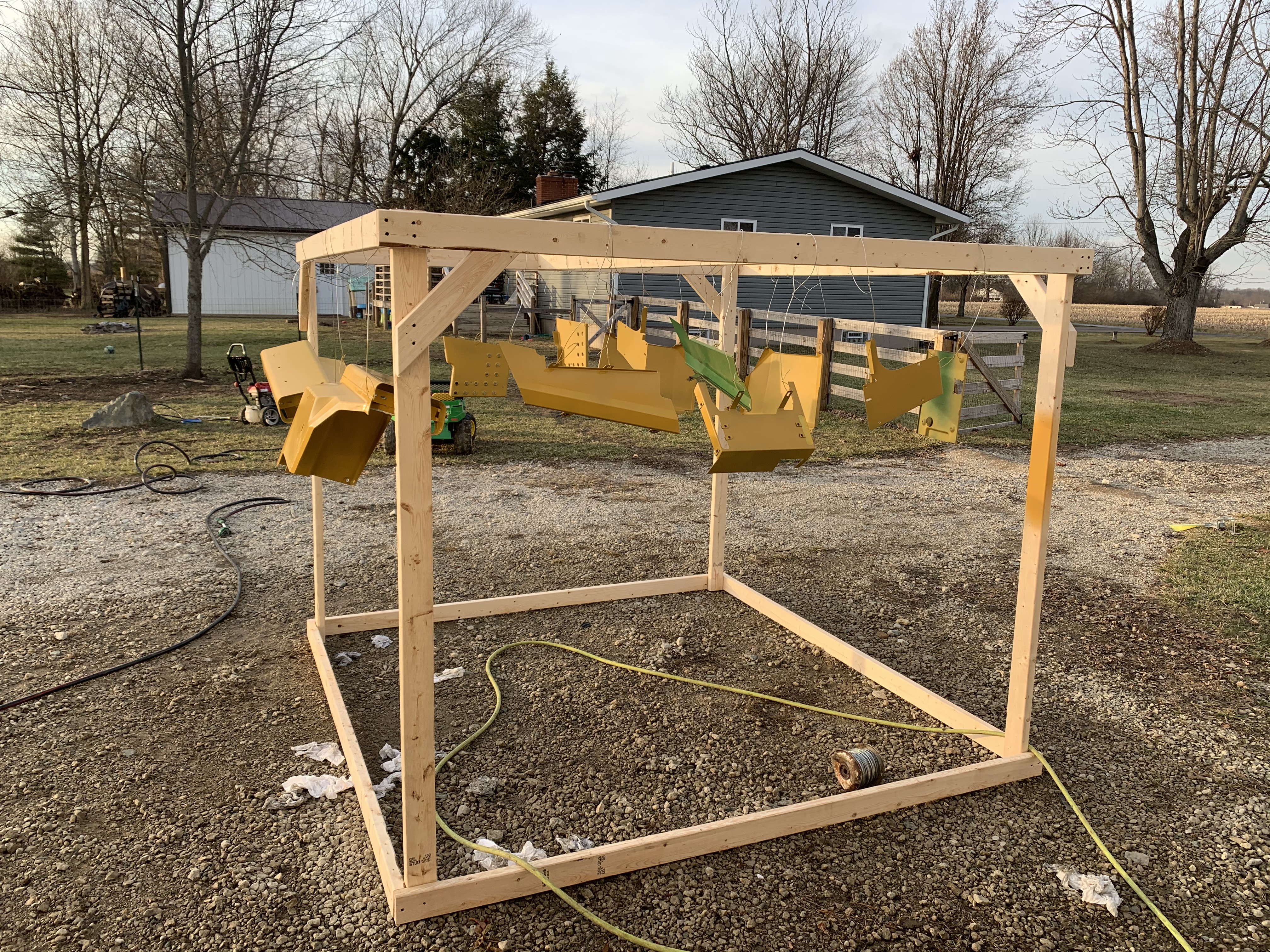

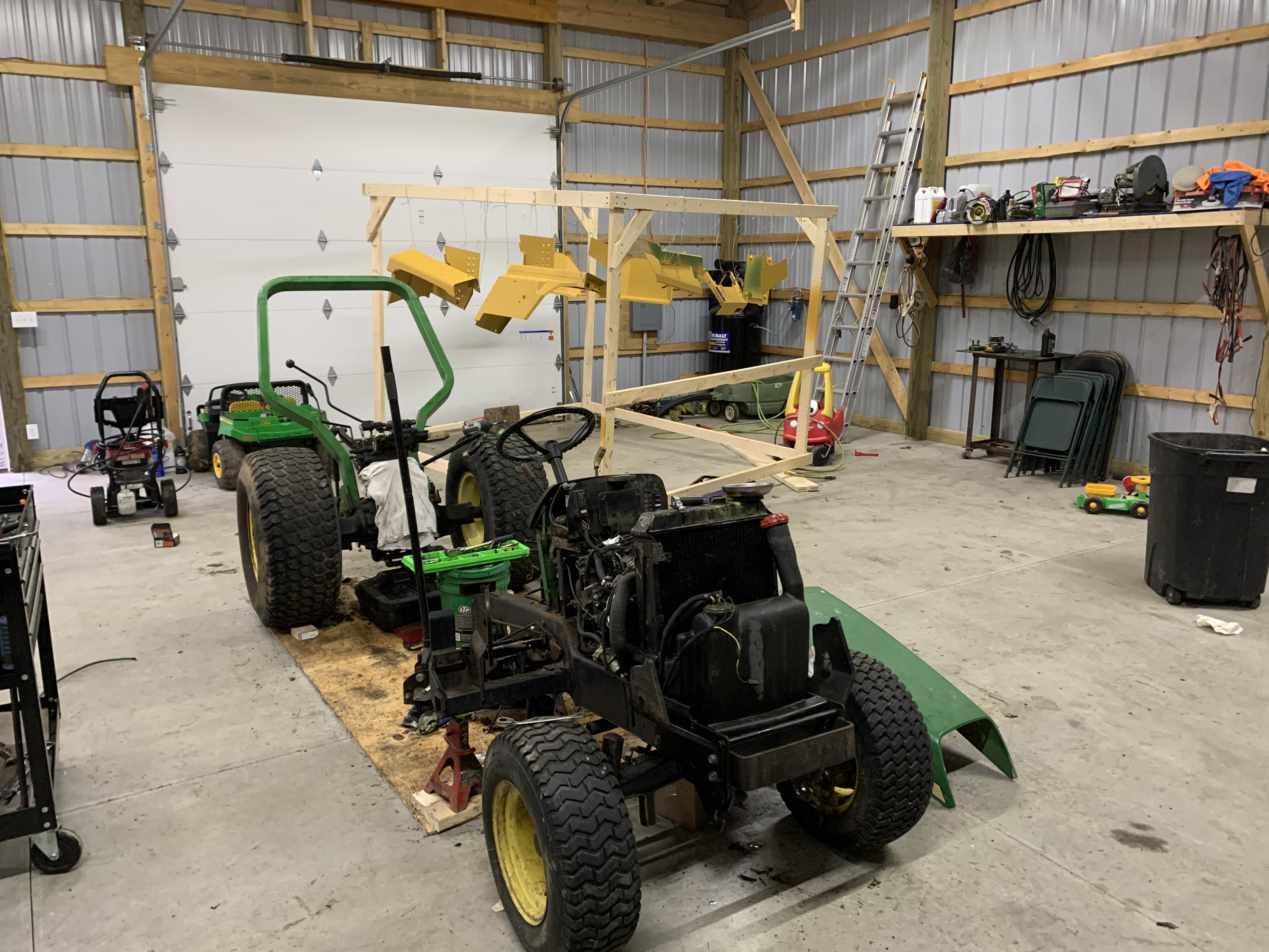

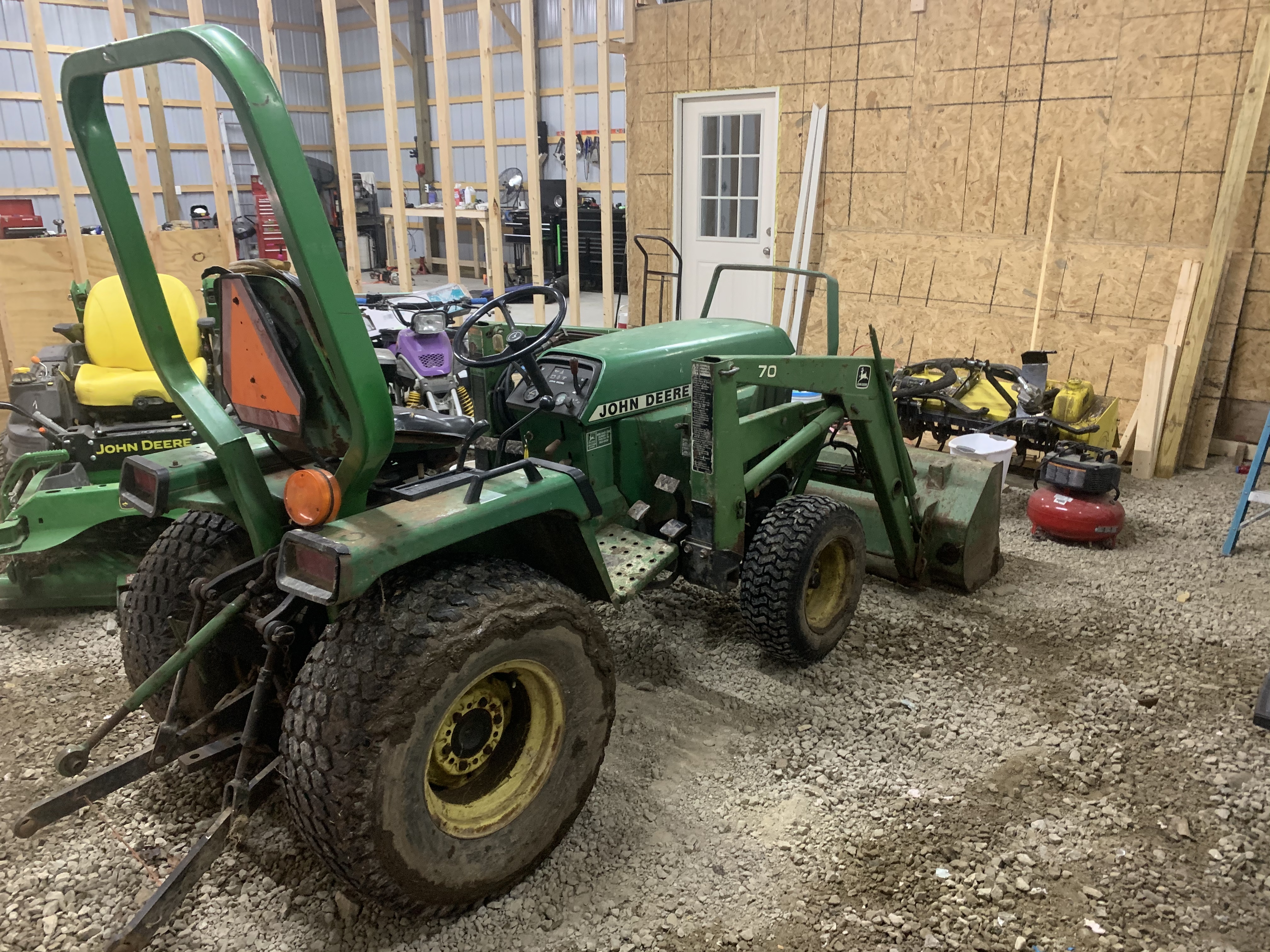

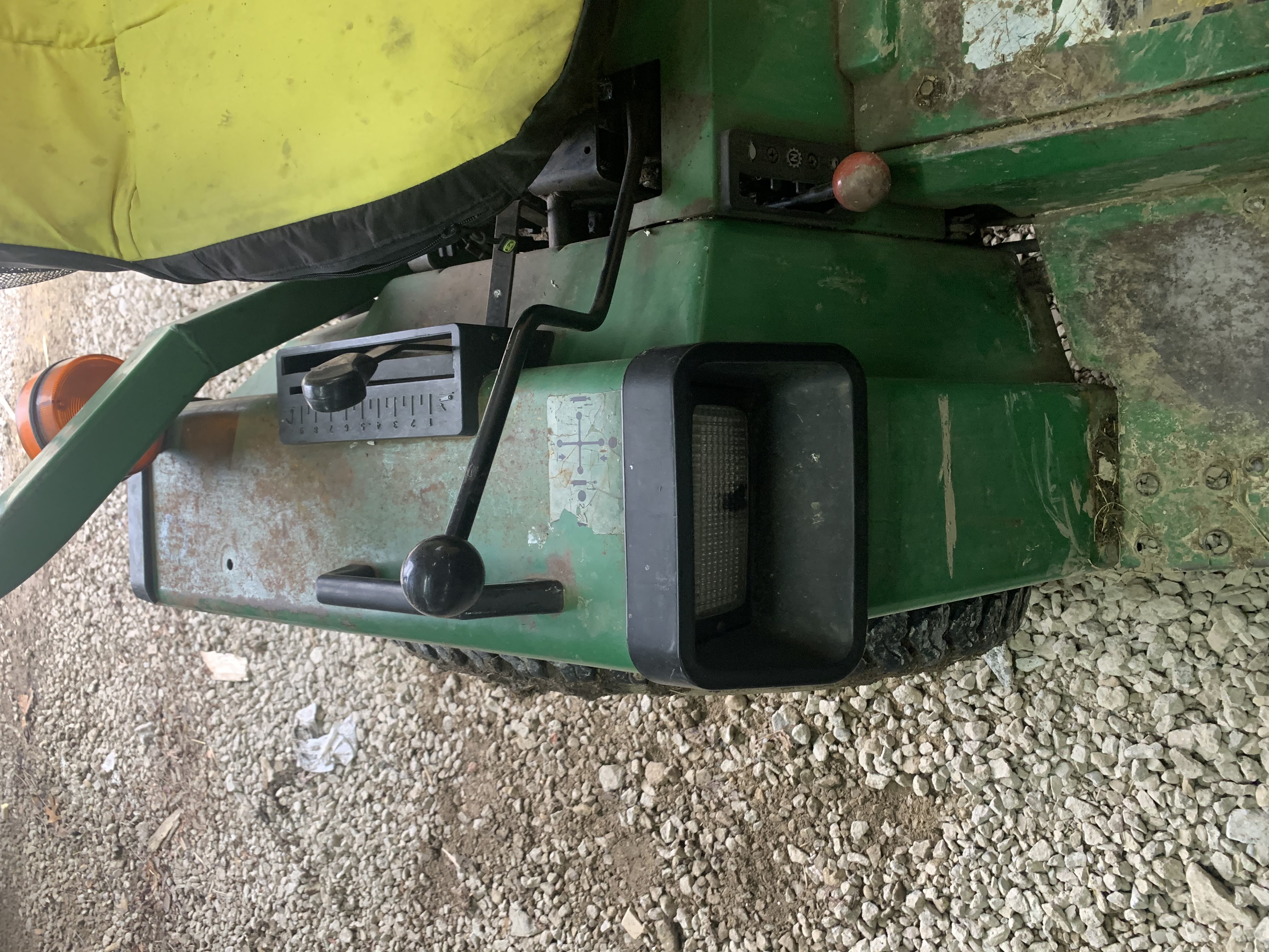

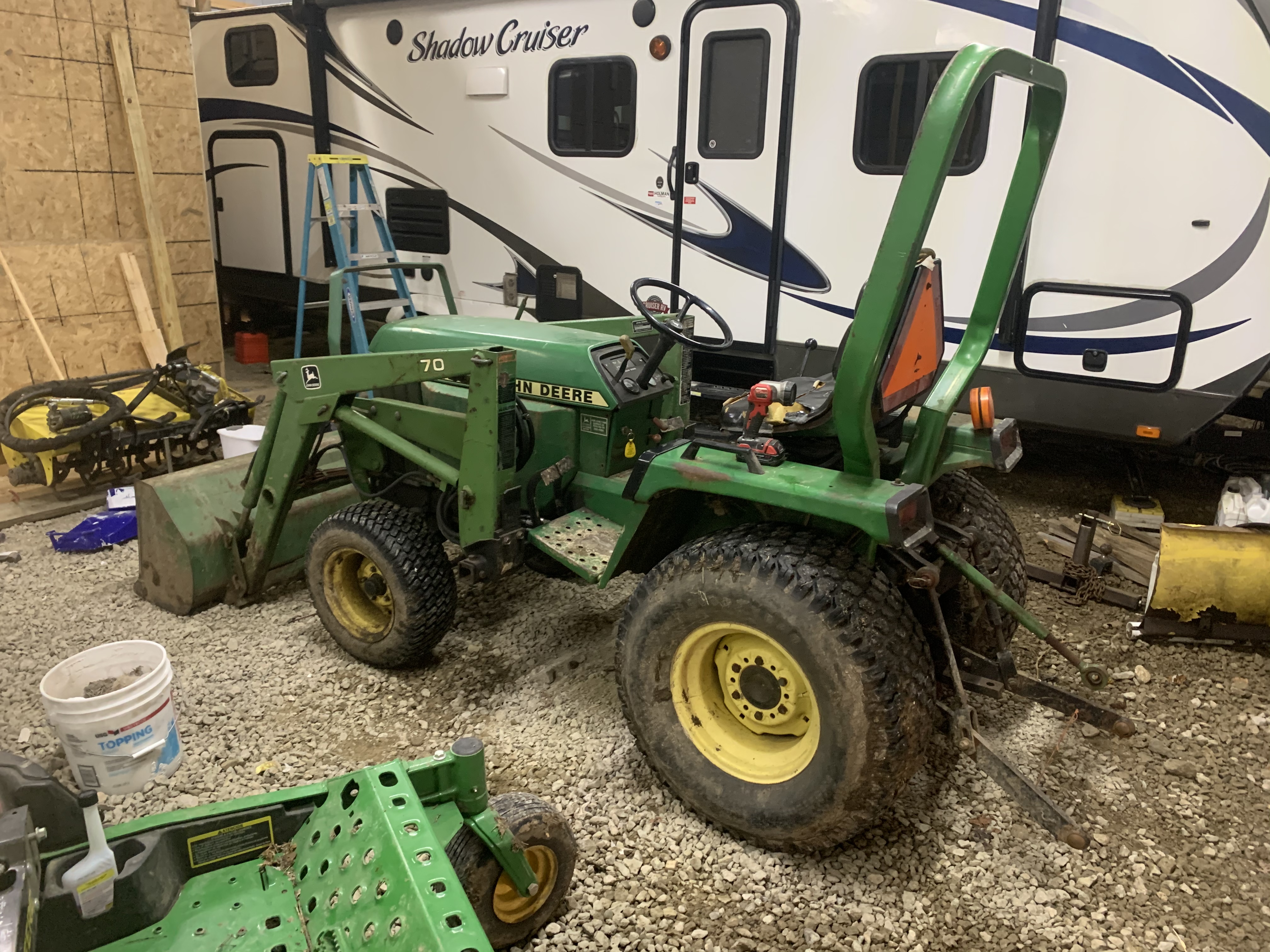

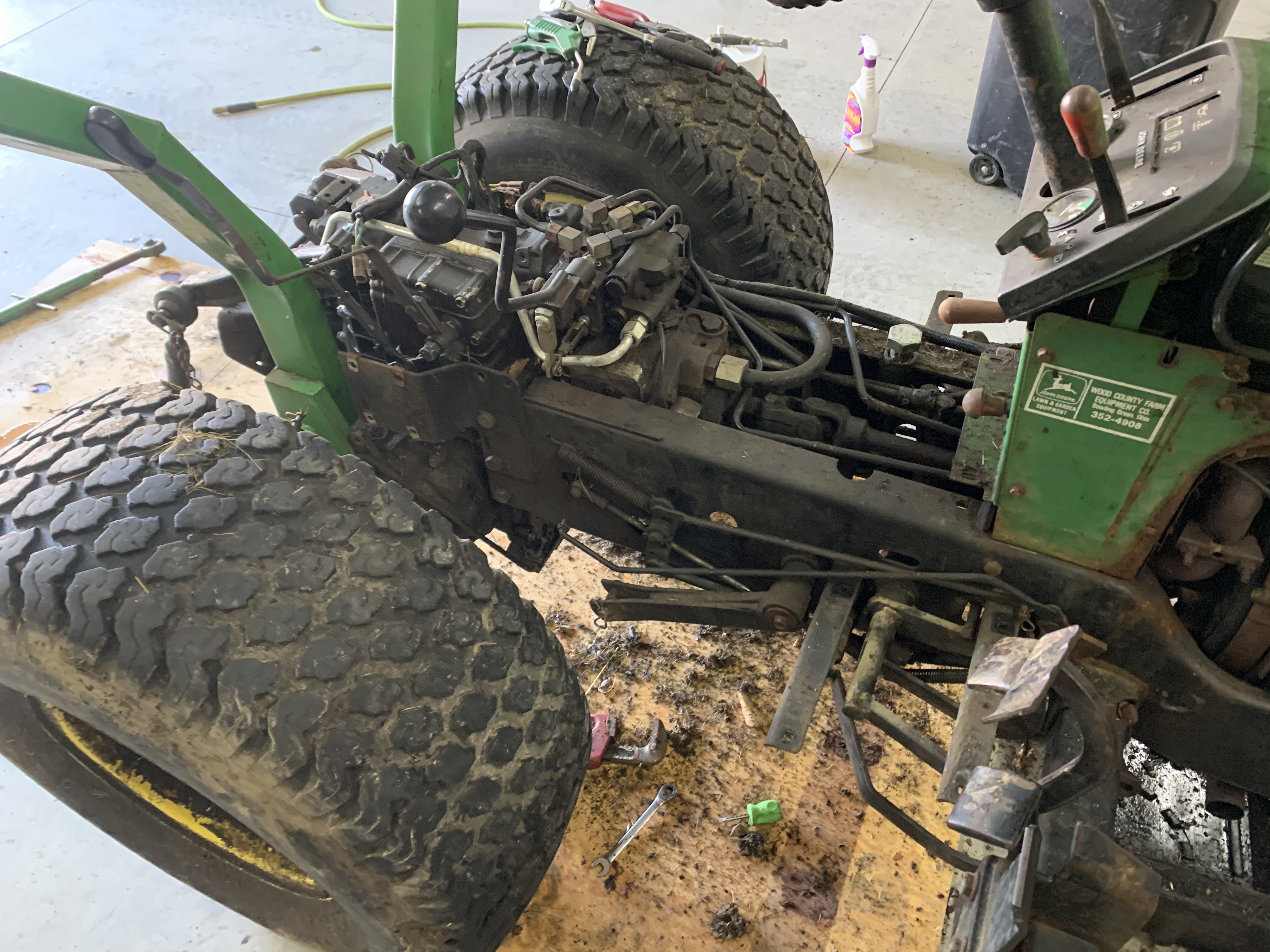

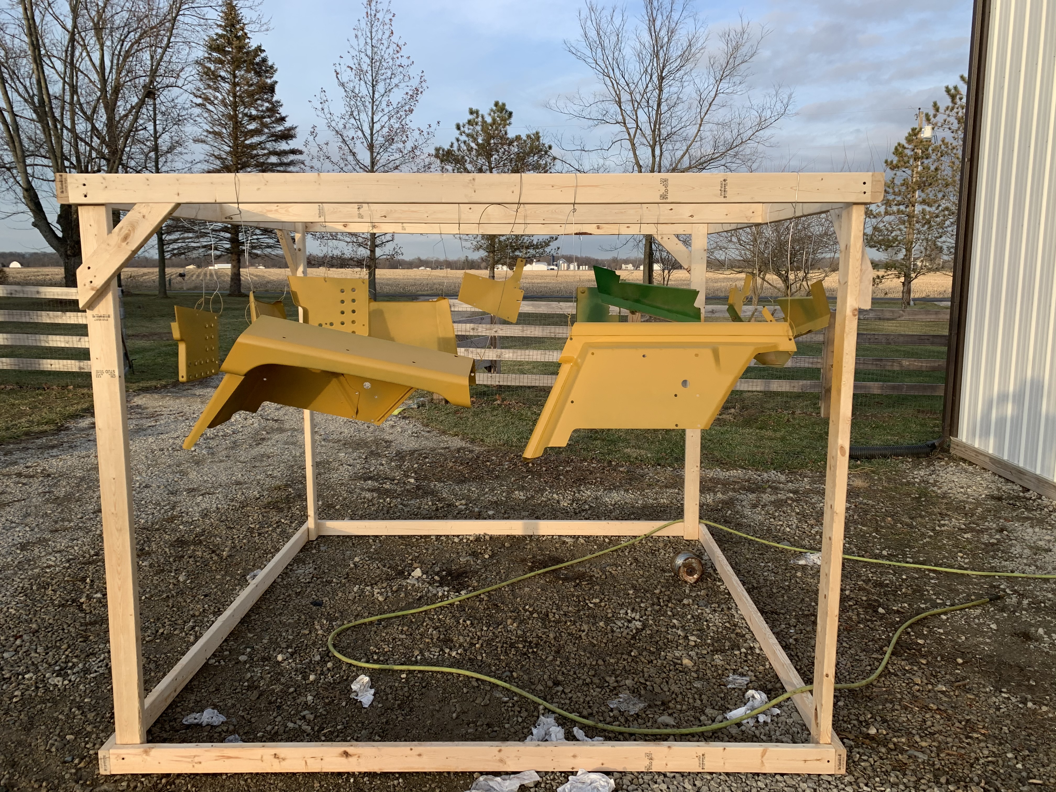

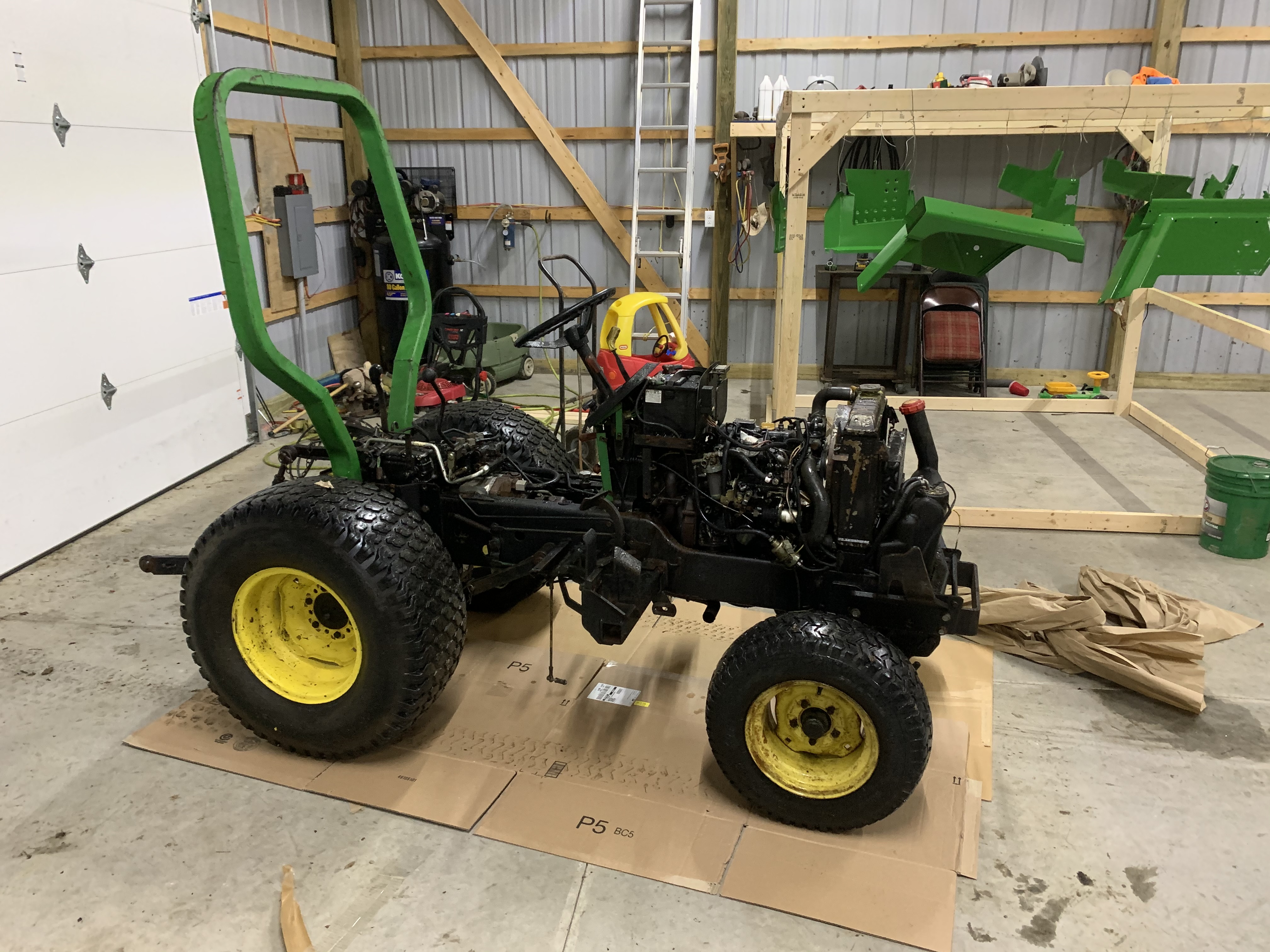

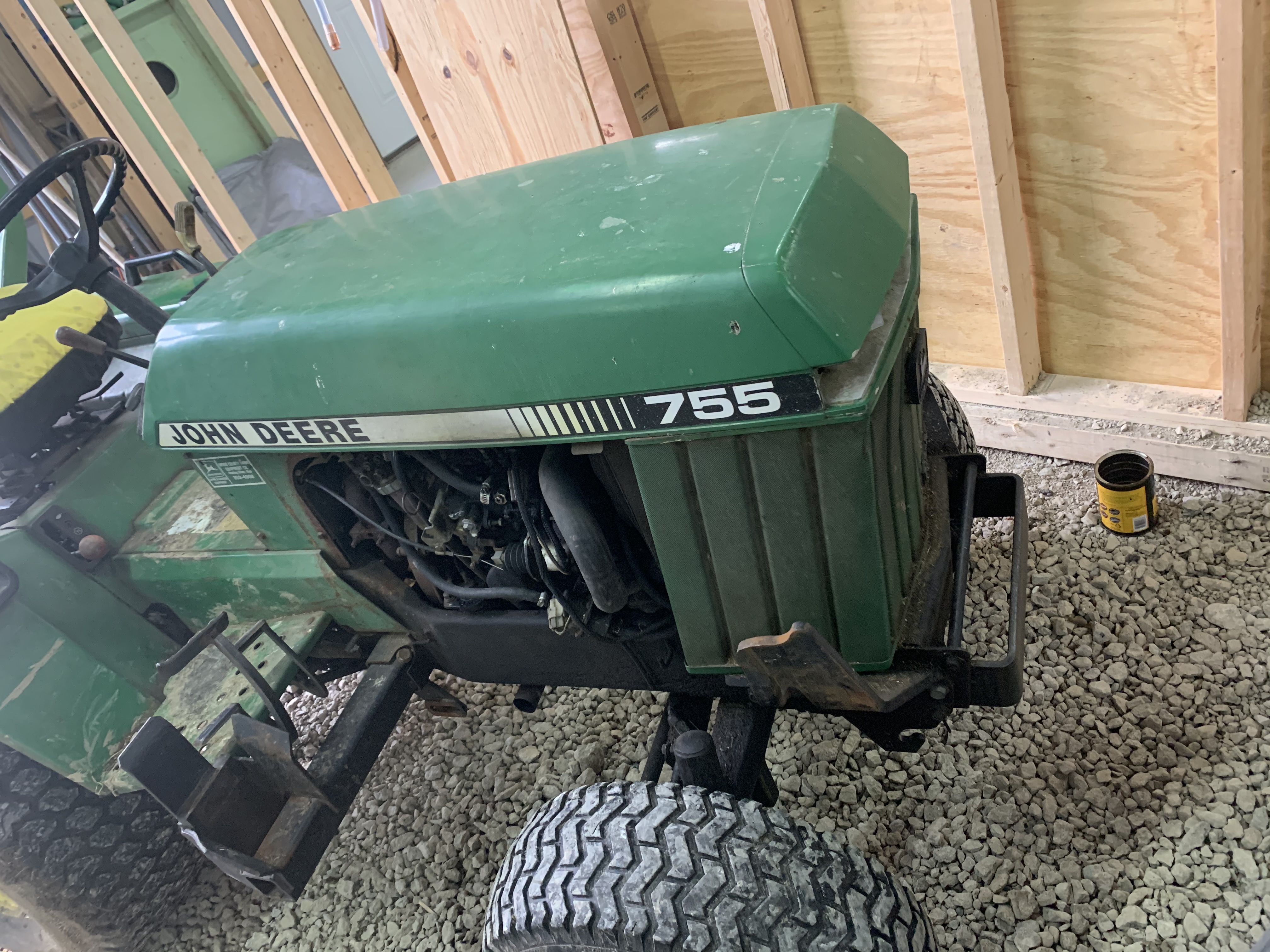

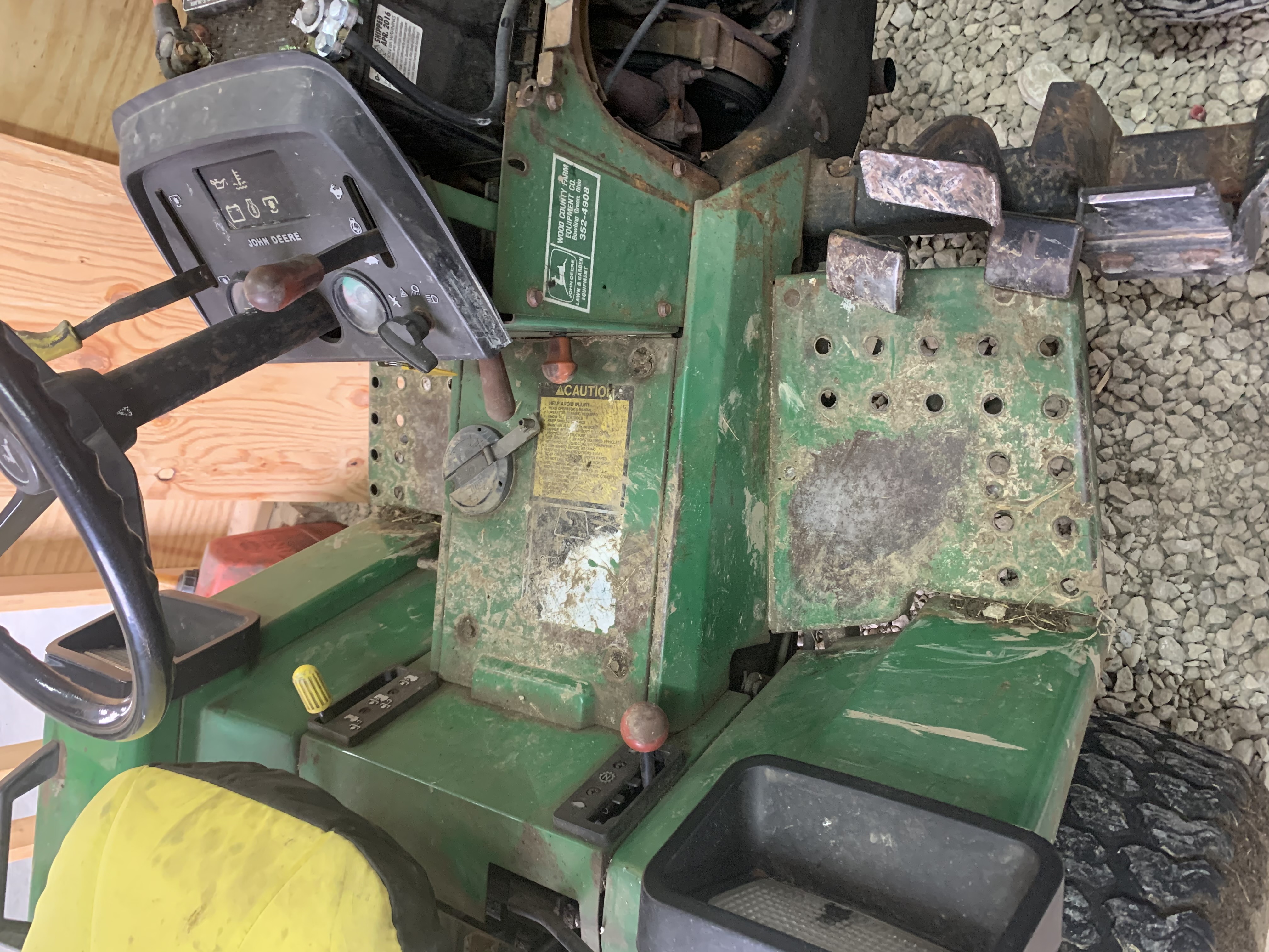

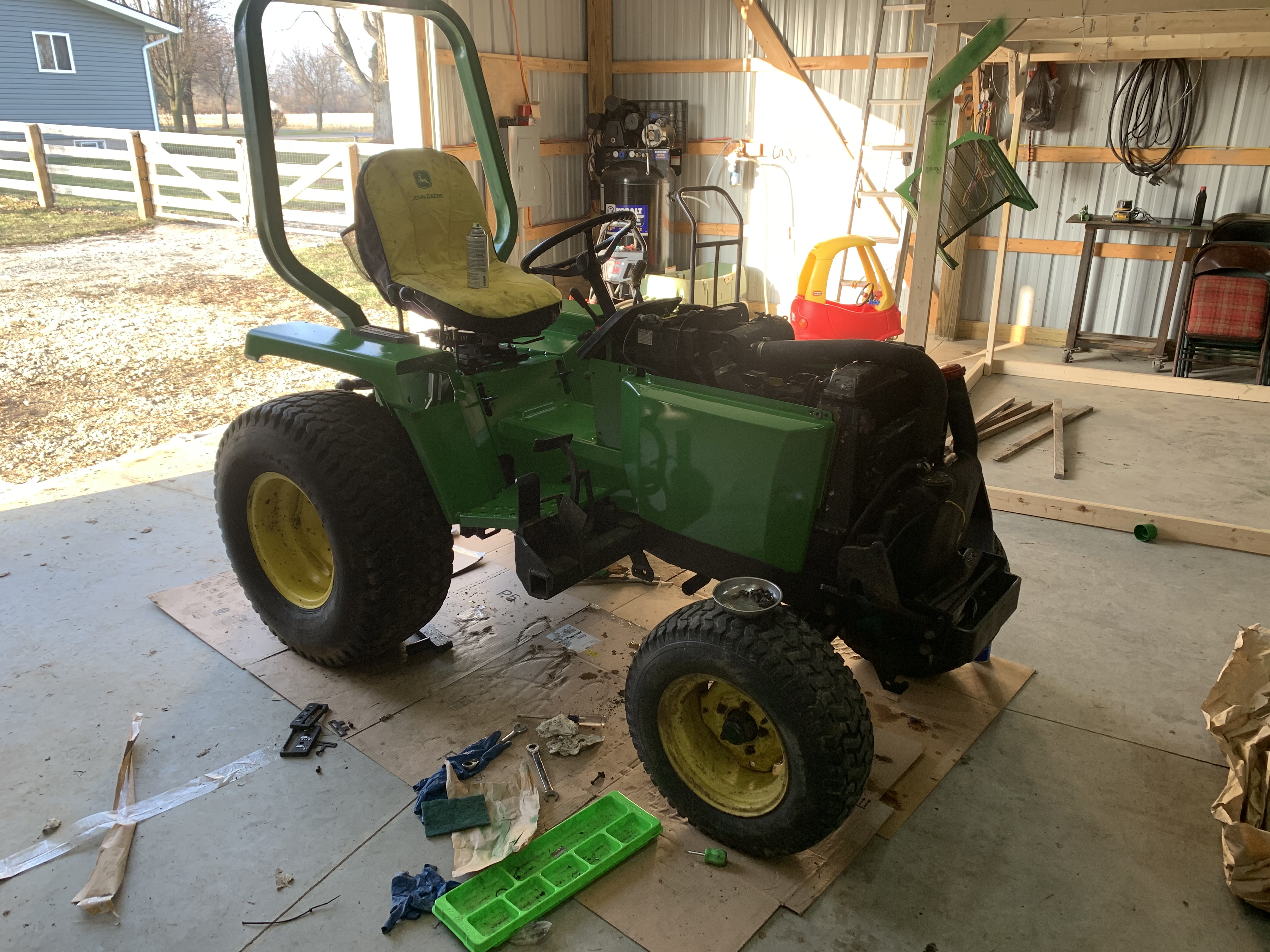

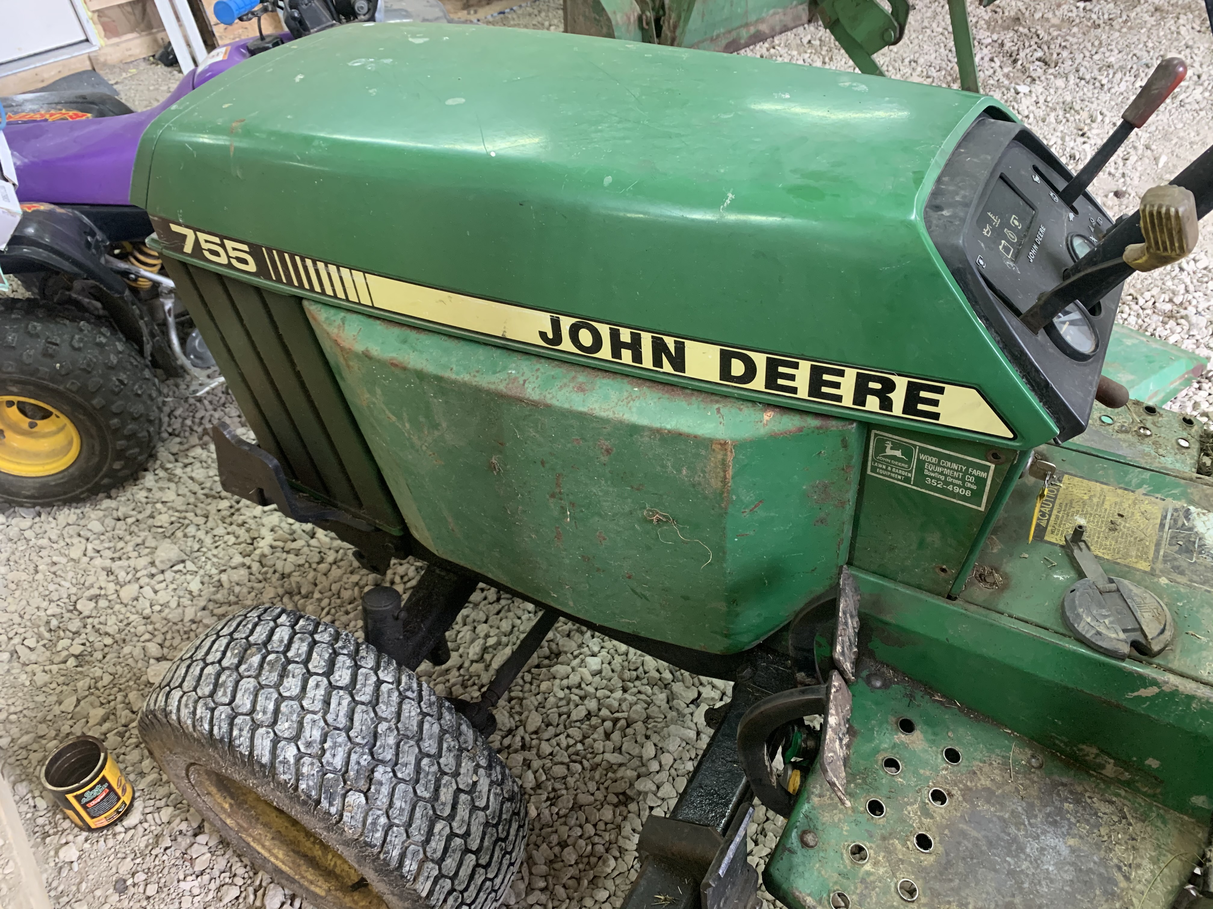

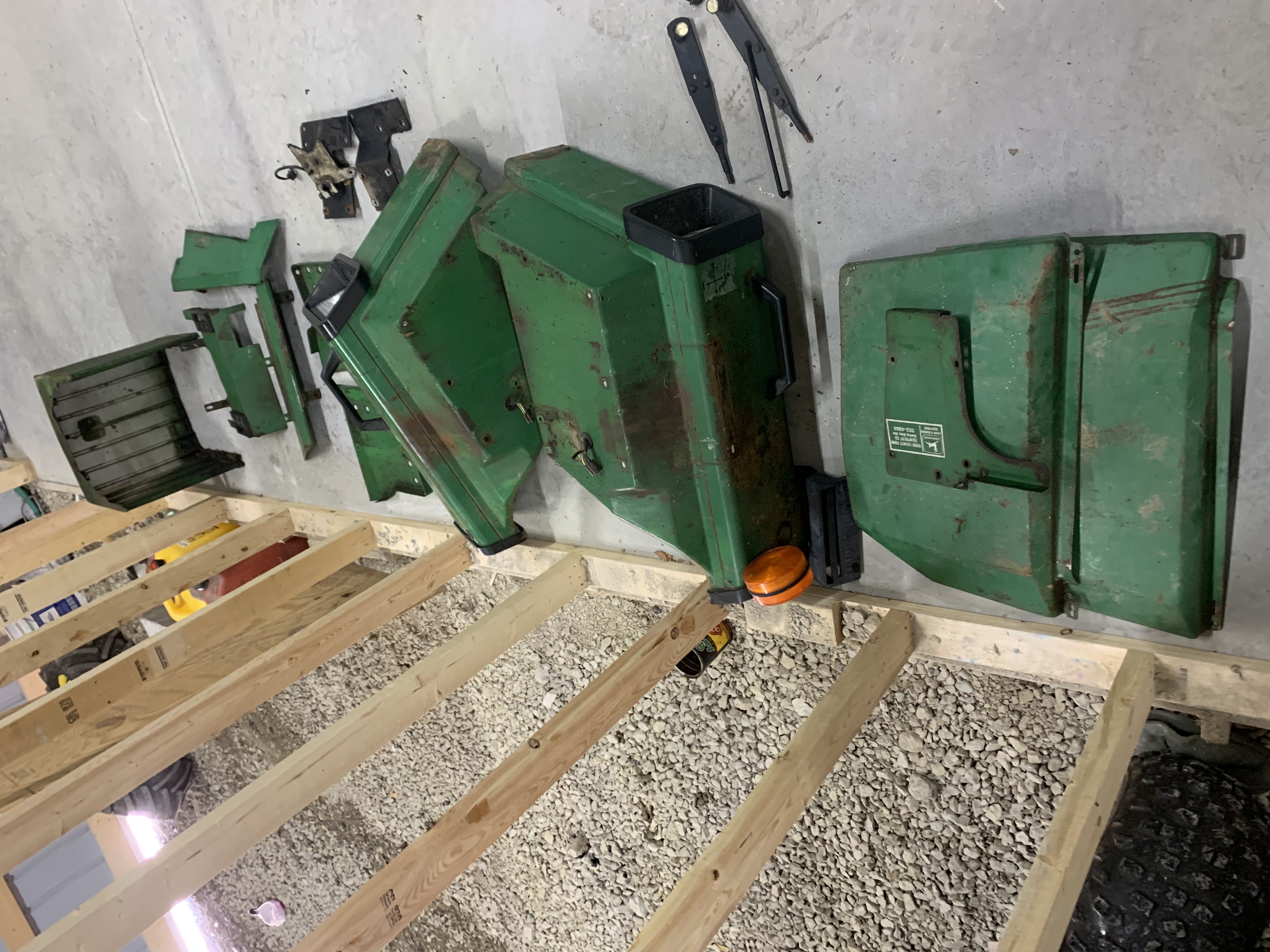

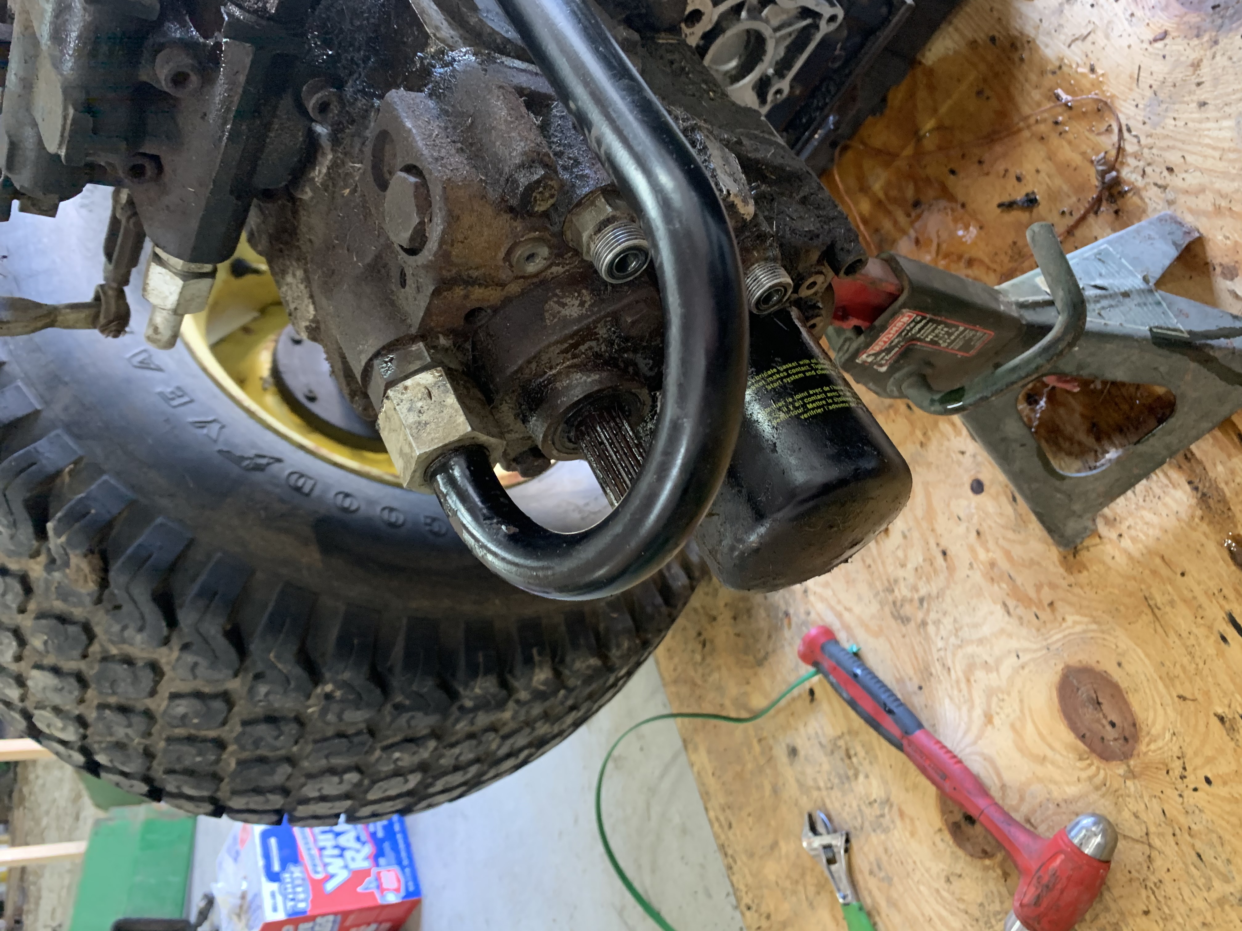

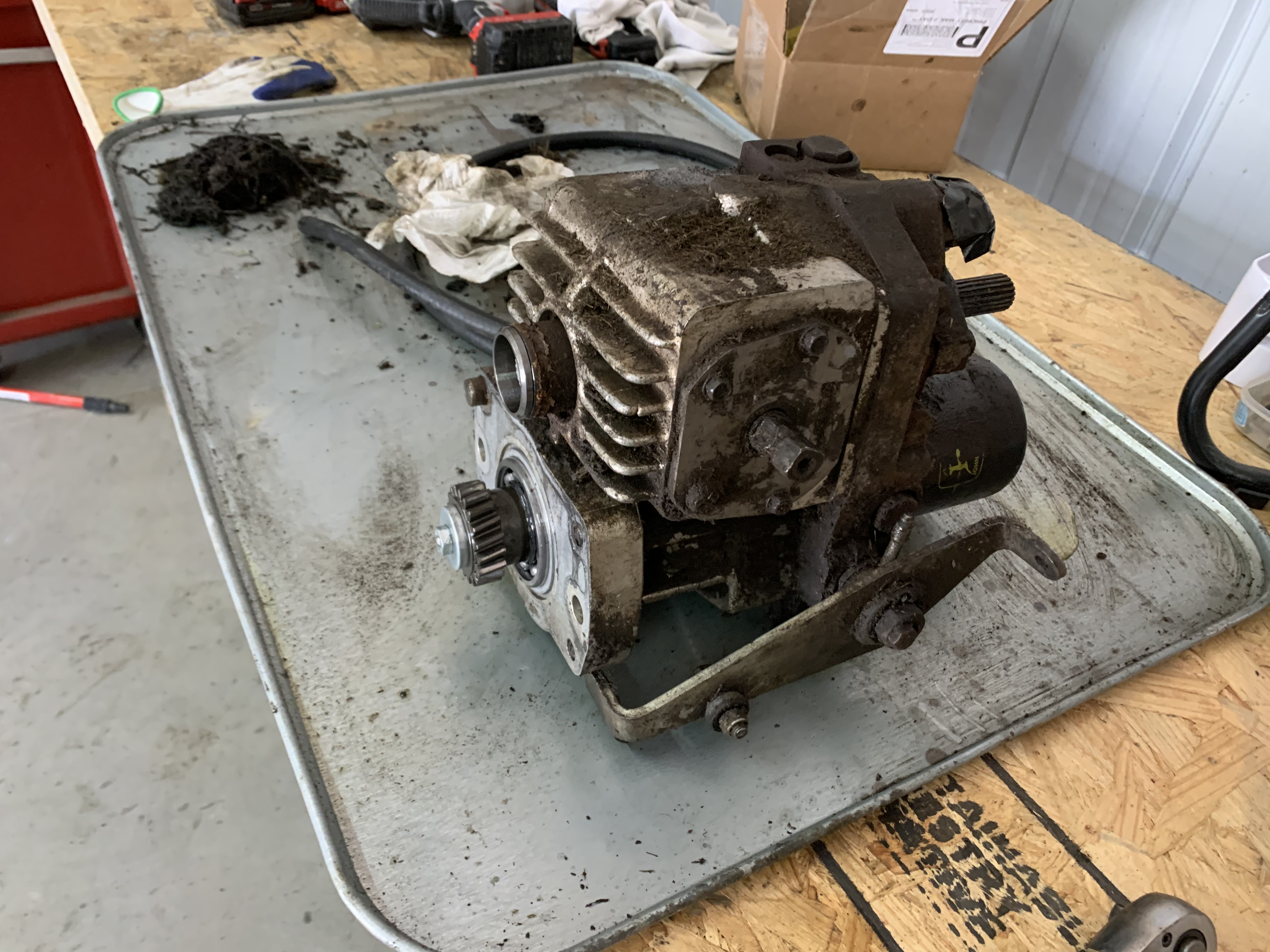

I recently decided that my John Deere 455 with 40 Loader was not enough for the task that I had been throwing at it. I had owned a John deere 855 without a loader prior and liked it so I set out trying to find something else. I came across a 1986 John Deere 755 2wd with 2362 hours on it that also had a 70 loader with it. The tractor was in rough shape. and the asking price was $4800. I contacted him and went and looked at it. It was in even worse shape that I thought but I made a $3700 offer and we settled at $3800. Thee mid pto seal was leaking so I knew the tractor had to be split. I worked for a John Deere Dealer as a lawn and garden tech for four years so I know my way around these so I was not worried about the work. I brought it home and spent an hour pressure washing it then set out splitting it. While tearing it apart i decided to sand blast and paint everything while fixing anything that was wrong. I drained the all the fluid, cleaned the suction tube, changed the filter, replaced the mid pto seal, replaced the trans input seal, adjusted the creep, changed the oil pressure sender, new antifreeze, and new o rings in every line I had to crack. Here are some pictures of the progress.

more pictures

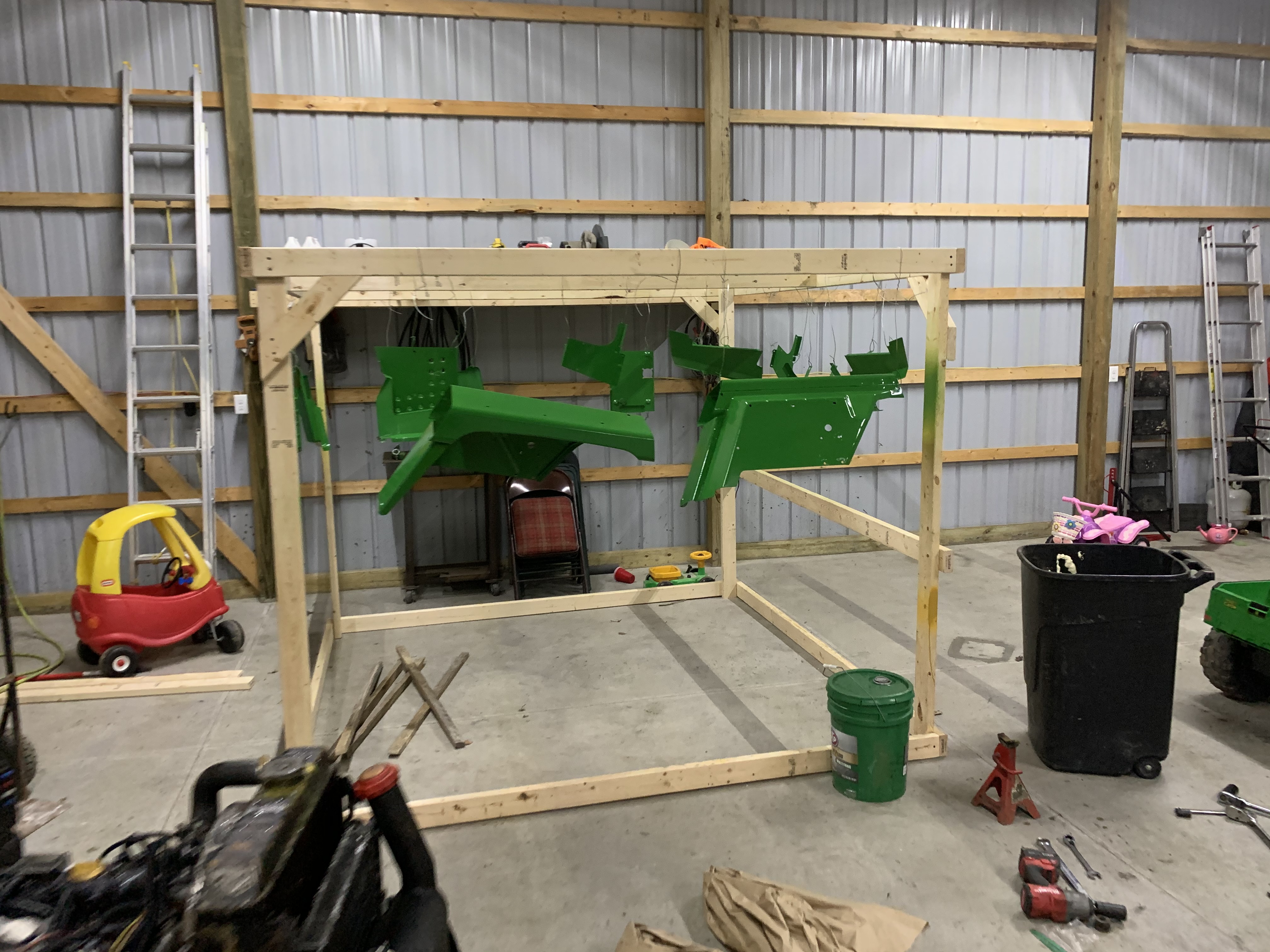

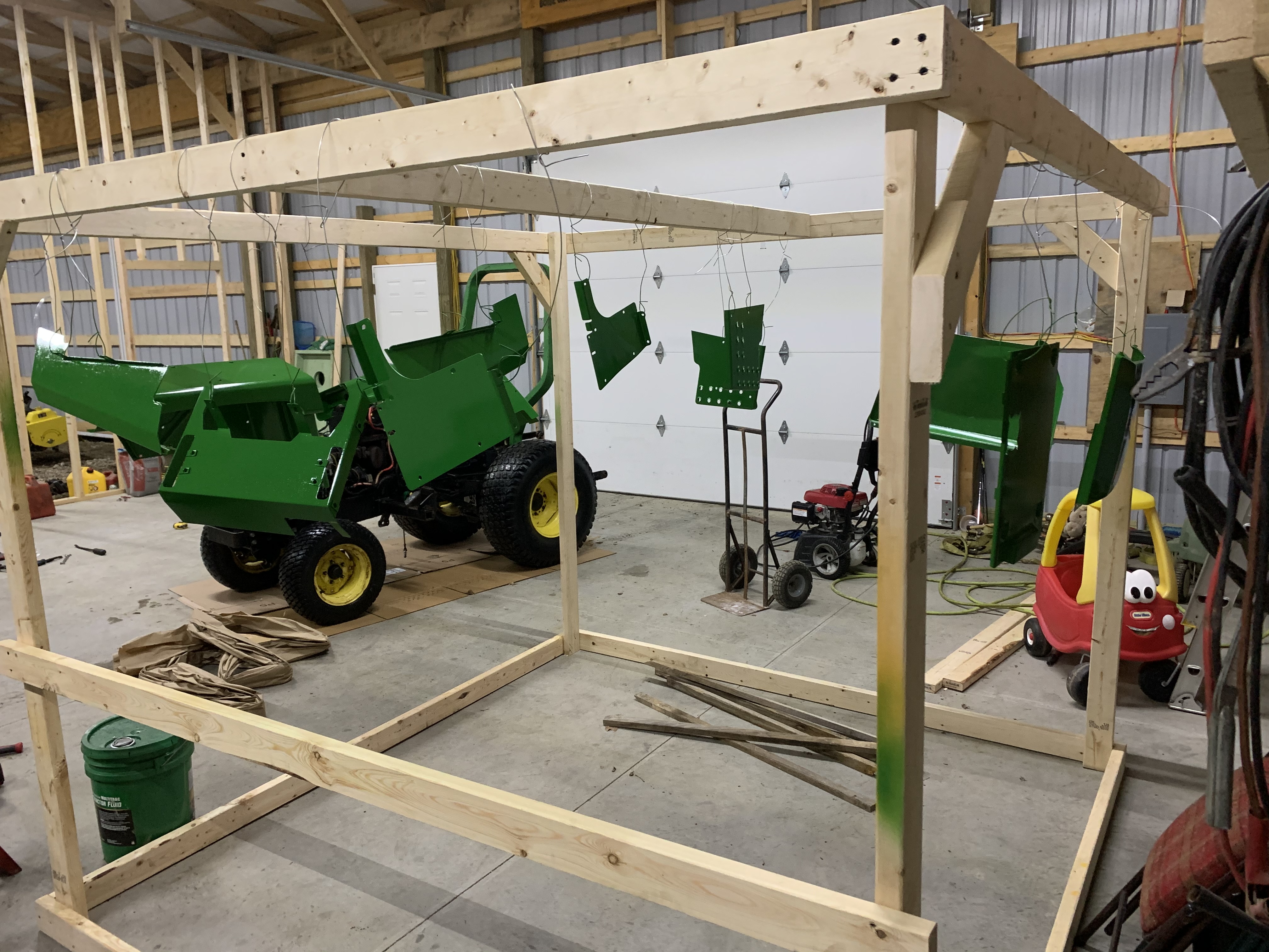

more pictures

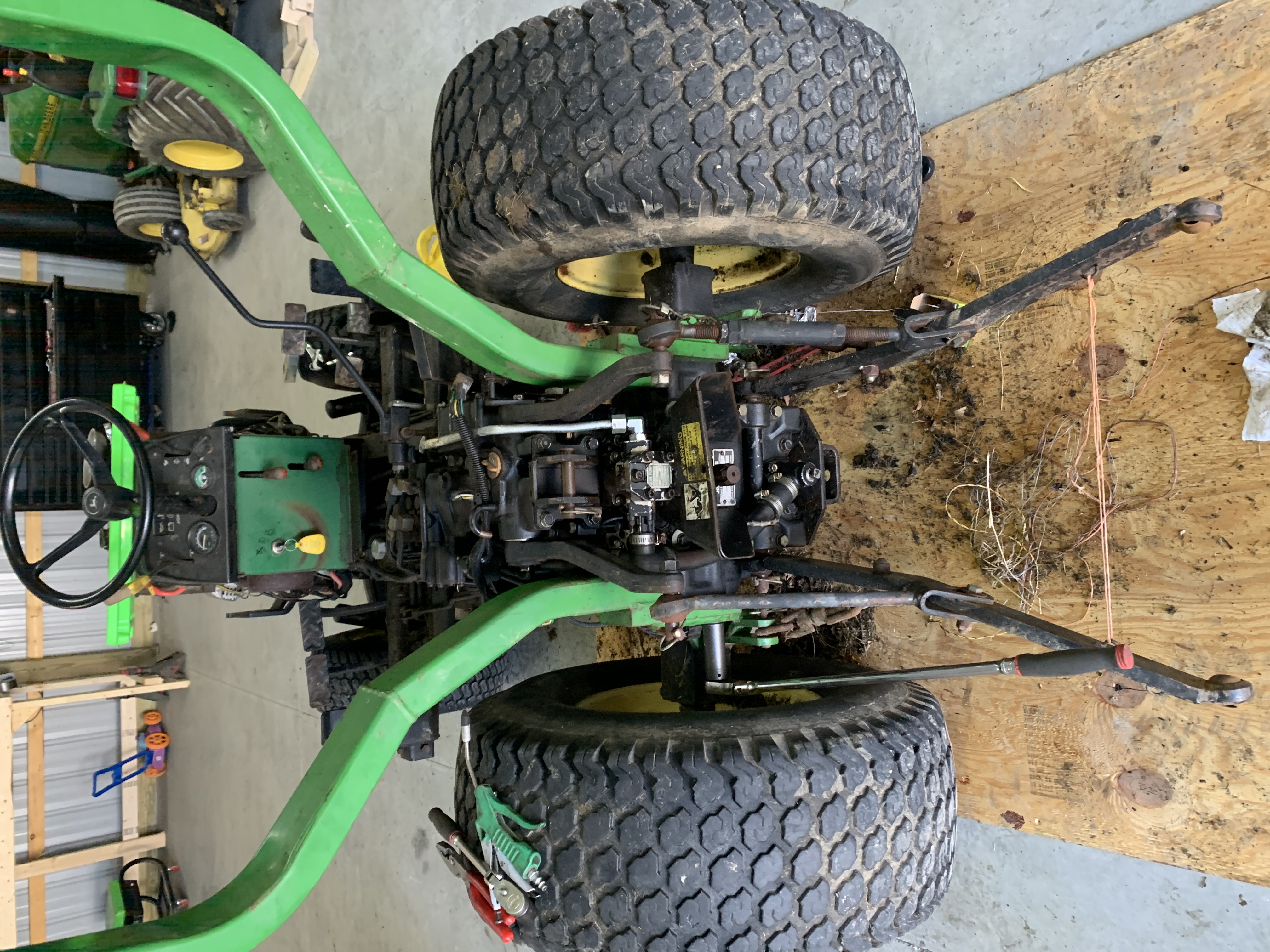

More Pictures
