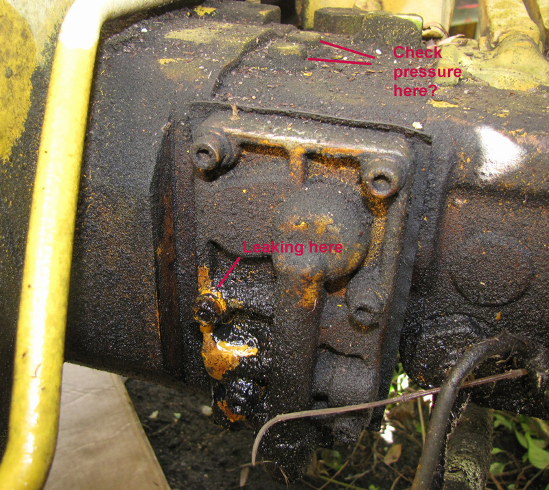

I bought this a couple years ago with this problem and I'm just now getting back around to fixing it.
It works great in reverse but in forward nothing at all.
It doesn't even try.
I'm actually suspect of the valve block because it's cover is leaking a bit. It has a homemade gasket but it looks like it's been working a while since anyone had the cover off judging by the untouched crud build up.
I read something about checking the pressures. I'm guessing the little plugs on top is where I attach a gauge?
I'm not real sure what to look for here.
My plan is to check the pressures, and then probably pull the cover off and pull the valve and check the seals.
If I don't see anything that looks odd, I guess. I'll need to split the tractor and put new clutches and seals in it?
Any help or advice is greatly appreciated!

The linkage is good.
I ran it today and the little leak I mentioned is not little at all. It's spraying a pretty good stream of fluid out around that bolt. I imagine that pressure needs to be inside heading to the forward clutches. I'm going to pull that cover off. It's pretty obvious at this point that something is very wrong in there. I'm guessing a blown o-ring.
Now I'm questioning the homemade gasket. If there's high pressure in there, I wouldn't think a paper gasket would hold up long at all.

I wound up taking the valve block apart. Nothing wrong in there. Not really much to go wrong that would cause the problem it's having, other then a blown gasket, which wasn't the case.
I did check the pressure. reverse port is 150, forward is 0. It's got to be leaking inside.

I finally tore into this.
Turns out the reverser is the entire center housing between the motor and transmission.
It is between the clutch and transmission but it's deceiving because the shifters don't go into the transmission. The transmission is actually in with the rear end.
To work on the reverser you need to take off the cover with the shifters, and then remove the rear end/transmission, and then remove the housing with the reverser from the motor. That whole thing needs to come out.
I took off the shifters and rear end today. And took out the reverser, except it's just one end of it. You cant get to the other end without removing the housing from the motor. They put one set in the front half of the housing and the other set in the rear of the housing so you really need to pull the whole thing. I don't see any bent pipes or anything but it don't matter at this point to put it together without checking the front wouldn't make any sense at all.
Once you get the back off there's not that much more work to removing the whole housing. This design is actually good in a way. When I put it back, I can put the entire reverser together, control block, tubes, and all, and then put the whole unit back in the tractor. Having taken it apart I found that there is a plate behind the control block that comes off (must be removed to get the reverser out of the housing), but removing it if your not taking the reverser out would be a bad idea as it holds all of the tubes in place.
So the easiest way to get this thing apart is remove the cover, remove the rear end, remove the housing with the reverser (valve block and all), and then tear into the reverser.

The front half of the reverser is messed up. The seal is shot and for whatever reason the clutch pack is digging into the front housing.
I believe it's moving ahead far enough for the oil to escape from behind the clutch pack. I don't see anything else wrong so I'm pretty sure this is the problem. Now to figure out how to fix it.

Sadly, I've come to the decision to part this one out.
That seal at the front has nothing to do with the hydraulics.
And I've come to the realization that there isn't supposed to be a thrust washer to hold the hub in as the cover is aluminum. Putting pressure on an aluminum housing doesn't seem like something they would do. I'm inclined to believe that the hydraulic pressure in the groove between the metal rings is what keeps it in.
I cant find anything that stands out as the problem, except I did notice that one of the metal rings on the front hub has a large area that looks like it's not coming into contact with the housing and it should be. And then where the ring should be rubbing, there is a lot of wear.

I looked at it again this morning after posting.
There's really nothing that keeps it in. Unless it's the pilot bearing but that would be pretty weird.
I really believe the hydraulic pressure keeps it in which would also be weird but there is nothing else.
Nothing has a groove for a snap ring. The back of the clutch hub just slides into the casing and nothing holds it there.
There is a shaft that goes through the hub, but again no grooves for snap rings or anything.
It's actually not the hub that's worn.
The 2 metal rings are in the hub and they don't look right but they are cheap and easy to replace.
The part where they rub is the biggest problem. It's an insert in the housing. Looking at it, it's pretty badly worn and I'm sure it has to be leaking a lot. It could maybe be replaced but I would have to find one and then probably take it to the machine shop to get it replaced. It's not in an easy place to get to.
I dont think the damage to the front cover is effecting it at all. I think it's not working because the hub is coming out far enough that the pressure is escaping past the rings, including the back ring so it's getting behind the clutch pack and pushing it forward into the front cover which is probably why it's not working and why the cover is damaged.
