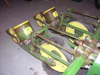

Here's a pic of the JD vegetable planter units.
The best setup would be a properly set up 71 for corn and beans and the Jd vegetable planter units for vegetables.

The smaller seeds you mention would plant well with a 71 with vegetable bottoms but you have to be set up with the correct parts and they are hard to find. Look in the parts and operator manuals to see how they look and what's needed. If you could find some of the small JD vegetable unit planters, that would be ideal. You could also buy "coated" vegetable seeds that are the size of large BB's. Some of those might plant with a 71 because of their larger size..

Here's the pic I said I would post of a wheel that could be used for a front packer or press wheel. I've done it before but not on a 71 planter. All are similar.
It's just an old cultivator gauge wheel. This is off a Ford but anything would work and there are lots around. Just make some brackets, make them "float" with a spring if you want and this runs in front of your gauge wheels to smooth the seedbed.
Also attached is a pic of some other gauge wheels I have that would work. Most any type of gauge wheels works. Use a bolt for your axle.
