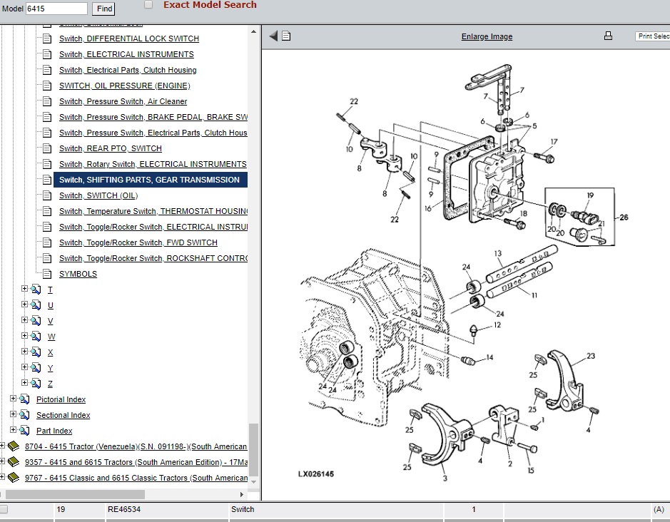

Mar 27, 2018 / John Deere 6415 #1 G Gerald44 New member Joined Mar 27, 2018 Messages 2 Location Berryville Tractor John Deere 6415 Can any one tell me where the netural switch is located on a cab tractor.
Mar 27, 2018 / John Deere 6415 #2 B beenthere Super Star Member Joined Aug 16, 2001 Messages 18,687 Location Southern Wisconsin, USA Tractor JD_4x2_Gator, JD_4300, JD_425, JD_455 AWS, added JD_455, JD_110, JD_X485(sold) :welcome: to TBN There is a switch in the gear tranny, as shown key # 19 here. along with part # Looks to be on the right side facing forward. Attachments 6415_switch_gear.jpg 205.9 KB · Views: 305

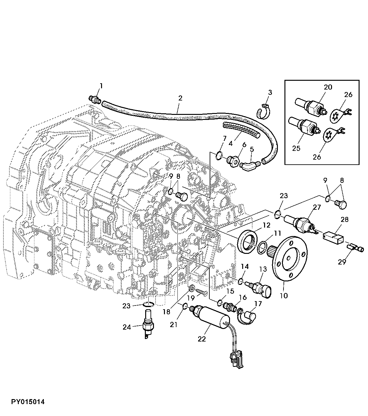

Mar 28, 2018 / John Deere 6415 #3 Zebrafive Super Member Joined Aug 5, 2010 Messages 5,635 Location South West MI Tractor John Deere 2030, John Deere 6415 I have a 6415 w/powrquad and neutral start switch is on the front of the transmission (where shaft from engine connects) Key 13 IIRCCC Attachments 6415pwrqd13.gif 41.8 KB · Views: 304
Mar 28, 2018 / John Deere 6415 Thread Starter #4 OP G Gerald44 New member Joined Mar 27, 2018 Messages 2 Location Berryville Tractor John Deere 6415 Thank you, I found the switch and got it fixed.
