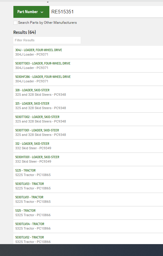

5325 is the only 5cyl that I know of.
   / John Deere 5525 Blowing fuse #16
Where used part # search on JD parts reveals ""64"" different listings utilizing the same 5 cylinder engine block. Partial list of models is shown below. All I noticed was 2 tractor models being 5225 & 5325 along with some skid-steer applications
   / John Deere 5525 Blowing fuse #17
5525. does this tractor have the five cyl engine?
Four cylinder turbo.
They use the part on all sorts of engines. Very common part for my dealer.
