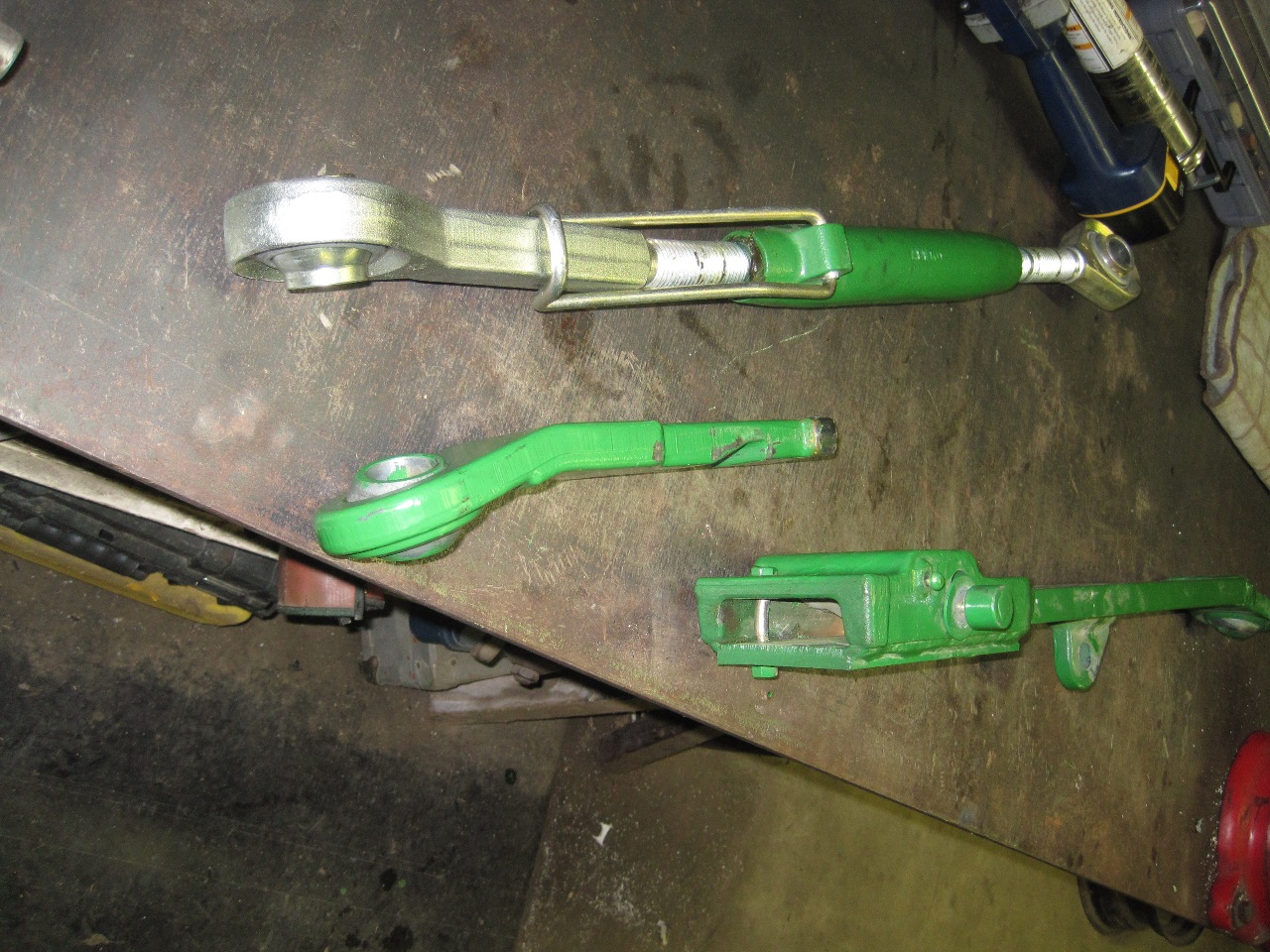

Well guys, I got a call from my dealer. The HD upgrade kit came in. Picked it up around 3. I had some tillage to take care of, started to install the kit around 10:30 tonight, finished up the install around midnight.

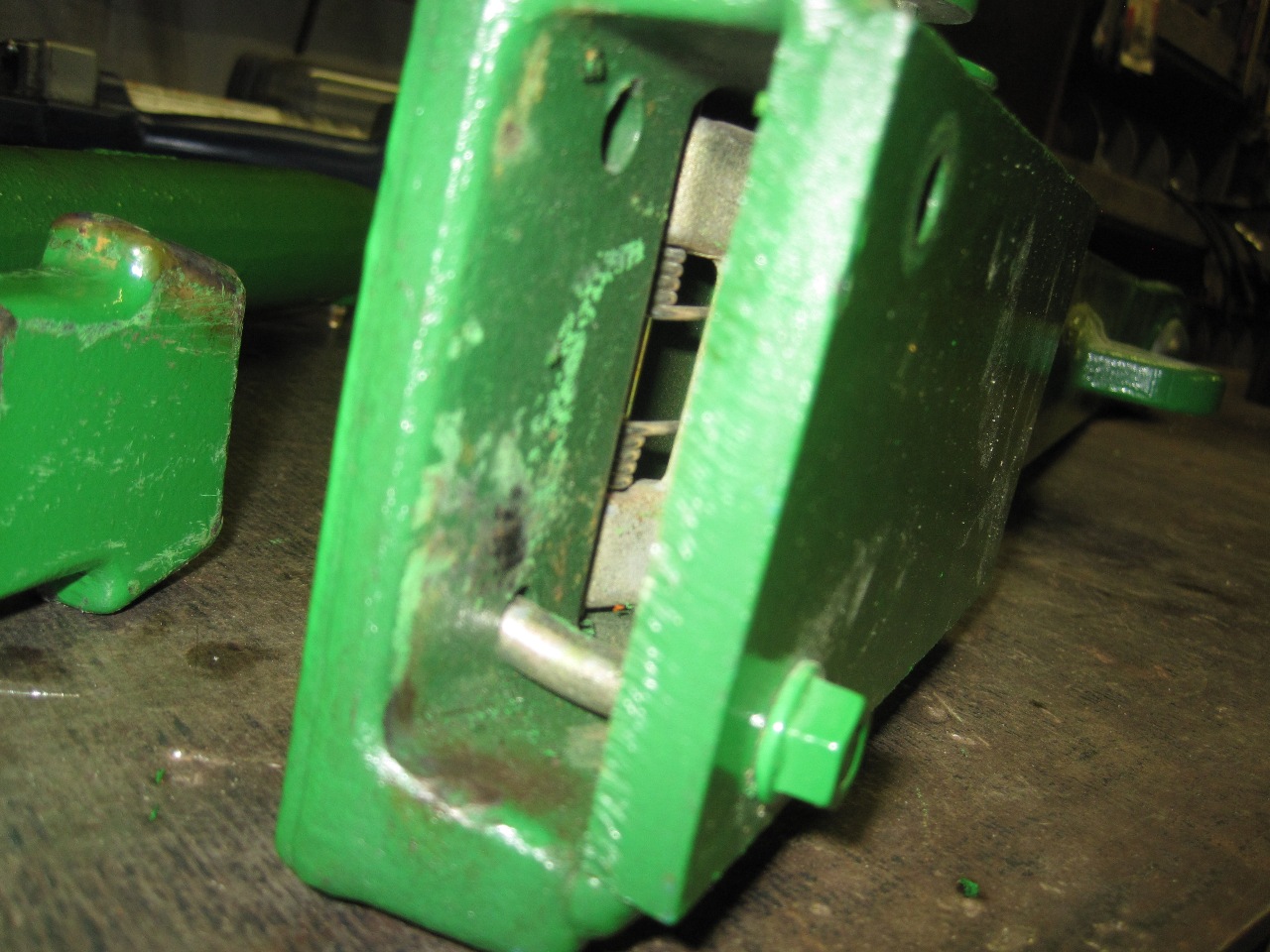

Installation was simple enough. Deere provides good instructions, and the materials are excellent quality. Its a good thing we went with the kit, and not just the lower arms as they would NOT fit. The HD arms are thicker, requiring wider lift link yokes and longer yoke pins. The HD style locking system on the telescopic ends is identical to that on our 6420`s. Very sturdy and extremely heavy.

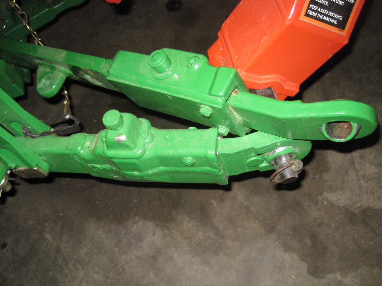

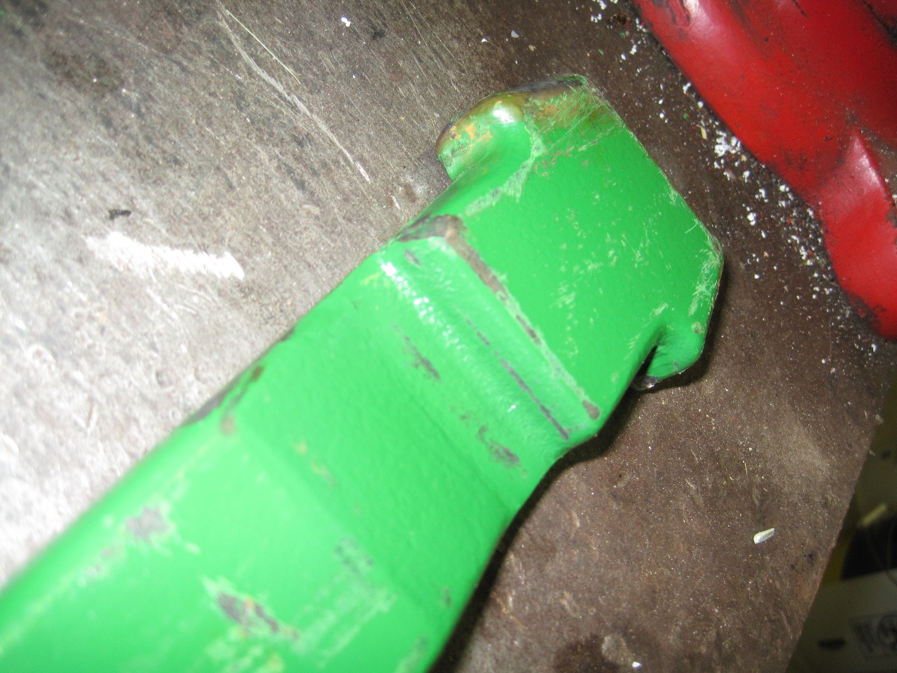

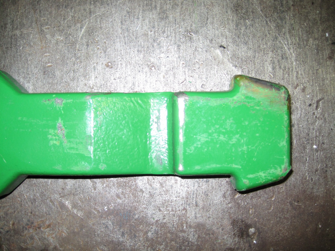

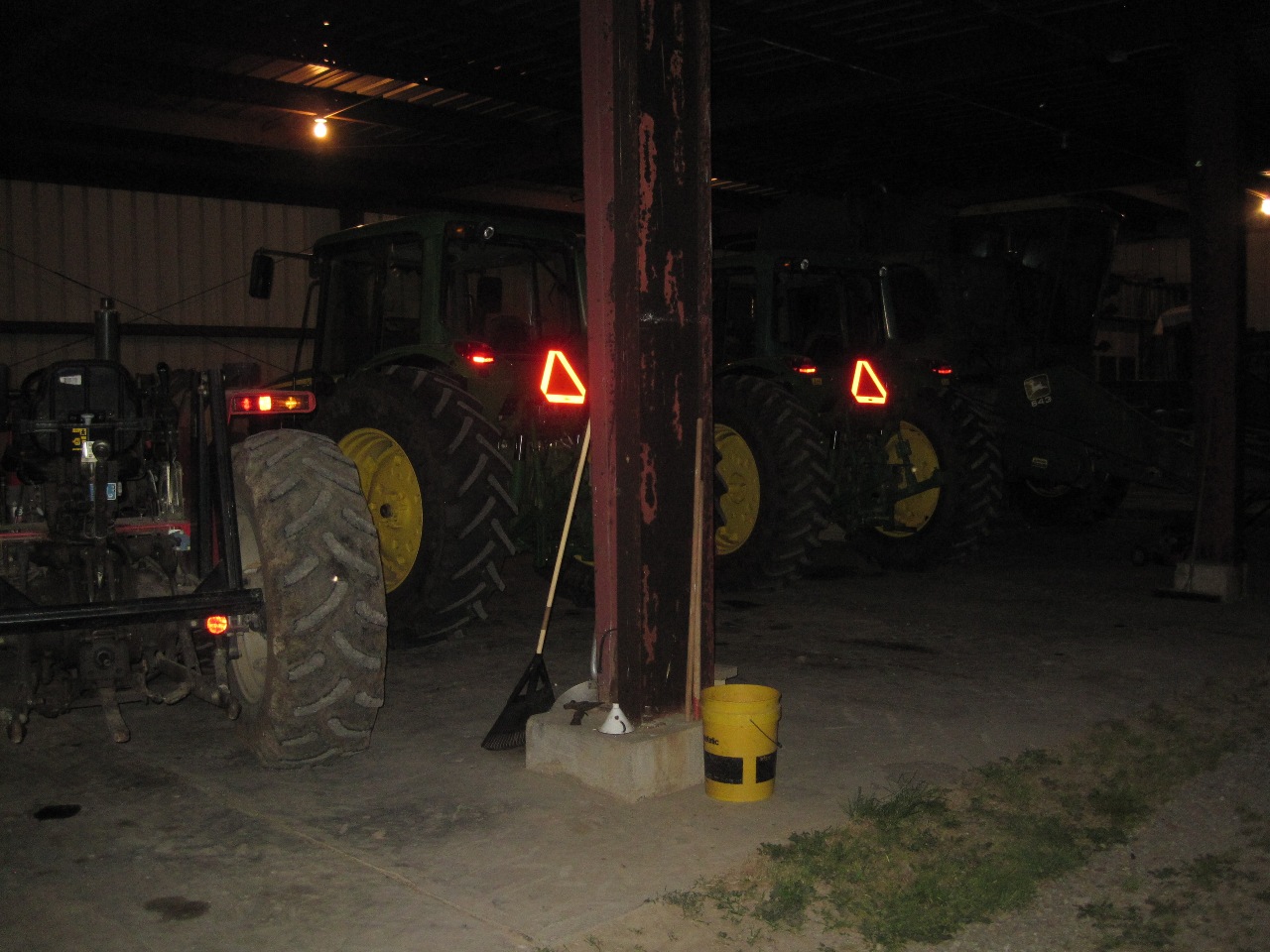

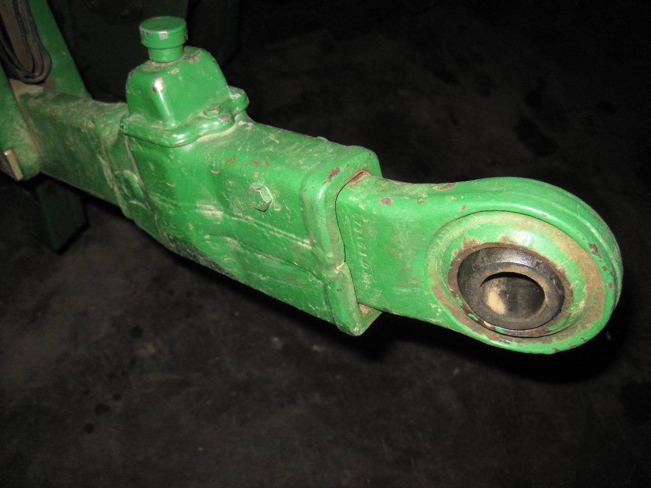

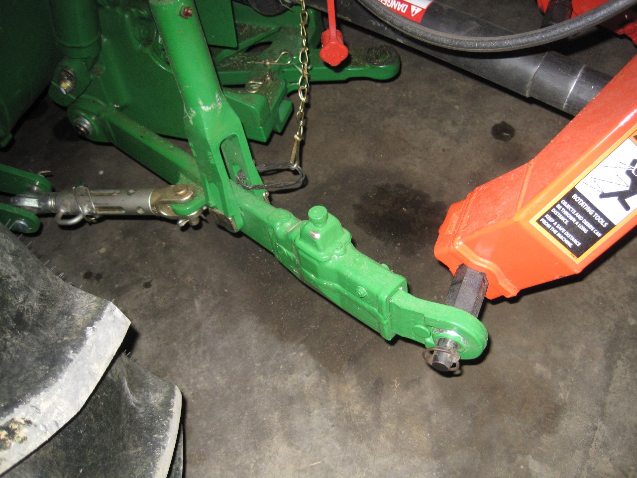

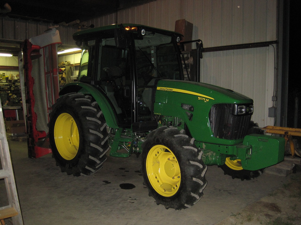

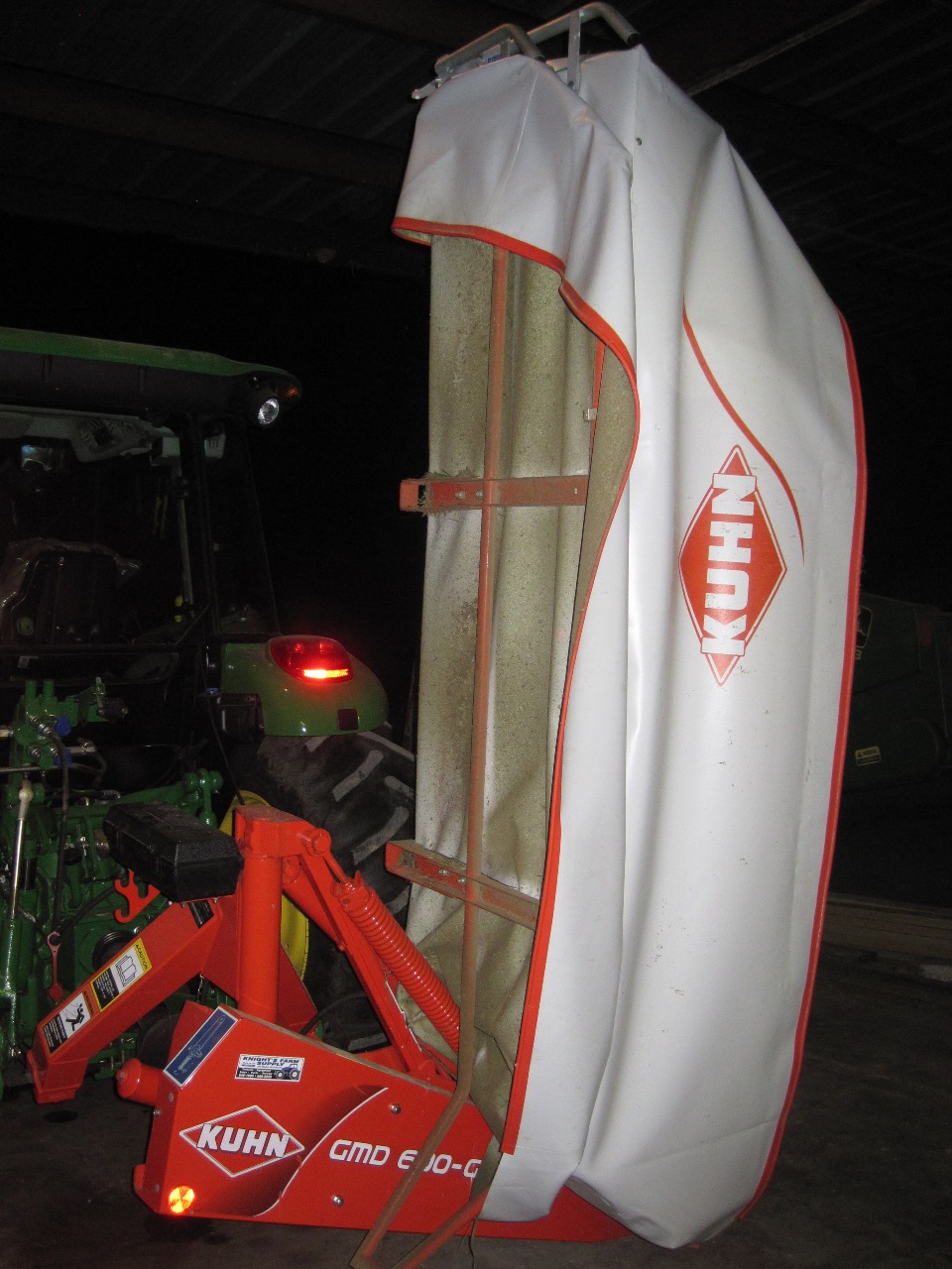

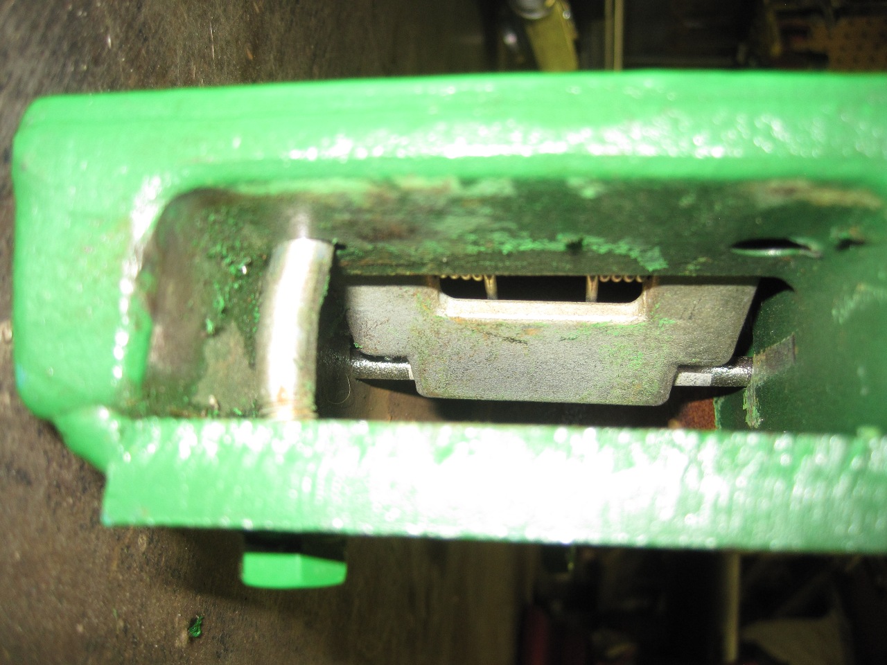

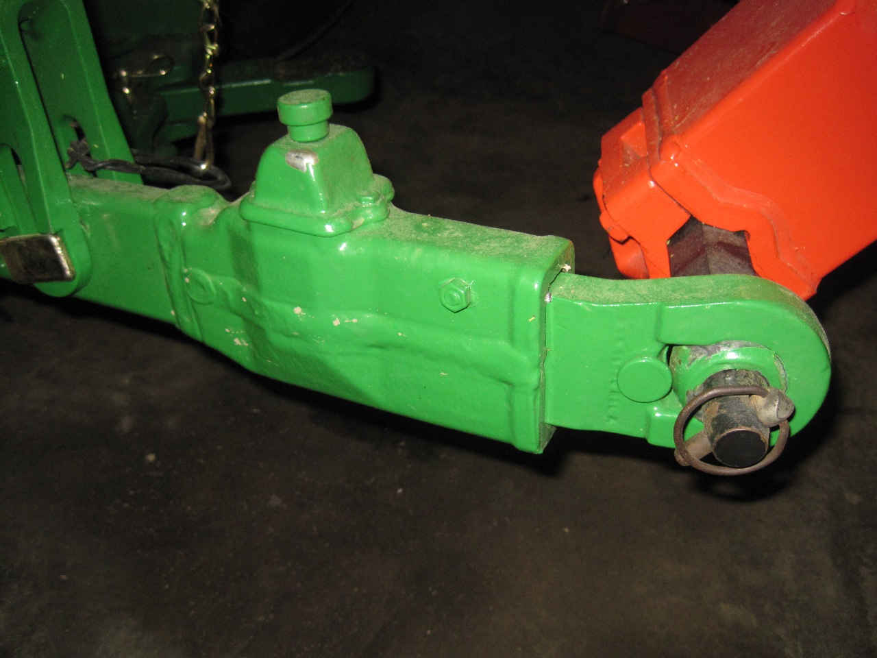

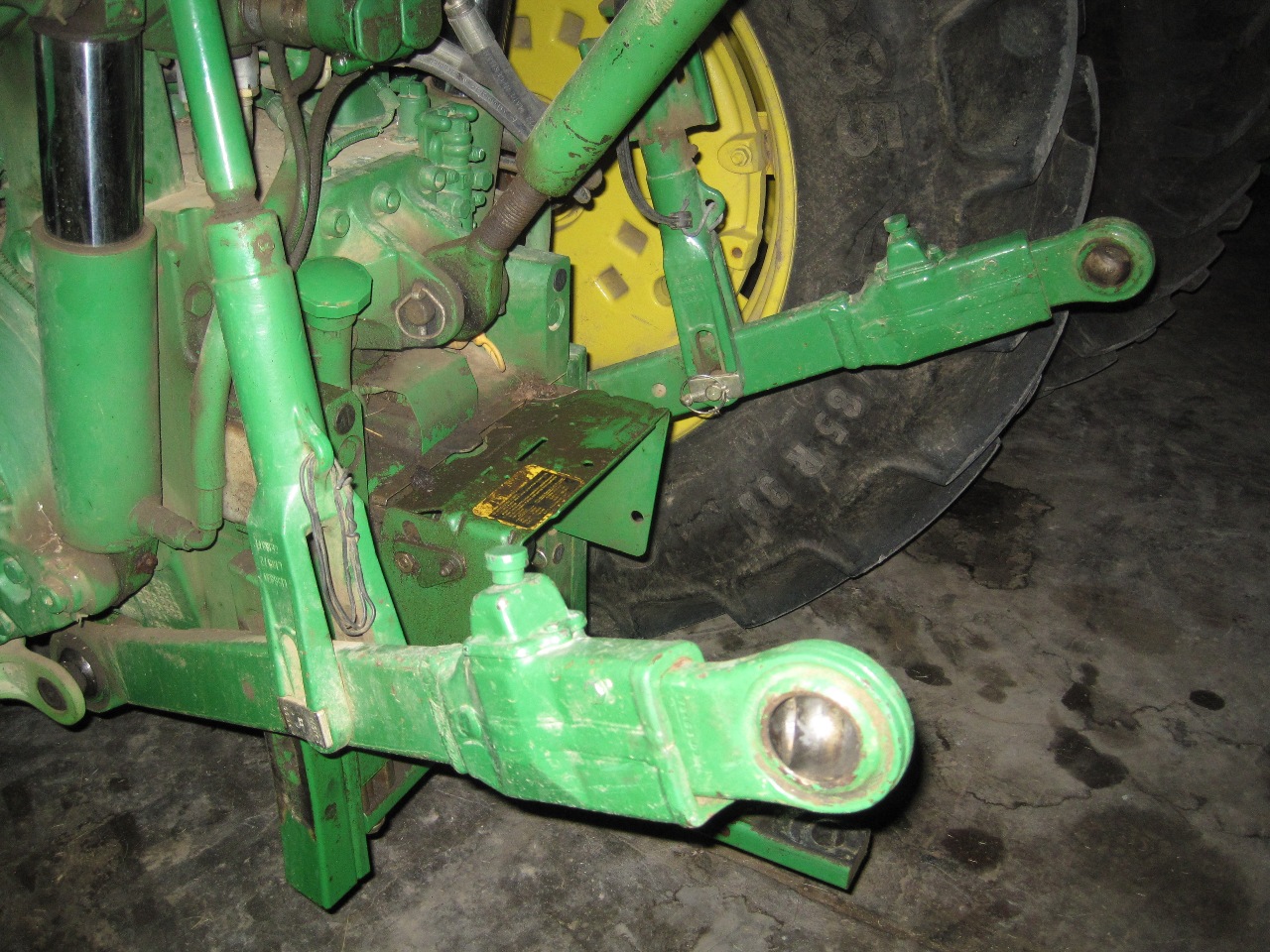

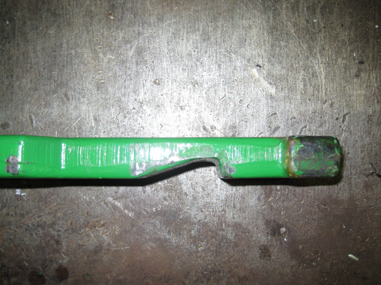

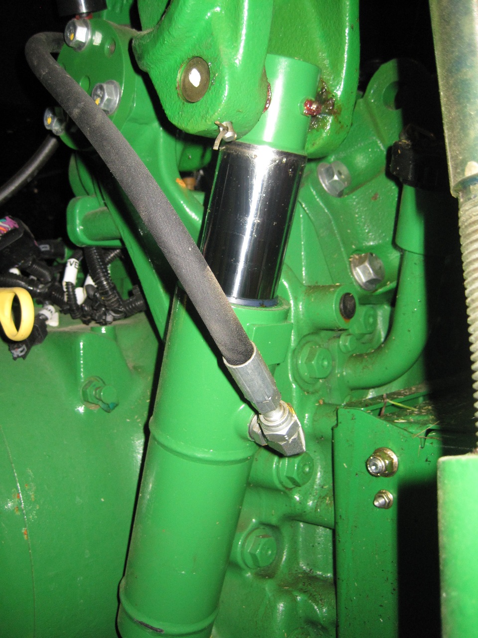

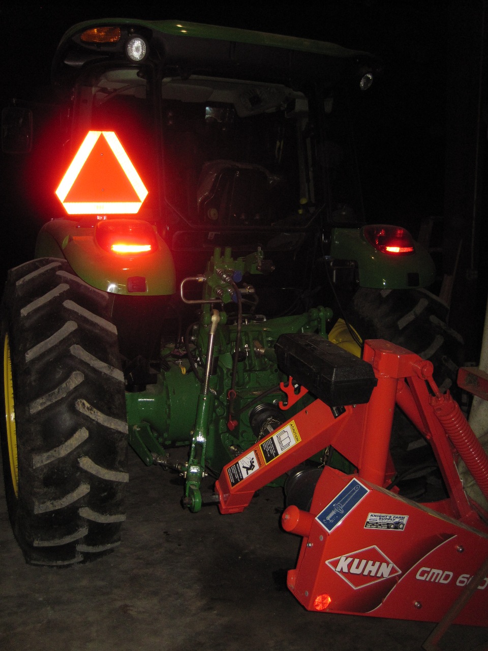

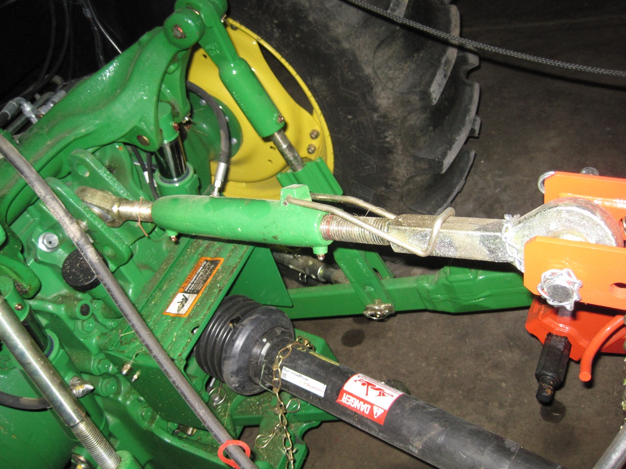

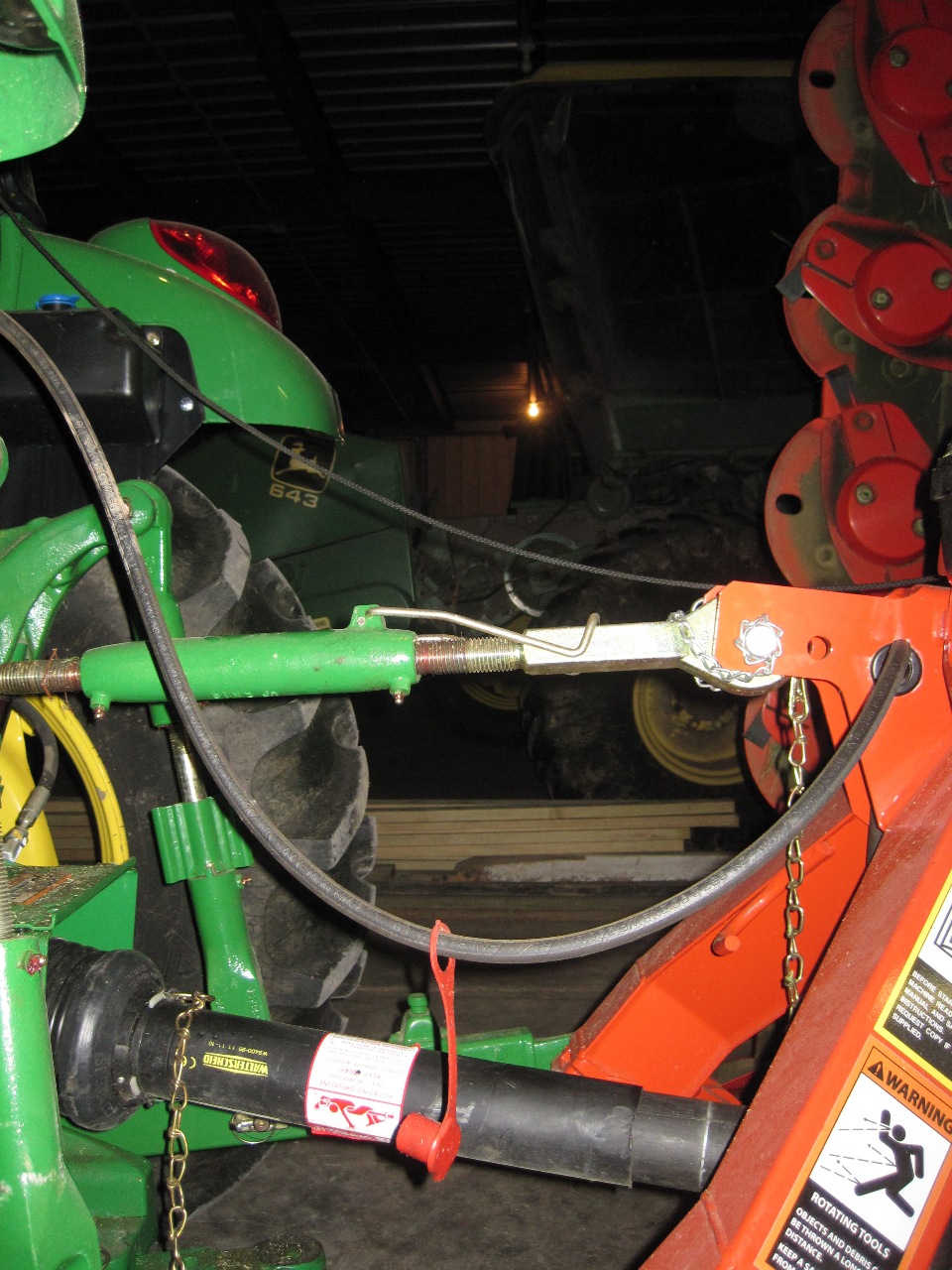

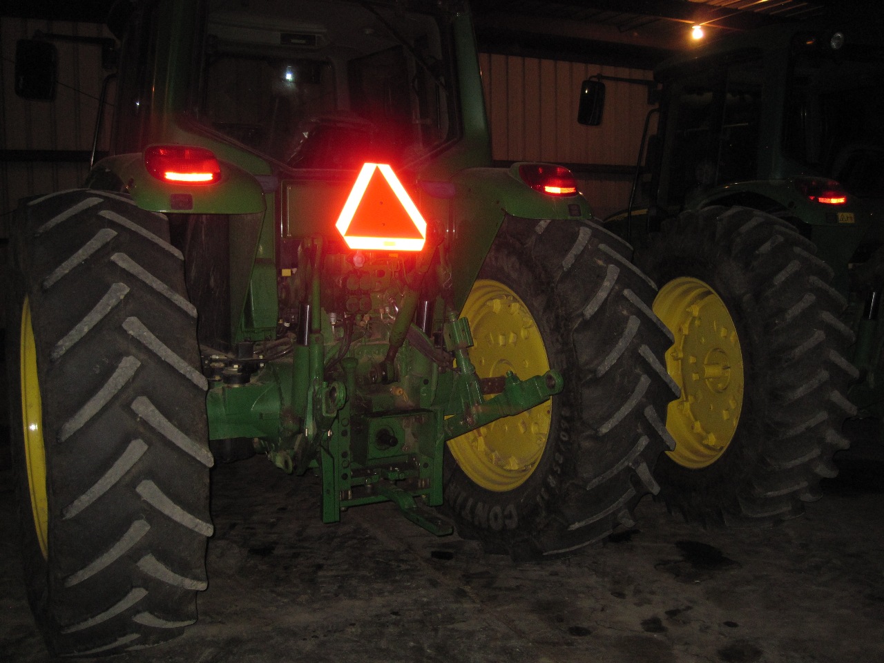

Well guys, I had some time after I parked the machines to snap some pics. Please forgive me for the quality, it was already after 9 and dark. I tried to park the 5075m near the shop so I could illuminate the rear end for a better shot. I also snapped some shots of 2 of our 6420`s to show the comparison of their standard hitch. Also, I made sure to take a few shots of the broken standard hitch arm and pieces. As of this moment, we have paid our dealer the $1100 (his cost), and will be sending Deere & Co. a registered letter to voice our dissatisfaction about the hitch failure. Hopefully they will refund us a portion of the cost. I agree Charleyfarmall, the HD hitch should have been standard. And YES, the manufacturing cost would hardly be more than the SD. I put 8 hours on the tractor today mowing pastures in all sorts of slopes and terrain....absolutely perfect function from the hitch and the mower. Its nice knowing its back there, would liked to have had it from new but...such is the way of things I guess.

Ive had a chance to operate the mower / tractor combination for several days now. I`ve been over just about every acre of ground on the farm. No problems with the hitch. The HD kit is really worth it. I would highly recommend the upgrade to anyone operating a 5M series tractor.
One thing I really like, when you use the telescopic ends during hook-up, you know they are locked in place when they "snap" back in. Way better than the Standard Duty hitch.
It would benefit Deere and their future customers if they would simply make the HD hitch the standard hitch, in its current form, no mods or alterations necessary. This is definitely the system that should have been on the tractor from first.
