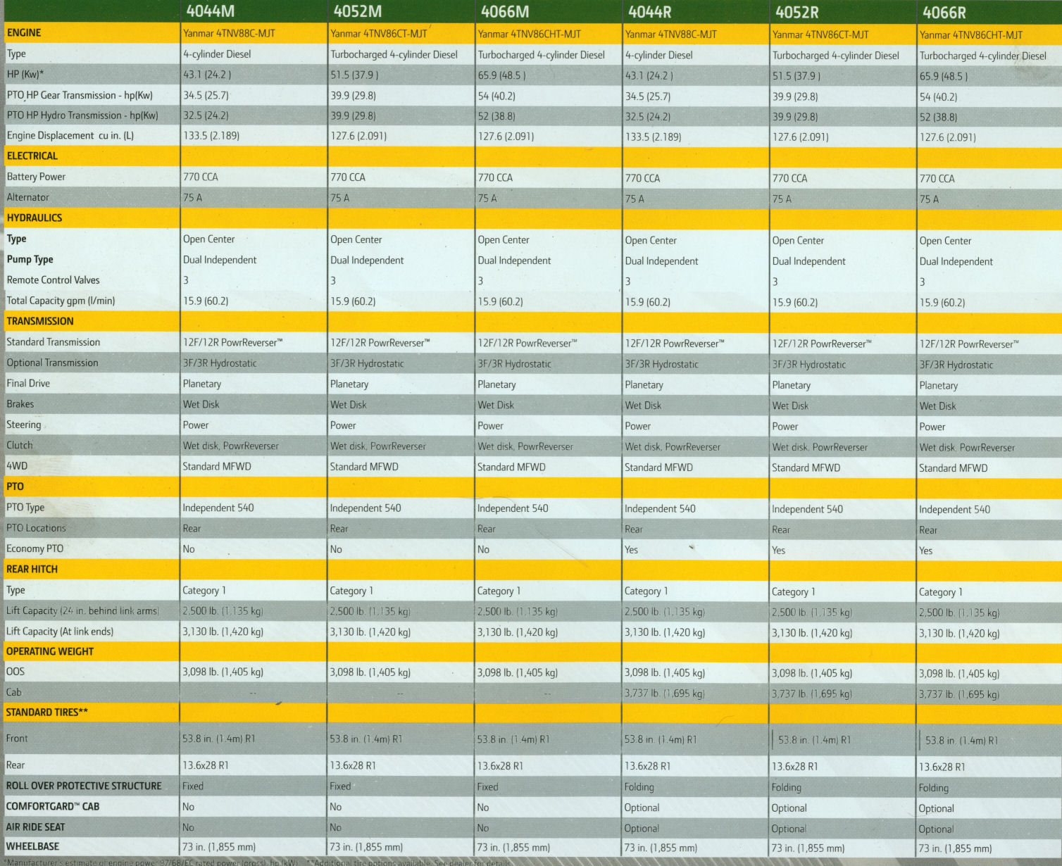

I had taken those figures straight out of the JD brochure other than rounding the figures. These are actual numbers shown. All 4000 series OOS @ 3098lbs & the Cabs @ 3737lbs. I am only going by what is printed on the brochure. ;)
Are you sure? That is the weight of the 3000 series.
I've got the old and new brochures as well as being a 4000 series owner and I am pretty familiar with them.
/ John Deere 5052R Compact Utility Tractor #15
Well, here are pictures of the front and the spec pages of the brochure that I have. I picked up new brochures at the local JD dealer before they closed down back in February. Maybe they were not so new? Still says "New 4 Family" though. :confused:

/ John Deere 5052R Compact Utility Tractor #16
That's nuts.
