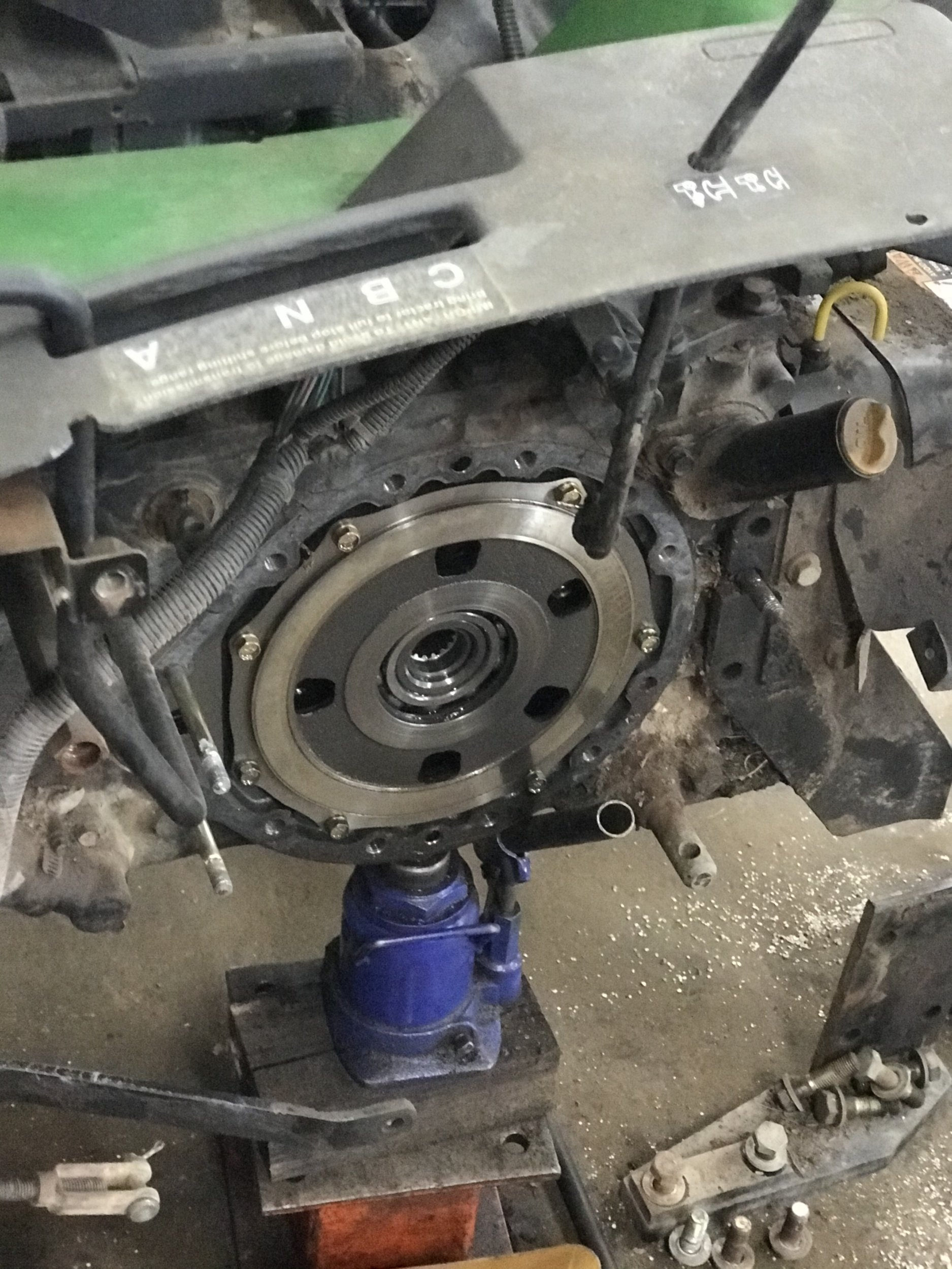

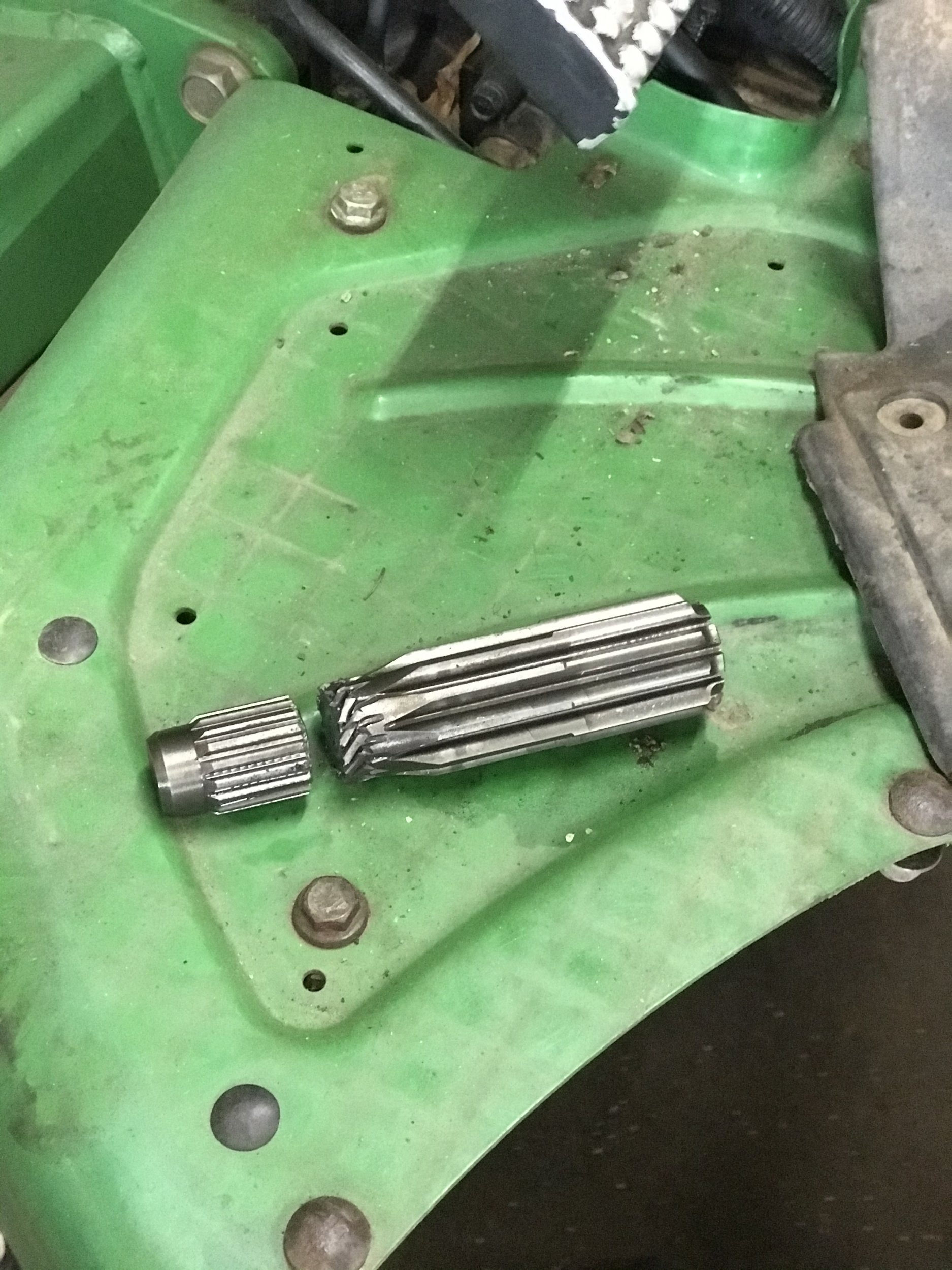

Update
I was at the tractor repair shop and they found the problem.

   / John Deere 4700 won't go into gear
M808491. Pinion

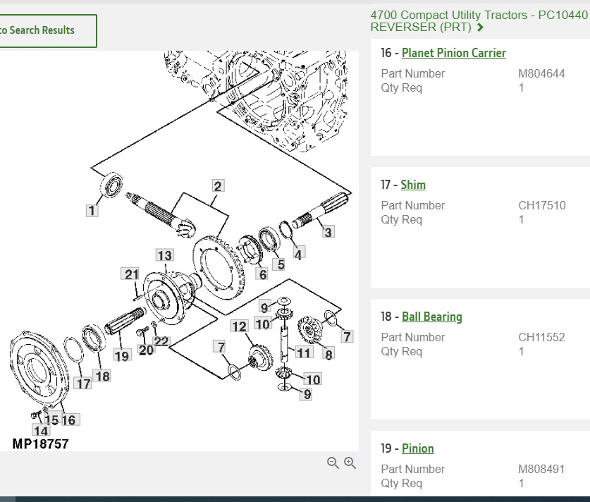

Can somebody comment further on this, and where this pinion shaft is located?
   / John Deere 4700 won't go into gear #8
Maybe this will help.
   / John Deere 4700 won't go into gear #9
at least it looks easy to get to !
   / John Deere 4700 won't go into gear #10

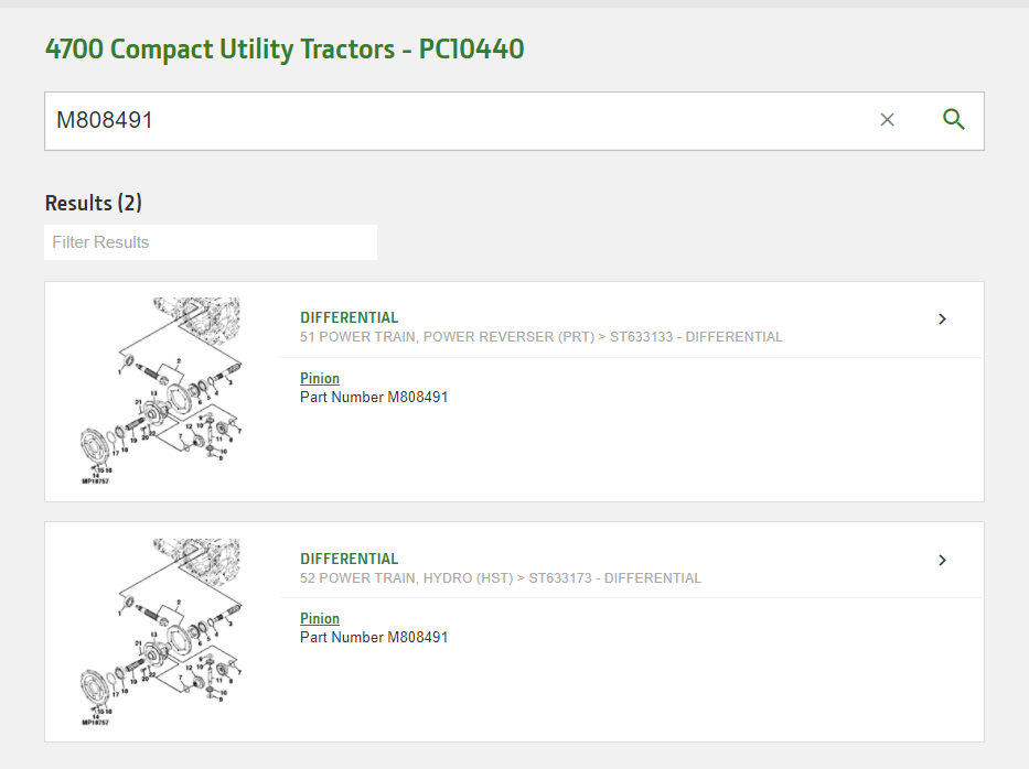

Beenthere answered your question.
In the future if you open JDparts.com go to PC10440 for model 4700 then enter a part #(M808491)in search window then schematics with part # application locations will appear as shown in photo below.
