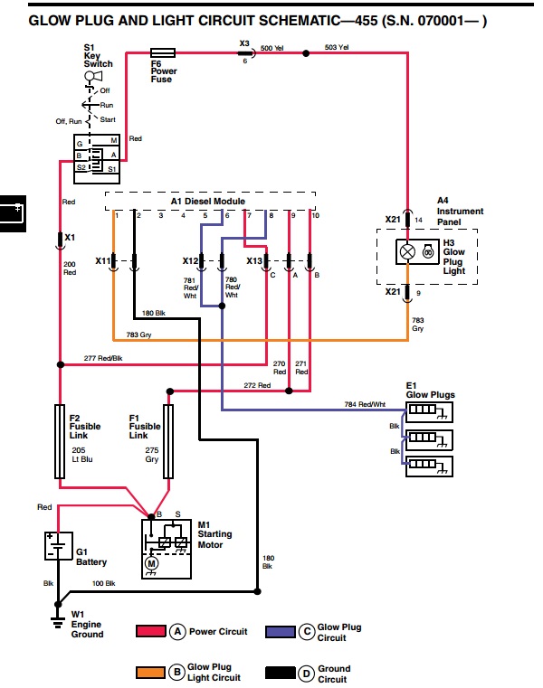

Apr 4, 2016 / john deere 455 glow plugs not working #11 C clindt New member Joined Jul 29, 2008 Messages 9 Location N.TX Tractor John Deere 455, 5055E I know this is an old thread, but I think my module might be shot. Does anyone have the schematics for a 70000+ machine?

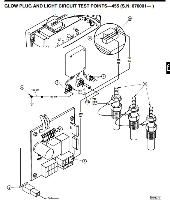

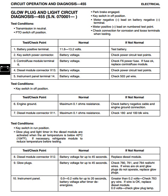

Apr 5, 2016 / john deere 455 glow plugs not working #12 B beenthere Super Star Member Joined Aug 16, 2001 Messages 18,612 Location Southern Wisconsin, USA Tractor JD_4x2_Gator, JD_4300, JD_425, JD_455 AWS, added JD_455, JD_110, JD_X485(sold) What part of the schematics are you looking for.. the electrical ? Same as my previous reply, but for the Over 70000 s/n ?

Apr 5, 2016 / john deere 455 glow plugs not working #13 C clindt New member Joined Jul 29, 2008 Messages 9 Location N.TX Tractor John Deere 455, 5055E Yes, please.
Apr 5, 2016 / john deere 455 glow plugs not working #14 B beenthere Super Star Member Joined Aug 16, 2001 Messages 18,612 Location Southern Wisconsin, USA Tractor JD_4x2_Gator, JD_4300, JD_425, JD_455 AWS, added JD_455, JD_110, JD_X485(sold) Attached here Attachments 455_Glow_70000_up.jpg 145.2 KB · Views: 540 455_Glow_70000_up_test.jpg 95 KB · Views: 933 455_Glow_70000_up_schem.jpg 95.4 KB · Views: 489
Apr 5, 2016 / john deere 455 glow plugs not working #15 C clindt New member Joined Jul 29, 2008 Messages 9 Location N.TX Tractor John Deere 455, 5055E It shows me me to test connections 11 and 12, but I don't see them on the schematics.
Apr 6, 2016 / john deere 455 glow plugs not working #16 B beenthere Super Star Member Joined Aug 16, 2001 Messages 18,612 Location Southern Wisconsin, USA Tractor JD_4x2_Gator, JD_4300, JD_425, JD_455 AWS, added JD_455, JD_110, JD_X485(sold) For some reason.. my fault.. the schematics didn't post as I expected. Thought I double checked too, but obviously not. Try that again. Attachments 455_Glow_70000_up_schem.jpg 96.3 KB · Views: 677

Apr 6, 2016 / john deere 455 glow plugs not working #17 C clindt New member Joined Jul 29, 2008 Messages 9 Location N.TX Tractor John Deere 455, 5055E Great! Thank you.
