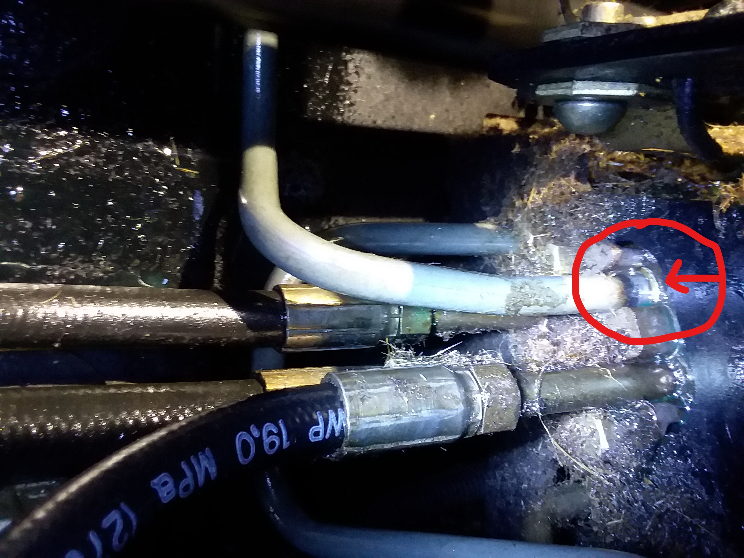

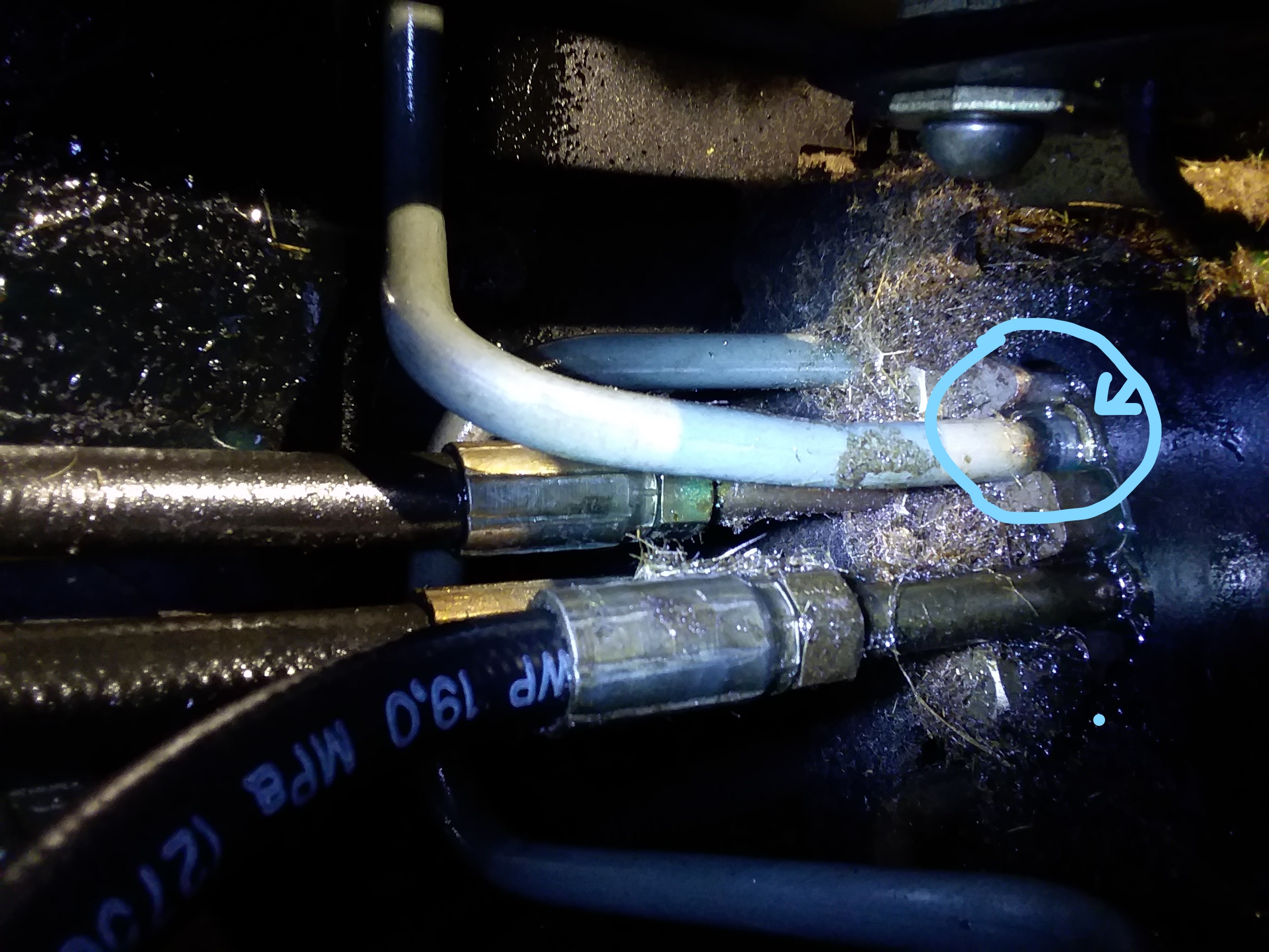

445 1_LI.jpg445-2_LI.jpgLooks like this is my leak Metal line going into the power steering control valve should it be able to move in and out?
/ John Deere 445 big hyd leak
Great info so It may just be an o-ring could my luck be that good. I'm going to take a run up to the dealer and see what they say.
/ John Deere 445 big hyd leak #8
Hard to tell in your picture, is yours missing the retainer plate?
#9

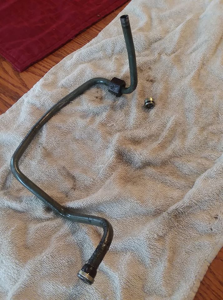

No retainer plate is there, the end broke loose either from factory defect or vibration. The end on the line that goes into the valve is soldered on. It was broken away. I was able to remove the line and go in with a pick attached to vise grips and yank it out. To it to a hydraulic shop and they re soldiered it on for me for free. John Deere wanted 60 bucks for a new line.
Great info here thank you all so much..... back up and running.

Eboal - This same exact thing just happened to me when pushing snow yesterday. Do you remember what the part # is on that hard line? More importantly, it looks like the line goes into the SVC valve. How did you go about removing the line? Also... how did you get to the bolt head on the left side as I cannot get my socket to fit for the life of me.
/ John Deere 445 big hyd leak #11
Great info here thank you all so much..... back up and running.View attachment 591881
I bought the same hard line from JD. After much cursing and yelling, I have it in place but I am going to really need to force the line into the correct port on the steering valve to make it fit. Can anyone confirm I need to push this with a good amount of force into place? It is hand tightened on the SCV and sits almost perfectly into the port where the main line from the transmission sits. If anyone can assist I would be grateful. :confused:
