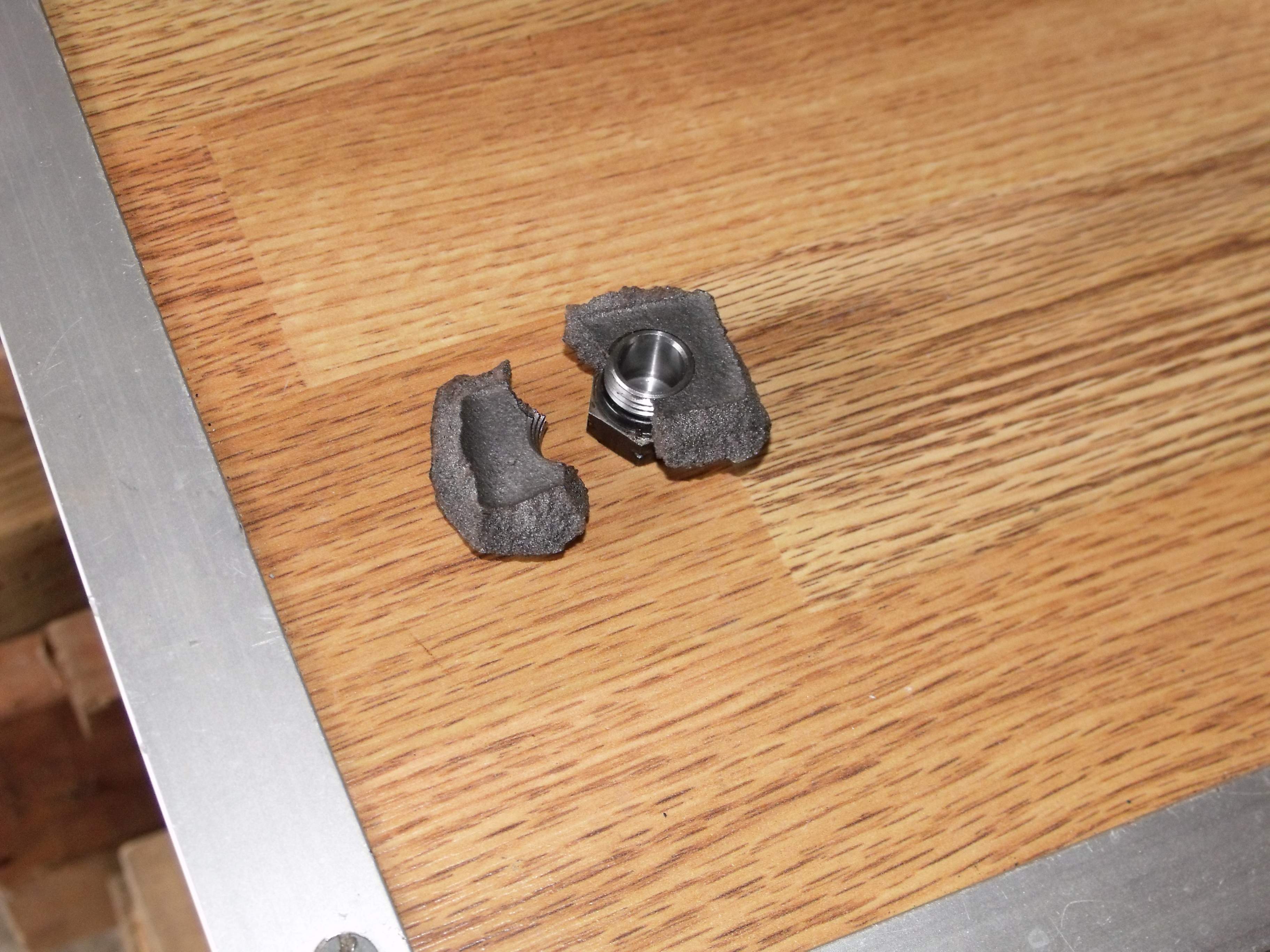

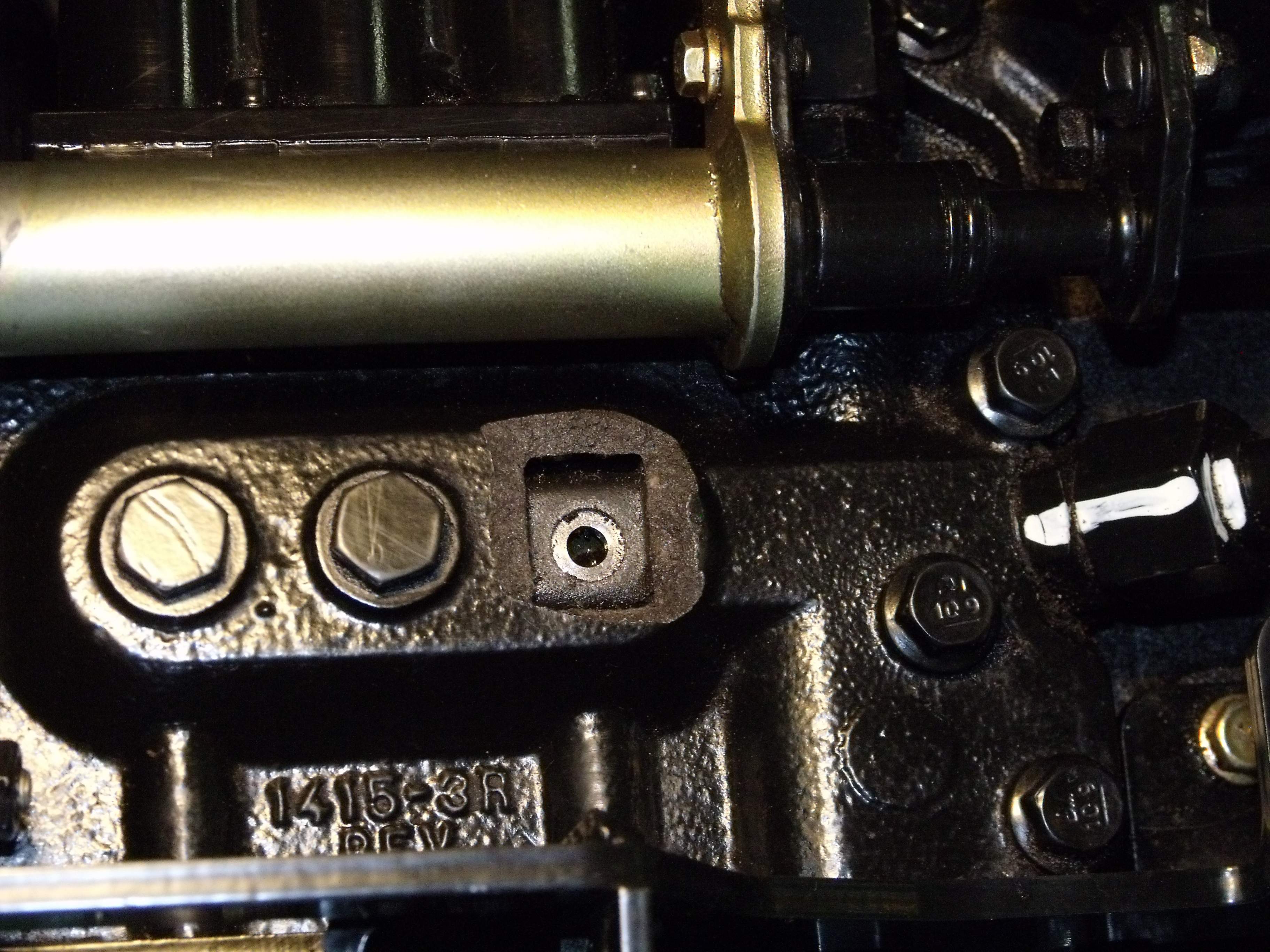

I had the top of my spool valve casting blow out. Is this a common problem. It is a 2004 with only 465 hrs on it. Anybody got any ideas about this one. 2 pictures attached.

Absolutly not a common problem, this is the first I have heard of this on a machine like yours. It seems like a really odd place for a failure also, where you doing anything unusual when it happened?

I was pushing some brush and limbs with the bucket into a pile. Nothing i have not done a 1000 times before. This seems to be an $800.00 part from john deere
nothing on mine is bad but the casting. But you can not buy just the casting from what i can find out. You have to buy the whole assembly. Not sure if i could find a used one or just get a new one. This is a great tractor and i have had no other problems with it. The strange thing about this is the casting does not look bad. Usually you would see a void in the casting where it broke but i see nothing. I had my Senior Metallurgist look at it an we can not see where the failure started.

Is that plugged hole just a machining process hole, or does it have a purpose for measuring pressure etc??
Could there have been a pressure spike that didn't get enough relief through the PRV??? Of course it should not blow the casting...but if something is wrong....it will break at the weakest point....:confused2:

The manual says they are check valves.

Yes, you have to buy the whole thing. The sppols are a "lapped" fit into the valve body so it only comes as a "matched" set. Good luck finding a used one-I would not know where to start looking.
When you get it fixed, you may want to hook up a gauge and check the PRV (pressure relief valve) setting just to make sure it's not set to high...but I think this is just one of those strange failures that turn up once in a blue moon:(

I know this is an old post but it came up in a search because I am looking for replacement plugs like that shown in the pictures posted by jim98338. If Jim happens to still be on here and has that part sitting on a shelf, I would love to buy those plugs.
Otherwise, can anyone tell me where to buy those plugs for my JD 4310 spool valve that works fine; however, those plugs are rusted so bad that one of them has a pin hole in it now and leaks badly. JD will sell you the whole valve and many other parts for the valve but not those plugs - go figure!

Can you get one out and determine thread size and how it's sealed?
I will guess metric threads.
Maybe an O-ring to seal?

Thanks for your response. I am at the point of needing to try to get at the valve so I can take them out because a couple of local hydraulics shops indicated they might be able to source something that will work. Unfortunately, I am not a mechanic and I hesitate to start taking the tractor apart for fear I will break something or not be able to put it back together properly! It is located under the seat. Maybe there's a Youtube video for that - I have not looked!
In any case, I had a tractor mechanic find the original leak and it was a pin hole in the plug. He took it to a welder and it worked for a short time; however, I am guessing the weld failed because as soon as I put a big load on the system the oil started squirting out the same plug. So, not likely just an o-ring issue.

Hard to weld something oily and get it to hold. You need to find out what plug will work and replace it.
If the hydraulic shops are close, you might see if they will replace the plug if you bring the whole tractor to their shop.
