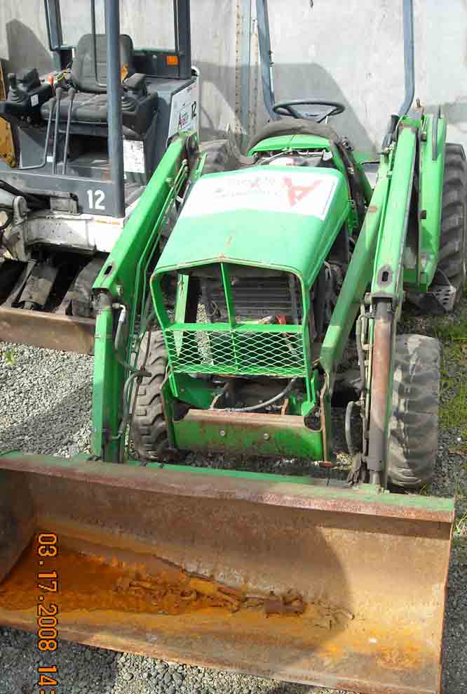

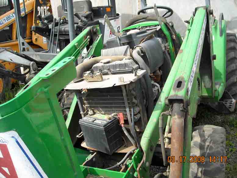

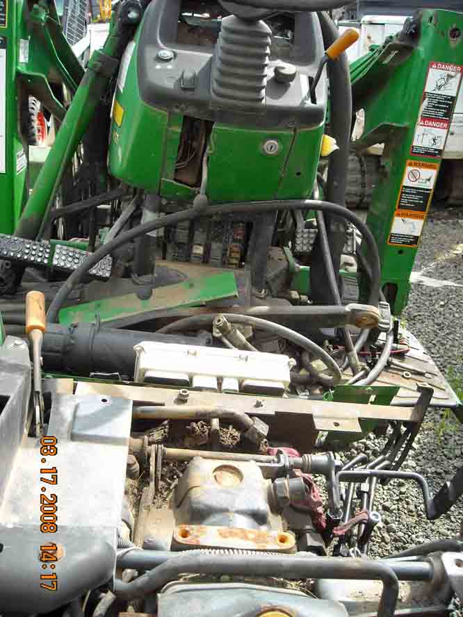

Anyway, here are pix of how I found this poor tractor. Note the missing
parts: hood, seat, FEL valves, etc. If you look closely at #3, you can see
the instrument cluster lying on the floorboard, along with a 3-pt arm, and
a loose FEL cylinder. Tires are flat an wheels are off. There is a very
hefty JD hood protector....I don't think it worked. Reports are that the
engine is dead, and I can see a bent FEL cylinder rod and a broken axle
casting.
Next time: I get the beast home.

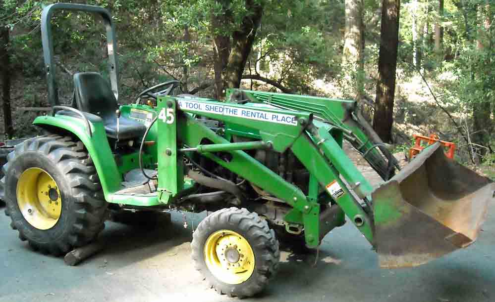

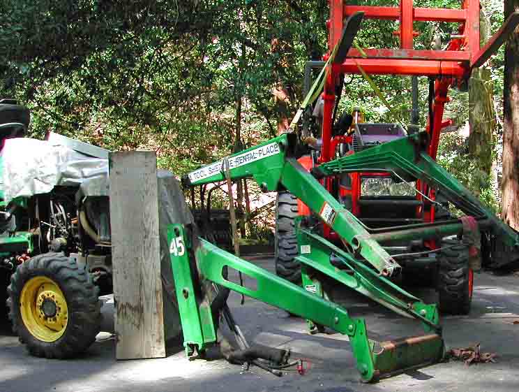

These pix show the tractor after it was brought home on a rollback
truck. The place I bought it from sort of put it together with the parts
they could find, so at least it could be moved. Numerous parts had been
taken off to fix other 4300s that were in the active rental fleet. Since the
range shift was broken and the transimission was in gear, I had to pull
the tractor off the truck deck.

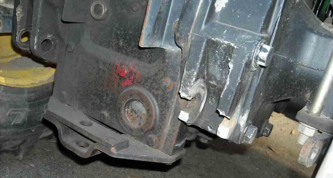

The 2nd photo shows the back end of the tractor, and the broken right
axle housing. I was surprised to find out this casing is cast aluminum....not
a good design decision, IMO. The lower 3-pt arm attachment has pulled
out. The middle section is cast iron or cast steel, which is the opposite
of the earlier 955, which had Al center and cast steel axle housings. The
Kiotis I have owned, and some of the Kubotas used all steel back there. I
would hesitate to buy a tractor this size with Al axle castings. (I do plan
to mount a backhoe on this tractor.)

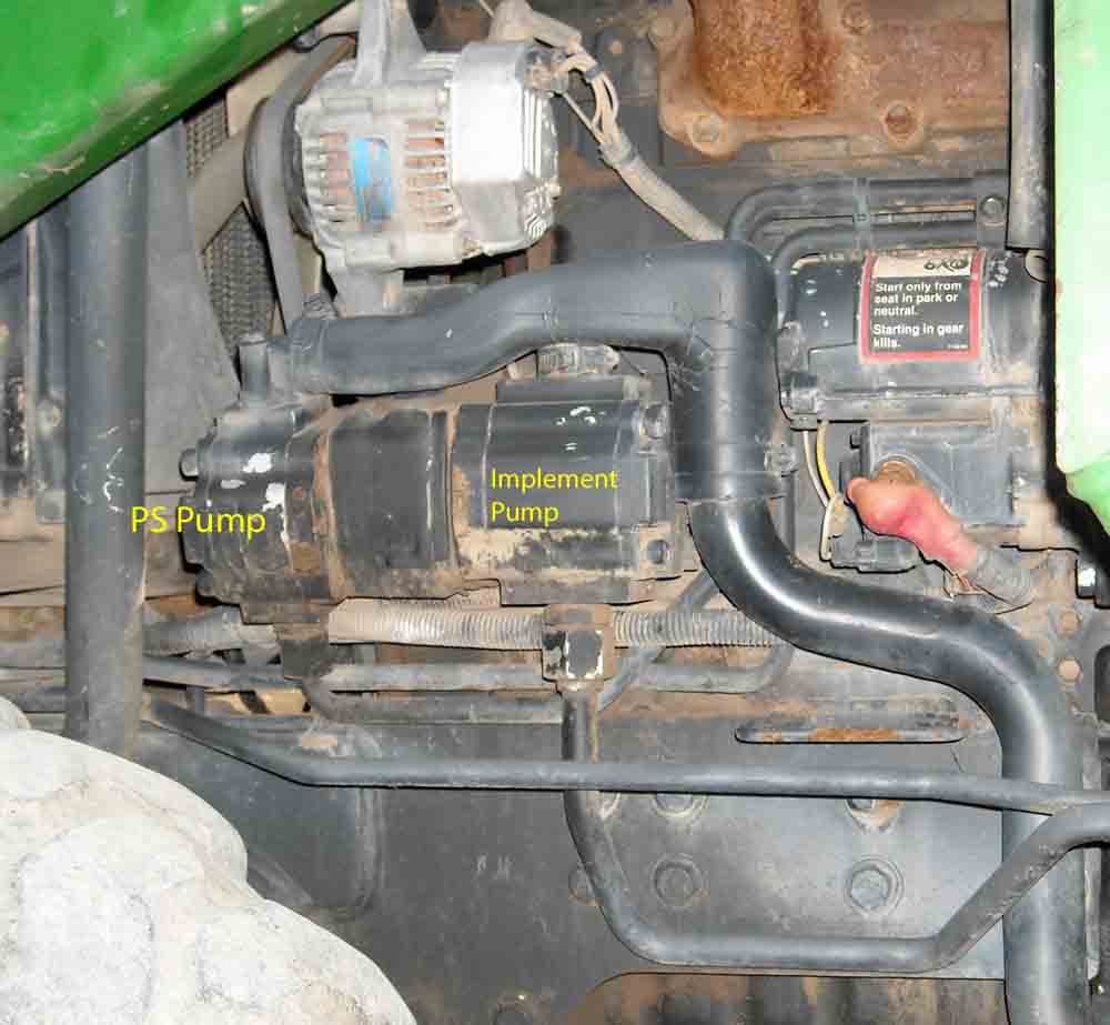

Finally take a look at the the two independent hydraulic pumps....no
flow divider is used, which IS the case on a lot of other CUTs this size. Nice.

Considering aluminum costs more than steel and weight savings on a tractor seems less important than on other vehicles; it seems odd that Deere would make the housings out of this metal.
I am dumbfounded by this design/manufacturing decision, too. It seems to
me that you need to bring a magnet with you when you get a tractor this
size. I would like to know what other tractors in this class (30+hp, 3000+
lb naked) use all-steel or part Al. Maybe other TBN members will post
about their CUTs. In terms of evolution, does the 4310 use Al? What about
JD's current crop, the 3xxx's?
As for fixing this, don't tell anyone, but I am going to take the axle housing
to a welder who does TIG process. Each housing new from Deere is $640.

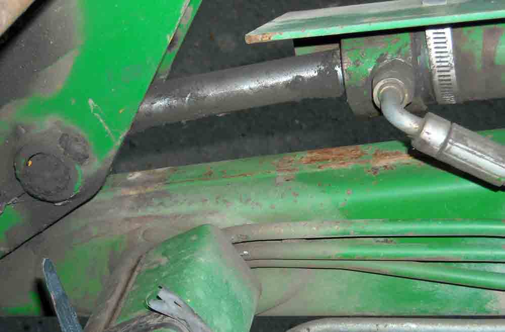

#17
Thx for the support, guys. I just got my engine block back from the
machine shop, so it looks like I can rebuild it with .25mm O/S pistons.
As for the FEL cylinders....the rods are only 25mm (one inch) in diameter.
Needless to say, most of the units have had theirs bent. The photo shows
one of the other 4300s in service....you can see the bucket cylinders are
rust colored. They have been rebuilt by a hyd shop that does not bother
to repaint. There are only one or 2 of these cyls that have NOT been

Now for the dissassembly. Removing the FEL was tough. Without any
hydraulics, these things are terribly unwieldy. I ended up taking it all
apart to remove it. I like the QA loader bkt. I never had one of those.
The FEL pivots are in pretty good shape....at least all the pins are 25mm
in dameter.....the FEL pins on my 955s were quite a bit wimpier (17mm).
As I start removing things and splitting the tractor, I noticed that most
bolts are 13, 15, and 18mm head sizes. I have never SEEN an 18mm
socket, as none of my many socket sets comes with one. Very unusual.

18MM is one of those "Special" metric sizes. Its used alot on Japanese products especially. My honda has a 18MM sparkplug. It never comes in common sets for whatever reason.
