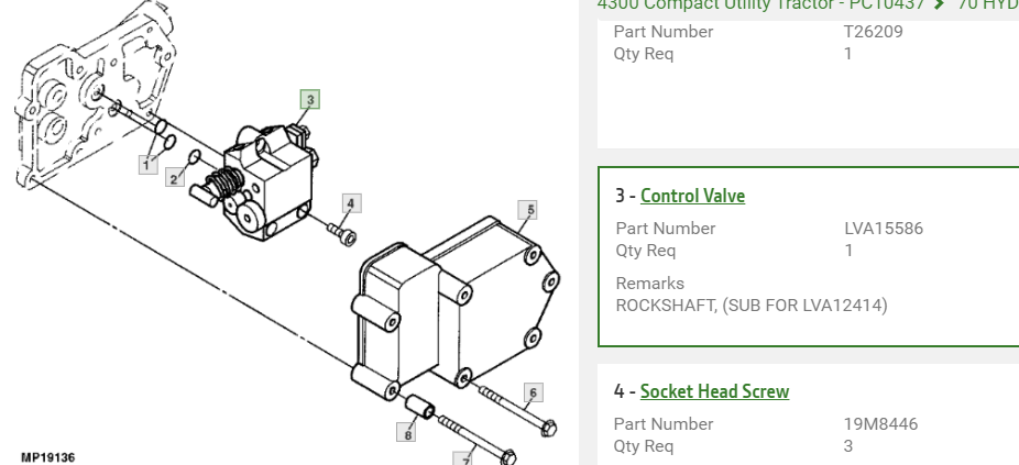

My 3 point just recently started screwing up (more than usual).
Since I've owned the tractor (2016) when I raise it all the way up the motor would labor, so I would have to move the lever down a bit to get it to stop.
The other day, the 3 point started dropping all by itself. It was very annoying dragging my box scraper while trying to move stone with the bucket.
Upon further inspection, I noticed that when I move the rock shaft lever, the 3 point doesn't move at all until it hits a point about 3/4" back. At that time, it acts as a "all the way up" lever. The 3 point then lifts all the way up and the engine labors until I move it down slightly.
At this time, moving the lever down slightly seems to hold the level steady until it doesn't. I can't trust it to stay up, and while I'm running the tractor the 3 point gradually lowers until I'm dragging it.
With the 3 point fully raised, if I move the rock shaft lever down just slightly past the "neutral" position, the implement lowers all the way to the ground.
Basically what I have now is an all raised or all lowered situation.
I pulled the seat and am looking at tearing apart the left side rear fender to take the cover off the valve and check for debris in the valve such as screen material that may have blown past the inline filter (I haven't pulled that line yet, but that will be the first thing I do).
Any thoughts? Am I on the right path? Does it sound like something is caught in the valve, or am I barking up the wrong tree?

/ John Deere 4300 3 Point Malfunction #4
This is the adjustment rod.. key # 8 that shuts off the lift valve.
Wow! That's a great diagram! Can I ask where you got it? Is it part of a service manual?
The only manual I have is the operators manual and it doesn't show any of this. I'd love to get my hands on something a little more in depth.
Now I have a few things that I can check out. I assumed that maybe one of those "bolts" were check valves, or relief valves, but I had no way of knowing until now.
Well, I spent last evening tearing down everything and here's what I found:
@waycoolmarine - 100% correct. That roll pin was broken and the shaft is seized. I hit it with PB Blaster and then removed the linkage in order to remove the broken roll pin.
@super55 - Also correct, but in this case, there is a deeper problem.
So, here's what I did in order:
1) Removed the input hydraulic line in order to inspect the inline filter. It was blown through, but very little if any pieces were missing. I removed the filter basket from the fitting and re-installed. (Should I do something about this after I get it running, or just run it without the filter?
2) I found the adjustment linkage for the 3 point that stops it from going up any further. As previously stated, I removed it, removed the broken roll pin, and saturated the shaft in penetrating oil in an attempt to free the shaft. No dice as of yet.
3) I removed the wheel & fender, and took the emergency brake off of the bracket in order to get to the hydraulic valve. I removed the cover, drained the residual oil out of it, then removed the valve and removed just about everything that could be removed (one at a time) to check for debris that might be causing me a problem.
At this point I'm nearly certain that my problem lies in this valve, but I see nothing wrong with it. Can these be rebuilt? Is there anything I can do with it?
It's acting as an on/off valve instead of a variable position valve. It's all or nothing, and I don't see how any other component could be causing this.
So, right now, the tractor is torn apart and the valve is removed and reassembled on the bench.
Suggestions? Where to go next? Is this valve still available if it can't be repaired? Cost?
#11
Okay, I found the valve on JD-Parts. Pricey little bugger! ~$550

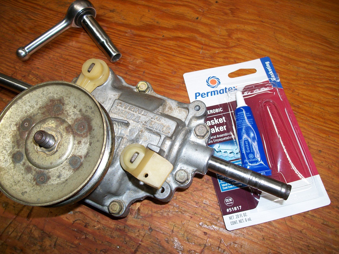

I used brushed on some permatex gasket maker. Any auto parts store should sell a small can of it. I like it a lot better than the typical RTV gasket stuff. Keep us posted on your results.

Always nice to keep from having to use the gasket-in-a-bottle if possible. I got up close with it last month when I re-built a 5 speed tranny for my friend who couldn't afford to replace his in a Deere walk-behind mower. Completely new experience for me, as a bearing went out and a replacement transaxle new was $486.
After cleaning, new bearing, have to assemble all the little parts and fill it with grease, then apply the liquid gasket and slap the two halves back together, torque the bolts and cross your fingers that all is in the correct place and the correct order. Lots of horror stories on line of failed attempts. Thankfully all went well and it works for a very happy friend. Learned about the liquid gasket then. I thought Permatex only came in a can with a swab for painting it on, usually with a paper gasket involved. Times have changed..
