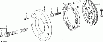

Powershift trans needs to be tested with gauges in each gear to properly diagnose malfunction. Also another possibility is a slipping damper clutch in engine flywheel. How long since hyd filters were changed & sump screen checked/cleaned?
