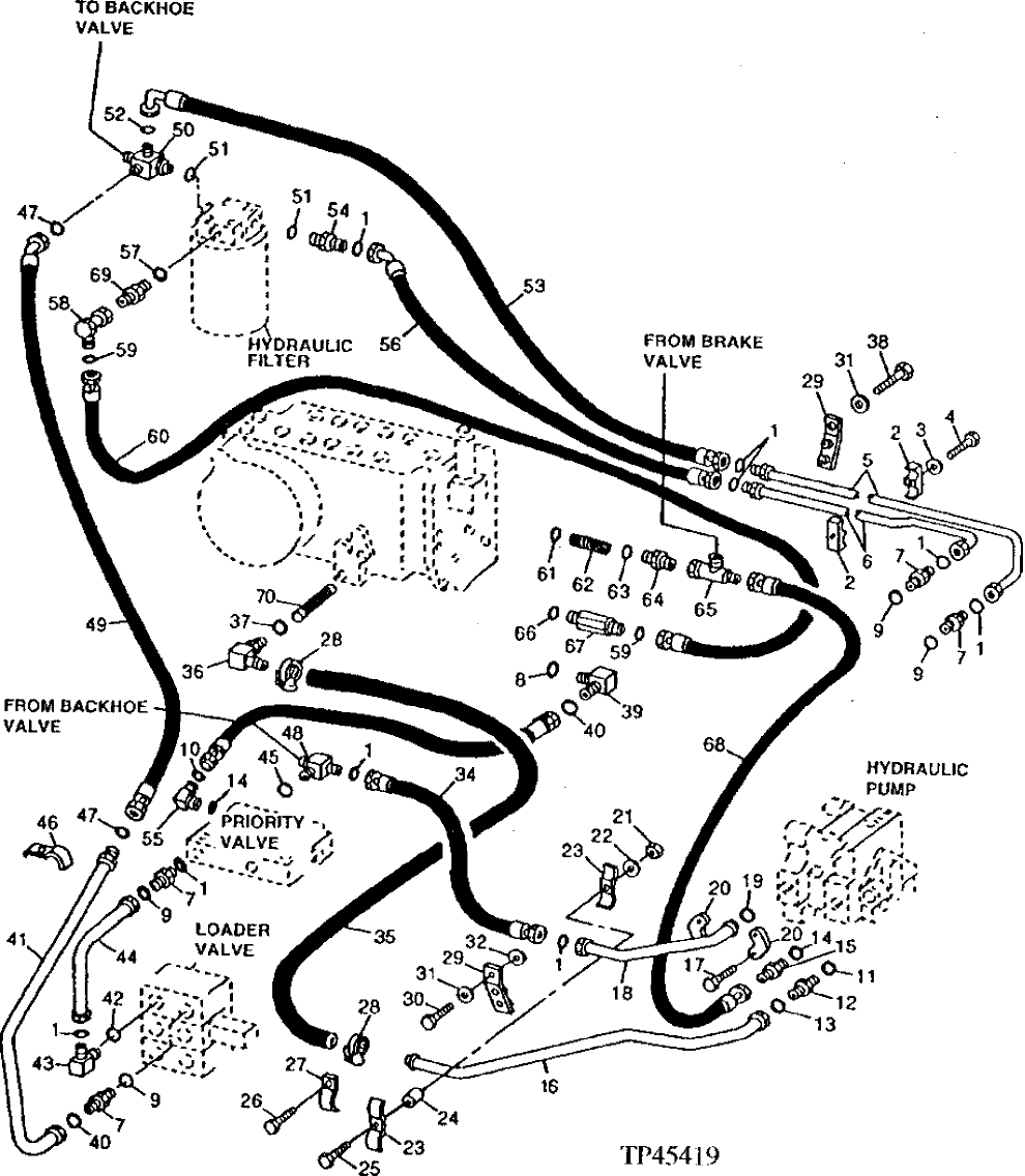

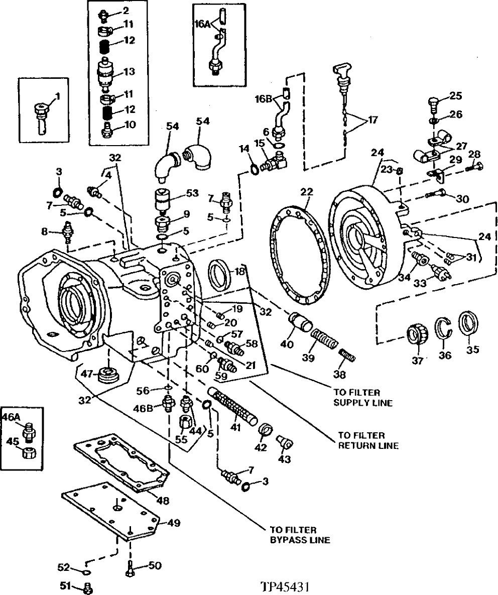

The bucket does stay in position when the engine is running. I am planning on changing out the oil and filters this week. I know the screen has never been changed. Where would the sump screen be located on this machine?
/ John Deere 410d hydraulics #7
Screen is parts key 41 or 70 depending on tractor serial number

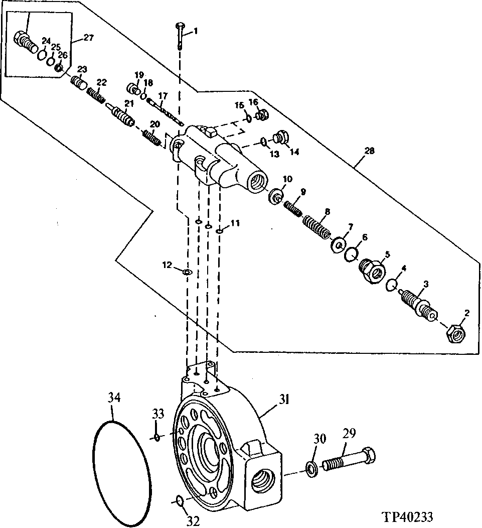

Thanks Jim for the info. The serial number is 789024. Where would the pressure relief valve be on this machine?
/ John Deere 410d hydraulics #9
On the hyd pump in front of the radiator. Stroke control valve screw is parts key 3. According to your tractor SN screen location should be per the 1st photo I posted
