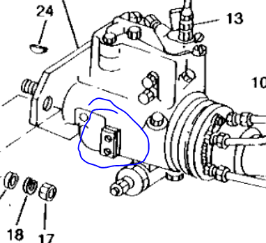

Just purchased this tractor. It ran strong when I tried it but after delivery it ran poorly and is fuel starved.
I have ordered an owners manual but don't have it yet.
I suspect an injector pump problem based on what the guy told me when he dropped it off. He said if it started losing power, remove the top line from the injection pump which I believe is the return line, clean it and it will run good.
Of course 15 minutes into my first dig this happened. Didn't help. But doing research it seems stuff from the injector pump o ring or something clogs the return line check valve and shuts the pump down.
But if he had not told me this I would suspect the filter which I am going to change first. (a lot cheaper than an injection pump)
Now my first problem. This is the square glass filter. It looks simple to remove with just an apparent clip holding it.
My problem. I am not sure how this works and don't want to break anything. Just how do you get this clip to release? I pried but it doesn't seem to do the trick.
Any secrets in priming it after a fuel change. My thought was to run the starter by shorting across at the starter. This should run the pump without starting. I don't see any hand primer.
Thanks.
Doug
/ John Deere 410C fuel problems. #2
I'll bet check valve on IP return line is plugged. Remove timing window screws then pry gasket loose from pump then test to see if engine will run correctly. Window is encircled in blue. It's also possible fuel control solenoid is heating up & shutting down.
Thanks Jim.
I cleaned the check valve because that was what the seller told me to do if this happened. Of course after he delivered it.
I changed the filter and no change.
I just removed the plate you said and it ran much better. Ran up to 2000 rpms with no load. Don't know what it is supposed to turn.
Now what?
Doug
Just tried it again with the plate back on and it went to 2300 rpms no load on a brief trial. The most I was ever able to get was 1500 rpms and it went downhill from there. Maybe 8 or 900 rpms getting it back home. It would hardly move.
Doug
/ John Deere 410C fuel problems. #5
More than likely the fiber drive ring in IP is deteriorating and will need to be replaced by dis-assembly of IP

Well running it lasted about 15 minutes. Pump rebuild time
I've seen tractors such as yours run several 100 hrs after the glass ball & spring is removed from fitting on IP that fuel return line attaches to. If you choose to remove ball & spring do so at your own risk as possible IP damage can occur if altered IP is run too many hrs without installing new drive ring.

Well today I removed the glass ball. My rpms are back and it was plugged.
We'll see what happens but I should be able to get my job done before rebuilding the pump.
We'll see.
Thanks again Jim.
