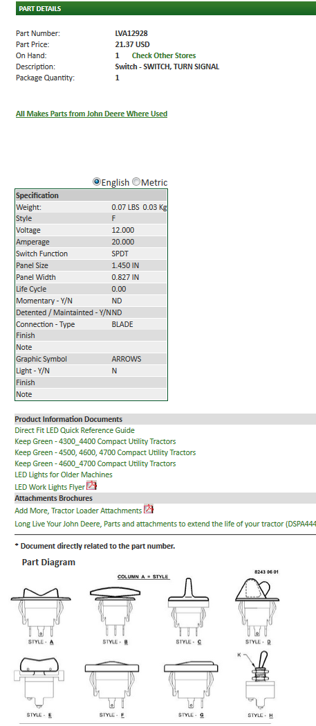

Here's the spec's on the 4105 turn signal switch.
LVA12928 Switch - SWITCH, TURN SIGNAL ADD 21.37 USD
/ john deere 4105
#9
Tx Jim thanks for the specs that pretty much confirms the turn signal switch is just a regular spdt.
Looks like Ill have to order the repair manual to figure this out. I want one anyway:laughing:
